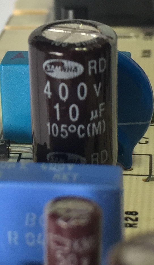

        Here are some revised photos

            Anyway, it does not seem to me there is actually any in here so it must be somewhere else in the fridge and here it only controls the freezer.
            What is the capacity of that biggest capacitor by the three blue ones?
            There are 9 quality 2.2/100 caps http://uk.rs-online.com/web/c/passiv...1&m=1&aaaExp=Y

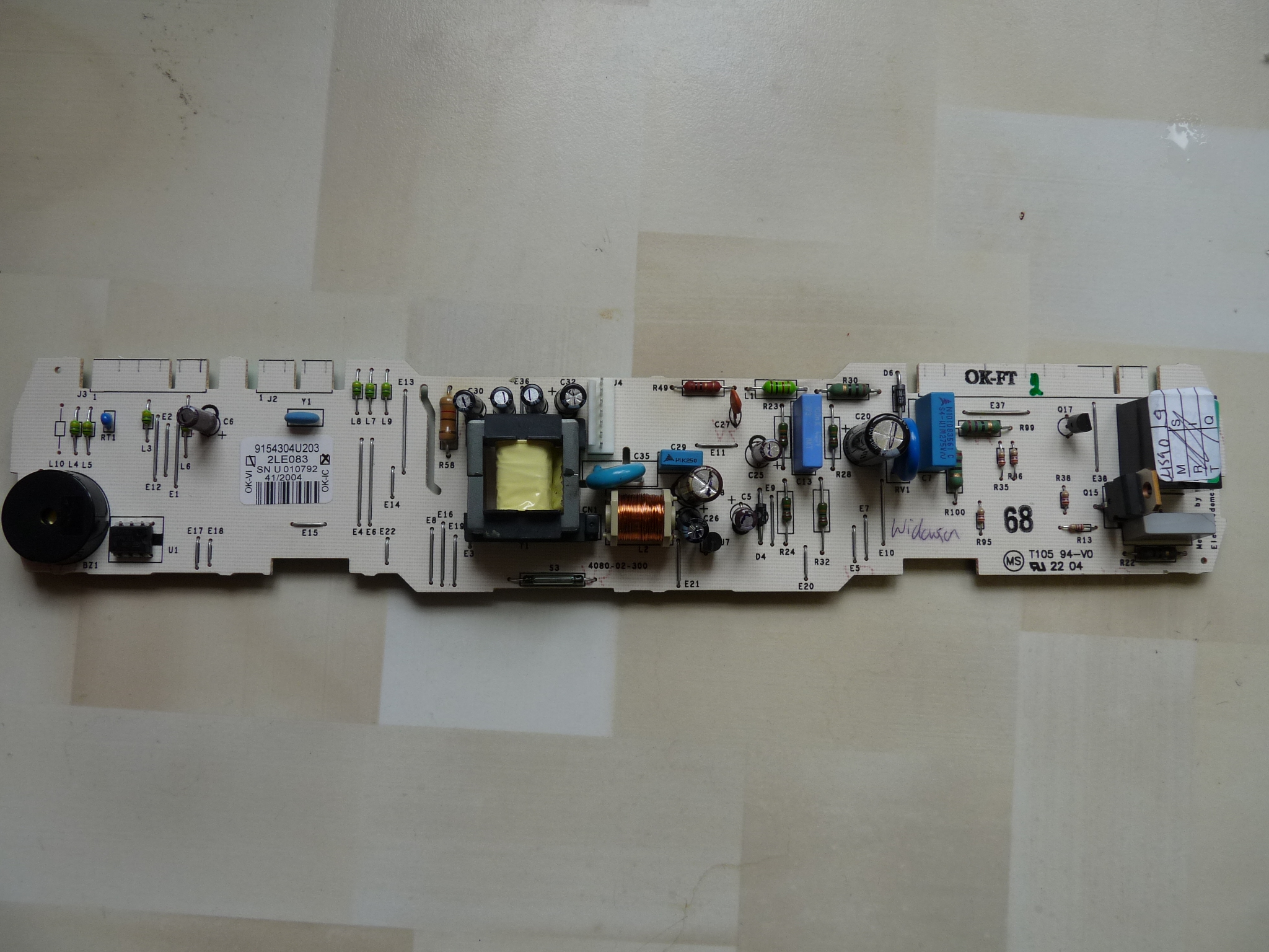

                Re: Hotpoint FFA47X Fridge Freezer

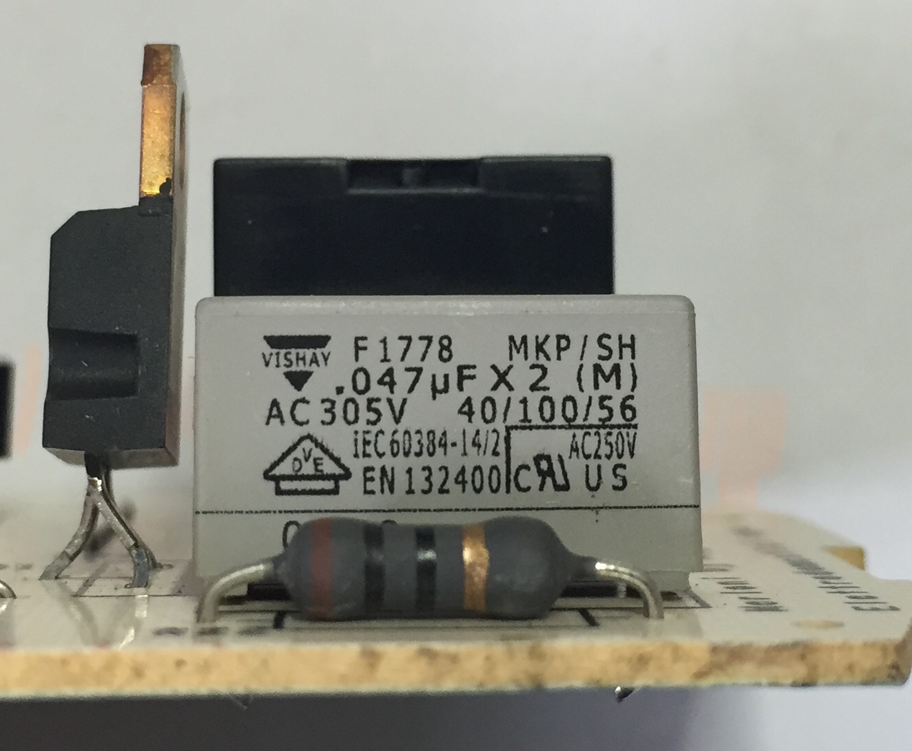

                The power supply circuits uses capacitive power supply (the blue rectangular cap is used for dropping the Voltage to lower value). The power supply is half-wave rectifying, and C20 looks to be the main filter cap, what is the Voltage rating of that cap. RV1 is the MOV.
                Check R30, R100. Also check the capacitance of those large blue rectangular caps.
                What is the rating of that relay with white paper on top? the coil Voltage will give you some idea of what the power supply Voltage should be.
                There is display circuit board that is attached to this board, right?
                          Which blue rectangular cap - C7?
                          I will check all and report back sometime over the weekend.

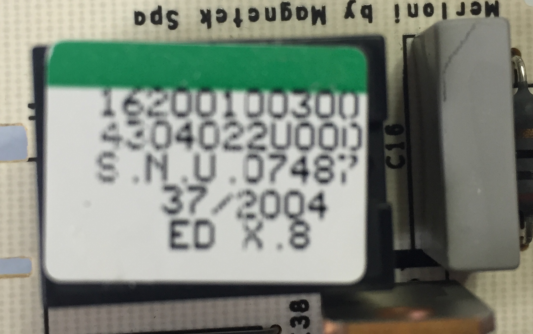

                          Hopefully, it will state this on it when I remove the paper. Otherwise I'd have no clue how to do that but can hopefully research that online.
                                All measurements are taken in circuit (with components on board) at this point in time as the fridge needs to be kept live and I need to develop my desoldering skills. Any good videos out there? Watched a few on YouTube last night but they were fairly varied in quality.
                                I am currently using a Peak Atlas ESR70 to provide measurements in circuit.
                                C7 markings:
                                Top
                                N101083561 C
                                S4-X1M275V~ (Unsure about X though could be letter W)
                                Side
                                B81130 X2 MKP/SH
                                40/100/21/B
                                ENEC logo with a number 10 by side of it then RL in capitals written backwards with 250V~ under it and then cRL written backwards with 250V~ under it next to that

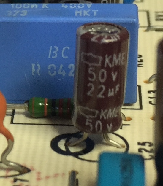

                                C13 markings:
                                Top
                                100n K 400V
                                373 MKT
                                Side
                                BC
                                R 0422

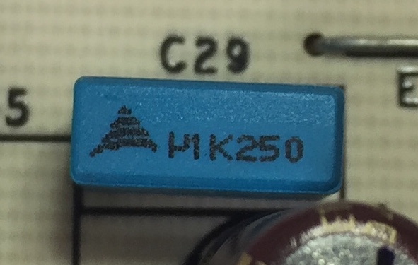

                                C29 markings:
                                Top
                                MK250
                                Cannot see any other markings on this cap.
                                C7 - Open Circuit or low resistance
                                C13 - 9.84uF ESR 2.3 Ohms
                                C20 - 400V 10uF (measures 9.53uF and ESR 4.4 Ohms)
                                RV1 - In-Circuit/Leaky ESR = 0.00
                                R30 - 10 Ohms
                                R100 - 27 Ohms

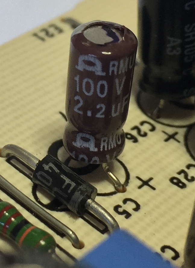

                                Rating
                                C5 - Unknown RMU 100V 2.2uF SH105degC A3 11/03
                                Measures
                                88.22uF ESR 0.78 Ohms
                                Rating
                                C25 - Unknown KME 50V 22uF (M)105degC
                                Measures 24.6uF ESR 1.76 Ohms

                                    These are most likely bad, such high ESR is too high even for GP caps of that capacity (they yrae not so bad as JingHai caps so they should not have over 40 ohms; yet here you would nicely use ESR Micro which has range up to 200 ohms):
                                    C30 - 0.92uF ESR >40 Ohms
                                    C31 - 1.12uF ESR >40 Ohms
                                    C33 - 7.9uF ESR >40 Ohms
                                    These seem to be in parallel, if you have multimetr you can set it to diode/continuity tester (beeper) and check both appropriate sides, they should beep:
