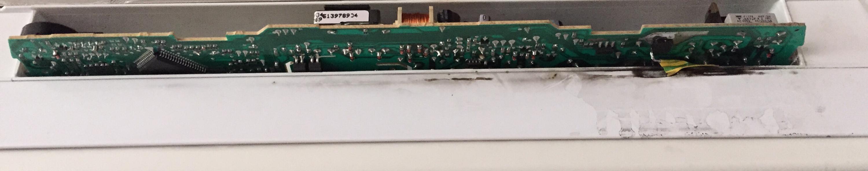

Hotpoint FFA47X Fridge Freezer
  • electro-raf
    replied
    Re: Hotpoint FFA47X Fridge Freezer
    Hi I am new on this forrum name is raf - I have this model FFa47x fridge freezer and need to know how to get access to the main pcb and where its located. I think it maybe at the top of the front door. Please if anyone can help
    thnaks
    Leave a comment:
    replied
    Re: Hotpoint FFA47X Fridge Freezer
    So the bottom line is the board connector's pads are getting the AC based on your report but the switching power supply is not working at this point.
    Leave a comment:
  • Rhothgar
    replied
    Re: Hotpoint FFA47X Fridge Freezer
    Underside of circuit board when installed
    Leave a comment:
  • Rhothgar
    replied
    Re: Hotpoint FFA47X Fridge Freezer
    Yes the fuse in the plug is fine.
    The freezer still gets cold but to -30 deg C And I did measure 240V across two pads a few posts back. Checked it anyway and it is OK.
    EEPROM on far left next to buzzer on top of board. GND and Vcc pins face out.
    Uploaded photo of u/s board too so you can see roughly how much of the board sticks out.
    Leave a comment:
    replied
    Re: Hotpoint FFA47X Fridge Freezer
    Did the fuse in the AC plug blow?
    BTW, you said you cannot get the probe to the board to check the continuity between pin 7 and pin 12 against the AC plug so how did you manage to measure the dc Voltage on the EEPROM?
    BTW, the MOV is connected between the LINE and NEUTRAL so you should be able to solder the wires to the MOVE legs to allow you to take the measurement.
    Last edited by budm; 07-11-2015, 09:58 AM.
    Leave a comment:
    replied
    Re: Hotpoint FFA47X Fridge Freezer
    the display should work even without the new triacs, although it may be related to the one that fits from the other side of the board.
    but that is not the problem,
    because you have no power to the logic chips (eeprom & cpu)
    Leave a comment:
  • Rhothgar
    replied
    Re: Hotpoint FFA47X Fridge Freezer
    Pad 7 shows continuity to the big solder reservoir pad at the rear of the triac where I soldered the jump wire to so I would be able to access that. Pad 2 continuity stops at triac leg obviously because, I assume, it's not powered and therefore not switched until power is applied.
    Leave a comment:
  • Rhothgar
    replied
    Re: Hotpoint FFA47X Fridge Freezer
    Originally posted by budm
    All he has to do is to check the fuse in the plug and also check the resistance between the L blade to the board pad 7, and N blade to the board pad 12, they should be <1 Ohm.
    Sadly, it's impossible to get in with my probes!
    I know it won't rule out a problem with the new truacs I have soldered in but from this photo is someone able to tell me if pad 2 traces to any of the big solder reservoirs once triacs are active ( or do the fans cause them to become live when they get a signal )?
    I'm obviously thinking how I can check power to the nearest component connected to any trace that needs checking given that the U/s of PCB is tight to fridge but protrudes slightly.
    Last edited by Rhothgar; 07-11-2015, 02:41 AM.
    Leave a comment:
  • Rhothgar
    replied
    Re: Hotpoint FFA47X Fridge Freezer
    Originally posted by budm
    The L and N are based on OP marking (you see the black L, N markers) which I believe the OP got that from the wiring digram.
    But after looking at the wiring diagram:
    https://www.badcaps.net/forum/showth...t=46668&page=3
    I believe the OP had it wrong, pad 7 is L. so the L and N in my drawing is reversed.
    I'm not qualified to have an opinion. Take a look at post 183. I was beginning to think they were wrong.
    I had no idea what those numbers were for on that diagram but how do you? There are 11 pads in that area of the PCB so how can we be sure?
    I wish I could strip the casing back!
    Last edited by Rhothgar; 07-11-2015, 02:07 AM.
    Leave a comment:
    replied
    Re: Hotpoint FFA47X Fridge Freezer
    All he has to do is to check the fuse in the plug and also check the resistance between the L blade to the board pad 7, and N blade to the board pad 12, they should be <1 Ohm.
    Leave a comment:
    replied
    Re: Hotpoint FFA47X Fridge Freezer
    that dont mean much given u.k. power cords have a fuse in the plug, and he dead shorted the board so could have burned a connection someplace.
    Leave a comment:
    replied
    Re: Hotpoint FFA47X Fridge Freezer
    Looking at service manual page 32 connection diagram, pin 7 is LINE (BROWN), pin 12 is N (BLUE 2) which are connected to the AC power cord, it does not show any fuse in line for protection.
    Leave a comment:
    replied
    Re: Hotpoint FFA47X Fridge Freezer
    right now, i just want to know if AC is reaching the board!
    Leave a comment:
    replied
    Re: Hotpoint FFA47X Fridge Freezer
    The L and N are based on OP marking (you see the black L, N markers) which I believe the OP got that from the wiring digram.
    But after looking at the wiring diagram:
    https://www.badcaps.net/forum/showth...t=46668&page=3
    I believe the OP had it wrong, pad 7 is L. so the L and N in my drawing is reversed.
    Last edited by budm; 07-10-2015, 05:45 PM.
    Leave a comment:
  • keeney123
    replied
    Re: Hotpoint FFA47X Fridge Freezer
    There seems to be a disagreement between Stj and BudM display of what is neutral and line. These things are important if you also have a ground. This is why I ask you does your electrical plug have a ground connector and does your receptacle have a ground connector?
    Leave a comment:
    replied
    Re: Hotpoint FFA47X Fridge Freezer
    https://www.badcaps.net/forum/showpo...7&postcount=51
    The board has more than one power supplies, one is isolated switching power supply which is the one that supplies the Voltage for the EEPROM, other is non-islolated.
    Leave a comment:
    replied
    Re: Hotpoint FFA47X Fridge Freezer
    400v radial electrolytic should meter about 345vdc across the pins.
    Leave a comment:
  • Rhothgar
    replied
    Re: Hotpoint FFA47X Fridge Freezer
    Originally posted by budm
    The primary DC circuit GND ref for measuring the DCV in the primary will be the negative leg of the main filter cap.
    Is that the 400V radial cap or one of the Epcos caps?
    Leave a comment:
    replied
    Re: Hotpoint FFA47X Fridge Freezer
    The primary DC circuit GND ref for measuring the DCV in the primary will be the negative leg of the main filter cap.
    Leave a comment:
    replied
    Re: Hotpoint FFA47X Fridge Freezer
    THIS should help.
    Leave a comment:
  • CG2
    Liebherr Fridge Freezer KGT 3456 not working
    by CG2
    To be a bit more specific, I've got a 20-ish year old Liebherr that has just stopped working. This was quite a sophisticated beast for its time. It's a twin compressor model, and you set the desired temperatures of the fridge and freezer parts from a couple of little control panels above the door. It displays the actual temps on some eight segment displays there, flashing if it's working to get to where you want it. There's a control board with a microprocessor on it that read the temperature from a couple of sensors, switches the compressors on as necessary, and runs the display. There's also...
    01-25-2023, 02:12 PM
  • mikey5791
    Help repair Panasonic fridge not cooling
    by mikey5791
    Hi all forum members,
    Few days ago, i might have forgotten to close my home fridge freezer door completely. The next day, the ice cubes and frozen meat almost melted halfway and the freezer doesn't feel cool. I shut it off, wipe dry and let it air dry for one whole day. The next day i switched on the fridge, the compressor run for a second and it shuts off(no vibration and no sound at all) only the internal freezer compartment fan is running but is not cooling even i switched on a full day.
    After shut off, i dismantle the rear water pan holder and reached to the compressor wiring....
    07-16-2025, 02:01 AM
  • tmcw
    Fridge - Gram
    by tmcw
    Have this fridge, laboratory grade unit, not working fully.
    It's designed with a chilling unit at the top, on the inside, and a fan just below that. When the door is closed, the fan blows the cold air down through the fridge, and when the door opens, the fan switches off, presumably so that it doesn't blow all the cold air out.
    The fan isn't switching on, so in addition to not having uniform cold throughout the fridge, the chilling tubes tend to ice up. I took the lid off the top, electronics are in the lid, and when the door is opened and closed, I can hear the relevant...
    10-10-2023, 05:00 AM
  • unimatrix93
    Replacement transformer for Samsung fridge
    by unimatrix93
    Dear forum
    My Samsung fridge died from a fault on the mainline and the transformer (https://www.hqelektronika.hu/hu/halo...-w8-da2600009k) died.
    No voltage on the secondary, measuring resistance shows open circuit. I concluded a blown fuse which is deep inside the transformer, I don't think I can disassemble it to replace the fuse.
    The second problem is that I cannot find an original replacement part anywhere or even If I do it's pretty expensive.
    My question is: Can I replace this transformer with a generic 230V to 17V one? The output has 4...
    07-14-2025, 02:16 AM
  • lapfix
    Dell latitude 5320 South peak 13 not power on.
    by lapfix
    Hello friends
    Got this laptop dell 5320 not power on , just a fast and a dim blink amber light at the power on led indicator.
    motherboard south peak 13 mb 213252-1
    i'm using schema and Bvd similair to this motherboard. https://www.badcaps.net/forum/troubl...-latitude-5320
    i don't have a type-c meter for the moment , so i m taking the voltage using his original charger.
    As i undestand from many topic here ,...
    04-29-2025, 06:22 AM
