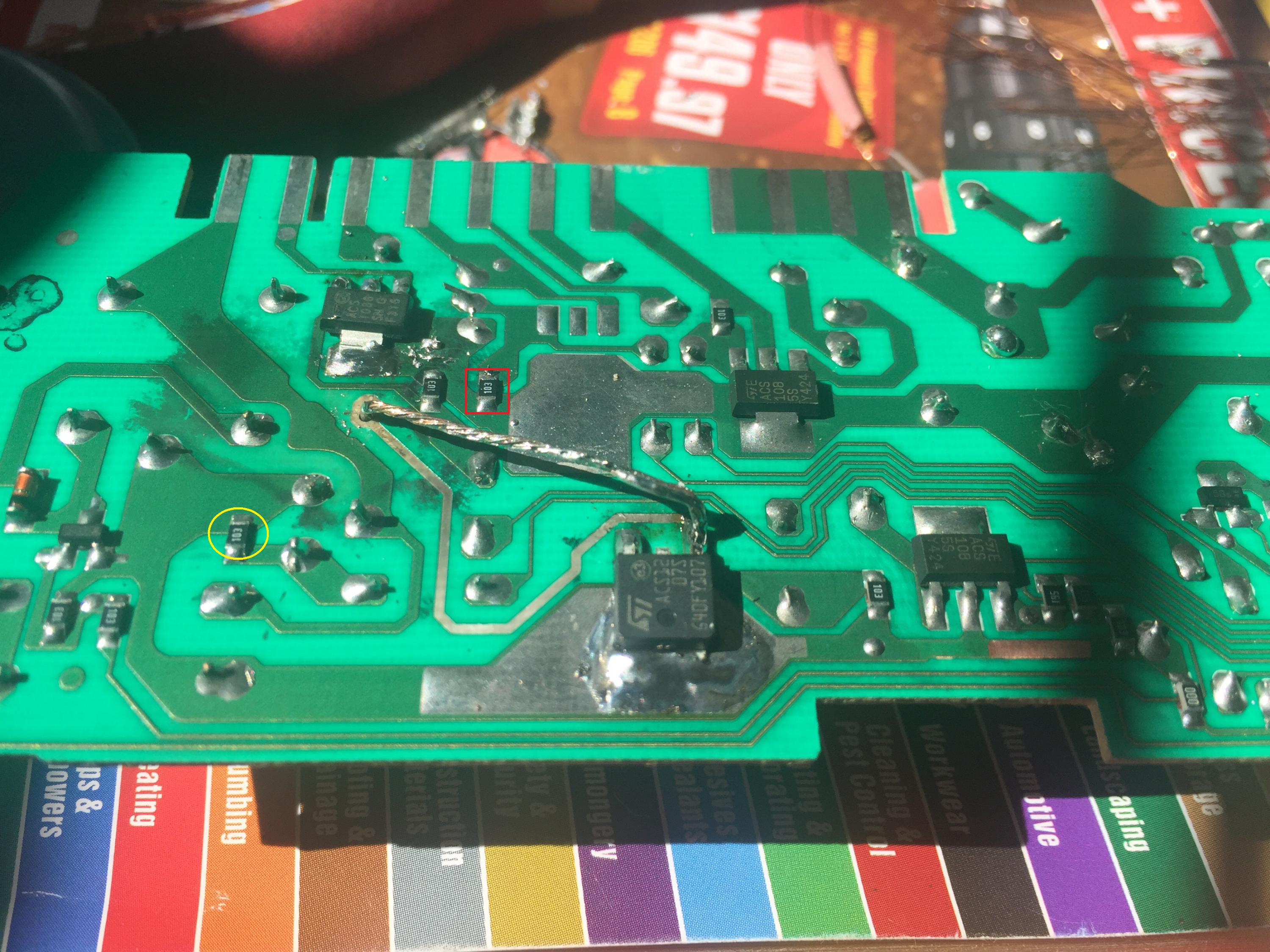

        Gutted.
        Have done the triacs and a tinned six strand wire and the display is still dead!
        Do I spend more time on it or buy a new fridge? Problem is it's a big fridge and it would be top end of £700 for same storage size and...
        I hate being defeated!
        Addition Information: I think the triacs are properly soldered in. I found another capacitor which had blown obviously during the voltage surge which blew the triacs and I have found some resistors which although I haven't checked resistance bands yet they appear not to be giving ANY reading in circuit whilst others are. Obviously need to work out their rating, desolder one leg and check them again but it seems suspect with no reading whatsoever.

          take a look at that pic, clean up those solder splat's - one looks like it's shorting something.
          and put some plastic under the jumper so it wont arc to the stuff under it.
          after that, meter all the supface mount resistors - the 3rd digit is the multiplier.
          so 103 = 10k

            Thank you.
            I've taken a look through a 10x jewellers loupe and solder splats look OK and I have metered for continuity across tracks that should be connected.
            I've tested the majority of 103 SMT Resistors and the two marked in the edited photo appear faulty or blown. Yellow circle reads 0.00. Red square one reads 1.000 on a 20K scale.
            I have a Precision Gold PG017 DMM and it measure weirdly I think. When on 20K scale, I get 10.00 for a 103 SMT.
            Some other SMT Resistors further down read either 561 or 195. It's impossible to tell but they are reading 0.28 on the 20K scale so presumably 280
            Also, how would I know whether these resistors are 1206 or 0603 or otherwise please?
            Last edited by Rhothgar; 06-30-2015, 02:54 PM. Reason: Changed word Capacitor to Resistor for SMT

              #106
              Re: Hotpoint FFA47X Fridge Freezer
              Originally posted by Rhothgar
              Does that mean they are DC or AC when they have the white strip?
              That'll be the two lines of copper dots then on the top right of the meter!
              The white strip with the - on it is the negative side which would mean it is a DC Cap. The AC caps are not mark with polarity as the voltage is changing back an forth . Sorry I did not see the other pages.

                The first two numbers are just that numbers and the other is how many zeros are after it. So 56 with one zero after is 560. I am looking at this bare wire on your board is that touching any other connection that it is not suppose to? Also, the resistors have to have one leg desoldered and lifted to get the correct reading.

                  #108
                  Thanks for your input.
                  My point was I am unsure whether it is 561 or 195. It is impossible to tell.
                  The bare wire is not touching any component. I wanted to use insulated wire but was advised to tin bare wire instead.
                  It's surely impossible to desolder one leg of an SMT Resistor? The others which are soldered are nearly bang on. The lowest reading I obtained was 9940 Ohm on a 103

                    #109
                    That's almost 10k so it's OK. There is some tolerance, +-1 or +-5 %.

                        #111
                        That's OK again. For those which read something else check if there is not something in parallel with that, otherwise desolder and check out of circuit. It is not easy but possible, just use enough solder flux and quickly heat one and other end all over again till it gets loose. Sometimes there is glue beneath so you need some other tool to help it.

                          #112
                          as per post 105 Also, how would I know whether these resistors are 1206 or 0603 or otherwise please.
                          im not sure how you tell this either maybe behemot can advise us?

                            0603 = 1.6mm x .8mm
                            0805 = 2mm x 1.25mm
                            1206 = 3.2mm x 1.6mm

                                #115
                                You just need to lift the resistor enough to slide a thin piece of plastic between the board and the resistor lead. Also, a 1.9 MOhm resistor is not a common size I would expect it to be 560 ohms which is a common size. Sure way to tell is to desolder and measure. Also, did that track burn up where you replaced it with that bare wire?

                                  #116
                                  Thank you. It is reading 280 so I'll leave that for now as a 103 reading 0.00 is clearly not right.
                                  Yes. Like an idiot I used single core copper wire to jump across the evaporator defrost terminals thinking it need a signal to say something was plugged in! Vapourised the track and blew the triacs to smithereens.
                                  Before that, I got it working for a few days apart from the compressor was not kicking in.
                                  I bought a service information manual. Cost me £32 for 30 pages of dross which cannot be retained to Hotpoint because it is special order. To boot, it looks like a colour photocopy and contains no real useful information about diagnostics.
                                    So was the compressor not being told to kick in? or is the compressor bad? The refrigerator should have a defrost timer. This should be either mechanical or electrical. If it is mechanical then this is a common problem. They get stuck in defrost mode so the compressor will not kick in. If mechanical some times you can turn it manually until the compressor kicks on again.
                                      Compressor is fine as I spoke to a AC friend of mine and he said to check if the coils are warm and they are.
                                      The compressor wasn't working when I fixed the PCB so I'm not sure what that would indicate but once I blow the PCB to bits, the compressor started working but it doesn't switch off because it is not getting a signal through the PCB I guess.
                                      The reason for the post was to initial fix the display IIRC. I replaced 3 capacitors and BINGO! I did that but the unit was not working still.
                                      I've tested the fans. They are fine.
                                      It's just a case of whether I can get the PCB fired back up.
                                      I have ordered a variety of SMD creamic resistors and they are arriving today.
                                      Pretty sure my skills are not good enough to solder SMD at the moment. I think they are 0603. I suppose I could interchange them with 0805 where I have space (or does the whole base of the case on an SMD have to be soldered to the pad to get the correct resistance - I guess not).
                                      A couple of the resistors as per a few posts back are not reading so that is where we are currently with the resurrection project.
