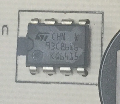

      Re: Hotpoint FFA47X Fridge Freezer
      WOW! Now I'm confused.
      I'll take some more detailed photos of the board. Part or whole? That is the question.
      I had a fright earlier and am concerned I am wasting my time and everyone else's.
      The wiring from the PCB to the display had broken through. I repaired this temporarily and bought a replacement.
      I need to check chronology of when that cable arrived. I'll explain why.
      I ordered the wrong cable and it didn't fit. It's s bit difficult to order the correct parts when you don't have a parts diagram. As of yesterday, I now have a parts diagram.
      I therefore needed to do a more permanent repair in the PCB to display cable.
      I plugged in the cable today and realised it was the wrong way around.
      The worry now is did I actually blow the display when the PCB exploded.
      I've got it plugged in now and the fans aren't working. Did I perhaps not Okug it in correctly before?
      When I say plugged in wrong I mean the colours at intermediate connector is wrong. Perhaps it makes no difference.
      If the triacs power the fans, and the fans aren't working, why?
      At what point do I throw the towel in and give up?

          what is the part number on the 8pin eeprom on the top of the board?

                      eeprom part number?
                      i need to get the pinout so we can check for the vcc supply.
                          thanks.
                          look at the datasheet, it shows the pin functions.
                          if you can safely do it, meter the voltage between VCC and GND
                          lets see if the chips are actually getting power!
                                Originally posted by stj
                                thanks.
                                Cool. OK. Tell me where a ground is on the board.
                                If I out my wellies on, am I right in saying I cannot get a shock providing I do not lean on fridge casing with another part of my body?
                                Board is high up so I'll need to stand on a chair (wooden by the way).
                                Presumably meter on 600VAC. Touch ground first when I know where it is then probe chips.
                                As I say if you can tell me where a suitable ground is then I'm good to go.
                                Also, need to be careful not to blow EEPROM as I obviously won't be able to reprogramme it!
                                  i would use ground on the chip its self says in the pdf just be really carefull probes dont slip just wait for someone else to confirm though.
                                    Indeed. I was thinking I could use GND on the chip but I don't want to blow this chip up. I've no idea if I can use that ground.
                                    Also looking at the data sheet this chip doesn't appear to match. The PDIP chip has a semi-circular indent in one edge but my chip has a semi-circular indent AND a circle indent too!
                                    Check ST website and found an M93C86W ( that's a 33 page manual so not sure if this matters. Same voltage range though).
                                          notches, circle in the corner etc are the same, just different makers using different markings.
                                          meter both pins on the chip, and set the meter to 10vdc
                                          i'm expecting (hoping) for either 3.3v or 5v
                                          you WONT get a shock from the chip even if you stuck your finger on it.
