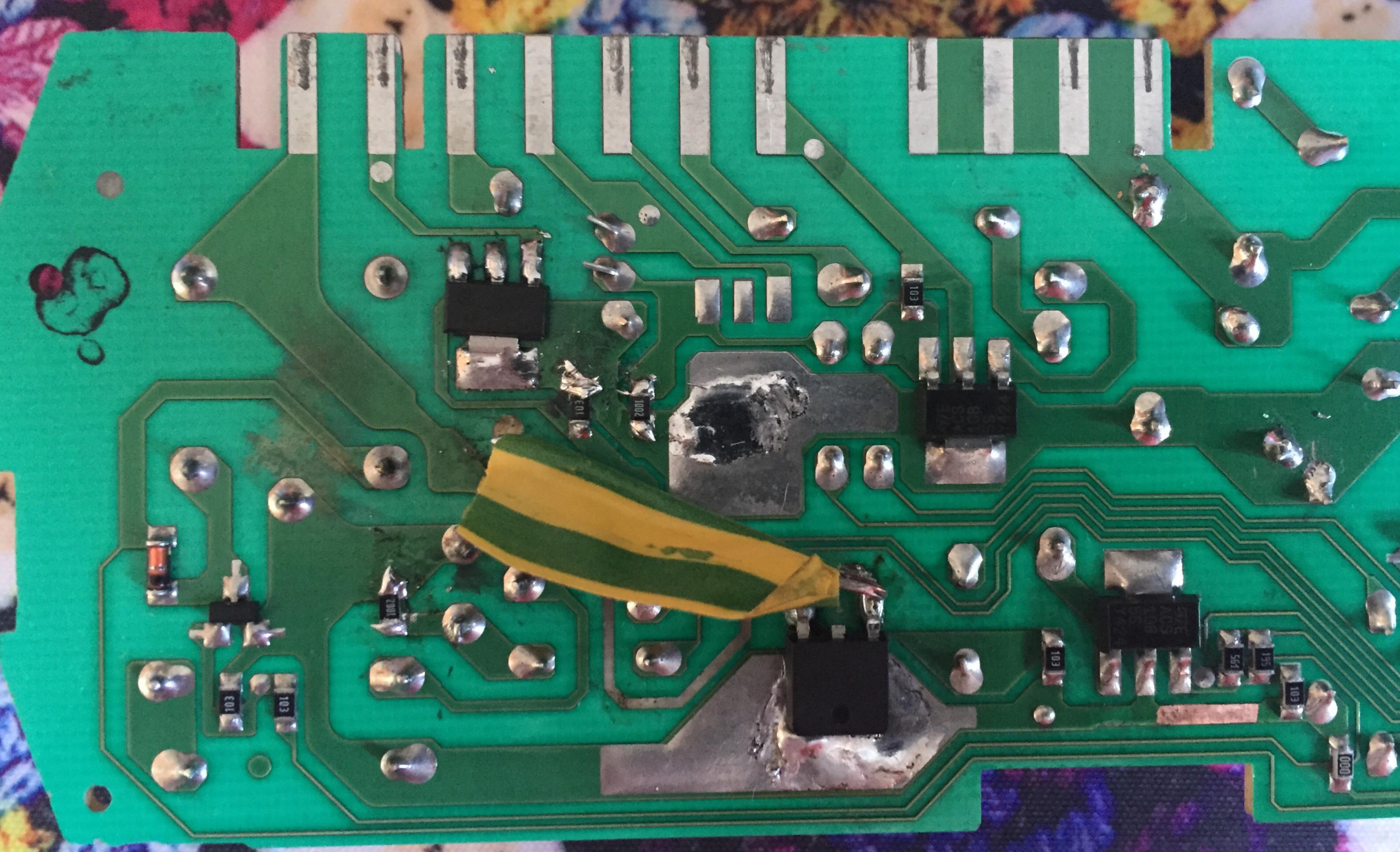

      #162
      Re: Hotpoint FFA47X Fridge Freezer
      Originally posted by stj
      notches, circle in the corner etc are the same, just different makers using different markings.
      meter both pins on the chip, and set the meter to 10vdc
      i'm expecting (hoping) for either 3.3v or 5v
      you WONT get a shock from the chip even if you stuck your finger on it.
      What about the triacs? Should I check them too? I know they are big voltage and AC I think?
        triacs - stay away from.
        the input and output are 230vac, but the control pin is 5v and if you short it - you blow the controller.

          #164
          I've got plenty spares for the triacs stj!!!
          The EEPROM is showing 0.231 volts in 20VDC scale and same on 2VDC scale so it looks like it is not switching the chip on.
          Do I need to take any readings from any other pins on the EEPROM or just the Vcc and GND?
            0.231VDC between VCC and the GND pin is not going to be enough to run the IC, you will need to trace out the VCC pin to see where it goes to, the VCC should be supplied by some kind of Voltage regulator somewhere on the board. You should also check the resistance between VCC pin and the GND pin to see if it shows low resistance or not.

              #166
              Right! When on continuity, it beeps momentarily and then stops. Remove proves, wait 10 seconds, do it again, short beep then stops.
              Turned scale up to max and then down onto 2K scale. It reads 1.958 so 1958 Ohms. Obviously this must mean a component is blown somewhere.
              Perhaps the chip itself?
              I saw a video on the net somewhere about the LeakSeeker 88 which said that, IIRC, the closer you get to the fault the higher the resistance becomes? Is is correct?
              I will try to trace back and do further readings some point this evening.

                #167
                right, i was kind of expecting that.
                now i need to go back to the foto's and see which pins the mains goes into the board through.
                because i think the board is not getting power.

                  #168
                  I think it is because it is warm after it's been left on.
                  Tell me how to safely probe the live and I will check them on the fridge with board out.
                  The earliest photos show N and L marked but you know me by now I am wary of just probing.
                  Another thing is and I will upload a photo in a minute, I am getting high resistance to certain pins in locale and then 10 on other side of some 103 resistors.
                  To me, it is looking like the resistance is in the chip and therefore I assume rightly or wrongly that the chip is damaged internally.
                  As always, I bow to tie greater knowledge and superiority.

                    #169
                    On the right of the photo is the 8 leads of the EEPROM.
                    The bottom left of the 8 pins is Vcc and bottom right is GND.
                    If I measure from Vcc to pin above I get 11000+ Ohms. No idea if this is right but logic says not.
                    When I measure to pass North of the 3 no. 103 resistors in top left of photo I get 10,000 Ohms i.e. the value of the resistor. When I measure to the pad nearest to the south of the middle 103 I get 1915 Ohms. That pad goes through the south of the 103 to its right (103 immediately to left of Vcc) and onto GND.
                    you can probably see it.
                    I hope the above makes sense.

                      #170
                      your supposed to be doing voltage not resistance.
                      set your meter to ac higher than 300 and check between the 4 blue wires in a row - any one will do, and the brown wire next to them.
                      that should be 230-240vac mains.

                          #172
                          Oh! Sorry. Sounds hopeful that 2000 Ohms is not unexpected.
                          This is where it would be useful if I had a variable voltage power supply!
                          I cannot see any wires because the female spades are in a plastic connector block behind he fridge top panel.
                          On the first photos I uploaded, the N and L were marked by a testing company so I would assume they are correct.
                          Being high voltage, one should never assume so to play safe I have a few questions.
                          1) if I am wearing rubber wellies, can you confirm that I cannot get a shock assuming no other part of me or clothing touches anything else that is earthed?
                          2) can I use a fridge hinge as earth or GND? Is it likely to be earthed?
                          3) is it safe to use any confirmed earth anywhere on the appliance or am I likely to do more damage somehow?
                          4) what would happen if I touch two lives with the probes?
                          I apologise if these are basic questions. Just want to be safe than sorry.

                              #174
                              mains earth and N should not be confused.
                              as for the boots - unless you step on the circuit i cant see much use for them.
                              that fridge must have fuses, and you shorted the power when you jumped the heater-wire.
                              I thought it prevented a live going to earth through me!
                              So if I probe a live wire with bare feet and no probe to neutral I would not get a shock? Surely I would.
                              I cannot see a way of removing any panels. There are screws but I don't think it's meant to be serviced.
                              It looks as though the case is built, wired, internals out in and then expanding foam to fill the voids between fridge compartment and metal casing.

                                      #178
                                      I tested the first 11 spades on the fridge.
                                      They relate to the photo uploaded.
                                      I assumed GND or Neutral was the far right trace at the top of the photo.
                                      The 7th trace in from the left is the only one that measured 240VAC.

                                          #180
                                          I was just worried about probing a live circuit and blowing something on the PCB again.
                                          I am trying to work out unsuccessfully but trying to learn as I go along which traces should have a live because I cannot see wiring in head panel.
                                          The big black rectangular component on the PCB marked J1 - the top left lead ( from last photo) on the u/s of PCB connects to trace 1 but when I meter trace 1 it's not getting 240VAC and I don't understand why.
                                          I've looked at legs on ACS108 data sheet and do not understand if COM is live or neutral.
                                          I'm trying to think logically about which side of PCB is live and which side is neutral.
                                          The company that marked board with L and N in marker pen seemed to indicTe that all 4 traces (7-11) were live but I'm not getting 240VAC in traces 8-11?
