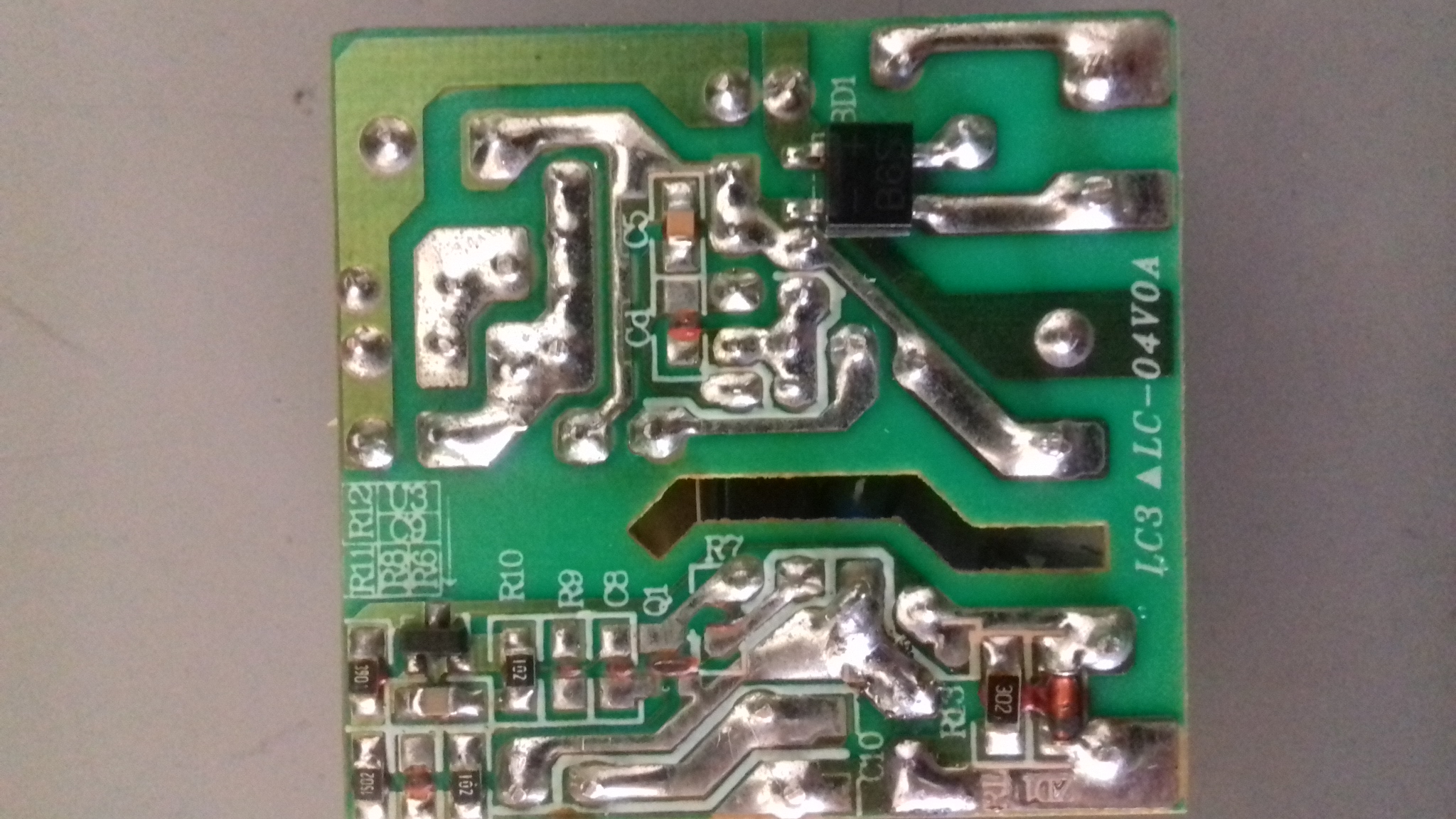

    Now, separate to the main electronics board, off a connector at the relay I can hear clicking, is a small 200-240VAC to 12VDC switching power supply, see photos. When the door is closed, on the input of the switching power supply, I have 230V, and when the door is open, it drops to zero. So far so good.

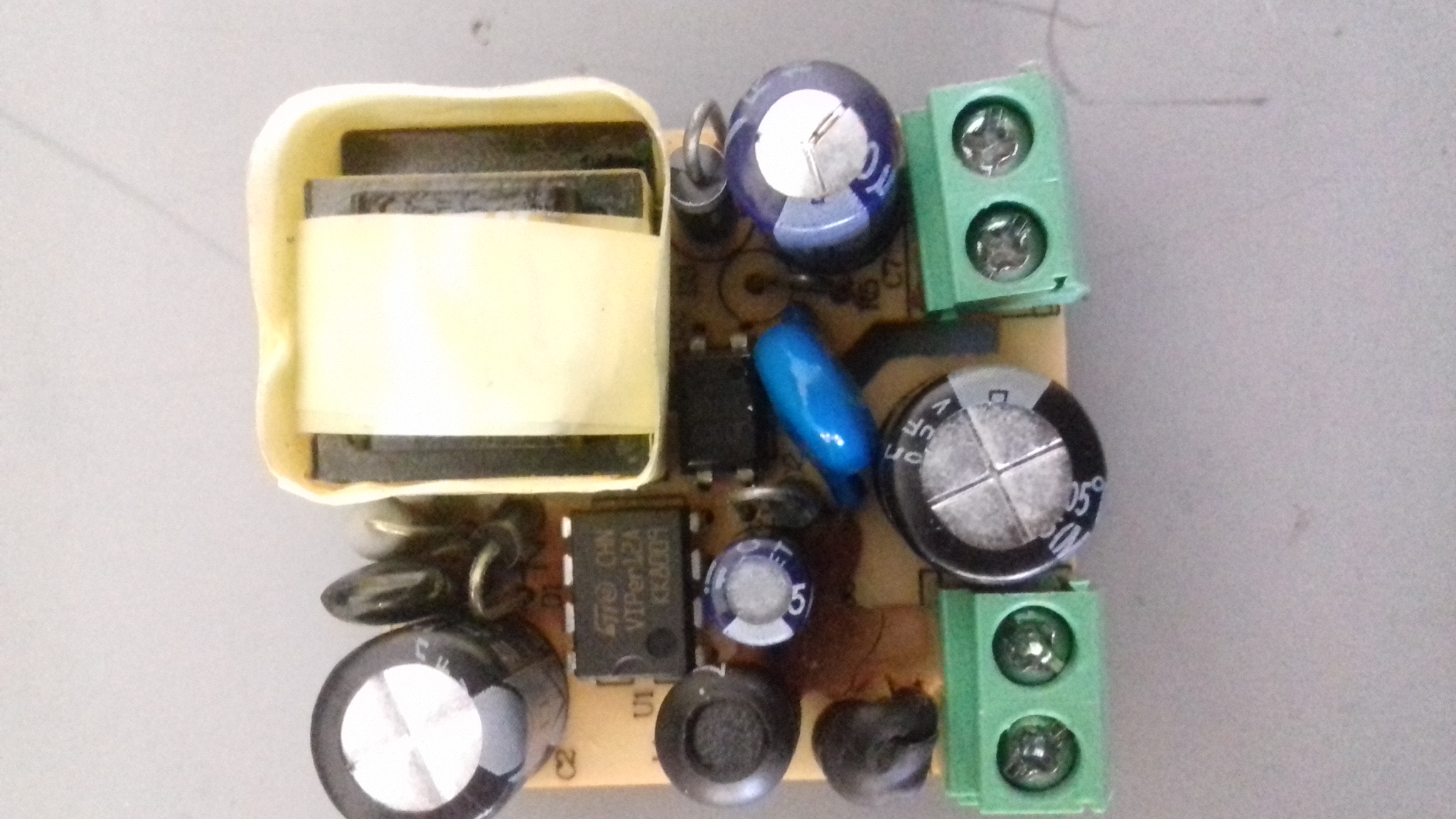

    On the DC output of the switching power supply, door open, I have zero volts, but when the door is closed, I'm only getting about 3V, so not enough to power the 12V fan downstream of this switching power supply.
    So, it looks like I've found the source of the problem. The 470uF/16V cap at the DC output is a bit bloated, I swapped it with an unbloated one from a donor board, but the output voltage actually dropped further.
    The board has a couple of chips, a VIPer12A, and an 817CN. Is there anything else on there worth testing further? There is some gunk on the input side, but I think it's just some brown glue for holding the components during manufacture.

    what make/series of cap did you fit?
    it needs to be a low esr type for a switching supply.
    also change the small one that starts up the chip

      Thanks for the reply.
      I don't have any good caps to hand, so was just scouring some old boards for parts, and the bloated cap near the DC out, the only 470/16V I could find was a janky green Lelon, and it was worse than the bloated one as far as the voltage out was.
      However, I took off the small one near the chip (22/50V, AISHI) and found an LXV on an old board, put it on, and the fan is now spinning when the door is closed!
      In the first few seconds of powering up the fridge, I could see that the fan was jerking, not getting past the initial "hump" to help it get spinning constantly, just moving a couple of millimeters, back and forth. I quickly put the multimeter on the DC out, and the voltage was low, jumping around between less than one volt, and a few volts, but then all of a sudden, after maybe 10 seconds, the fan started spinning.
      The voltage on the DC out is now changing between about 8.8 and 9.5 volts. That's just with the small 22/50v cap near the chip changed.
      Anyway, big improvement. I'll see about getting a good 470/16V cap for the bloated one, but any point in changing the others, is it likely to bring the output back up around 12V?

          For the time, money and hassle I would shotgun it - replace all 4 electrolytic capacitors.
          The reason is a fading cap can cause more damage, if it hasn't already- the VIPer12 might be damaged/weak. The 22uF cap is critical.

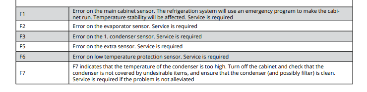

            Just to diverge a bit from the above problem, I've already gotten the next fridge, but it is giving an error F6 upon power-on, which when I look it up, I find that it might be...
            "Error on low temperature protection sensor. Service is required."
            I'm trying to figure out what this might relate to. The mainboard has 3 connectors that have 2-wire devices which I suspect are thermocouples, one goes to the radiator on the outside-back of the fridge, one goes to the tray under the chiller unit (near the fan), and the other one is stuffed into the fins/vanes of the chiller unit. I'm thinking the error might relate to the one stuffed into the fins of the chiller unit, as it's the one most likely to get coldest. Would that be right?

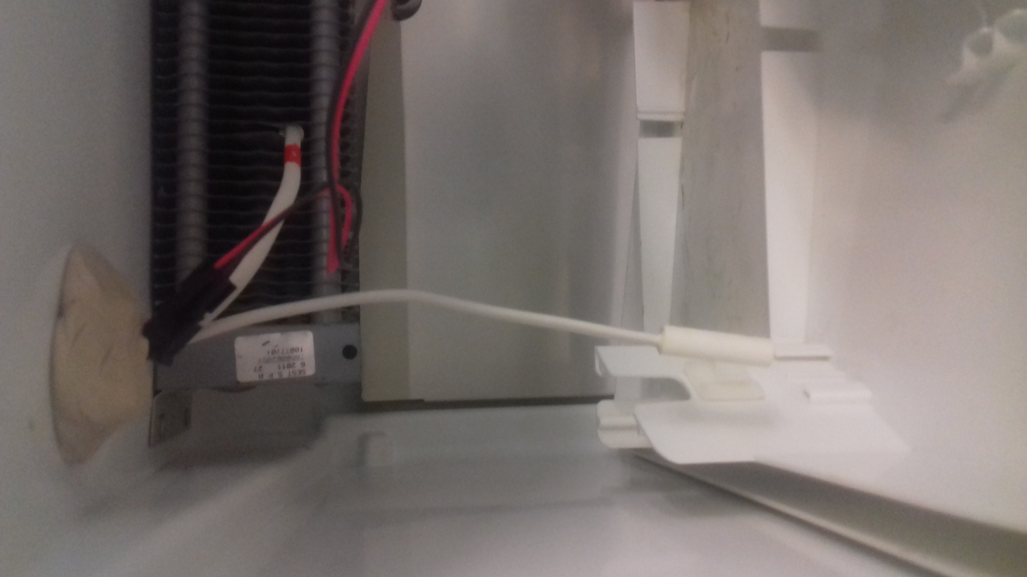

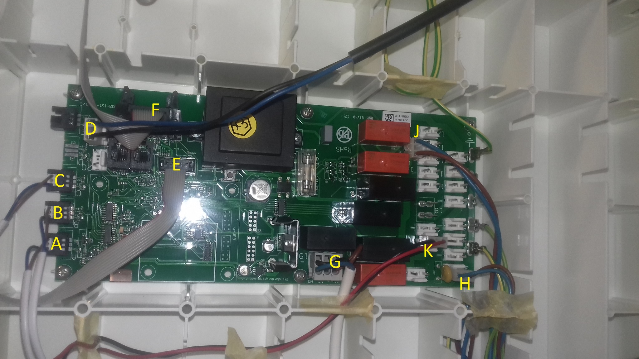

                    I've attached a couple of photos, one of the mainboard, and one of two of the sensors that are inside the unit, one stuffed into the chiller, the other rests in the tray below the chiller. In that photo, you can also see the wiring that goes to the fan, which is attached to the tray.
                    When I was talking about the connectors, I was referring to the physical connector on the mainboard that the 3 temperature sensors attach to, the one hanging is connected to A on the mainboard, the one stuffed into the chiller is connected to B, and C is connected to a sensor that is cable-tied to the radiator on the outside back of the fridge.
                    I've labelled a few other connectors on the board...
                    D is the connection to the magnetic door sensor.
                    E is a connector to an RS232 connector under the front panel.
                    F is the connector to the display/buttons on the front panel.
                    G is a connector for external stuff, it's unused.
                    H is mains power out to the compressor outside the fridge.
                    J is Mains power in.
                    K is 240V out to the switching power supply that goes to the fan.
                    When I disconnect A, B and C, I get additional errors on the display, F1, F2 and F3, and replacing them one by one, the errors disappear. But always still left with the F6 error. Swapping around the sensor connectors didn't change anything.
                    The resistance on the sensors are:
                    A 6.89 k Ohm
                    B 6.88 k Ohm
                    C 7.15 k Ohm
                    • redwire

                      There seems to be other (but electronic) sensors? Pics shows 5 sensors for the "RF". I would look at the remaining two.
                      The three sensors have the same thermistor inside, but each has different cable lengths and thus part numbers. It is a 5kΩ@25°C NTC, B=3984 if Vishay NTCACAP.
                      Beyond this, the controller might have scrambled settings and need to be reset back to defaults.

                          Some Gram refrigerator control boards can be programmed for the different options and I thought this board might be (wrongly) set for the model having the electronic LTP board option, so it is looking for something not there in your model.
                          The LTP board might be a dedicated board with ability to override the main controller, in case it gets stuck on. Some safety functions are done that way.
                          The pushbutton on the control board I would definitely try... push and hold see if it goes into TsT mode.
                          If another tech was in there, double check all connectors as well, they do leave a (new) mess sometimes.

                            One thing I did notice is that in my photo of the mainboard, I had the door switch connector connected to connector 21, whereas it's connected to 20 in the wiring diagrams, so I'll need to rectify that, but I will at least check in the first fridge I opened up, that it is connected to 20, as I didn't remove any connectors in that one, just the wiring to the switching power supply, and check all the other connectors, make sure they are all in the same place. It didn't seem to affect operation though, the chiller/compressor came on as normal, perhaps the extra connector there is for a fridge with 2 doors?
                            I did try the pushbutton (couldn't resist!), but all it does is switch power off completely to the board, and when you release it, power is restored.
                            Knowing what I know so far, I'm beginning to think our fridges don't have this LTP board, and that the settings got corrupted, or changed, so when I get back to it on Monday, I'll go to a working fridge, write down all the settings through them menus, and compare with the settings on the fridge with the F6 error.
