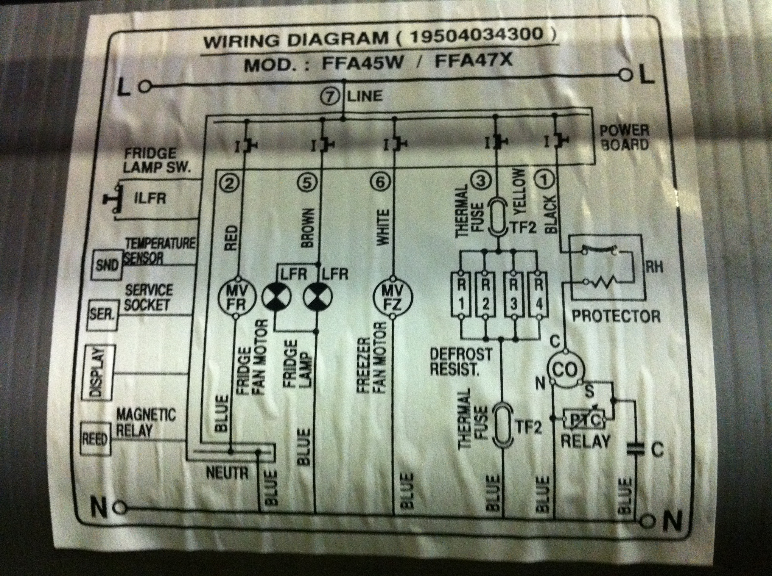

      Here is a wiring diagram from the back of the fridge.
      I've no idea what the relay looks like or where it is.

        There is one relay there, I can see, magnetic relay

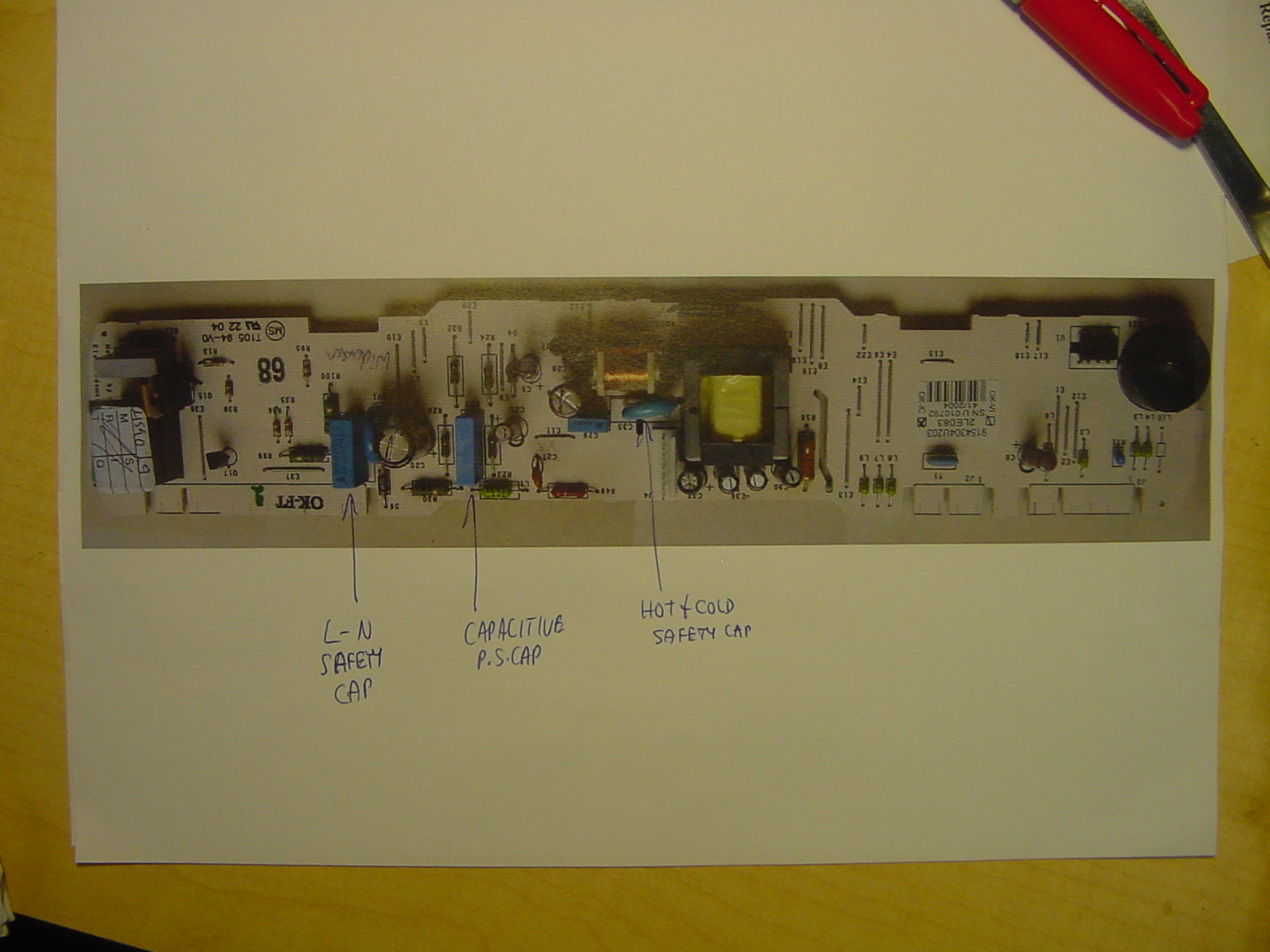

                I would not worry about the safety X/Y safety caps (Line and Neutral, Line and safety Ground, Neutral and safety Ground), they are for AC line noise filter.

                  Man you yourself identified there is capacitive linear supply in there and now you say you would not worry about the cap? ORLY? OFC these go bad, they are not meant for such usage, they loose capacity in time because of internal shorting and vaporizing the film and than the voltage behind them in series drops until it stops working. May be very well happening. This often happenes in wasching-machines or dish washers.

                      Yes, but one of those films caps is used for that, thats why I am surprised. May be the C7 in question, not sure, I have not studied it so close, I only see it is in tat area. If not it, than other one for sure.

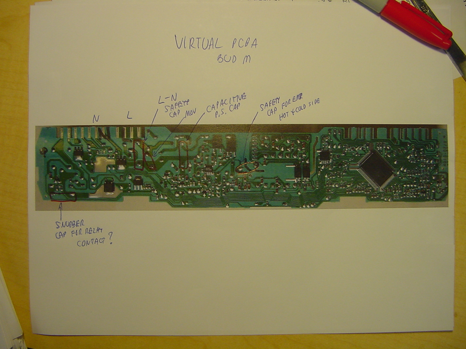

                        Virtual PCBA of what I can see so far.
                        This is not going to be easy to do the reverse engineering due to very fine lines and photos have to be super sharp.

                          #52
                          Re: Hotpoint FFA47X Fridge Freezer
                          Sooo it's the other one
                            Do you want me to email you some high definition photos directly?

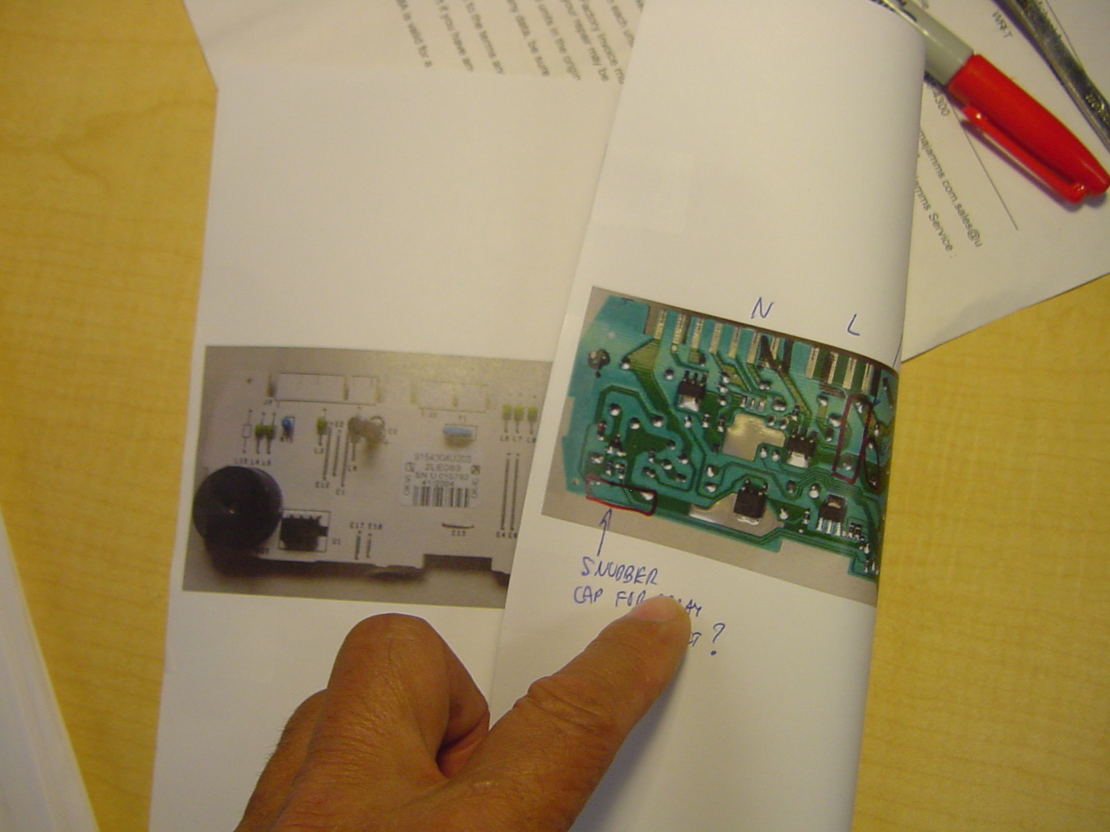

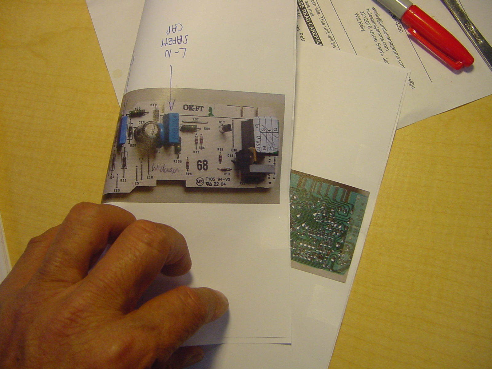

                                  Can you point out which one is C7?
                                  C13 small rectangular blue cap is for the Capacitive power supply.
                                  The one connected between Line and Neutral is for AC noise filtering, is that the one?
                                  https://www.badcaps.net/forum/showpo...7&postcount=51

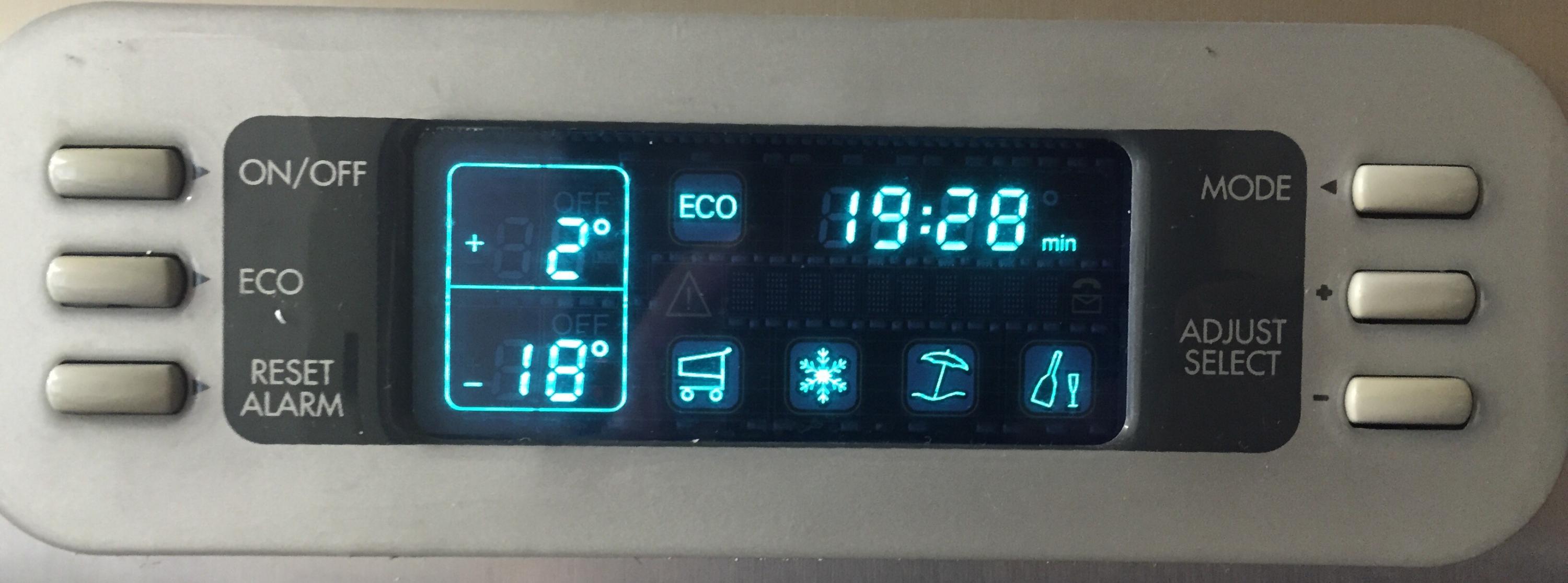

                                      Guys! Guys! Guys!
                                      I have repaired my first ever electronic item!
                                      I am 'over the moon' with joy.
                                      See attached photo.
                                      The fridge display is NOW working.
                                      I just bought a pack of mixed capacitors from Maplins for £9.99 as I was getting fed up with going through online catalogues for capacitors.
                                      I replaced the 3 Teapo ones with equally poor quality capacitors with only 85degC rating instead of 105 just as a test and IT WORKS!!!!
                                      I will now order in some high quality capacitors to change them with. I am guessing that these should last a year or two even with the lower temperature rating.
                                      Man I am SO happy and the missus will no longer have to close the downstairs door to muffle the incessant beeping!
                                      Thanks to all who held my hand through this journey.
