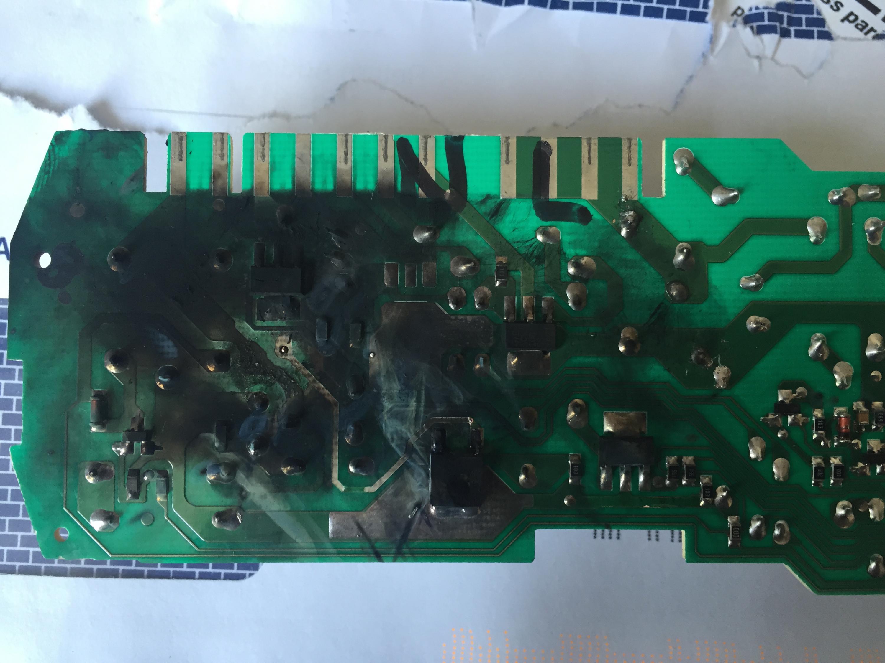

                      The fun continues.
                      Got the compressor working but I've blown something up! Hopefully a capacitor!
                      I thought I would test the fan and the defrost Resistor wire which is supposed to keep gutter clear.
                      I had no continuity sound in my DMM so I thought it would be a good idea to use a jumper wire in the defrost resistor terminal block in the back of the freezer.
                      Connected a wire (quite thick copper) and switched on.
                      Display came up! Compressor kicked in then BANG... Display now dead.
                      At least the compressor is still running!!!!
                      Problem now is whether to continue unplugging components and testing or leave alone and see if it freezes up.
                      I suppose with fan now working. The cold air is not going to transfer to fridge section.
                      • Rhothgar
                        • May 2015
                        • 109
                        • United Kingdom
                        #71
                        Re: Hotpoint FFA47X Fridge Freezer
                        Spot the difference!
                        Not sure if it is recoverable. It's blown holes in a couple of components and it was all going so well.

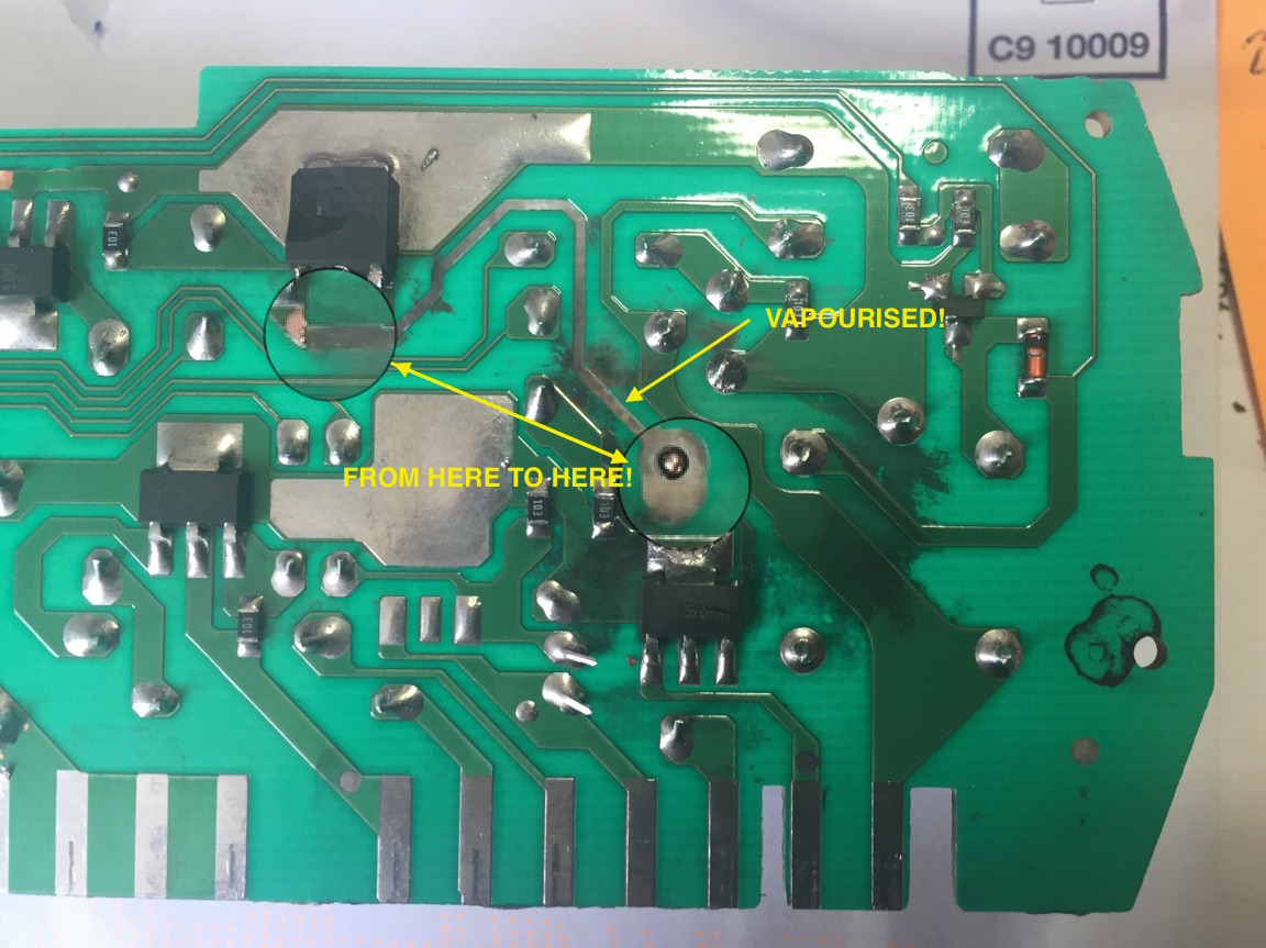

                        • Rhothgar
                          • May 2015
                          • 109
                          • United Kingdom
                          #72
                          It appears to have vaporised a copper track!
                          Can I rebuild the track using flux and solder or is that TOO ambitious or just plain stupid?
                            • 31249
                            #73
                            clean the soot and oxide off it and take another foto with better lighting.
                            it looks like you just blew a transistor/triac/fet and vaporised the track between it and the connector.
                            if that is the case, a new part and a jumpwire and your sorted.
                            • Rhothgar
                              • May 2015
                              • 109
                              • United Kingdom
                              #74
                              You beat me to it stj. You're a star and you're bang on the money.
                                • 31249
                                #75
                                btw, try to read what's written on that black part, and it goes through a resistor on the other side - R95.
                                check that isnt burned or anything.
                                tell me the colours of the stripes.

                                  #76
                                  R95 is red, lilac, brown, gold.
                                  The triac or whatever it is is blown to smithereens! Is it safe to assume that it will be the same as the other two on the board which are
                                  A logo (ST or similar) followed by YCN
                                  D2NC6
                                  0
                                  6HD421
                                  I don't think it is safe to assume.
                                  It start ST then
                                  ????????SL2
                                  ?????????7S
                                  ??????????2
                                  Other one next to N is:-
                                  ST E
                                  ACS
                                  108
                                  5S
                                  Y424
                                  That is cracked in half
                                  I've looked back at original pictures but impossible to read.
                                    • 31249
                                    #77
                                    r95 is 270 ohms - or it should be, check it.
                                    i suspect the bad part is a high commutation triac.
                                    so you have a split part too? damn.
                                    must have got spiked by an arc from the vapor.
                                      • 31249
                                      #78
                                      http://www.st.com/web/catalog/sense_.../SC477/PF62670
                                      that's one of them
                                        • 31249
                                        #79
                                        so this may be the other!
                                        http://www.st.com/web/catalog/sense_.../SC477/PF66524
