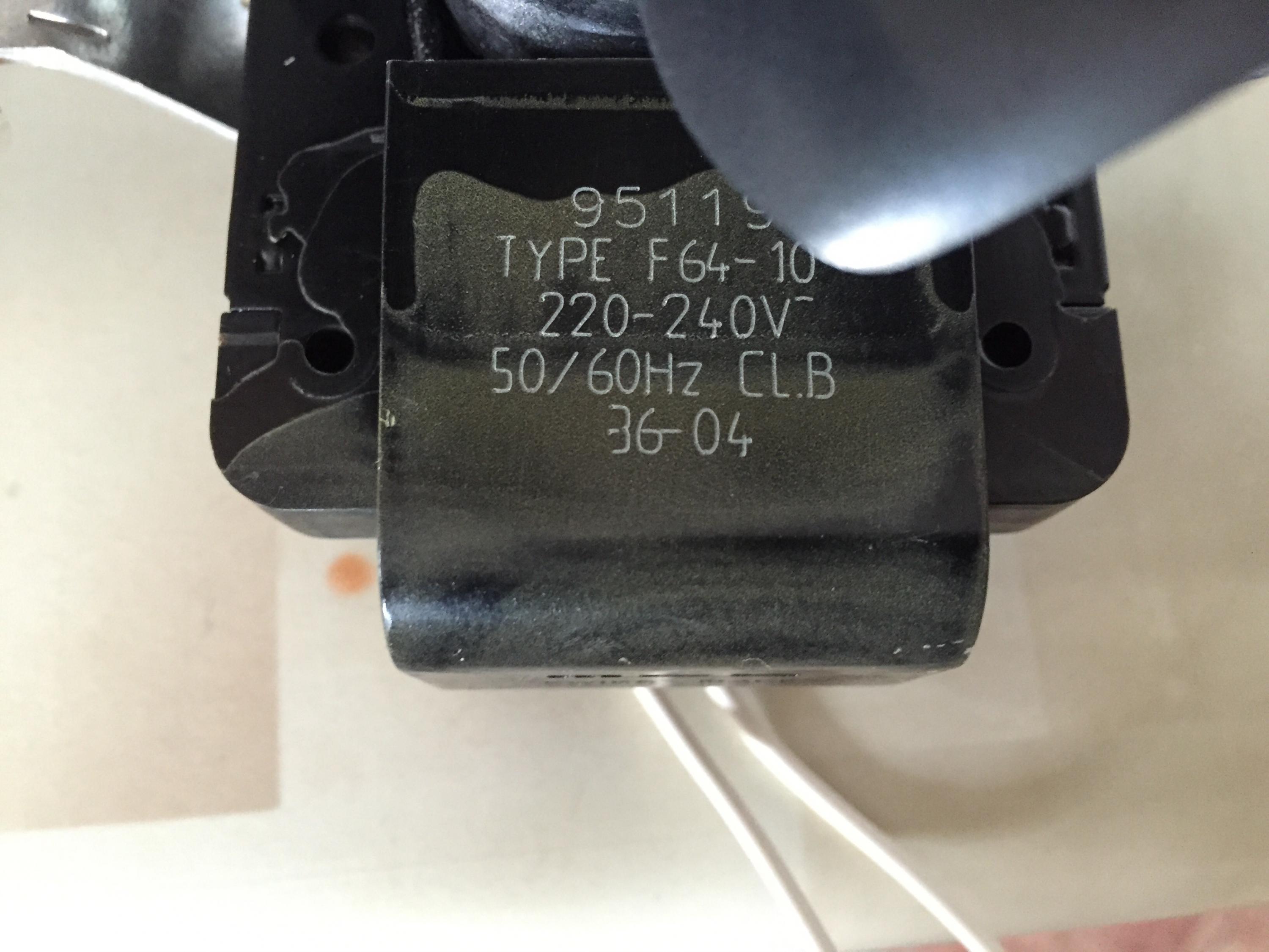

                      Quick question. I took one of the fans out last night and it was too hot to touch. I had switched the unit on earlier in the day as the evaporator is still working and the freezer gets cold.
                      The fan has two wires and is a type F64-10 with MES Swiss made on it.
                      Is it safe to simply connect it to a live and neutral to see if the fan spins and would it matter, for testing purposes, which way the live and neutral are?
                      Presumably it will just run backwards?

                        Re: Hotpoint FFA47X Fridge Freezer
                        have you got any foto's of the fan?
                        does the label state the voltage?
                          Sorry. It is 220-240V
                          I do have a photo.
                            you can hook it to the mains for a test - watch your fingers with mains fans as they have high-torque.
                              Noted. But does it matter which way? That is my concern. I cannot afford to buy a replacement if I damage it. Chances are it's burnt out anyway because it felt so hot but...
                                • 31254
                                #95
                                no polarity, it's an ac fan.
                                it will get hot, look at the design.
                                you have a constantly powered coil on a core that goes around the motor shaft.
                                i imagine it uses the flow from the fan across the coil to stop it melting down.
                                  Thanks for clarifying.
                                  Problem is you remember I vapourised the main board? Well. The fan isn't turning.
                                  Once I repair board this week, I can then start diagnosis of other components.
                                  Someone kindly suggest I use a jumper wire for bridging the points on the vapourised copper track.
                                  Will any copper wire do with insulation? Like a multi strand wire say 1.0mm diameter?
