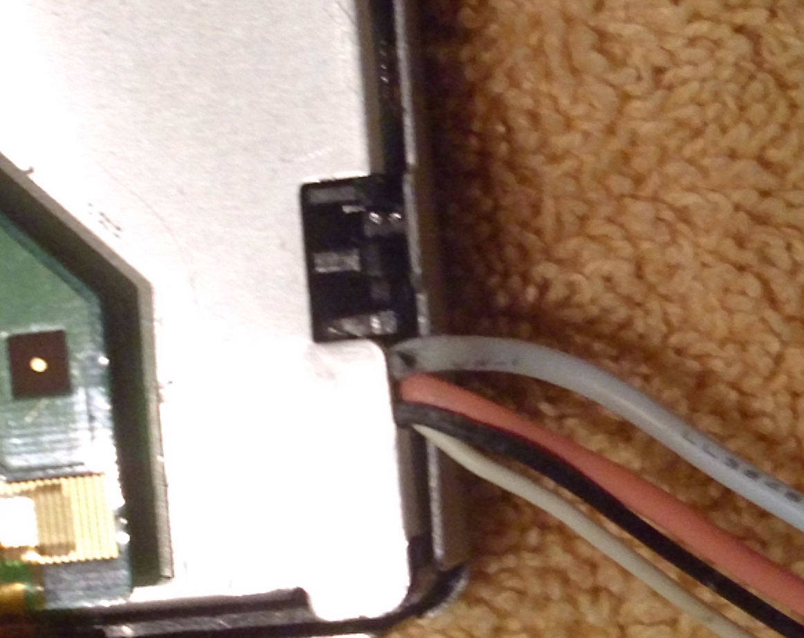

    ^ Well it think it might qualify for the thread now.
    This failure was fairly easy to notice, I guess I should have used a magnifying glass on the previous 3 attempts. Looking closer at the other CCFLs I installed there was a slight slit in the hot wire to the ccfl causing voltage to go to ground. It was very hard to see. The last one as you can see in the picture left some very good visual evidence on the blue wire, explains why it worked until everything was tightened down I need to get some small heat shrink tube and do a proper repair. Anyway I fixed it!
