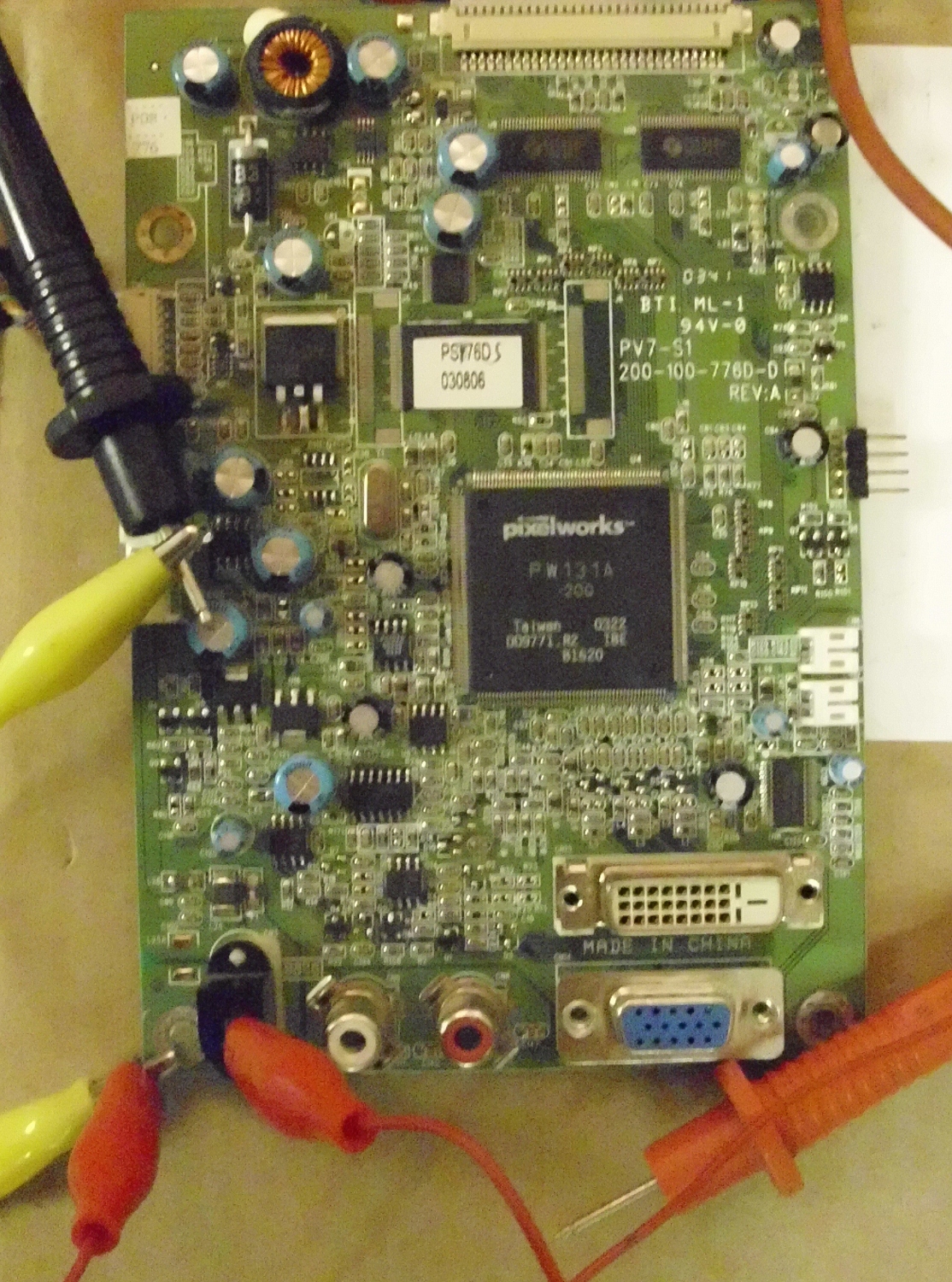

                                Here's a good one.I did not have the proper power supply for this monitor so I improvised.
                                You can see the hookup up, I couldn't find my black jumper, so don't be confused I used a red and yellow to connect the ground of the power supply and the DMM to a ground screw hole.
                                This monitor showed no signs of life so I decided to power it up and check some voltages.
                                I had 14.5 volts on both sides of the main fuse coming in to the board. And no matter where I touched on the voltage regulator legs I measured 14.5 volts.
                                I immediately thought a bad ground on the voltage regulators so I started checking from the ground pad of the capacitors to the voltage regulators ground leg. I really could not find any problem.
                                I was thinking if these voltage regulators are bad is this worth the time and money to fix.
                                Well after a good nights sleep and dreaming about it, I found that the screw hole I had hooked up the P/s and the voltmeter was insulated and not really a ground.
                                When I found the correct ground, the voltages started to make some sense. So maybe there is hope on reviving this monitor after all
