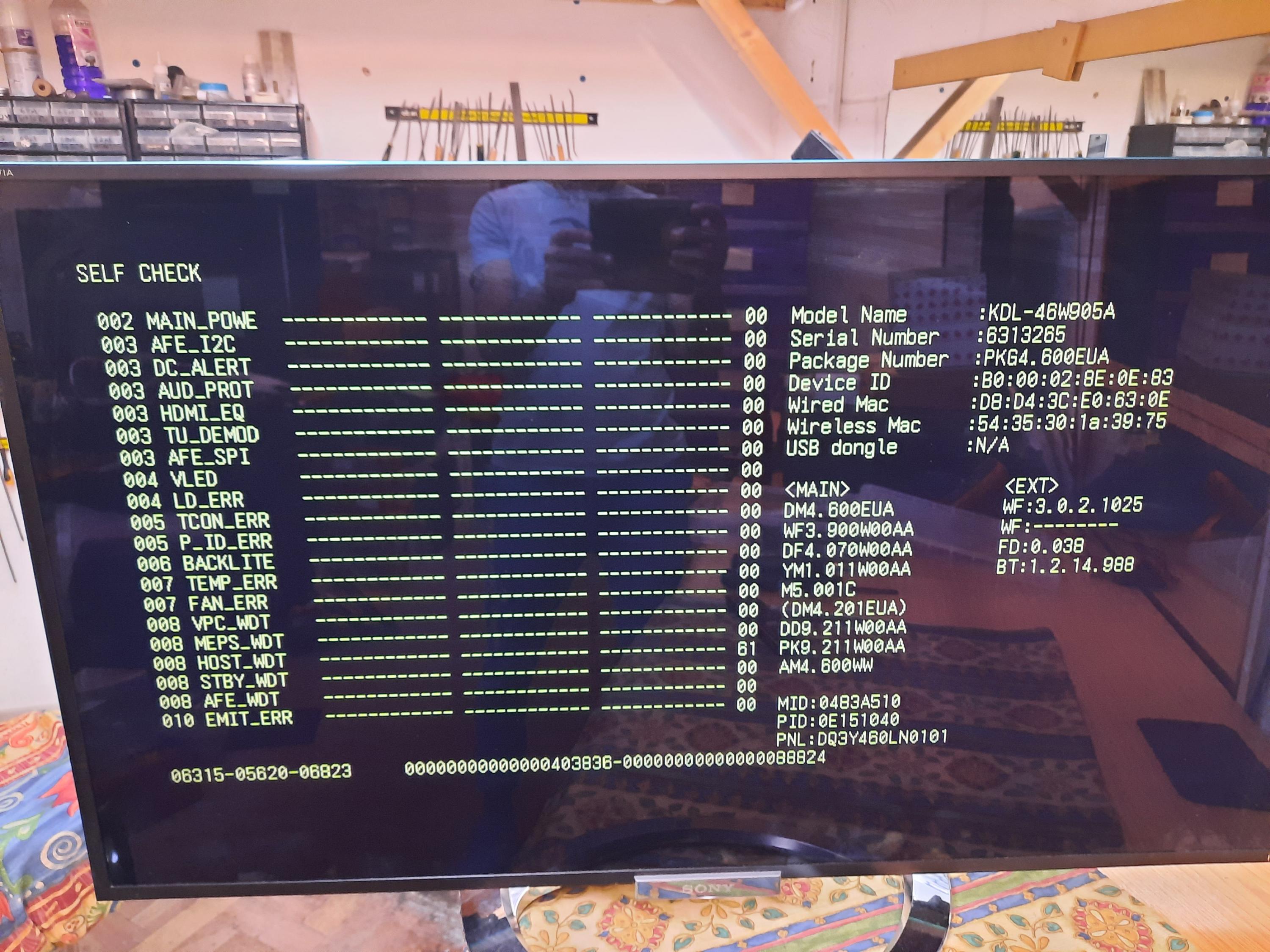

    Hi all
    Self check came up with 61 errors logged for HOST-WDT . Anyone know what this means ? Cleared by typing 80 whilst on self check page .
    Carried out a factory reset , which has resolved issue for now , but not sure long term .
    Current software PKG4.600EUA . Is the latest version .
    Has been to another engineer before me . Suspect they may have tried factory reset , as customer mentioned it lasted 2 weeks before rebooting again .
    She started noticing issues after connecting Chrome cast , unless that's pure coincidence .
    Possibly some sort of conflict ?

    Re: KDL46W905A , randomly rebooting . Latest upgrade & advice please.
    seemed like some kind of a watchdog thing, maybe this is similar: https://microchipdeveloper.com/8bit:wdt
      Thanks very much , will check it out .
