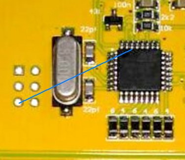

                                    #157
                                    Re: ESR meter upgrades
                                    can you link the video?
                                    https://www.youtube.com/watch?v=rSLW...ature=youtu.be
