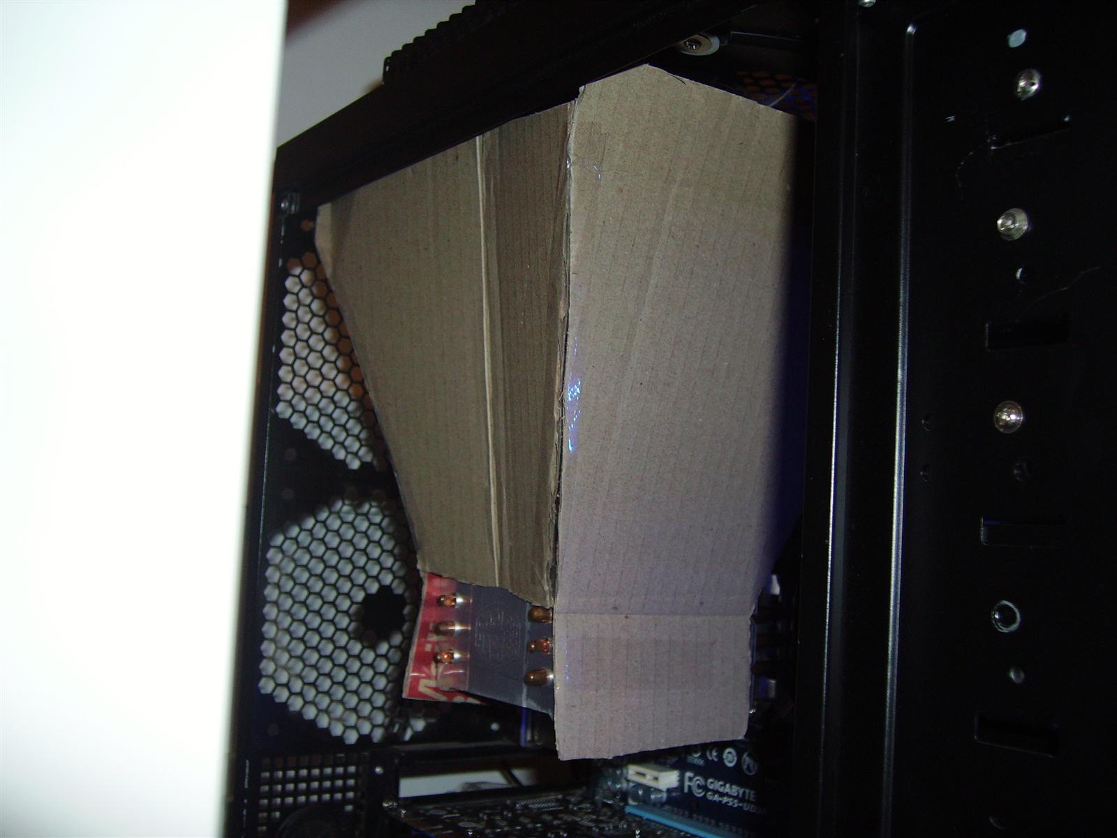

                      I decided that the 92mm fans on my TX3 were a little small these days, since every other fan in my computer is 120mm or larger. So, I decided that since i had a 230mm fan on the top of my Antec 1200 case which wasn't actually doing much, why not use it for the CPU? So, here's what I came up with.

                        Reminds me of a Dell.
                            Nice mod, but just make sure the CPU heat sink doesn't get too hot! I doubt cardboard is UL 94 -compliant .
                              It doesn't even get warm now. That 230mm fan does much better than the original 92mm fans.

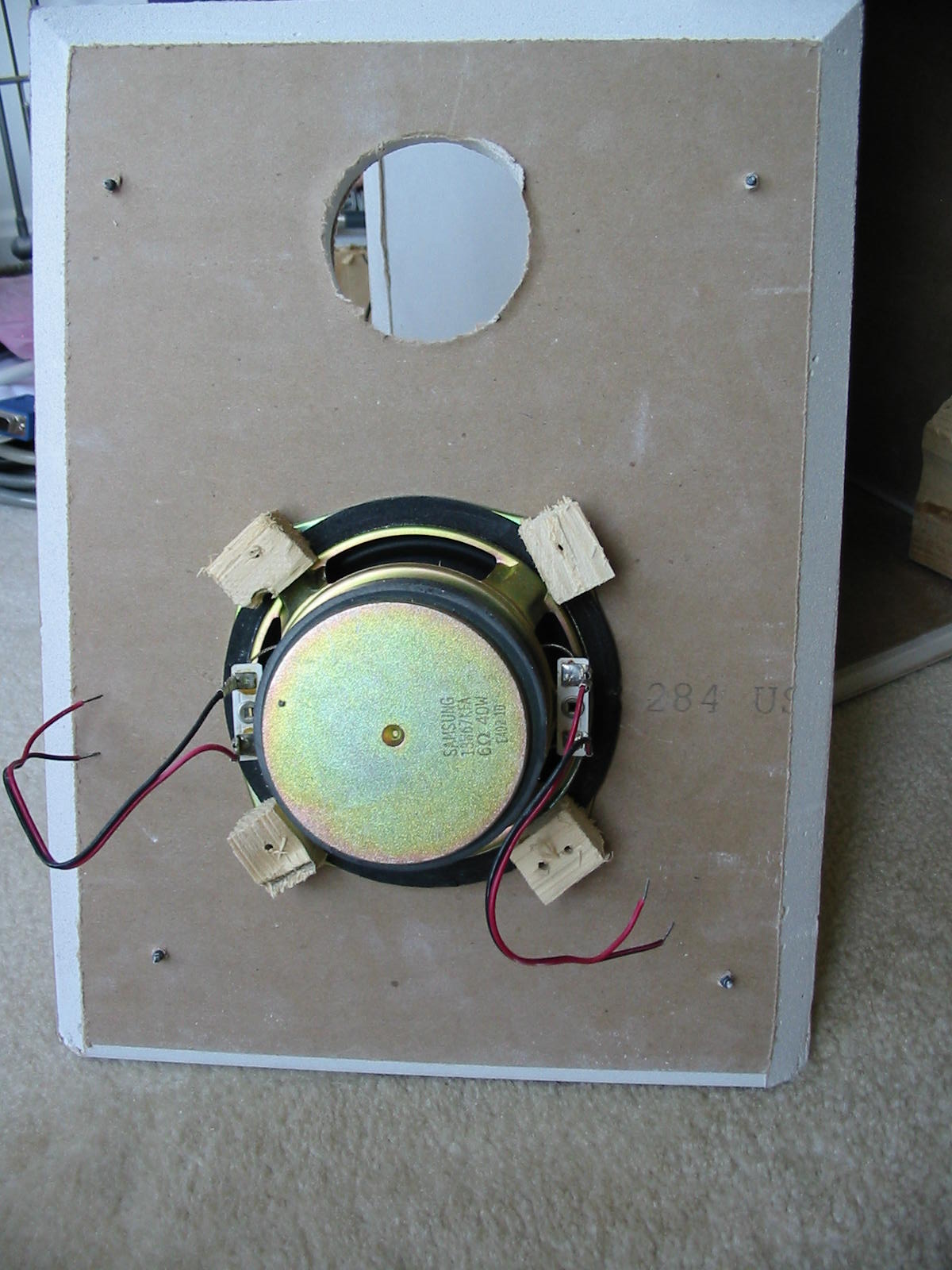

                                Re: The ghetto mod thread - Sheetrock Subwoofer
                                And now ladies and gentlemen, I present you the latest and greatest from the world of Hi-Fi audio
                                The SHEETROCK ® brand Firecode series of subwoofers .
                                Yes, they are finally here!
                                (more pictures at the bottom of this post)
                                Not only do they look ghetto, but they sound ghetto, too. And I really mean ghetto (as if you were actually in the ghetto and someone drives by in their car with one of those loud trunk woofers... or maybe worse ).
                                So how I came up with this mod (or should I call it creation)?
                                Basically, my dad and I bought 5/8 " (approx. 16 mm) drywall by mistake rather than 1/2 ". Unfortunately, we cut it and put it on the wall before realizing it was the wrong thickness . So, when we took the drywall down, it had holes and cuts in it and some of the pieces couldn't be reused. My dad couldn't think of any other project where he would need it, so I thought I'd save it for a project of my own.
                                Now as far as the speaker driver - I've had that for a while now. It's a 4", 40W (peak likely?) Samsung driver with dual coils inside, each rated for 6 Ohms. A friend of mine gave it to me along with an amplifier board (turns out, the driver and the amplifier were part of a Dell MMS5650 5.1 surround sound system). I actually wanted to build a subwoofer box for it for over a year now but didn't really have the time until this summer. Moreover, I didn't want to invest much money in the project either - especially in the box. Originally, I was going to build it out of wood (the idea was to just go around the neighborhood on or before trash day and find some suitable thrown out furniture). As it turned out, though, the extra drywall just came at the right time. Since this is something I haven't seen anyone do before, I decided it would be a fun idea to try.
                                I actually tested this subwoofer using the original amplifier board it came with. (Un)surprisingly, it didn't sound that great . Very low frequencies below approx. 60 Hz get quite attenuated (okay, I know... it's obvious that a 4" driver can't make miracles here!) and the higher frequency bass makes the box resonate at certain notes . Then again, I haven't glued the sides down nor filled the box with soft foam or fiberglass. When I do these things, it will no doubt sound a little better. I already tried stuffing the box with some old rags (), and it tightened the resonances a lot more.
                                Lastly, the amplifier board didn't go without ghetto mods either. When my friend (or whoever else) took it apart, they ripped about 1/10th of the board off. Nothing major in the amplifier section, but probably enough stuff in the On/OFF logic and active filters section to make it not work (I didn't even attempt to turn it on - it was very obvious that it wouldn't work). So I had to do some data sheet reading to find out how to enable the amp ICs and where their inputs were. After that, I just put a simple RC low-pass filter in front of one of the amp ICs and hooked that to the driver. The amp board itself has 3 amp ICs - two TDA8947J (4-channel SE or 2-channel BTL audio amp) and one TFA9843J (2-channel SE or 1-channel BTL audio amp). I was using one of the TDA8947J's in BTL. Like most amp ICs, it's noisy with high gain. But quite acceptable for this project .

                                  I thought sheetrock had really good acoustical properties for speaker cabinets, being so dense, beating chipboard and bettered only by concrete.

                                    HAHAHA! Lol at the Gyprock (or whatever the US calls it)

                                        It sounds crap because your box isn't tuned. I see you just left the second hole like that, without putting in a port (tube). What are the (internal) dimensions? I can try and calculate the port length for you.
                                          Yeah, I thought it might be that too. Don't have it with me in my dorm room, though, so I can't get measurements until this weekend. I found this online calculator:
                                          http://www.mobileinformationlabs.com...0lenth%201.htm
                                          Do you think it's okay to use?
