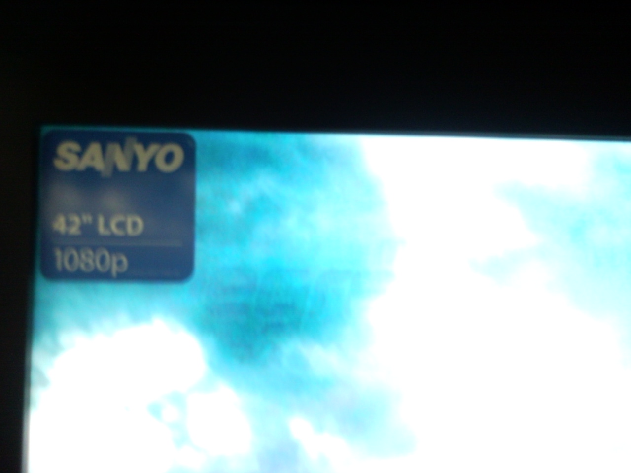

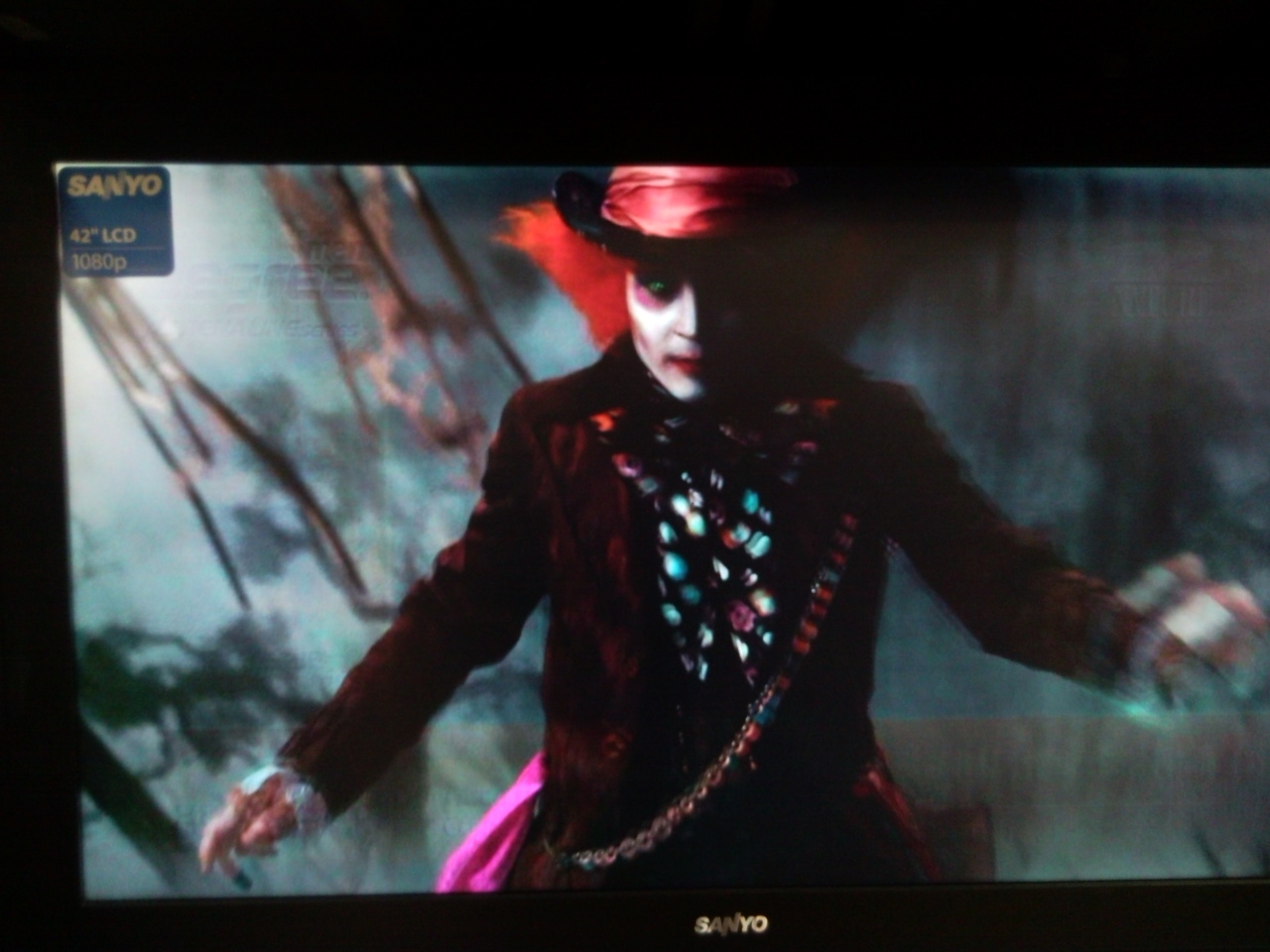

nice burn in on sanyo lcd at walmart
  • kc8adu
    • Nov 2003
    • 8832
    • U.S.A!
    no idea how long this took.

            Recent Consumer Reports surveys show that Sanyo LCDs have one of the lowest failure rates. Actually I don't think they reveal any statistically significant difference in failures except for Mitsubishi and the worst brands, like Westinghouse and Polaroid.

                i have seen image persistance on lcd sets.mostly on cheap panels like the chi mei in an audiovox 26" on my bench.
                it goes away quickly and is most easily spotted on a still image with a brightly colored area.a negative of that colored area will be seen in some scenes later.
                example is a webpage with bluegreen stripes down the sides.on a white screen you will see pink stripes.

                  I've never seen a LCD burn-in like that.....even at our local walfart, which never shuts theirs off. I've seen burns on some of their plasmas though, all Sanyo's ironically enough. I think our local walmart rotates the stock often enough to prevent most of this. they periodically sell floor models dirt cheap.

                    I do know that LCDs do not burn in, but plasmas do.

                            "Burn in", while descriptive of the appearance is probably not a good term, but a permanent image on an LCD panel is possible.
                            An LCD panel works by using a polarizing voltage across the cells in the panel. Under some circumstances (usually an electronic failure) they will electrolyze the liquid in the cells. It won't happen in a panel that is working properly, but the chearper they build them the more likely it is.
                            PlainBill

                              My Sanyo 26" LCD TV also gets image burn in.
                              At first it would go away after awhile but this last burn in that happened from falling asleep while it was on a show that was 4:3 ratio and the sides are a permanent burn in now.
                              I always thought LCD's were pretty safe from burn in owning this sanyo has proven different also have seen the old Dell LCD TV's get burn in.
                              Purchased the Philips 5000 series LCD 4 months ago and noticed right away it does not get burn in like my Sanyo does.

                                    These panels are meant to be driven with a high frequency AC signal, so there is no overall DC bias across each cell. If there is a failure like you mention, DC might be applied to the cells. This happens with LCDs from calculators etc. Try connecting a battery to the segments. They will work but they will be damaged if left for a while.
                                    I guess the most common fault would be T-con going bad, it's possible it could fail in a way that the picture continues to work but a DC bias is applied. Like some amplifiers can kill speakers by keeping a DC bias across the output terminals - yet you probably wouldn't notice the difference in audio.

                                      As long as the burn-in isn't really severe, you can usually get rid of it by displaying a solid white picture for a relatively long time (couple hours or more)
