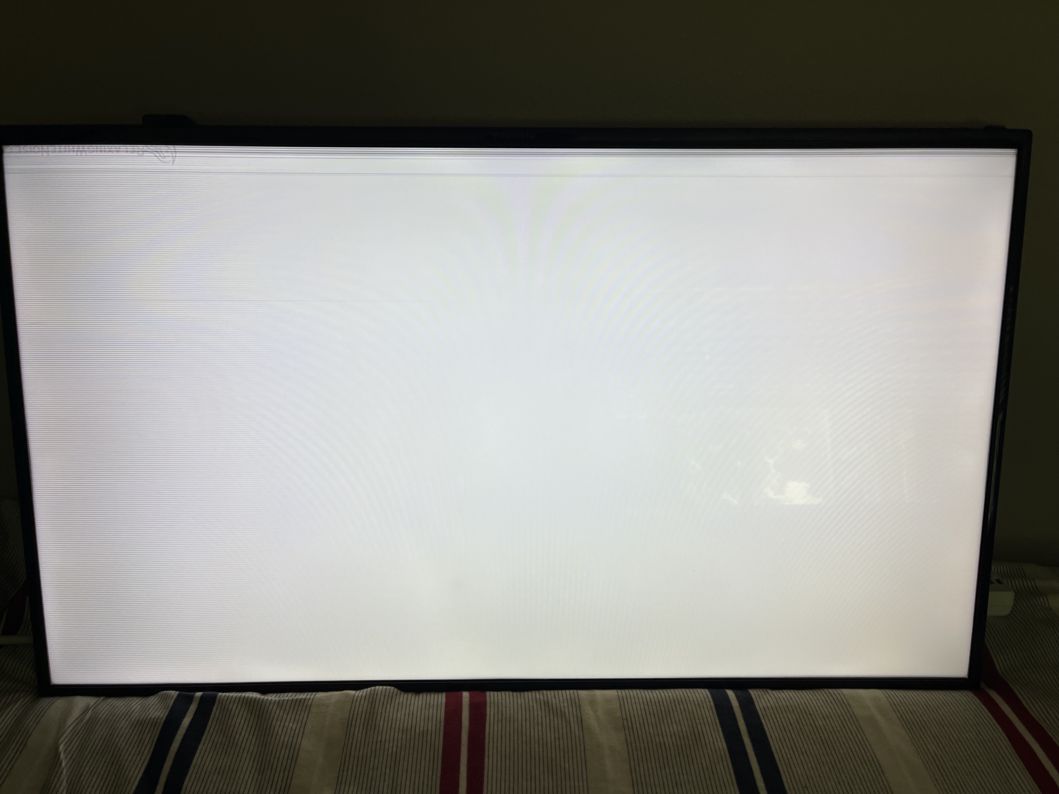

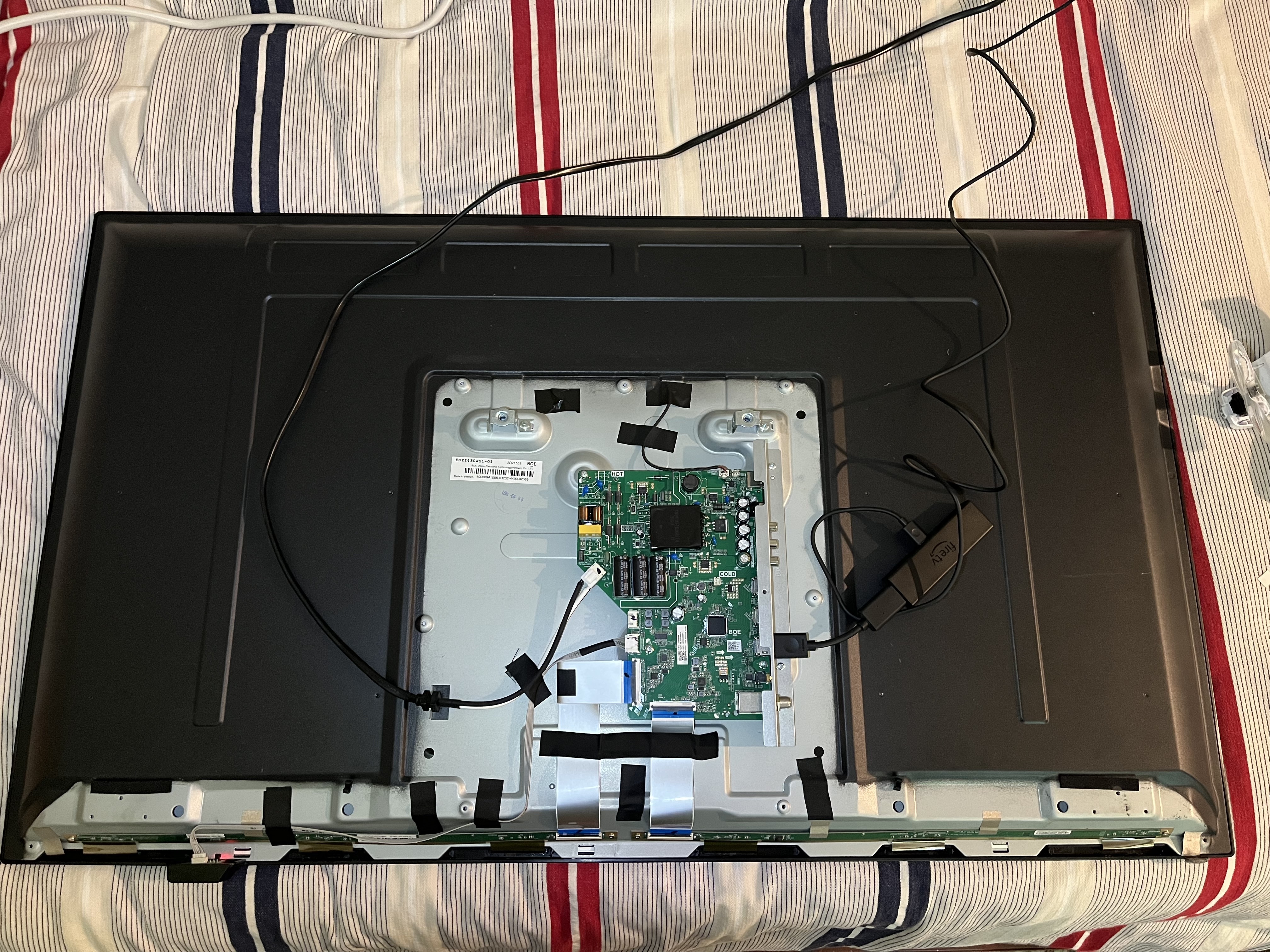

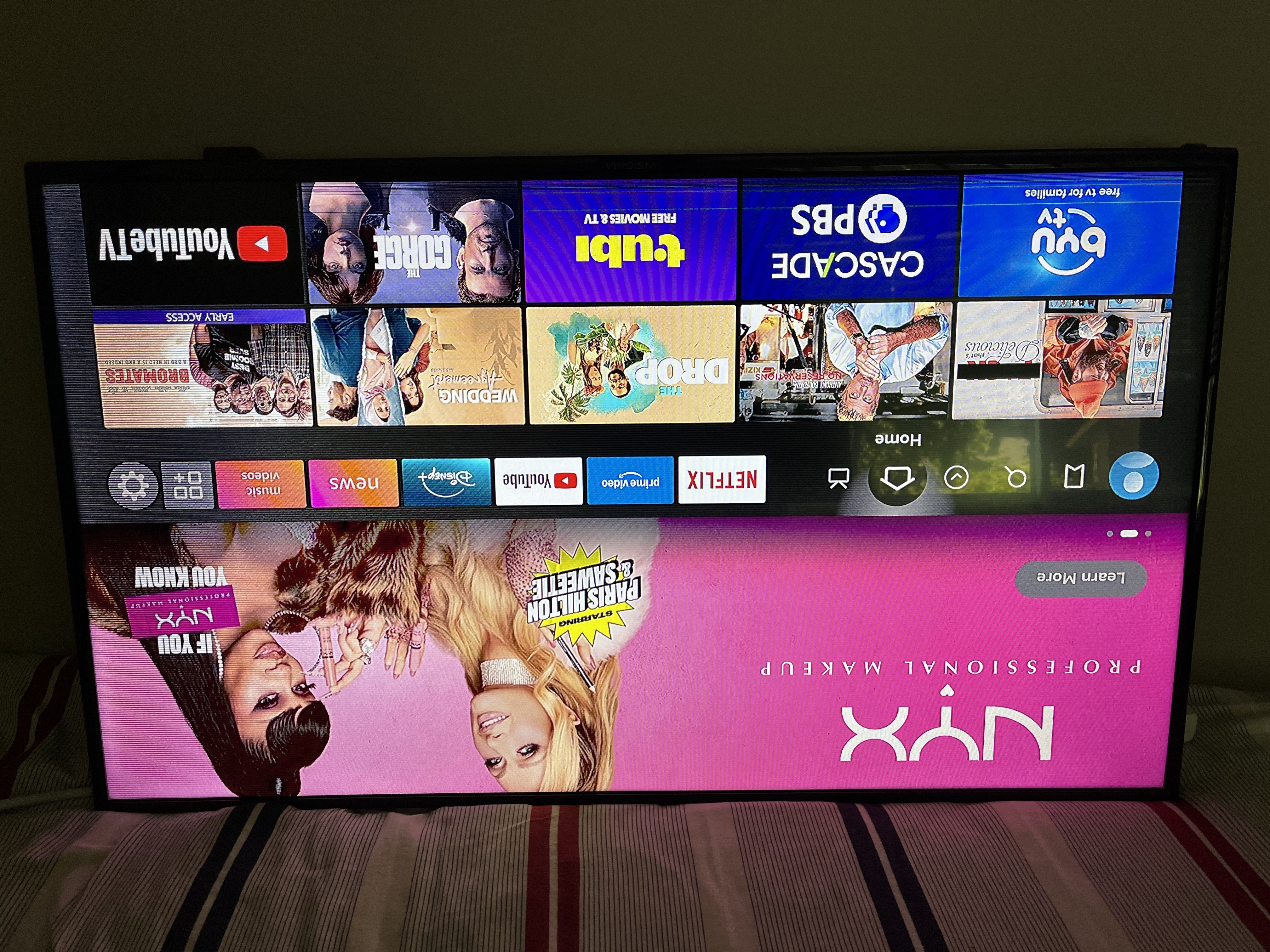

    Eventually discovered a burn mark near lower corner of LCD. Here is a summary

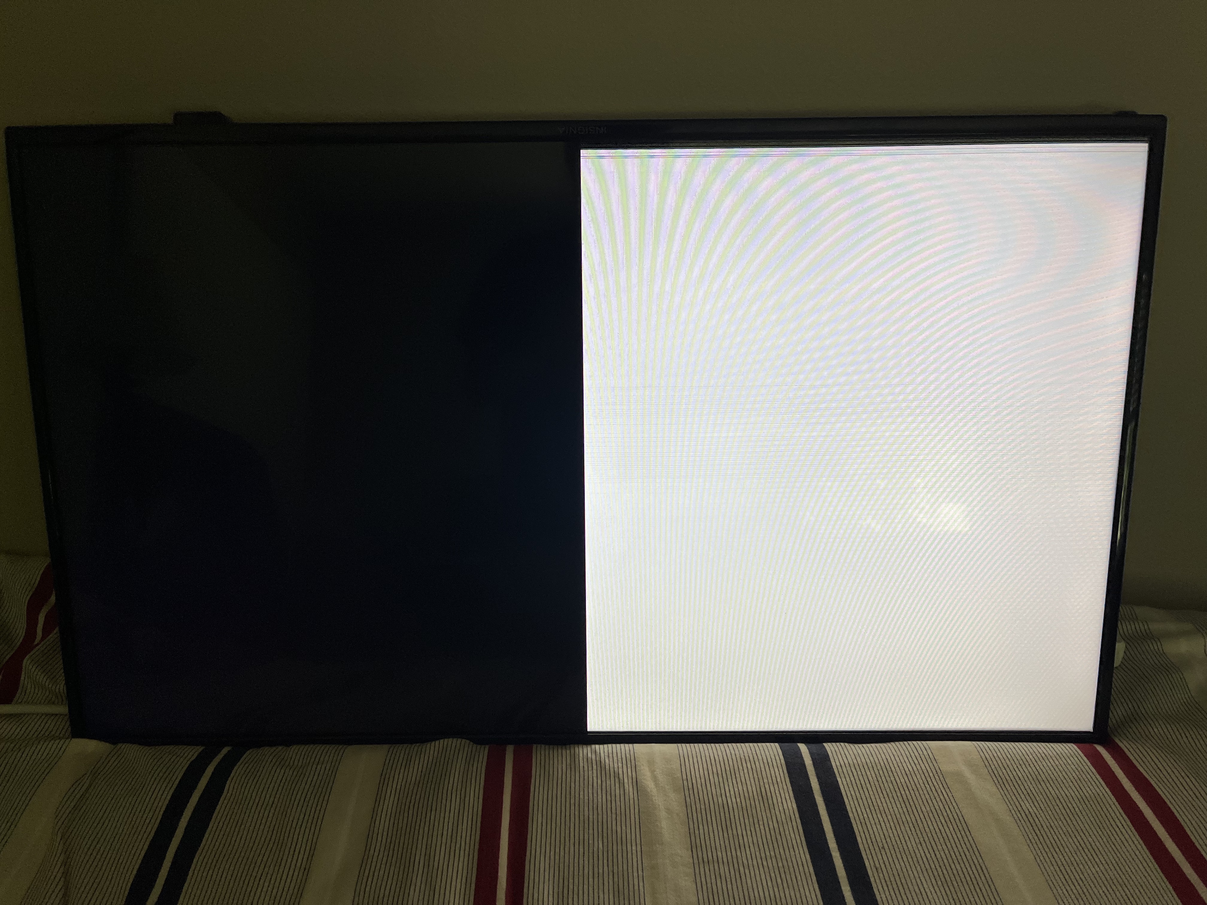

    • Backlight on, no image

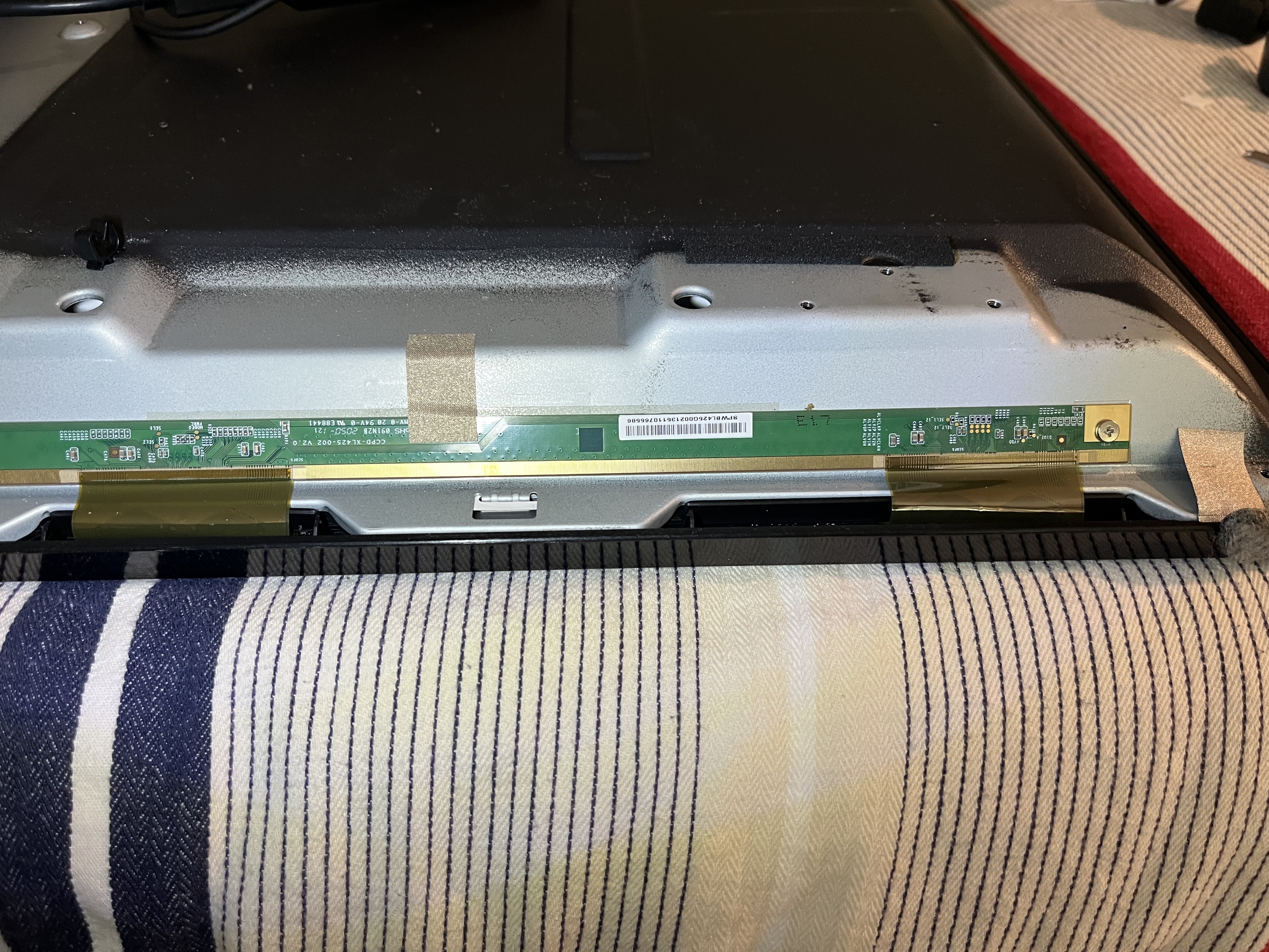

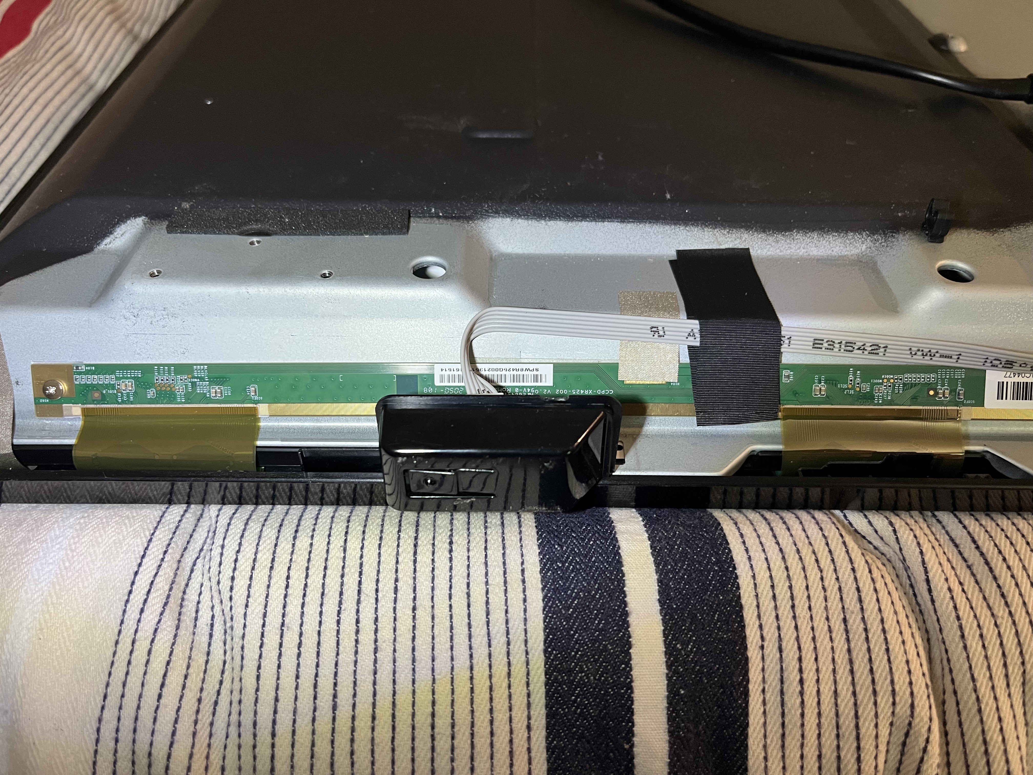

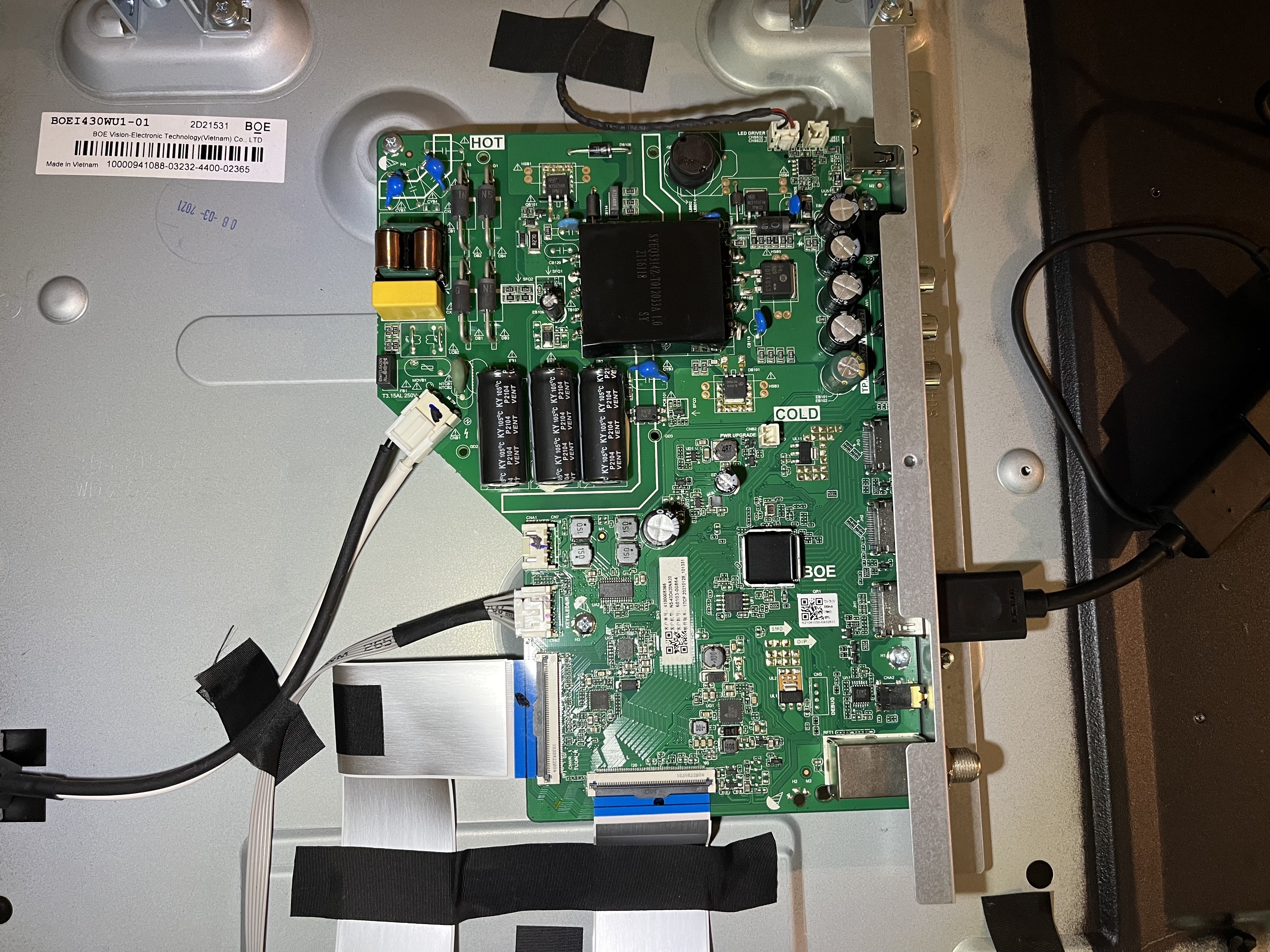

    • Disconnect right buffer board (view from front), left side display comes on

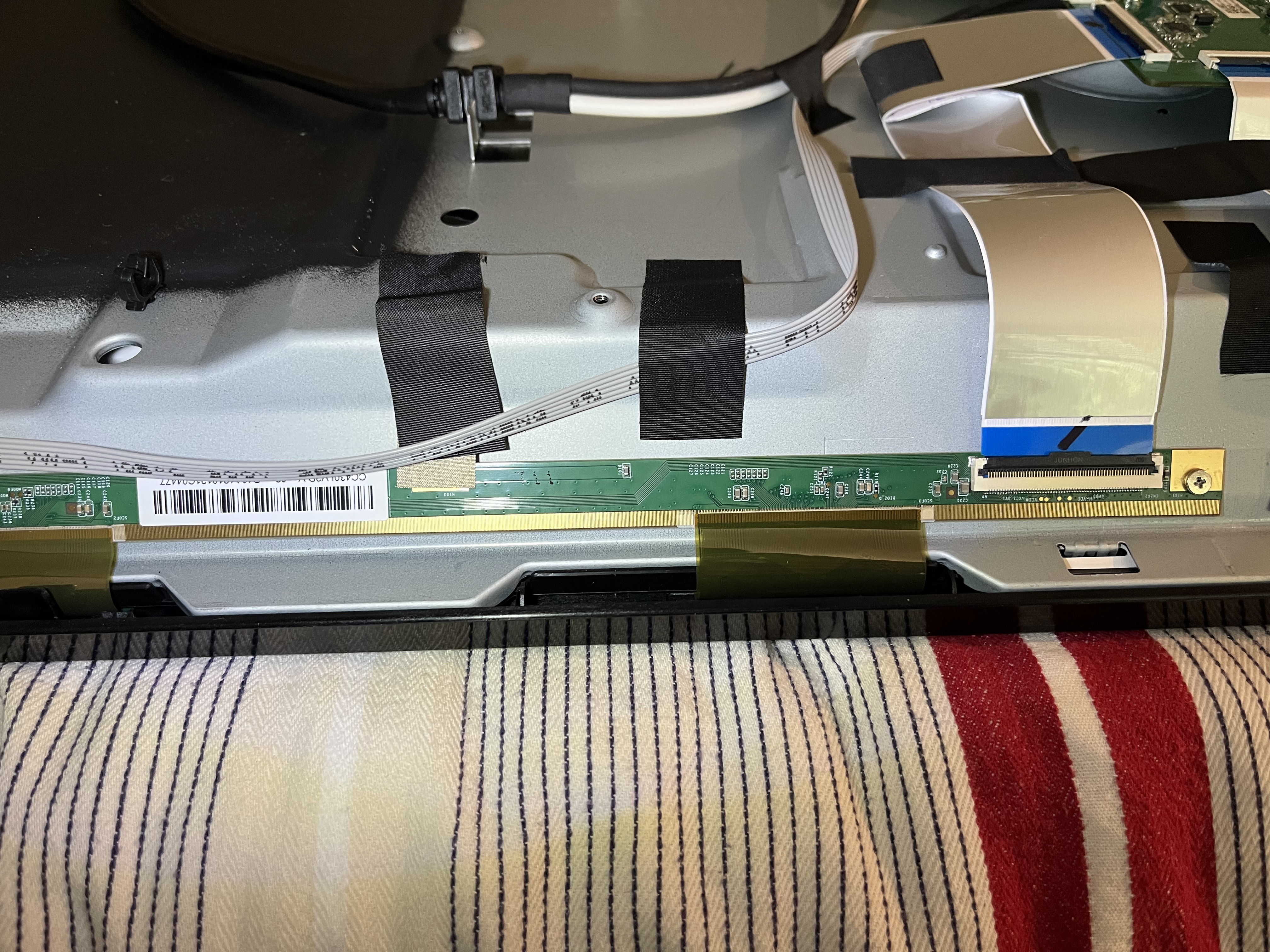

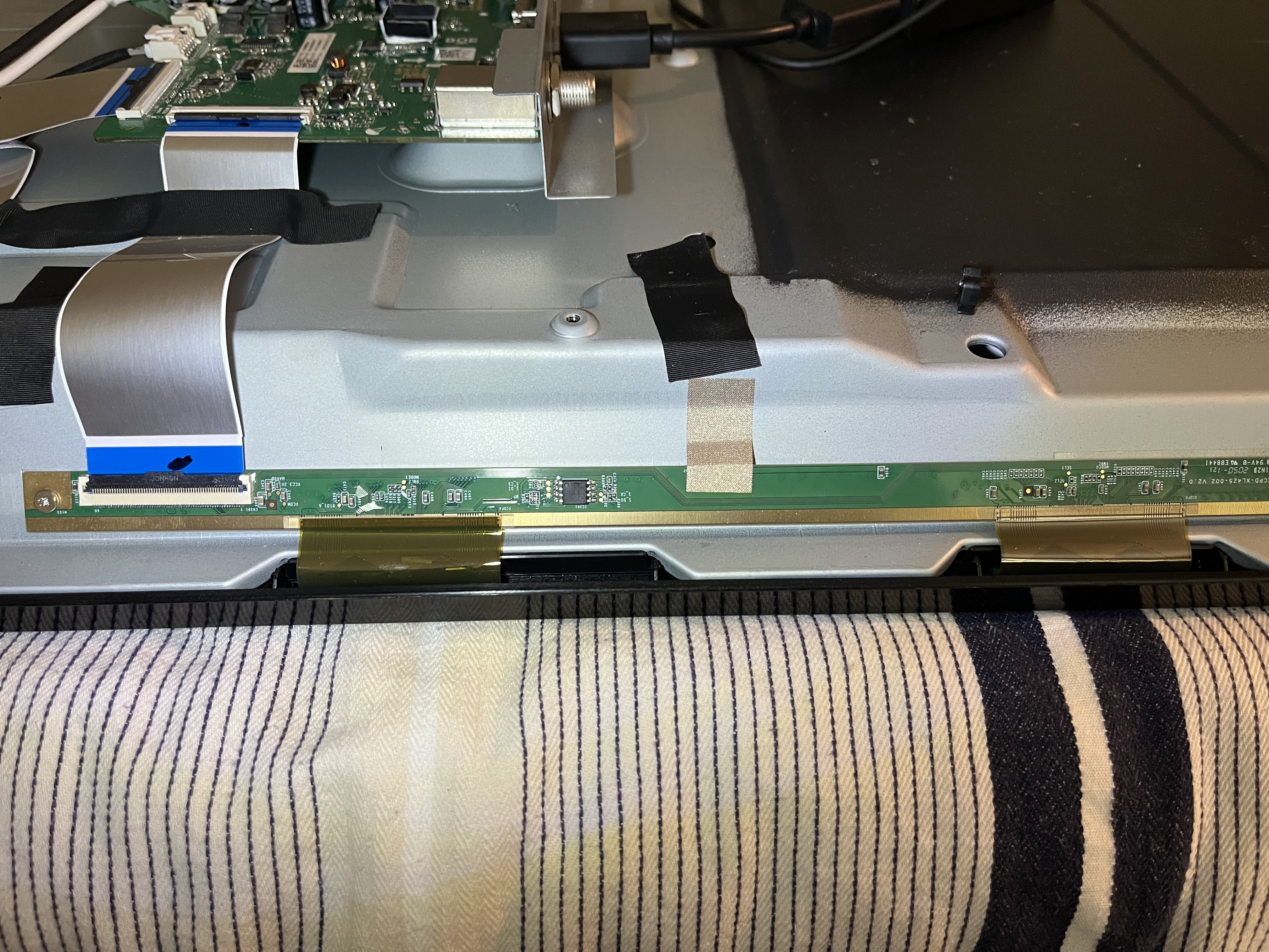

    • Masked off pin 7+8 (both ~12,5v on both left and right buffer board) from t-con to right buffer board (view from front) display works but have some lines
    • Buffer board is pretty simple

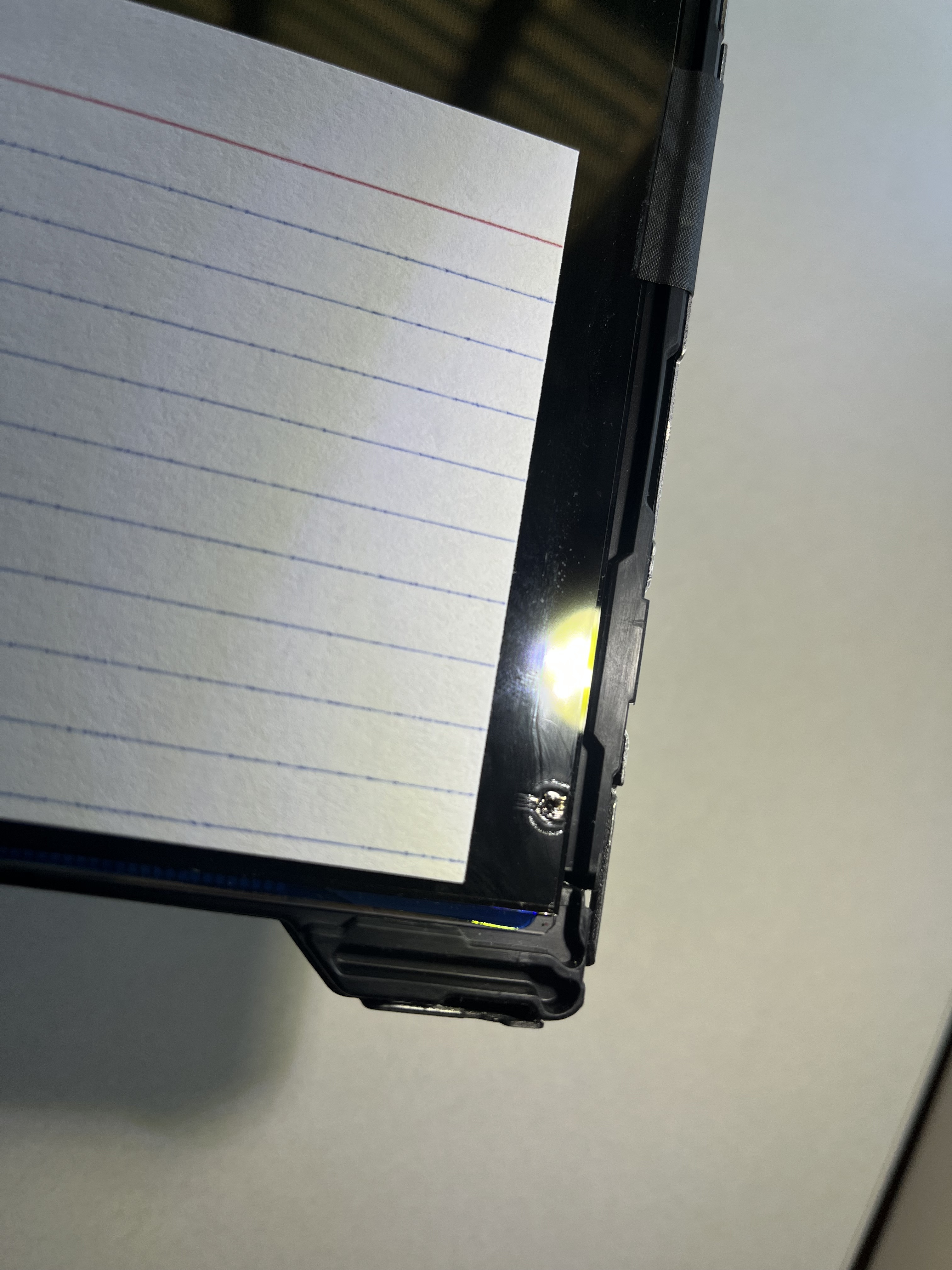

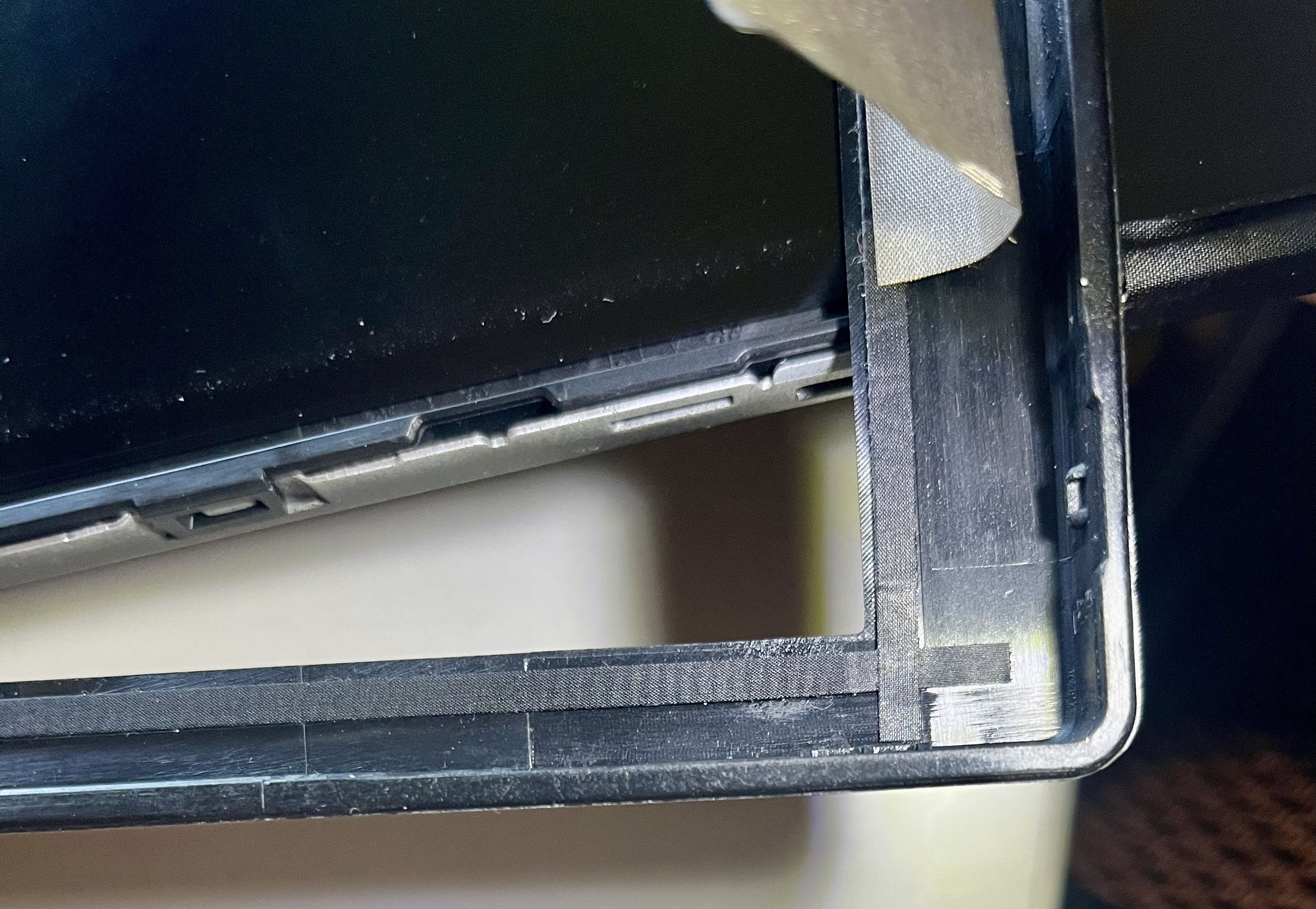

    Removed the front bezel to examine edge of the glass. Found burn mark on lower right (view from front). Plastic bezel covering the burn mark region shows heat signature on the inside surface facing the LCD panel. Last 2 pics. Bright spot above burn mark on LCD is just flashlight reflection getting the area lit for pictures.
    Since the panel is defective, only salvage parts.
