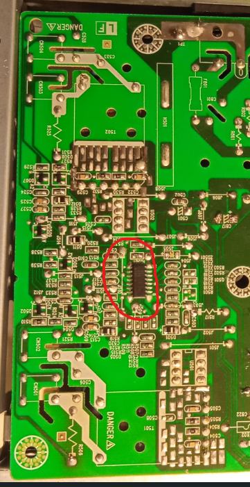

            • 31028
            the 16pin chip is on the other side of the board - that 8pin chip is the mosfets
            • ttmi100x
              • Mar 2024
              • 11
              My bad, this one, right?
              The number is rather hard to read, partly because of the surface, partly because of the component age (I'm guessing) had to grab a magnifying glass and blast it with light from the right angle.
              Anyway, as far as I can tell it goes as follows:
              OZ9938GN (The "O" could be a zero but I'm leaning more towards O as it does look slightly wider than the zeros)
              A86710 20
              0924B
