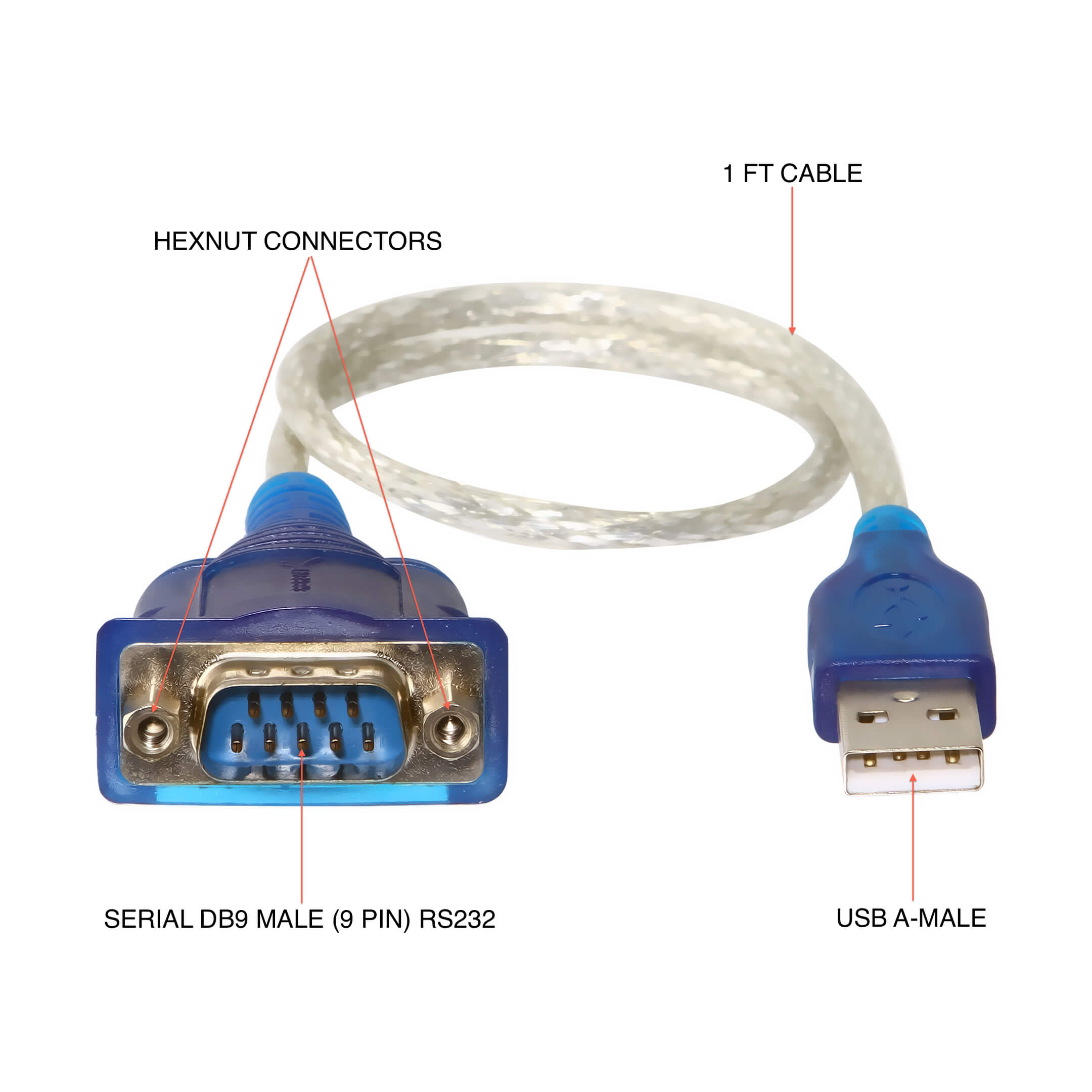

              Is there a way to see if that one pin is causing it? I figured out what Tom meant about the RS232 to USB cable.
                #147
                Re: Pioneer Elit 1120HD Power Supply issue?
                You would need to connect your PC up to your panel using RS232 to USB cable then use a program like RealTerm to send the TV commands.
                https://learn.sparkfun.com/tutorials...l-term-windows
                TV must be in standby
                Send the command (**PON) with hex 0x02 and 0x01 around the command. Do this by using the send hex mode.
                If the TV powers on when you send this, you can communicate with it using this method.
                Baud rate is 9600, mode 8N1 (8 data bits, no parity, 1 stop bit)
                • Boyd1966
                  • Mar 2017
                  • 128
                  #148
                  Thanks Tom. I downloaded the software. I just need the rs232 to USB cable. If I can communicate with the TV, what would I be looking for?
                    #149
                    We should be able to send requests to the TV controller to generate test patterns, also may be able to ask it what its status is.
                    • Boyd1966
                      • Mar 2017
                      • 128
                      #150
                      I don't see a male connection on the TV that would fit an rs232....that looks like the picture below.
                      Also, is it plausible that the solder job is causing this?
                      Is there any checks I can do with the volt meter? What about replacing the Y main board and X main board?
