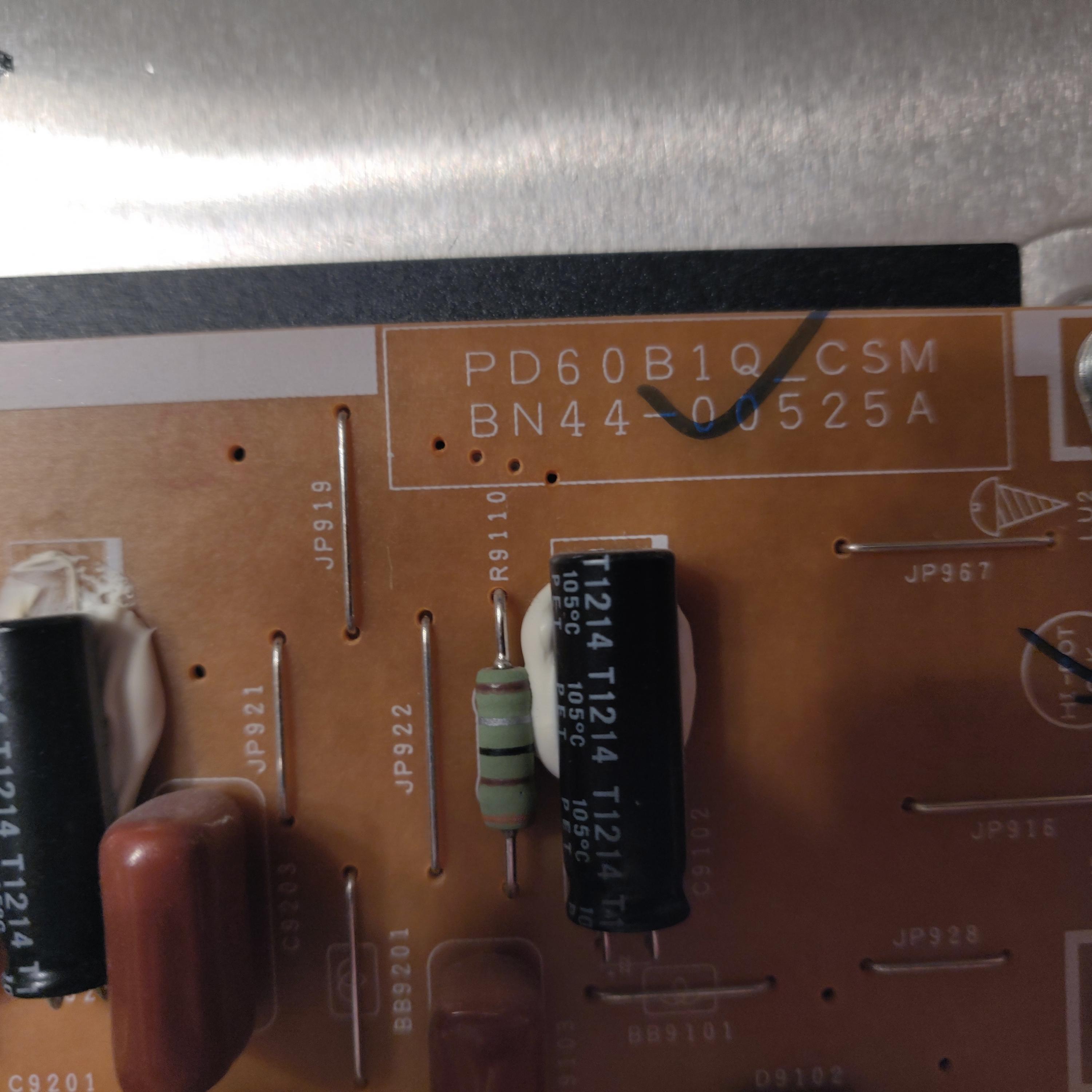

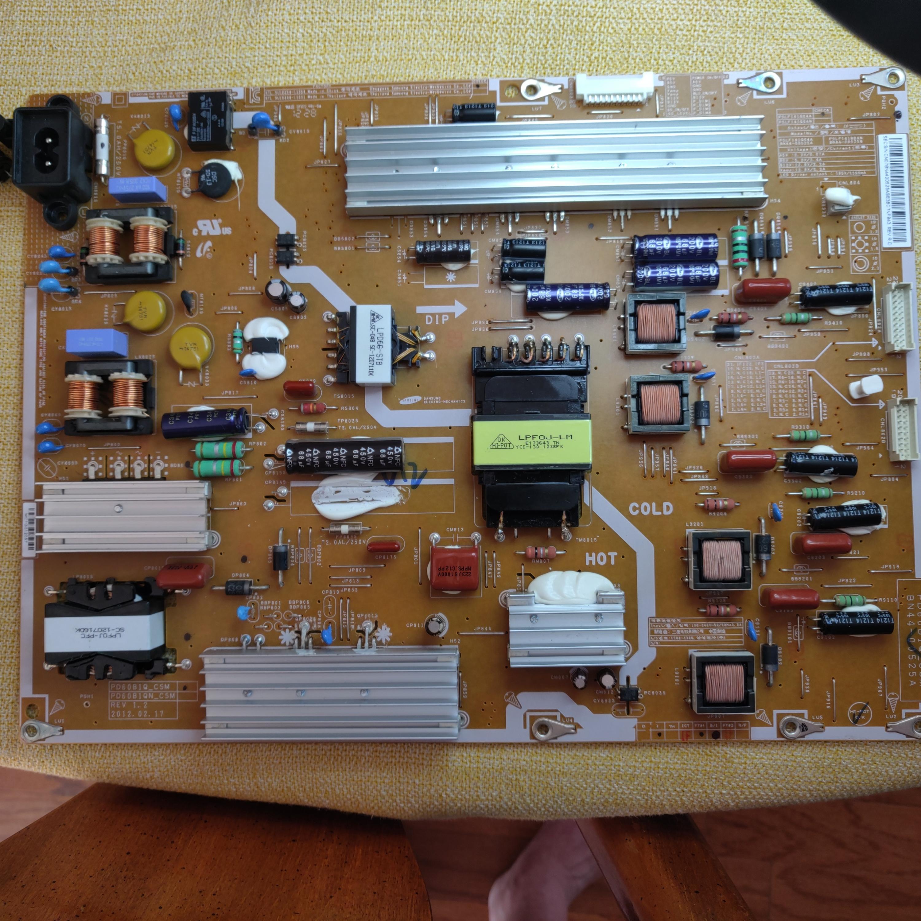

    Hello Everyone, this is my first post and I am excited to be a part of such a great community. I've been reading these forums for awhile and there really is some good friendly people here. No bashing and being rude like 90% of other forums Ive been to. Lets get to the good stuff.
    I have two years of college in Electronics Engineering Technology. Ive been tinkering with electronics sine about 1990. I know enough just to be dangerous, so be gentle.
    Make: Samsung
    Model: UN60ES6500FXZA
    Power Supply P/N: BN44-00525A
    Symptoms: The TV was given to me with a flashing red standby light and a clicking relay. When I plug the TV in I hear a click (TV turns on), then standby light "blink" "blink" pause "blink" "blink" pause "blink" "blink" pause "blink" "blink" pause "blink" "blink" then click (TV turns off). Repeats cycle over and over. No backlights at all.

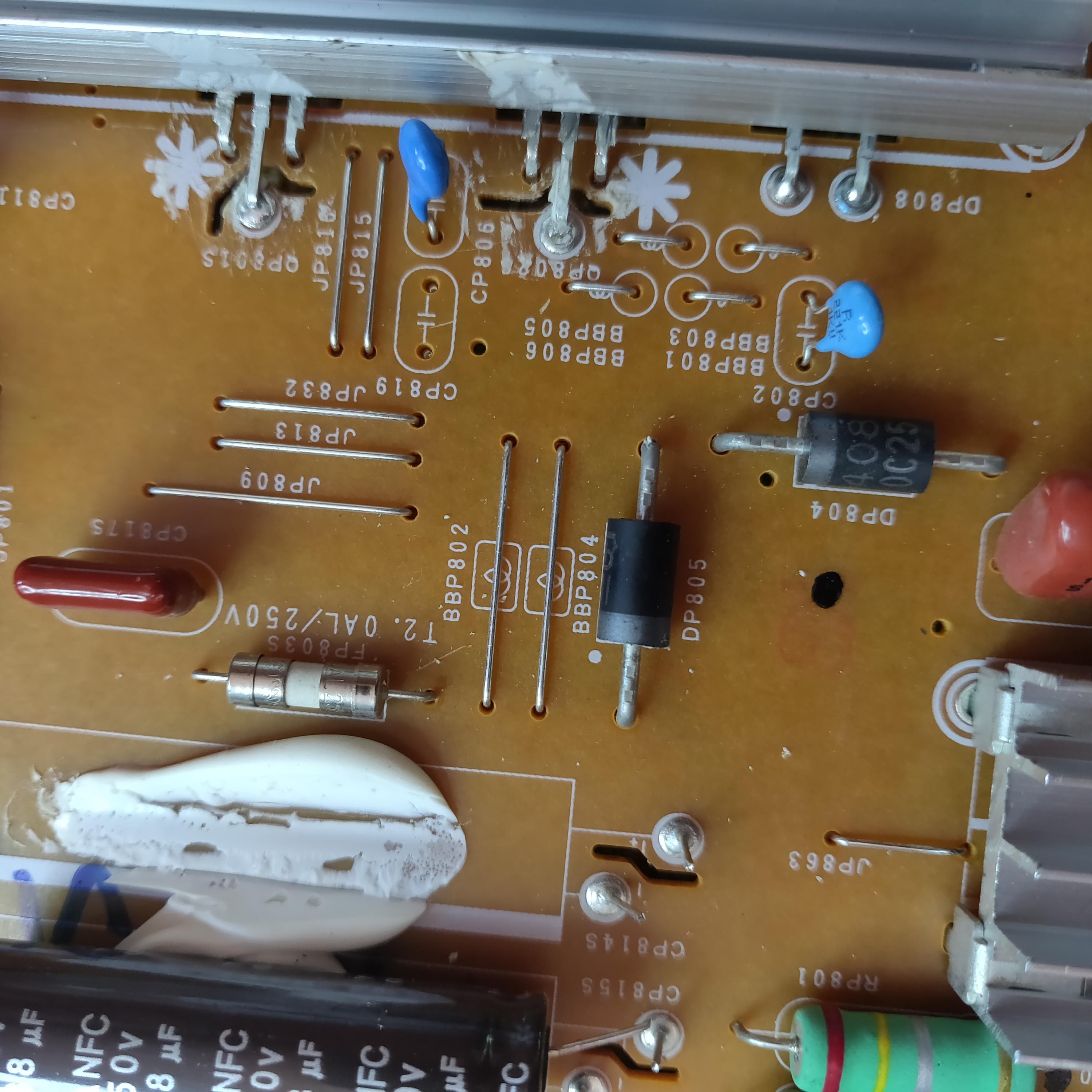

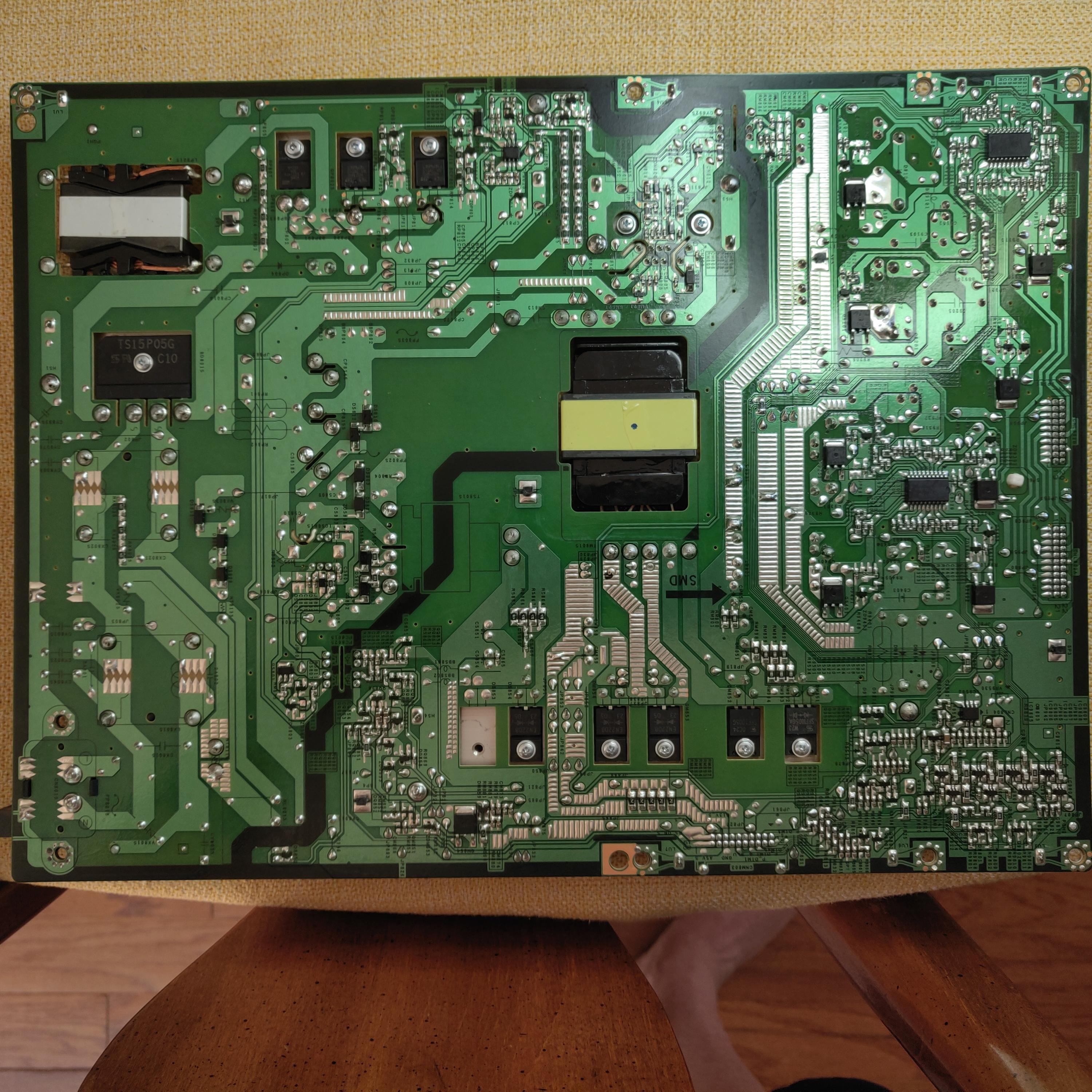

    1. I removed the back panel and the first thing I did was remove the Mainboard connector from the power supply. I plug the TV back in and hear a click and the relay stays in that position. No standby and no blinking and no backlights.
    2. I unplugged the TV, removed the Backlights connectors from the power Supply board, lifted all three fuses and they were good, at this point, there is nothing plugged into the power supply board. I started poking around with a Meter and discovered that voltages were missing from a lot of points. I was seeing a lot of 0V on the hot side and the cold side.
    3. I unplugged power and lifted the diodes DP804, DP805 andDP808 to test and they were good.
    4.I removed QP801 and QP802, they tested good.
    5. I then cut one leg of C814S, CP815S, CS818S, CS854, CM858 and CM851. They all tested bad with my Fluke 85 multimeter. You can see in the pics were I cut one leg and even removed on cap completely.
    I cant find any information on this power supply or a schematic. No one has and repair kits or boards. i would rather repair this one if its worth the time and money. I was thinking of replacing all the caps, but wanted to get a professional opinion before I go any farther. Ive attached some pics, let me know if I need to post better ones. Thanks for any assistance with this issue.

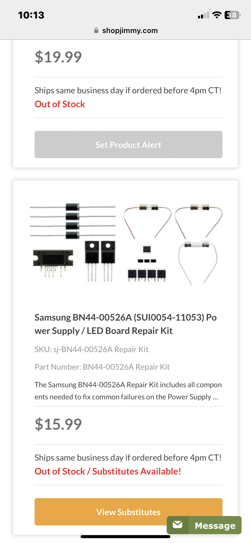

                  This power board is famous for a lot of different faults. They do sell a repair kit for this with fuses, diodes etc. it's quite a few parts. It not in stock but at least you can see the parts and give you an idea what to check.

                    Good find, I looked there but didn't see that one.

                      This repair kit is for a BN44-526A, I have the BN44-525A, not sure if there is any difference in output. The board is physically different. I have the schematic for 526A and compared it to my board. They are close but not exactly the same.

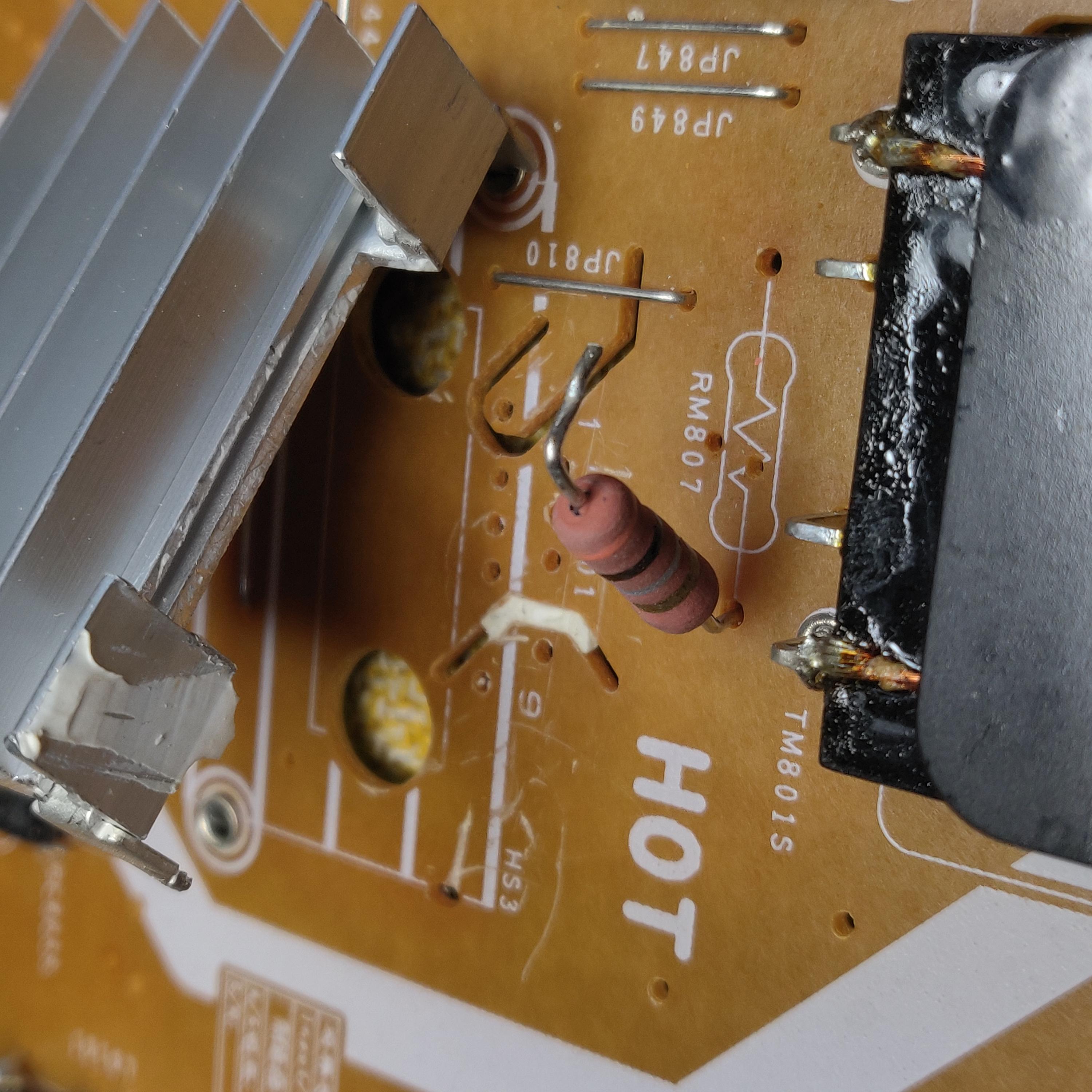

                            I circled the part that is always bad on the ones I repair. Usually you have to remove the heatsink and you will see it's blown apart. At least that's how mine were.
                            There is usually more parts that need replaced but this seems to be a good starting point

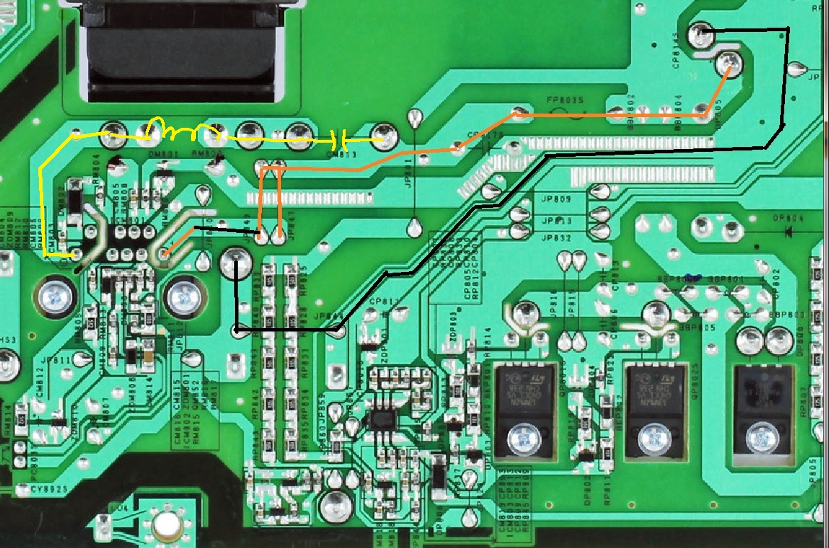

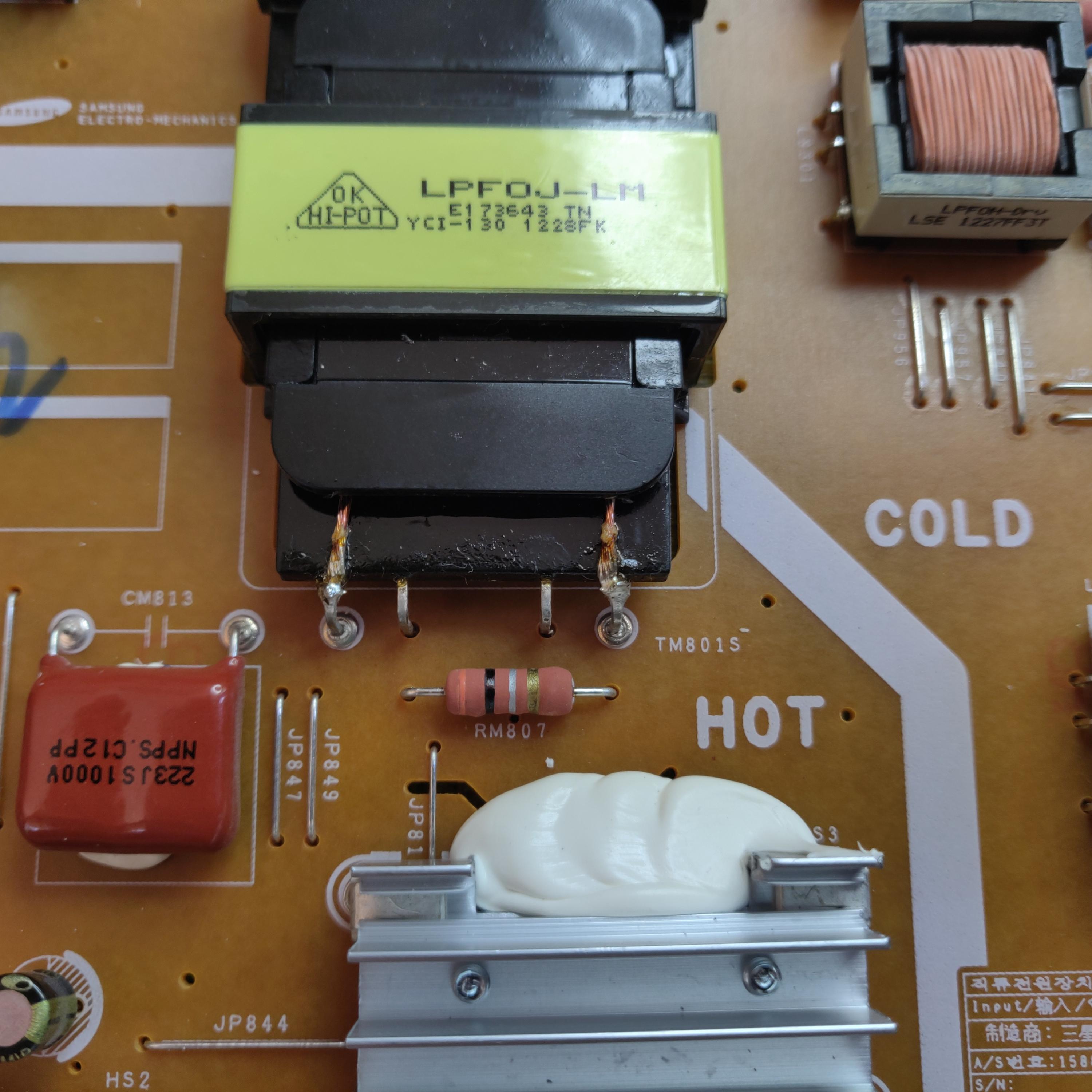

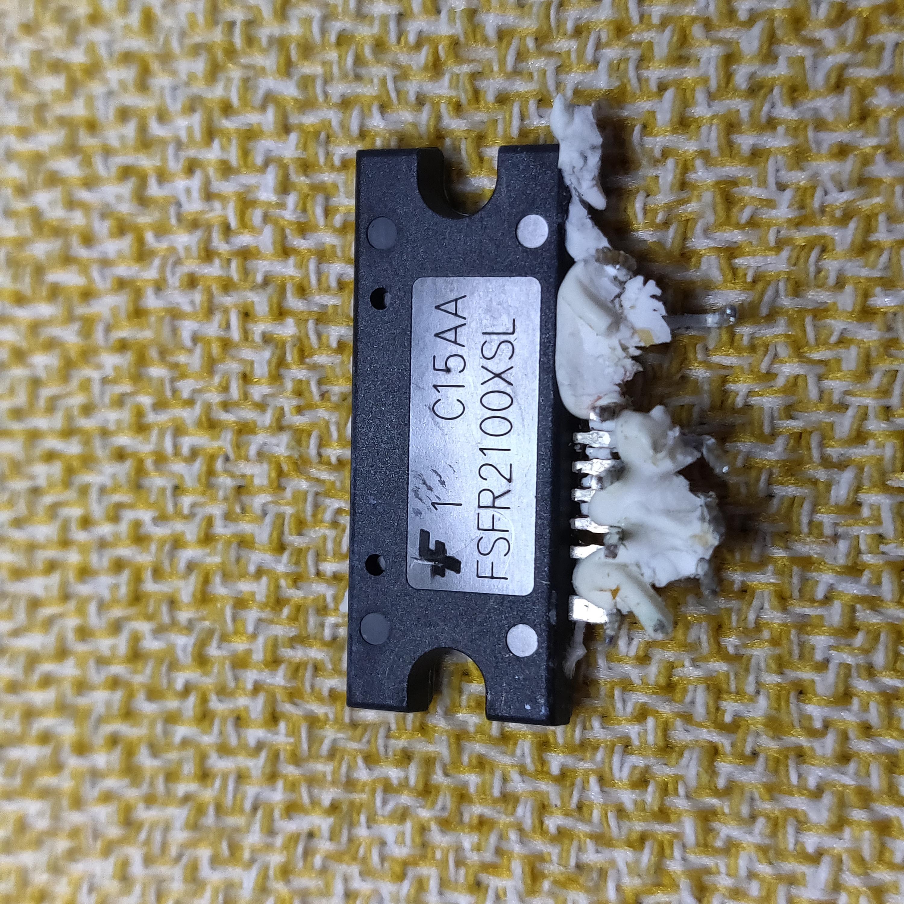

                                I removed ICM801 and found that it wasn't destroyed, but no idea if it is bad. I lifted the leg of RM807 and it tested as a dead short (.5ohm on continuity test).
                                This would explain why TM801s has 0V on the hot side. I havent reach the knowledge of where I can "see" whats going on in the circuits. I know how components operate, but I dont know how they play together! Trying to get there!
                                I attached pics.

                                  The high voltage is supplied from CP814s, through FP803S through JP847 to icm801 pin1, the ic then switches the primary via pin10. The primary gets switched at about 100khz so you won't measure any real DC voltage on the primary. The ic also requires VCC on pin7, check that there is about 15vdc on CM812
