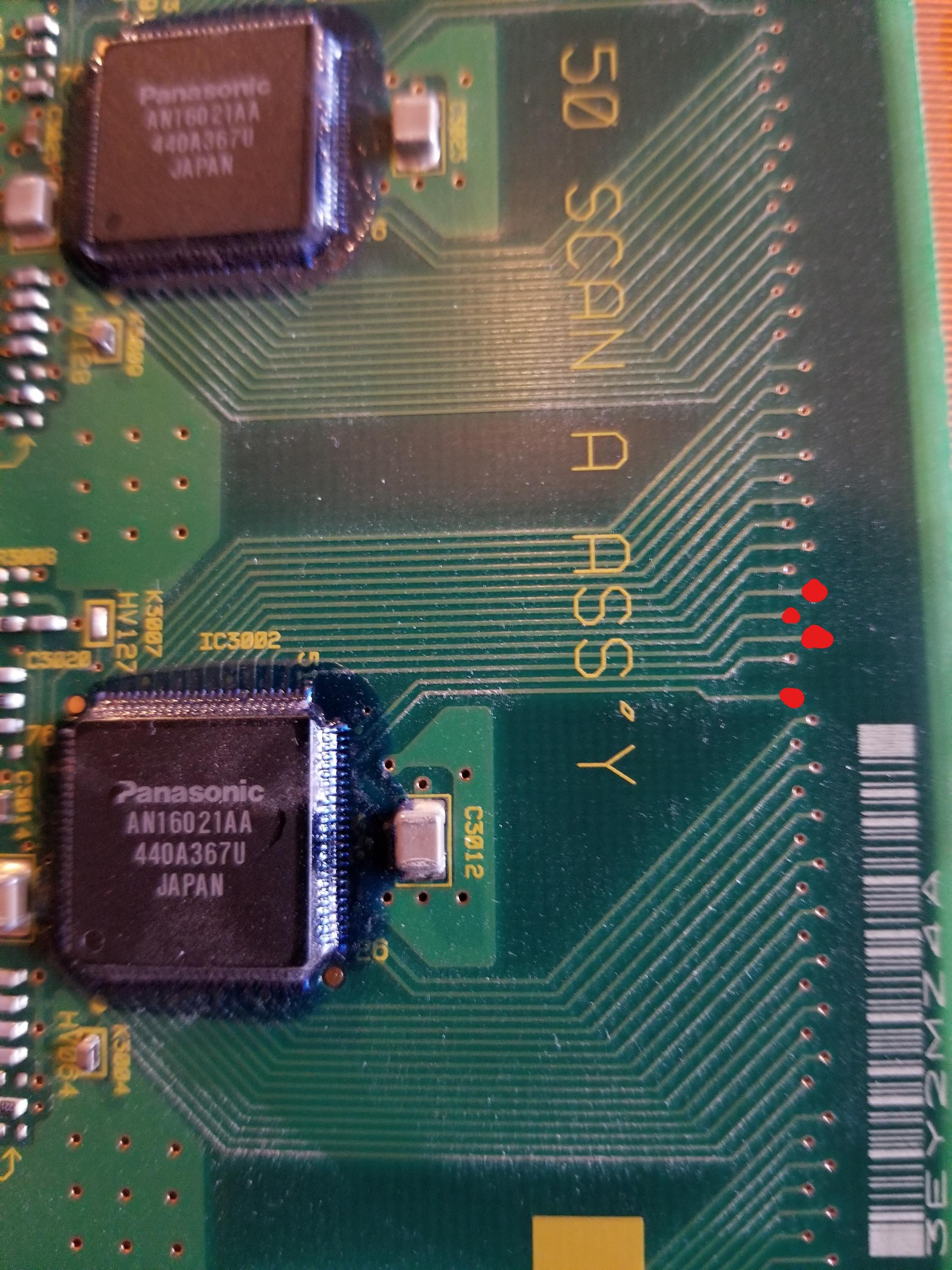

    Continuity is one click from the last V~ setting, the one that has the audio symbol and diode symbol. Sorry on mobile so can't highlight it. This is for seeing if any outputs are shorted Freak's test is more general

      Thanks Tom. I see it. So if it beeps, its good?
        #103
        Re: Pioneer Elit 1120HD Power Supply issue?
        Beep is bad that's a short
        There should be no beeps, you may briefly get one but it shouldn't be continuous

          One thing you can do as well is run the probe along the connection quickly which should let you find shorts in not much time. Test your meter first by touching the probes together and you should hear a beep

            Forgot to ask, where does the black probe and red probe go in the highlight square you showed me?
              #106
              Black probe on the gold pad
              Red probe on each of the vias/micro drills.
              You may be able to run the probe fairly quickly along the vias as I said above.. This depends on your meter being fast enough (most are)
              You're basically trying to test between the big gold pad and the outputs of the buffer/scan board

                I get it for the red probe but for the black, where is the 'gold pad'? Sorry for my noviceness!!!

                  Oh you mean the GRND gold pad right?

                    Yes use GNDH for the grounding point. This would be a sure test to know if in fact those scan ICs are shorted or not. Its a time consuming process but a thorough one.

                        If found 4 vias/micro drills that beeped in the lower board. See picture with red dots.
                        I tried doing the same test to the upper board but I wasn't getting a reading. i.e. no numbers would show up. Just the L. I am not sure what I was doing wrong.

                          Unfortunately, there's your problem with the tv...
                          This board is unreplacable. How many hours would you say you have on this set?

                              Replacing the IC Scan chip by a professional?

                                Since this board is fused to the panel, it cannot be replaced. The IC can but it requires a certain skill to do so. Hot air and a fine point soldering station. Flux as well. I have done it quite a few times, unfortunately I cannot just have you send me the board for repair..

                                        Thats always the question.. These IC's are like tires. When one goes, it's usually a sign that the others may be on their way as well. But Given Pioneers reputation, like Tom said, they use a better way of driving the ICs so they are not "maxed out" all the time so. It's a gamble.
