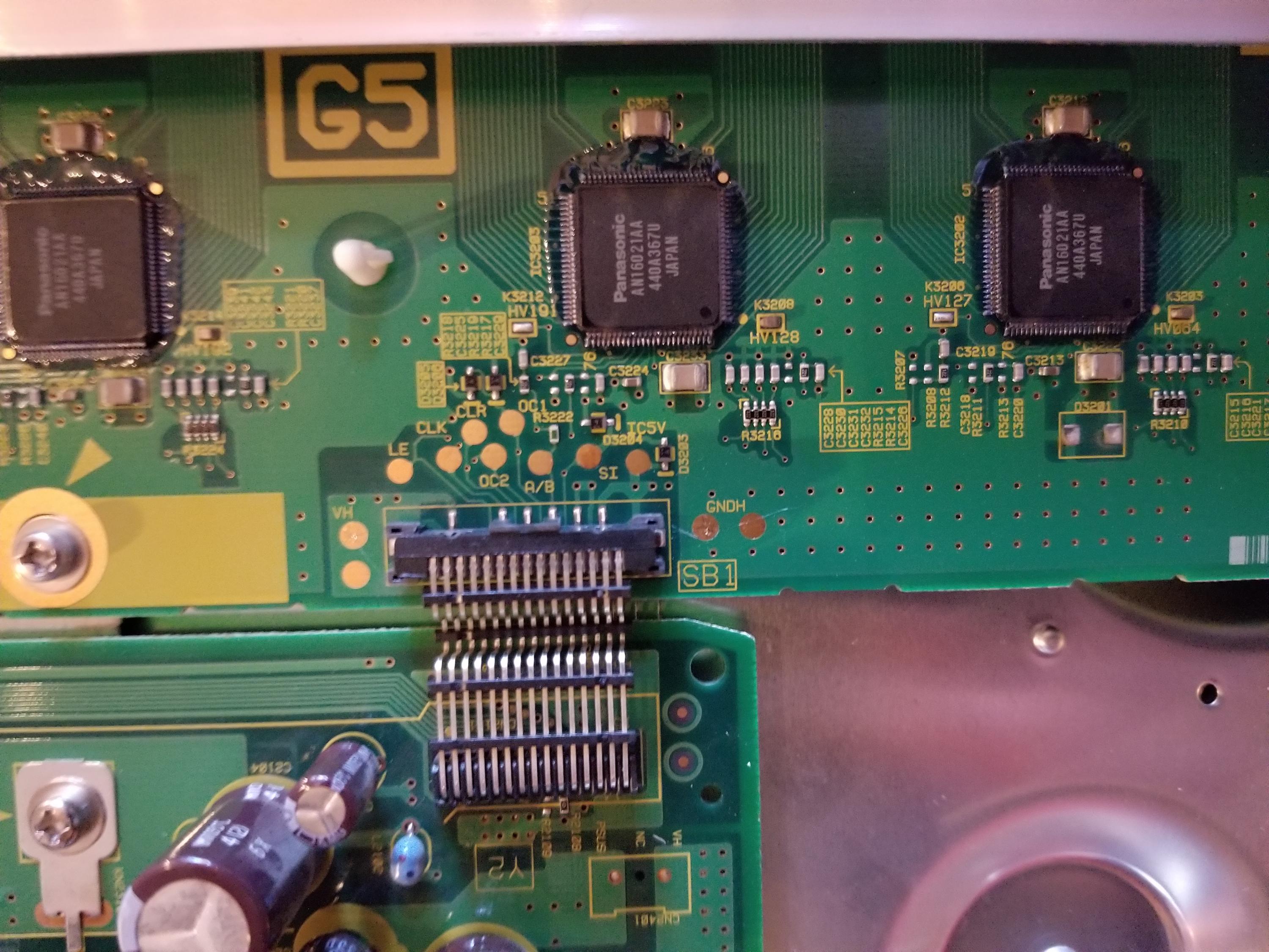

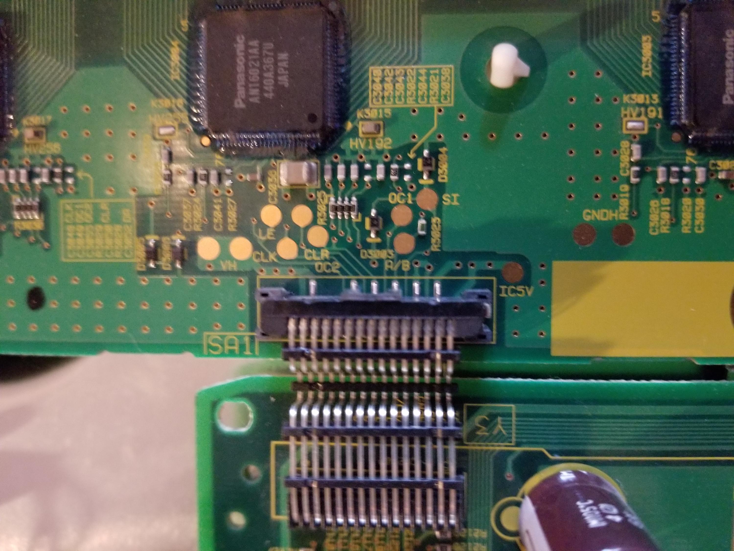

    How do you check VH to the floating ground? i.e. what is floating ground vs ground?
    • freakaftr8
      • Oct 2012
      • 3743
      #62
      Re: Pioneer Elit 1120HD Power Supply issue?
      the test pads on the scan board labeled GNDH. By the yellow bar printed on the scan board. there are two pads. Either works for a ground. Put your black lead there.
      • Boyd1966
        • Mar 2017
        • 128
        #63
        I found it. The first picture is the lower and the second pic is the upper.
        Upper - voltage showed 13 then to 1.
        Lower - voltage showed 14 then to 1.
        I did find this which seems to say the same thing you said except the 300 to 600 ohms. https://electronicshelponline.blogsp...-board-ic.html
