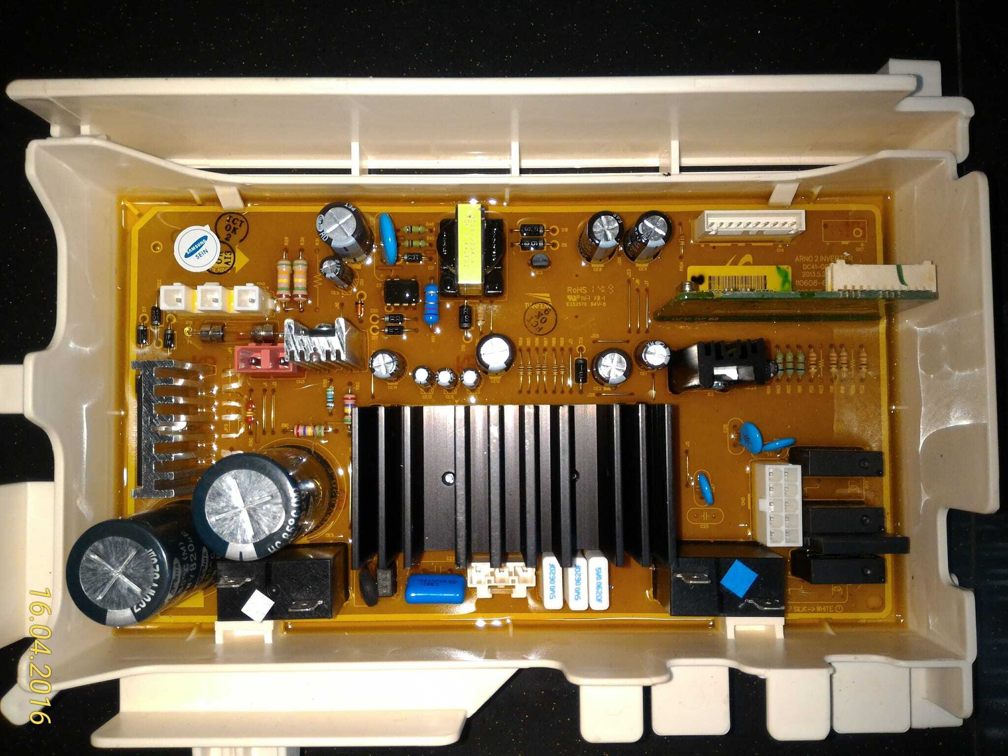

    Hi everyone,
    I am trying to fix a samsung washinmachine power supply main board.
    I already replaced it with another one to fix the machine but i want to try understand the issue with the old board.
    Therefore i hope to be able to get some help to explain what to check in order to troubleshoot.
    The power supply board reference is the following: DC41-00189a
    I have followed one thread (https://www.badcaps.net/forum/troubl...roblem?t=67604) and have done the following check:
    - Big relay (GT 1A 12D) click when 12v dc is provided and shows 0.00 ohm resistance
    - Main fuses are good
    - Main 2 big capacitor seems good (tested whithout desoldering but got good capacitance value)
    - Tested some diode too and didn't find one wrong yet
    Context:
    My washing machine used to run fine and some times when i started a washing cycle it would run and turn Off rondomly.
    I just had to switch it On again and push the resume button and it would resume the cleaning cycle where it left it.
    Given time, it started do it more frequently until a day where this was off and i couldn't turn it on.
    Hence I would give a little kick next to the power supply main board. It sometimes helped but only 2,3 times.
    Now I have not used the board for a long time (>1 year) and wanted to try troubleshoot it to learn more.
    When i tried it again on the washing machine it worked and was able to launch a washing cycle but shortly after it turned off.
    There is one special aspect with this faulty board. When it is connected to the machine and is connected to electrical socket we will here a continuous click from one of the big relay.: it will make contact (close) then open, again and again.
    When it was randomly working, it used to make it too but when it was working this cycle clicks didn't occur. In fact when connected to power socket it should click once and stay closed.
    Also, I found out that there is not constant DC voltage among the board: it is flickering (1v , 2v, 5v then 0v, 1v, 2v, 5v). It is synchronised with the cycling clicks.
    I noticed a smps transformer but not sure how to test it.
    Hence, if you have any help or suggestion, please let me know.
    Thank you in advance

      Hi. I would first clean the circuit board and check for any potentially sulfated traces, as well as cold solder joints and component contacts...optocouplers, etc. Best regards.

        I didn't notice any bad component or sulfated/overheated traces. Therefore to my eyes there is nothing looking wrong.
        I already tried to reflow some solder joint but not all (i vould say maybe 20% off all solder joint).
        I did it where I think there was big load of current and heat. To be more precise around big relays and capacitors and the chip behind the huge heat sink.
        But there was no improvment.
        Can someone explain the main principle of power supply main boards ?
        I understand there is 230v ac incomming from power socket but then ?
        Is it converted into dc directly within the smps transformer ?
        what about the bridge rectifier ?
        I want to try troubleshoot from the start to see what component is not providing its expected voltage.
        Here is a list of the main component i noticed:
        - 2 big relays (Gt 1a 12d - 25a 250v ac - 12v dc coil)
        - 1 big bridge rectifier
        - 3 smaller relays ( 12v dc coil)
        - one smps transformer with 5x2 pins
        - one pwm controller next to the smps transformer
        - 2 voltage regulator (one 5v output and the other is 15v output)
        - one big component (icmp ??) That is beneath the huge heat sink
        - 2 big capacitors 820uF 250v
        - other small capacitors
        - bunch of fuse, diode and resistance
        I consider myself a newbi but want to learn.
        In addition to the test made on relays, capacitors, diode and fuse, I have replaced the pwm controller but nothing changed.
        My guess is that nothing will work if no constant dc voltage is provided... so trying to check where the ac is converted to dc and how.
        Hope this can provide additionnal information.

            As for the clicking relay. Is it the main AC relay that clicks in the corner? There are 3 things to check. One you already did and that is the relay. Then there is a DC enable circuit and there is a 12 or 15V regulator and with that there are some capacitors to check too.
            While your at it, take that big heatsink off like in the vid on the second link and put new paste. Also desolder and resolder that IC with fresh solder.

                        Here it was ! There were two black spot on 4 pins of the big IC. Following the provided schematics (thanks again ) it is a IKCM15F60GA.
                        I had a lot of difficulties to desolder and remove it. I damaged two trace and there is a small hole into the board now.
                        I think I can manage to fix those later.
                        At this point I am not sure if this faulty component was the cause of all this or if it is only a consequence of another failling thing.
                        I tried to check the component linked to those 4 burnt pins but everything seemed fine (caps, resistor, diode).
                        So...... I ordered another IKCM15F60GA, a new bridge (just in case) and a fuse and will try again when possible xD.

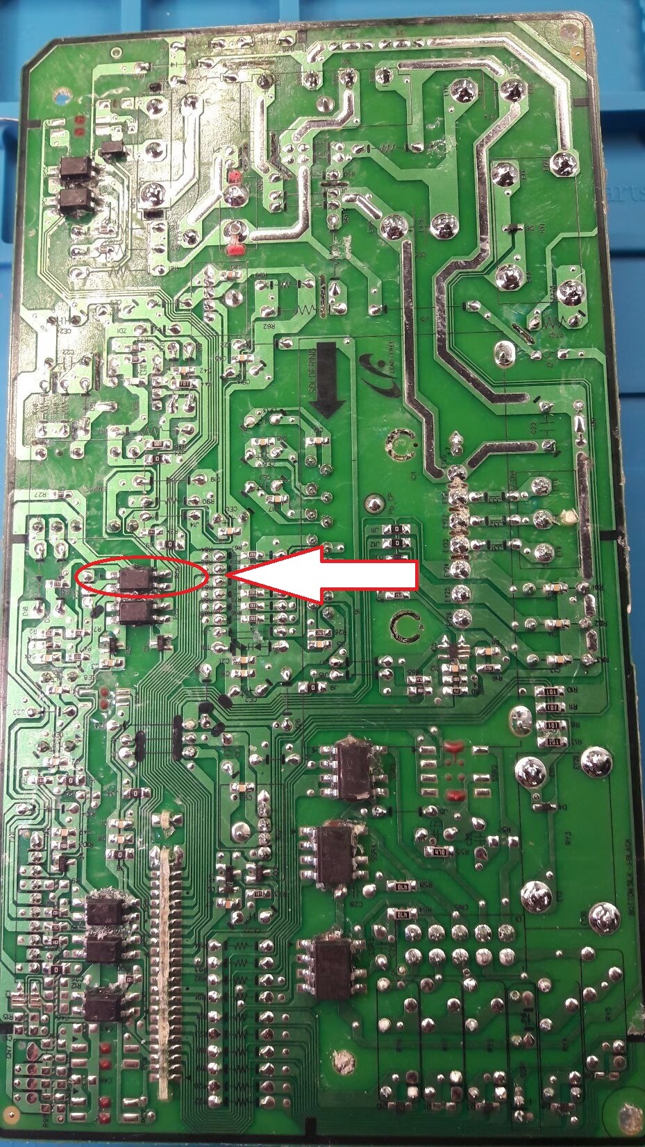

                              Look at what PC1, 3 & 5 do on the LED side of the optocoupler. I wonder if the voltage is steady or is on off like the relay clicking.

                                I remember checking those at the begining. If I remember well there are arround 6,7 of optocouplers at the back side of the board.
                                I tested in diode mode the input side (only passing in one direction) and also checked that there was no short between input and output side. However I didn't check the voltage.
                                I will check them tonight and revert. Thanks for the idea and don't hesitate if you have any other ones

                                  I wonder what they do if it's clicking or not clicking. But I think is something with the power supply. Check the PWM VCC what happens to it.

                                    I took this opportunity to write down the voltage around these optocouplers in 'stand by' mode and 'On' mode.
                                    I remember that before I replace the PWM IC I found flickering voltage at VCC pin.
                                    I will try make it fail again so that I can check again for the voltage of those.

                                        Hello all,
                                        I come back after long time to provide feedbacks on this topics and the encountered issues for everyone.
                                        After checking the voltage i didn't found the root cause of the issue. So I ended up changing all optocoupler as it was cheap. I found one faulty in diode mode. After replacing it the board was not clicking anymore and the washer was turning ON (in attachment the faulty one).
                                        I am sure to have check them all before but I guess this is the tricky part with "randomly" working.
                                        Hence, the flickering voltage and the issue was gone but after that and surprisingly the motor kept blocking.
                                        In fact it was trying to move but kept stopping as if it was blocked. After checking that the drum was not physically blocked I ended up replacing some component.
                                        At last I ended up replacing the big chip beneath the heatsink that was replaced previously and was almost new (IKCM15F60GA) and all issues related to the motor were fixed.
                                        So It is working now for 2 months and it seems that it is fixed for good.
