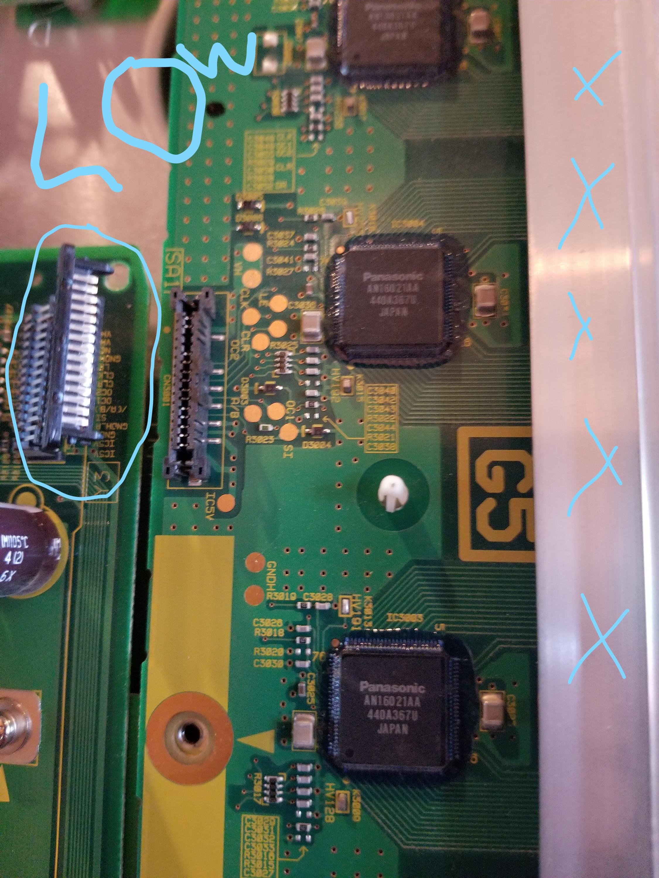

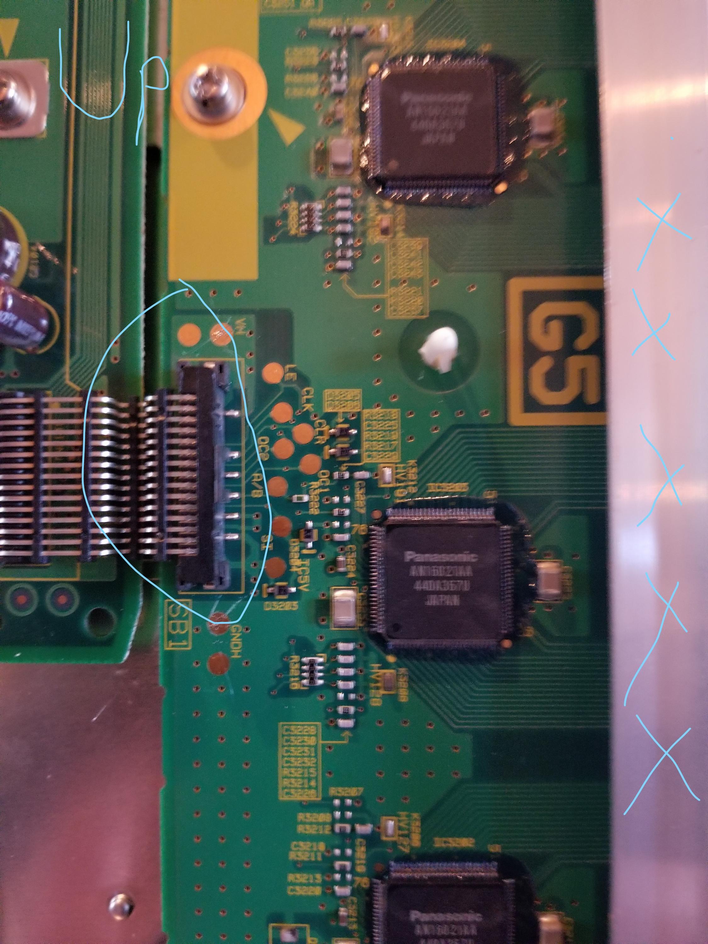

    interesting.. I can only assume there is a short on that lower board then. But 4 blinks points to an X drive DC/DC converter circuit failure.. At least from the manual i'm looking at..
    129 seems a bit low still to me. Maybe i'm wrong..
    Can you look at the other side of that board where it attaches to the panel. Is there clamp in connections to those ribbons or are they fused to the scan board?

      On each L and U board there is a ribbon in the back that is fused to the boards and covered by a aluminum panel (Xs in picture). There are connectors to each board. The U connector rated 129 (as I said before). The L connector (circled) rated 130 to 150. See pictures.

        Ok so your'e saying the lower board disconnected, showed 129 oh VH testing this point from the upper of course.
        And Upper showed 130 to 150 testing VH from the lower board testpoints?
          #84
          Re: Pioneer Elit 1120HD Power Supply issue?
          So whichever board causes the drop in VH when it is connected has a short.
            #85

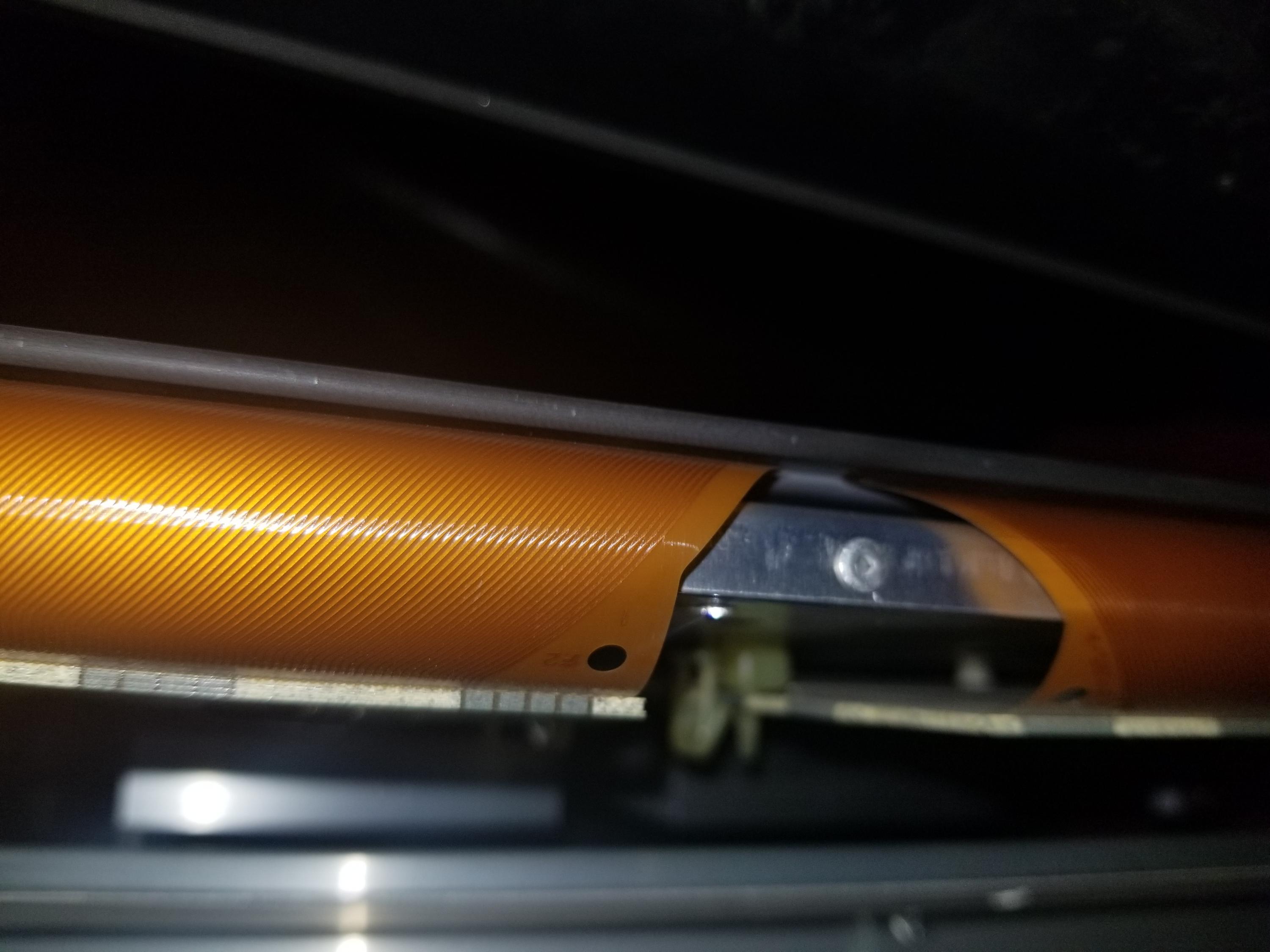

            If the connectors are fused to the panel it will be very hard to repair indeed.
            We can hope that it is possible to remove them? Can you get a picture?

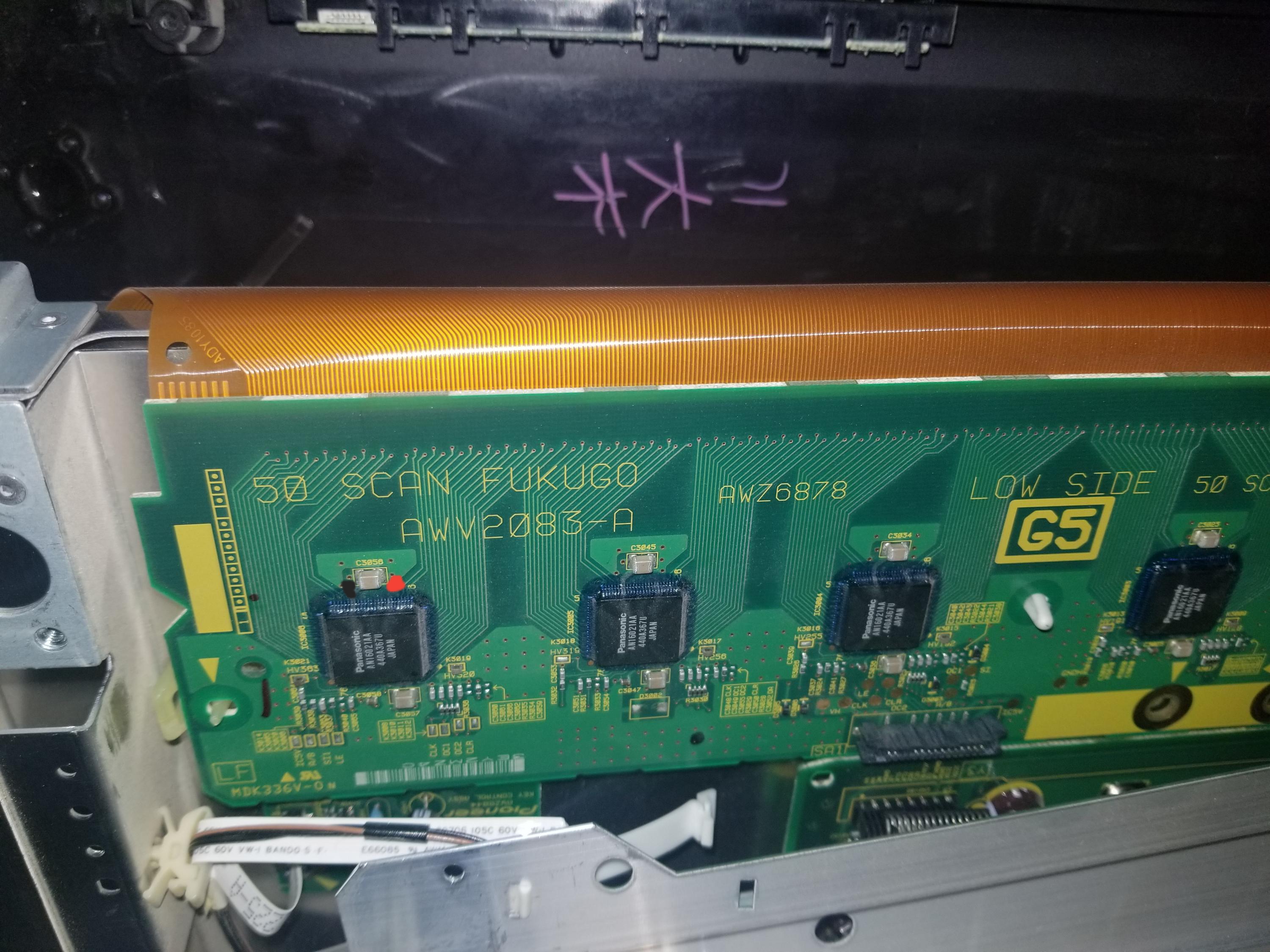

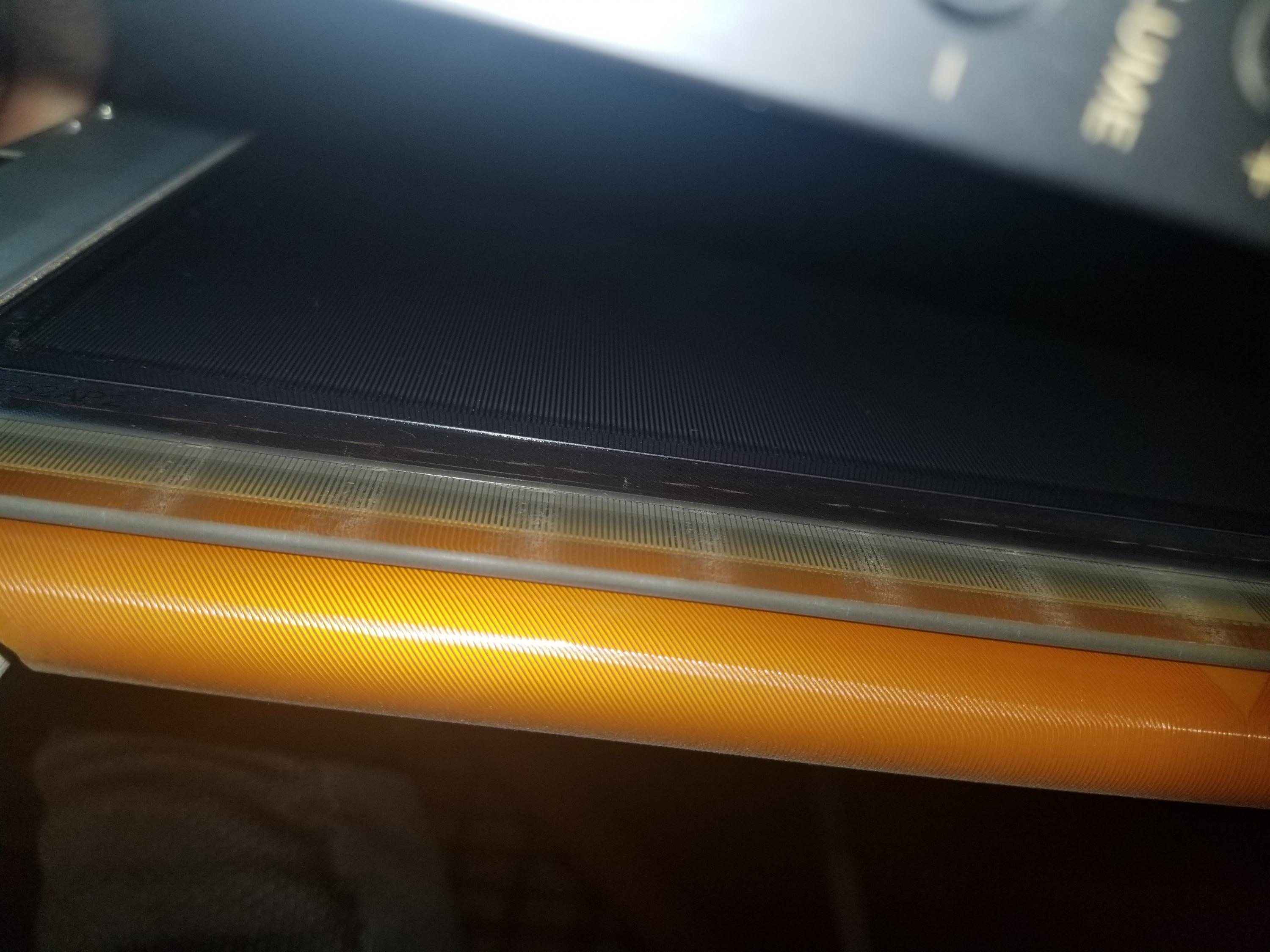

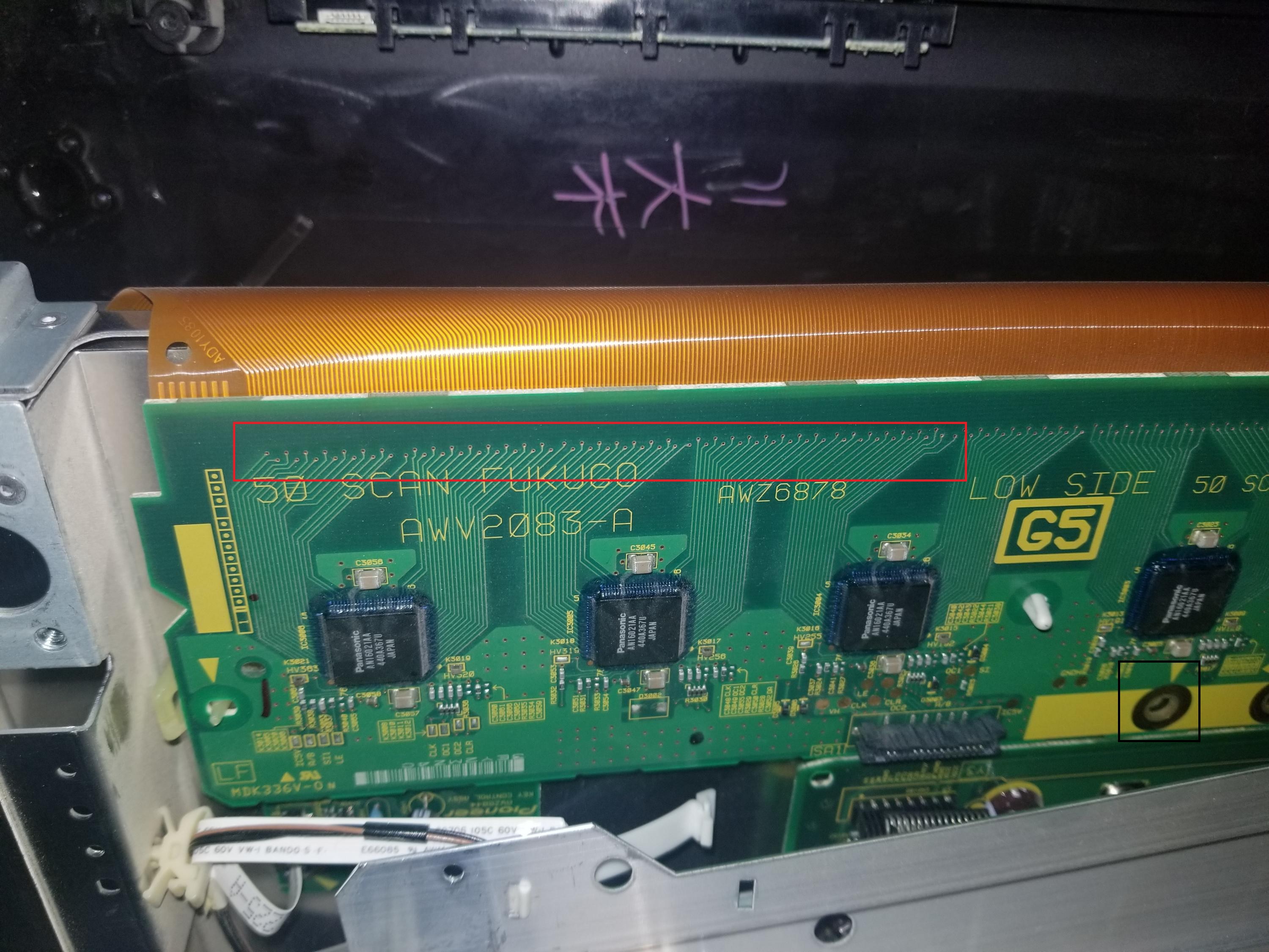

                I will see if I can remove the aluminum panel and see where the ribbon goes and if it is fused to the panel.
                • Boyd1966
                  • Mar 2017
                  • 128
                  #88
                  The pictures show the ribbons to the L and Y boards and it looks like they are fused to the panel as well.
                  What about replacing the black square IC scans?
                    So the lower board connected in circuit is the one causing the dropout in VH? Sorry got a bit confused a few posts back.
                    The Scan ICs are replacable, however it is a very tedious and patent process. We need to find out if one or more of those are indeed shorted out

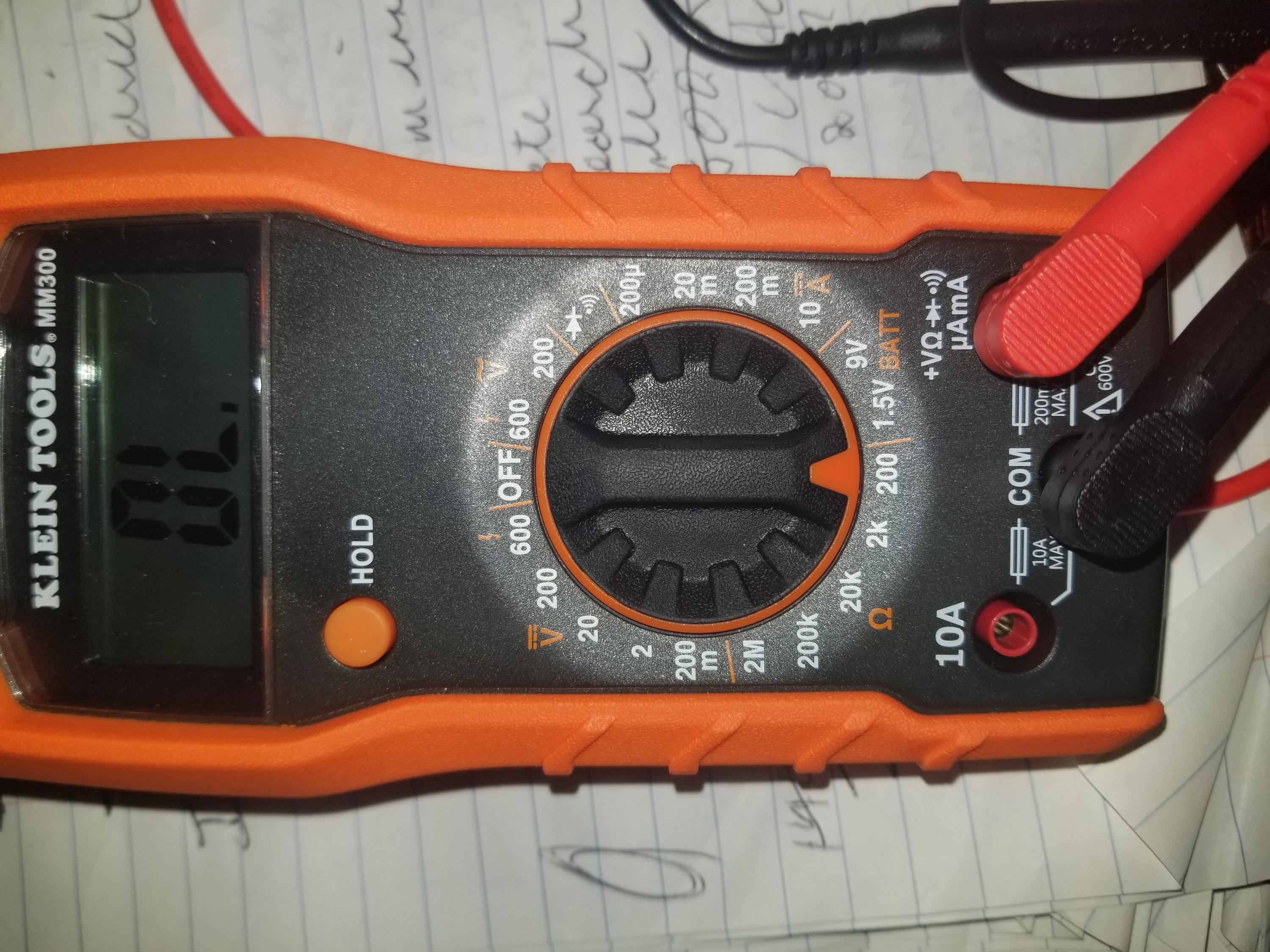

                              Maybe try this in OHMS setting on volt meter. This is a setting that looks like a horseshoe. Red probe to where I have the red dot, black probe to where I have the black dot. Read each one of those up-and-down the lines of each scan board

                                Should I have everything connected before I do that? Please be specific in ur instructions. I really appreciate everything u guys are doing but I have no idea what I'm doing other than trying to narrow down the cause.
                                • Boyd1966
                                  • Mar 2017
                                  • 128

                                        You should be able to check from red to black here on ohms.
                                        Check on each of the vias (micro-drill holes) that are exposed, if your meter has continuity it will make it easier because there are at least 300 on one board. You can run it along each contact and listen for a beep. Check all the ones near the plasma panel not just the ones I've highlighted.
                                        A short from the output channel to the floating ground (black) is bad, it means one of the ICs on the scan driver board is bad.
                                        You asked before about floating ground. Well plasma TVs are a bit odd in how they work. The X-electrode driven by the X-main/Z-sustain board is common to all rows. But the Y-electrodes are separate because they contain a row selection signal that needs to be applied to the pixels appropriately.
                                        The plasma Y-main output is swinging all over the place from -200V to +200V, the waveform is kinda complex, but in the middle of this, there's a row selection signal, that is VH, which is applied to one line at a time. So you need to be able to "superimpose" VH (~150V) onto the plasma panel but only one line at a time. That is what the scan / "buffer" ICs do. They do not buffer anything. They are only used to switch between the floating ground and the floating ground + VH signals.
                                        The problem is if VH is shorted by one of these scan ICs then other power supplies on the Y-main will shut down so you will get a distorted image then the TV will turn off due to protection. On some TVs you see no lines selected, on others you see every line selected (vertical lines down screen). Or in the case of this Pioneer it's a kind of partial full discharge of the panel... It depends on the technology.
                                        The long and short of it is sadly if we cannot replace or repair that board then the TV is dead.

                                          Shawn - What ohm value should I look for and look at the pic of my meter and tell me what ohm setting I should use (2M, 200k, 20k, 2k, or 200).
                                          Tom - Can you clarify "Check on each of the vias (micro-drill holes) that are exposed, if your meter has continuity it will make it easier because there are at least 300 on one board. You can run it along each contact and listen for a beep. Check all the ones near the plasma panel not just the ones I've highlighted."? I see the micro holes but how do I know if my meeter has continuity and which hold for the black probe and which one for red probe? Also is this different than what Freak told me to do?
