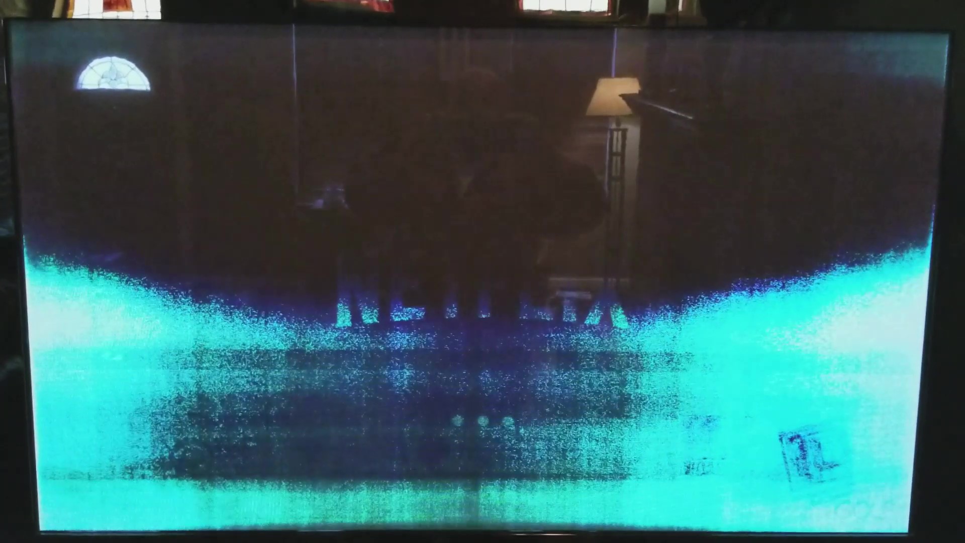

    ISSUE: When turning the TV on, the screen flashes on then hear a click and the TV turns off with the red light blinking. attached is a pic of the screen right before it shuts off.

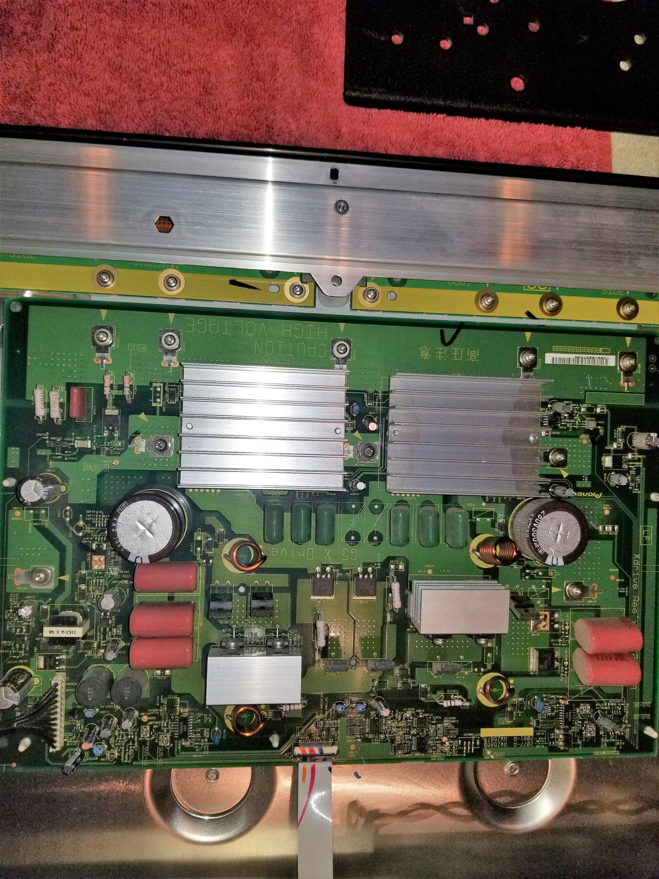

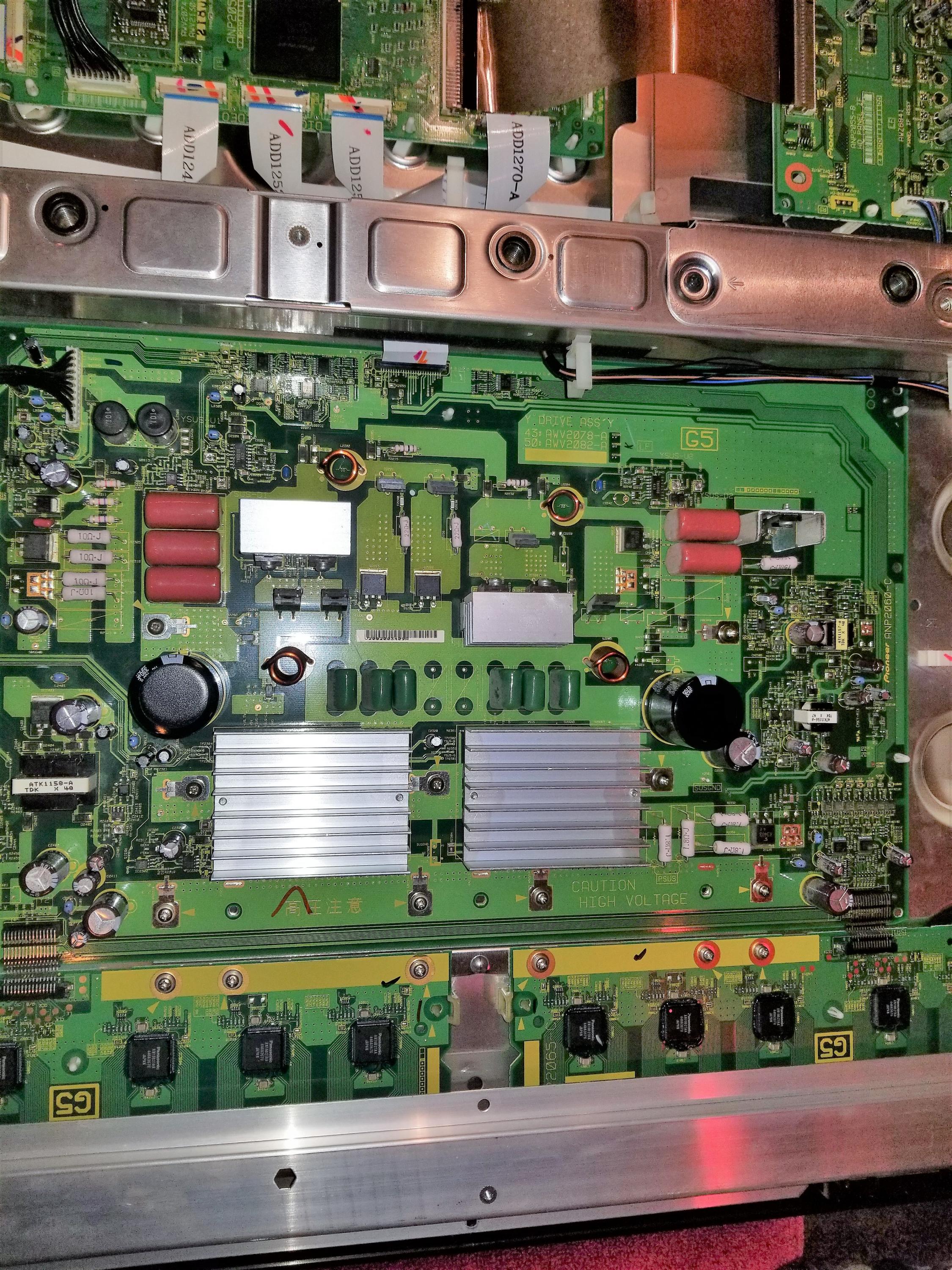

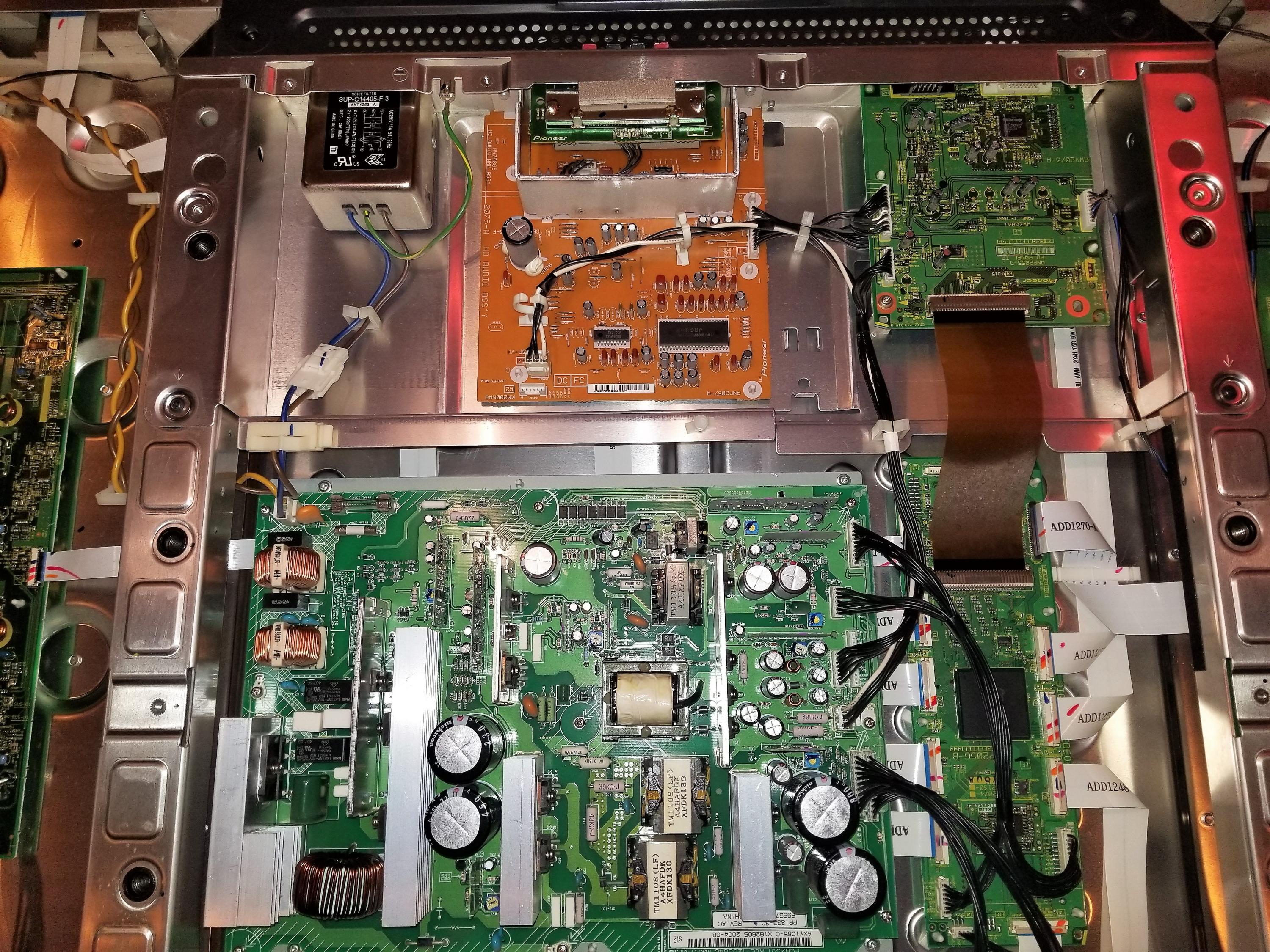

    Hey it's been a while! Looks like sustain board issues. Can you snap clear photos of the power supply, Y and Z boards?
      Re: Pioneer Elit 1120HD Power Supply issue?
      Yeah it has been awhile but I was hoping not to be back so soon!! Here are the pictures you requested. Let me know if you need close ups but hopefully you can enlarge them if need be.

        On the Z board, unplug the connector that feeds VSUS. Power on and see if it stays on.
          U forget I don't know what I am doing. ..which is the Z board? And where is rhe VSUS?
            The board in your 2nd picture

                  OK you can try plugging That side back in and unplugging the connector off the opposite board

                            The picture I posted originally is what happens during the few seconds before it shuts off. For example, I turn on the tv and the image of the picture I posted shows up for a split second and then shuts off.

                              This is a shutdown because one or more of voltages are out of spec in judging by the picture I'm seeing it looks like VSUS is low
                              Now this could be caused by a sustain board problem or a power supply problem as we need to figure out.
