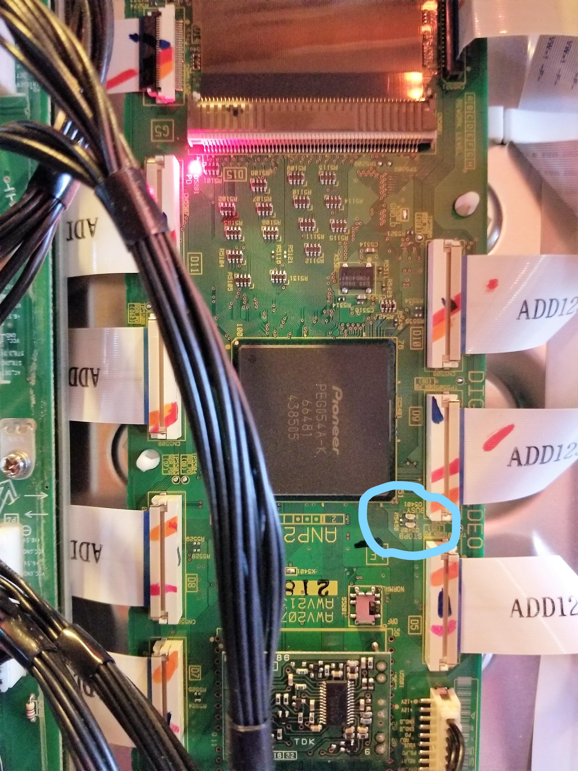

      I heated up c2304 and nothing changed. Still turns off to 3 blinking red lights. One thing I didn't mention is on this board (pictured top left corner) is a constant red light when the front panel is blinking 3 times. The blue circle, a green light comes on right before the 3 red light sequence comes on.
      • freakaftr8
        • Oct 2012
        • 3743
        Re: Pioneer Elit 1120HD Power Supply issue?
        That's the control board and the red light indicates an error.
        Might need to get a Volt meter and check over the VSUS voltages. Power supply is definitely shutting down to over voltage under voltage over current under current. Something like that however it looks like you're VSUS is significantly low Considering the picture you have before the shutdown. Now something shorted on one of the boards could be dragging this voltage down sending it into protection mode

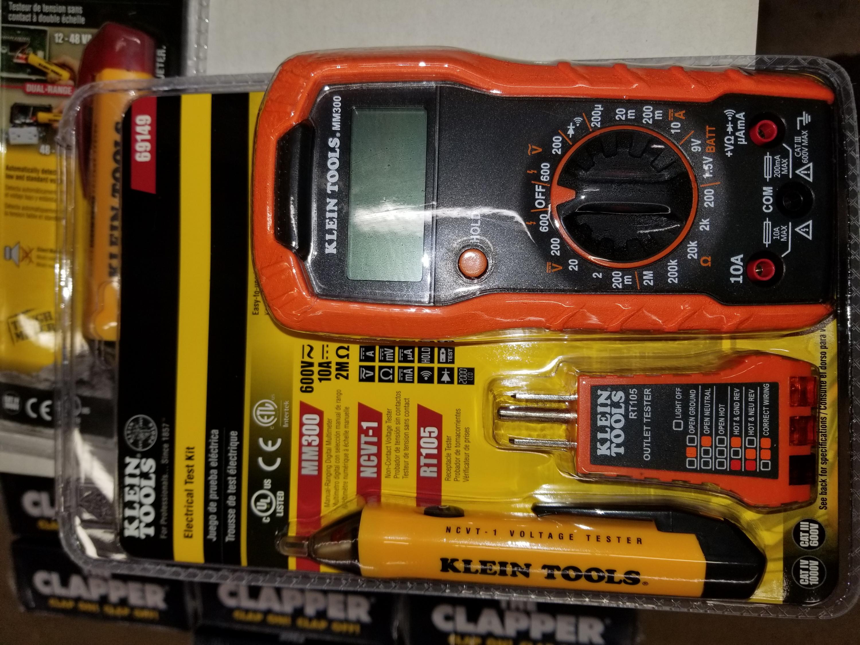

          What kind of voltmeter should I get? I am going to Home depot now.

            One that has a digital display and can read A.c. and DC up to 400v
              Like this one?

                Yes that will work
                  That is fine, make sure it's got the probes with it (should do)

                    It does.

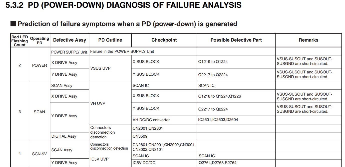

                      The 3 red blinking light pattern indicates a short on the X, Y or scan ICs which are considered the buffer board. ( Let's hope it is not the buffer board as I don't believe those are replaceable on that model. Maybe Tom66 knows.
                        #31

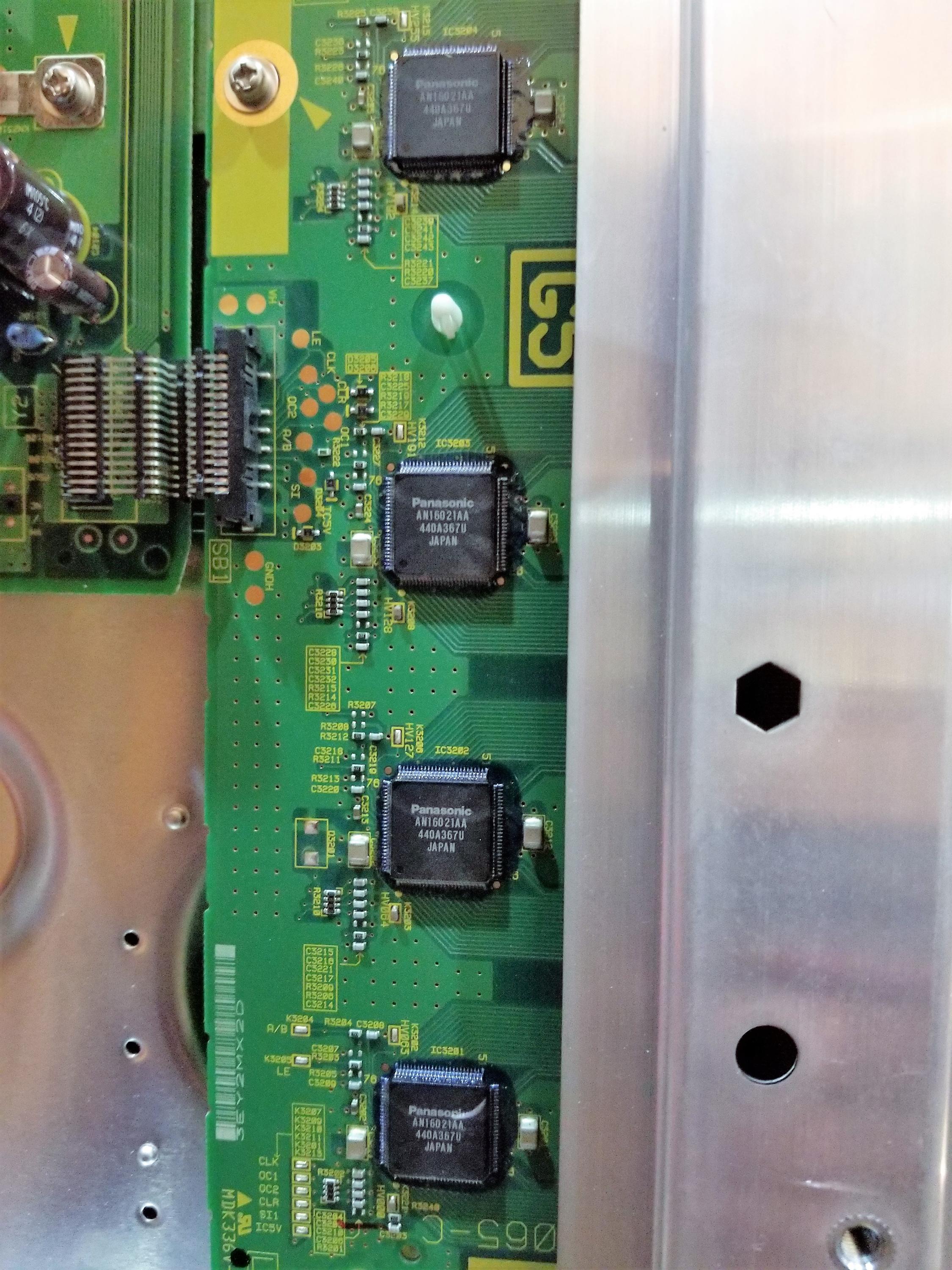

                        Unfortunately I can't find a service manual for this model. However, it is likely the same for other models.
                        Since you have 3 blinks and a lit panel it is not likely to be VSUS-SUSOUT short, etc.
                        It is more likely to be VH or VMSK fault, or Scan IC fault.
                        On some Pioneer plasmas the buffer "boards" (Scan IC) are part of the panel ribbons. They are quite reliable, and I would not expect them to fail, especially because Pioneer use 48- and 64-bit ICs (lower power density) when most manufacturers were using 90-bit ones at the time. However, it is conceivable that there is a fault on them. In which case the best you could do is to try and remove and replace the IC on the ribbon, the ribbon not being directly replaceable. It depends on which model of TV you have, I know the PDP-LX5090 and similar 9th generation Pioneer sets used this system which would mean scan IC death would be effectively fatal. Your set is older however so it is another matter.

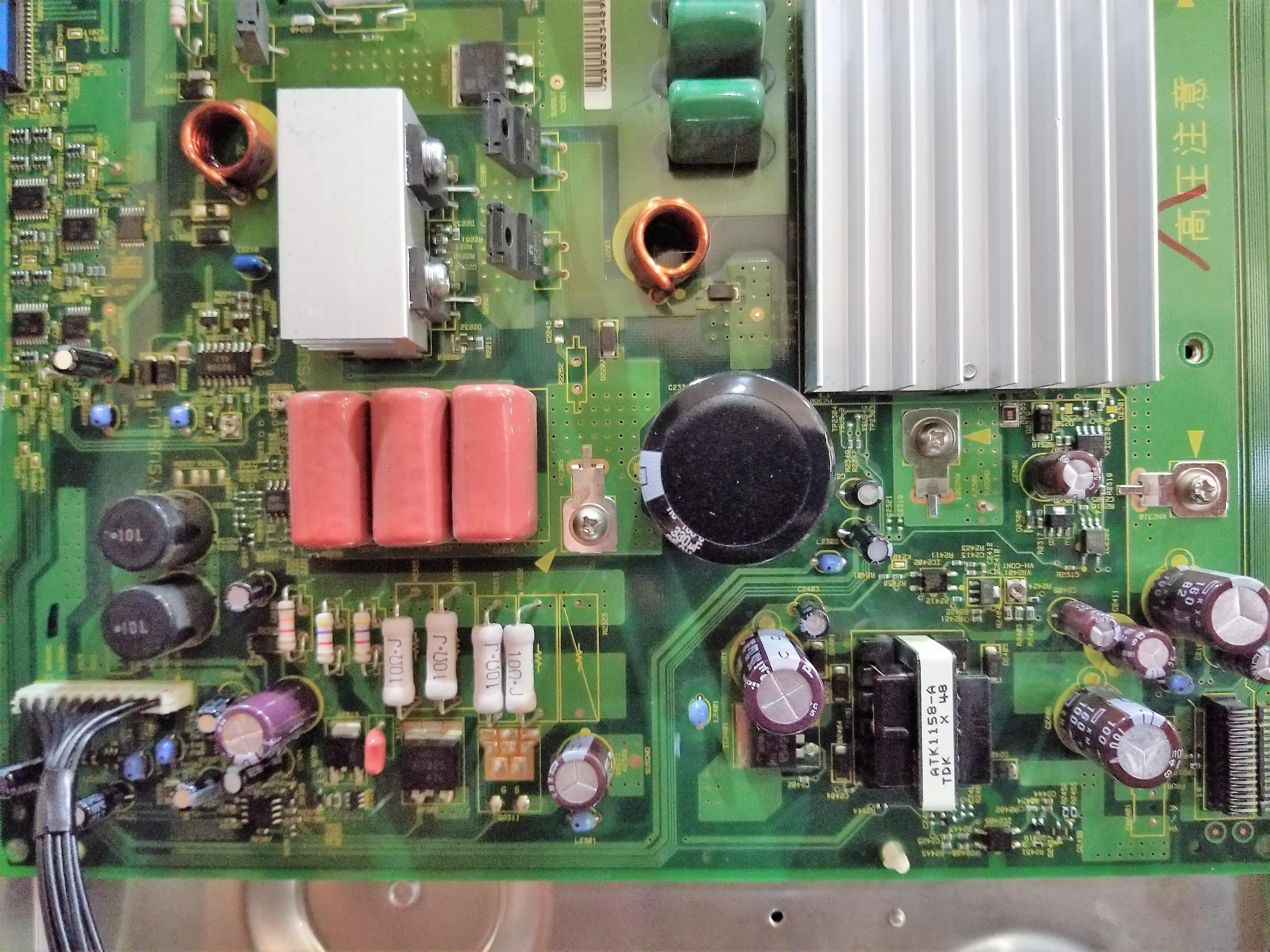

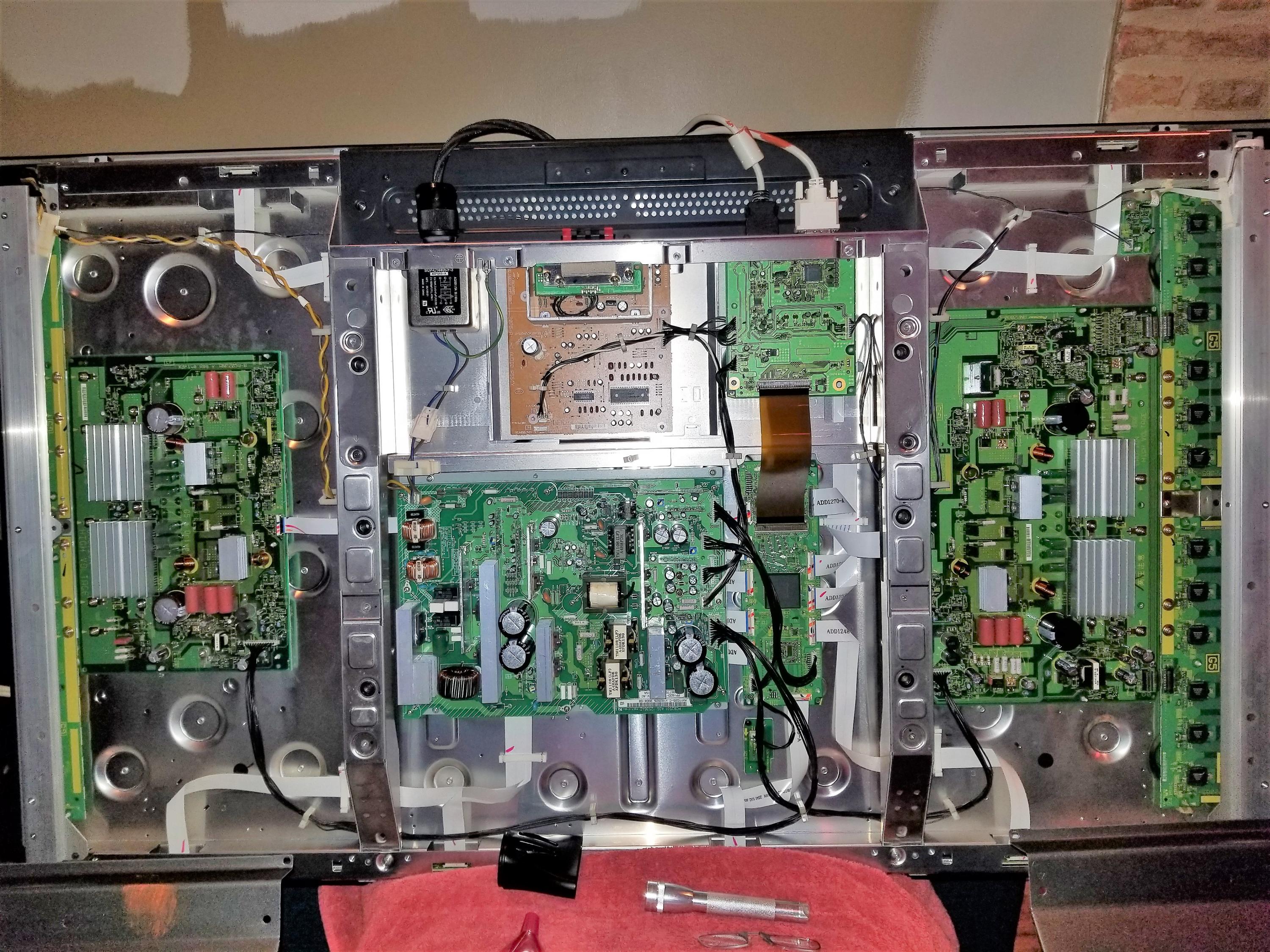

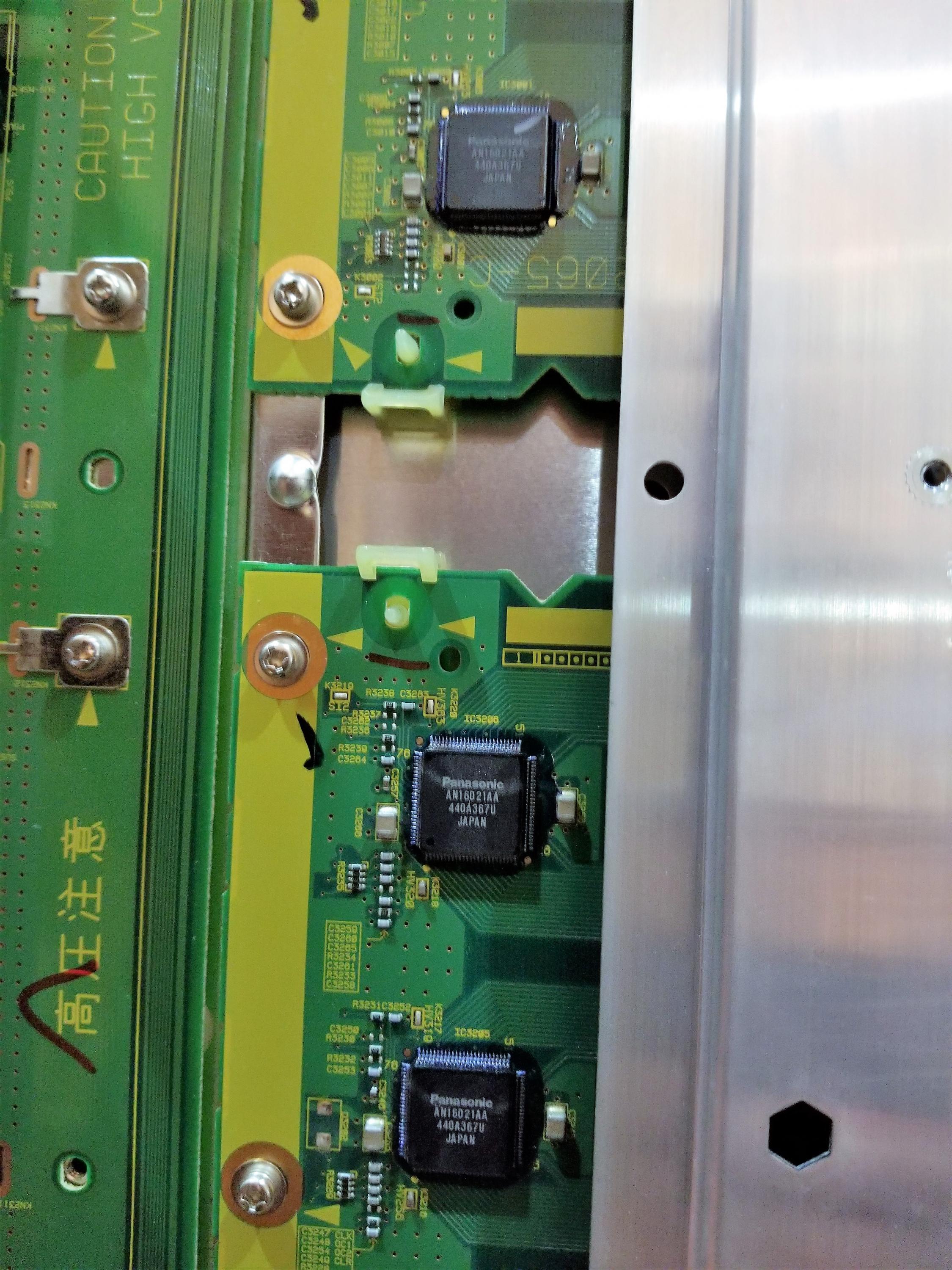

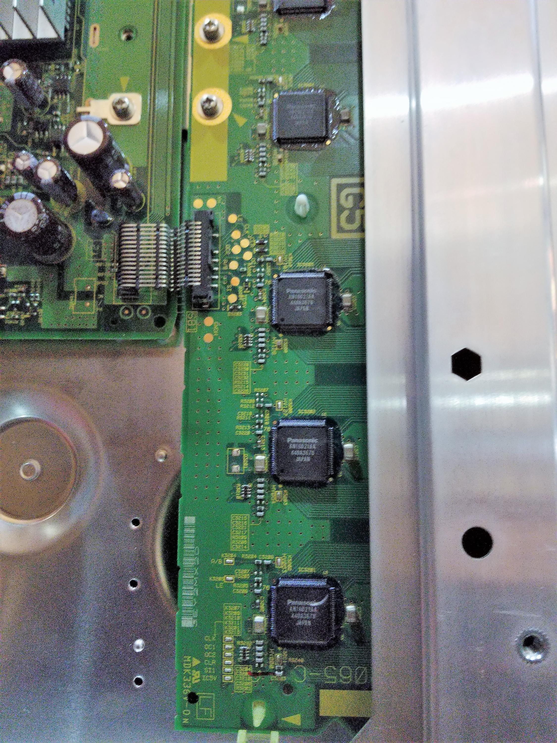

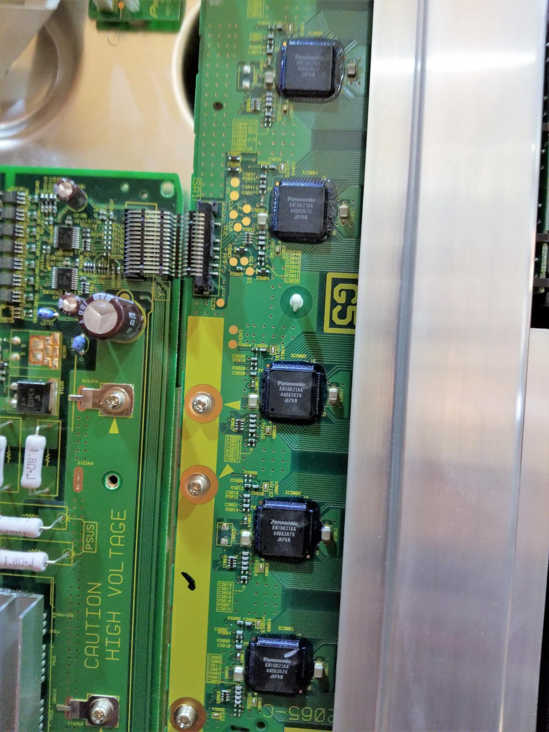

                          Ok guys.... much appreciated the feedbback....BUT what should my next move be? I need step by step instructions....as you know by now, I am learning as we go. If I have good direction, I can accomplish anything you say....ultimately I just want to know if this plasma is toast or not. ....so since this is older (one of the first pioneer elite plasmas's) what information do you need to know so I can go and diagnose?
                          I do know the ribbons connected to all of the boards seem to be replaceable from what i can see. If you can tell me to take a picture of positions of the boards, we will know for sure. Right?
                          P.S. The TV started to screw up when I was streaming Netflix and it just hung there for a few minutes like it was clunking away and processing .i.e. working hard....then it just shut off. Thats when I tried to turn it back on and ...you know the rest.... 3 blinking red lights.
                          See picture. I added a full view of the plasma. The exterior power and display connections are on top, the tv is upside down. I thought this might help you see the ribbons connected to the boards.
                          Scan ICs are on the right? The square chips? Can I use my new voltmeter?
                          We can do this!!!!! We can rebuild the TV. We have the technology. We can make the TV better than it was. Better, stronger, faster!!!!

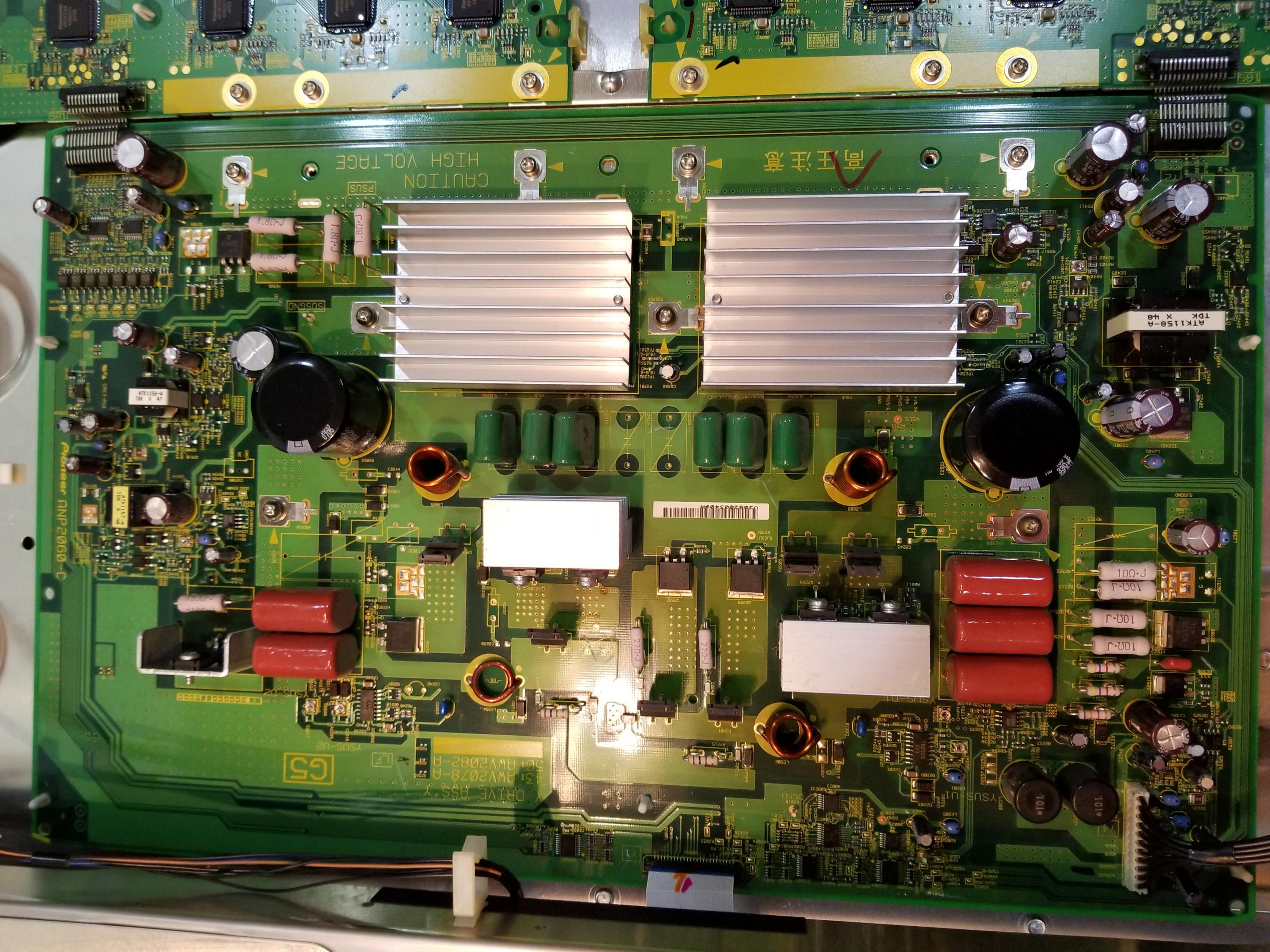

                            Could you take a good clear photo of the Y board. Try to get good lighting and eliminate the Flash on the camera if you can

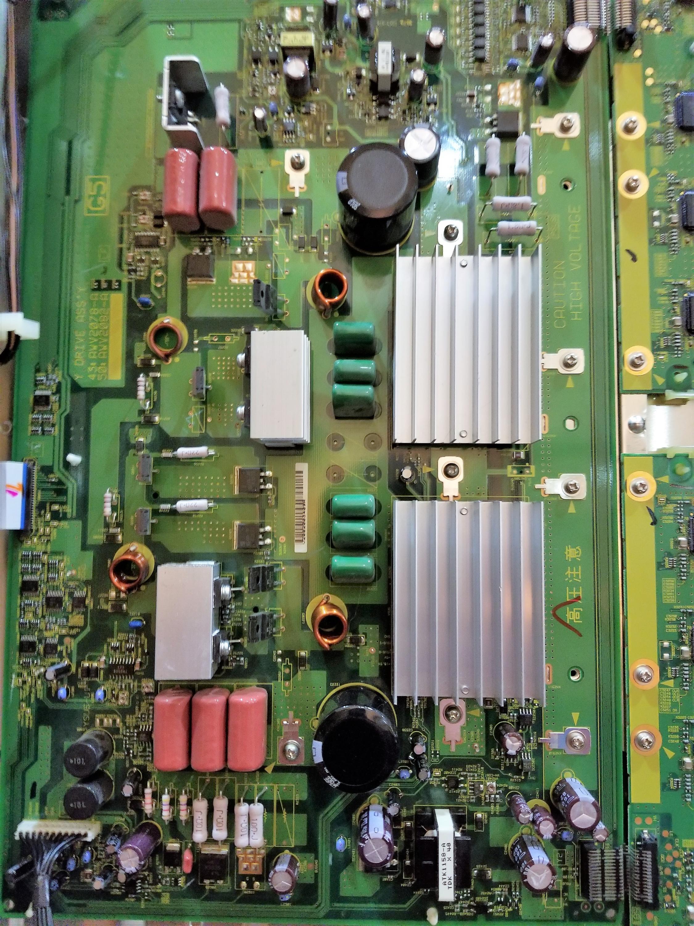

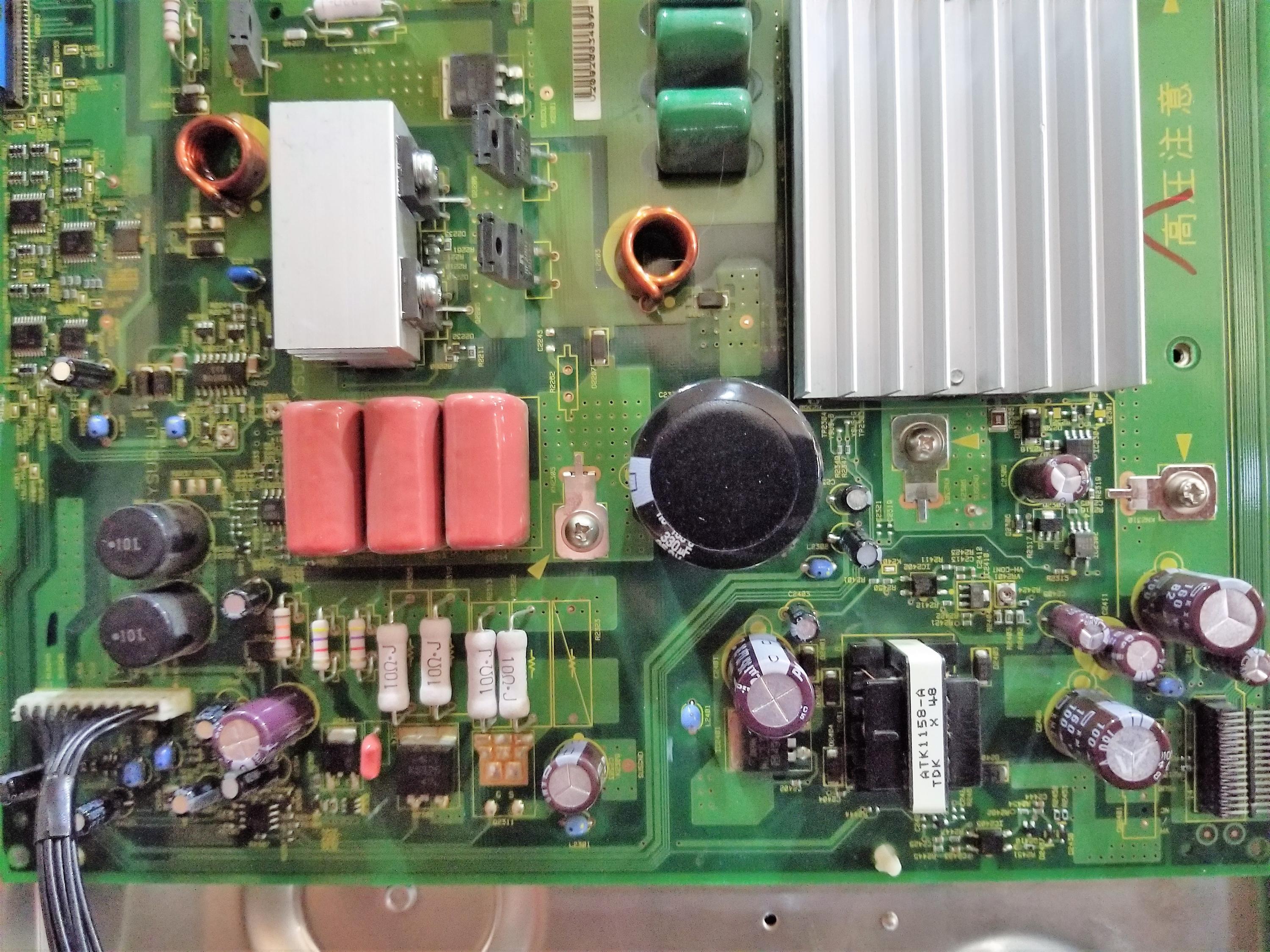

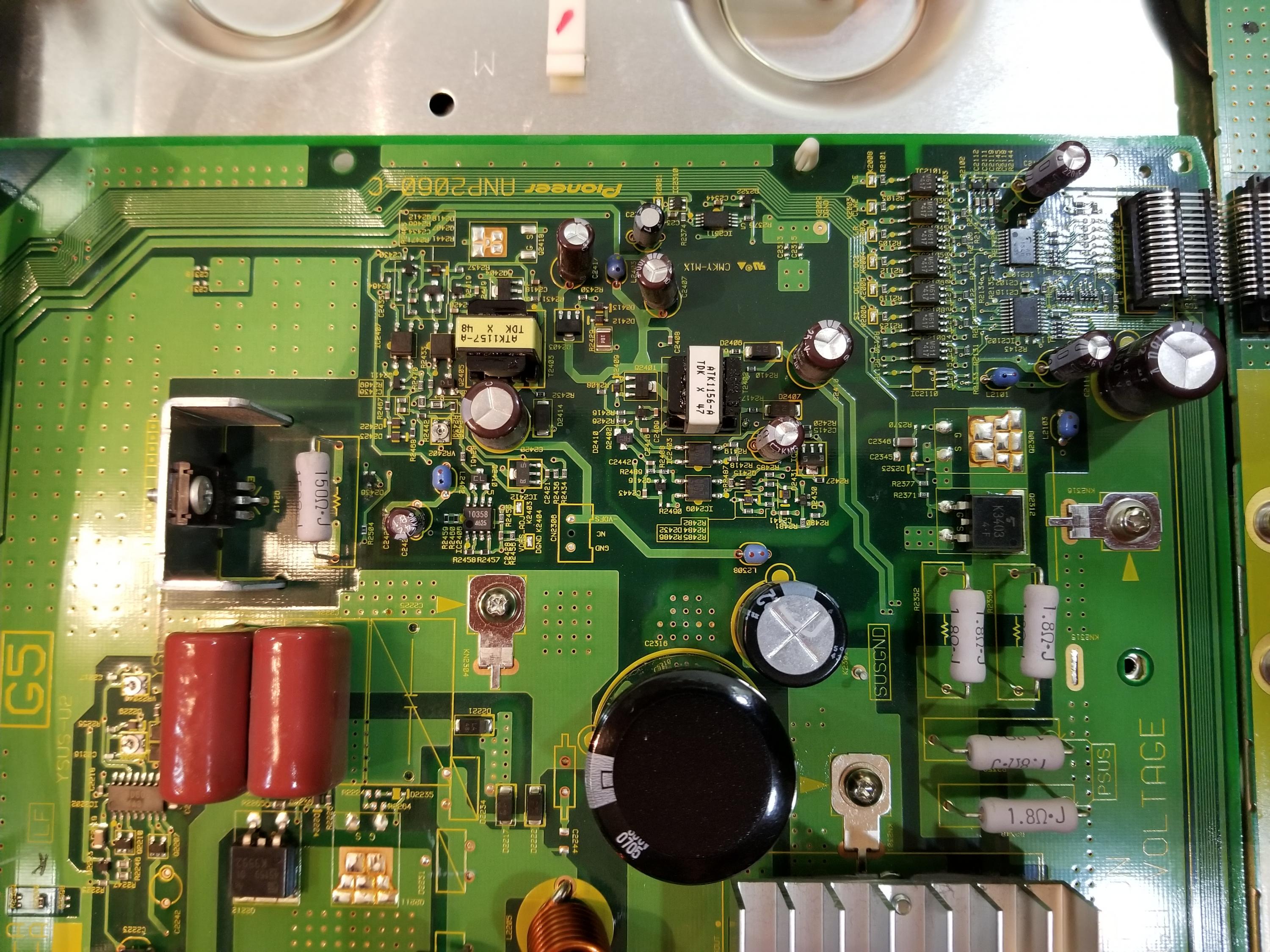

                                  Yes Netflix on the TV just froze, nothing would happen, then the TV just shut down. And then when I tried to turn the TV back on, the image in my first photo in this thread shows up for a split second and the then the TV shuts down to 3 red light mode.

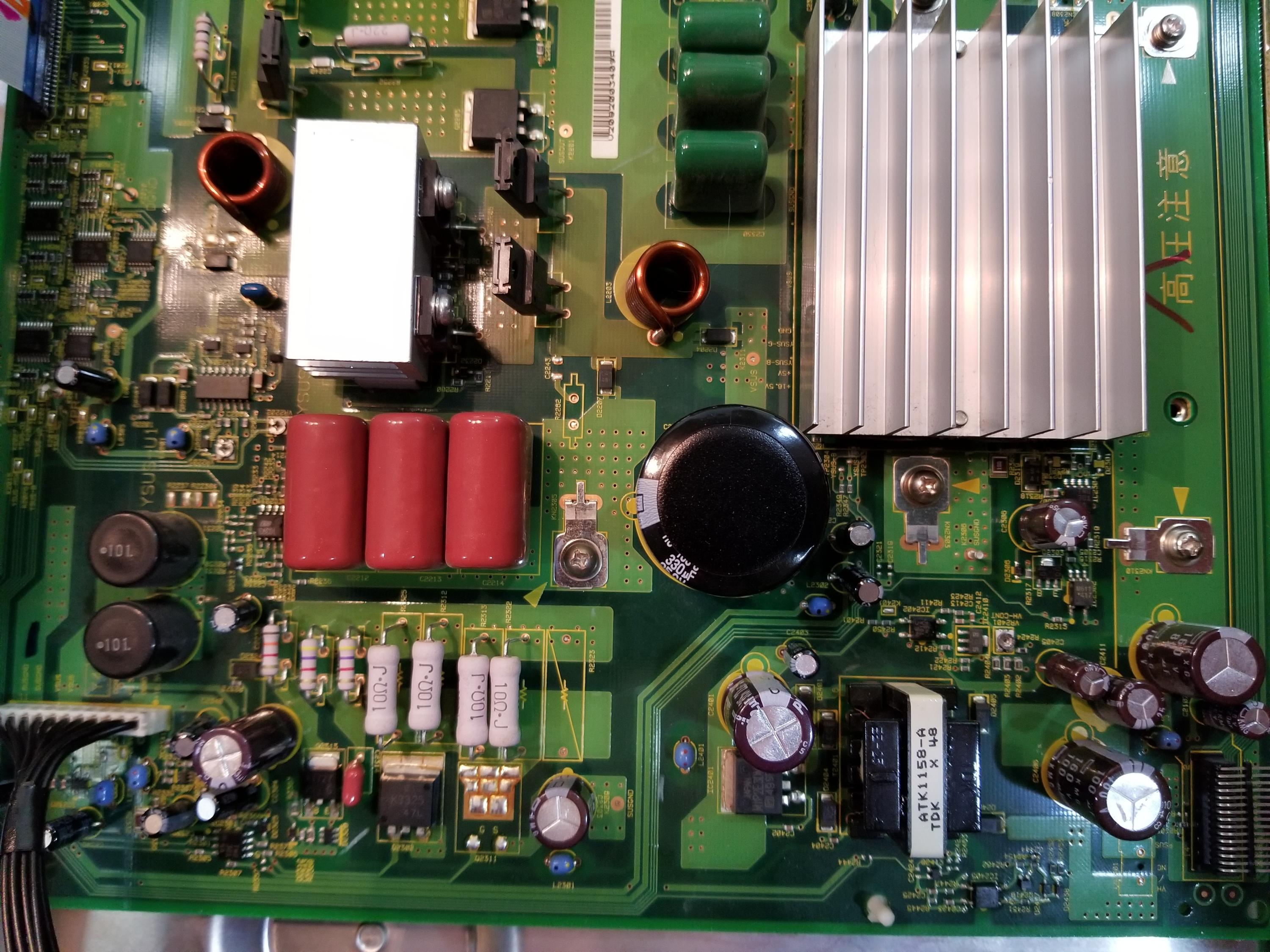

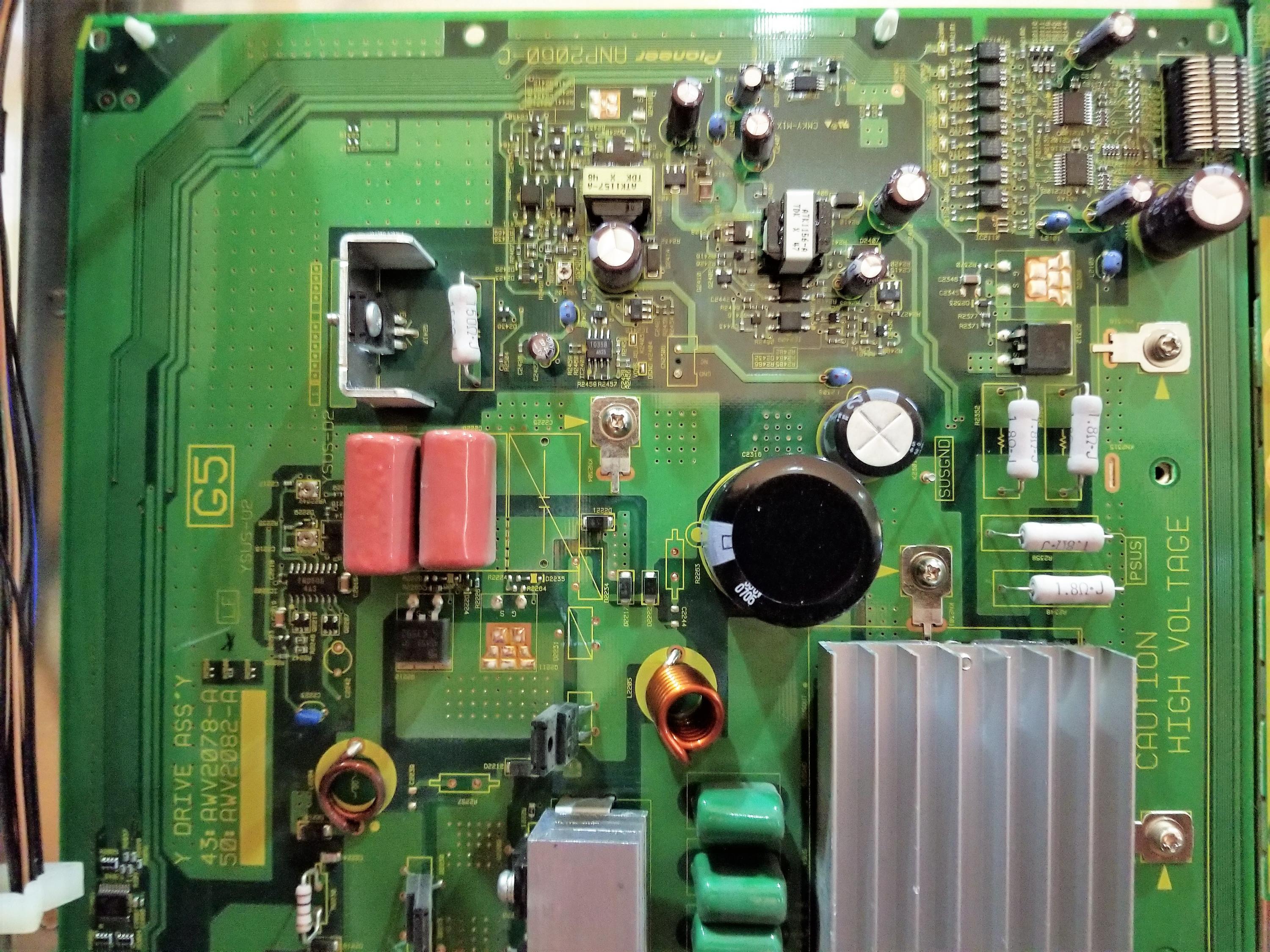

                                  Here are the pictures of the Y board. I hope they are clear enough otherwise I will need to put the TV on a table under an overhead light.

                                    These might be better pictures of the Y board.

                                      OK can you probe VSUS with DC voltage setting on your voltmeter set to 400vdc. Black probe to chassis ground And red probe to one of the pens that go into the Y board labeled the VSUS. Read what it says it's probably gonna be quick before it shuts down
