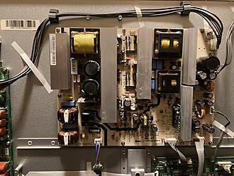

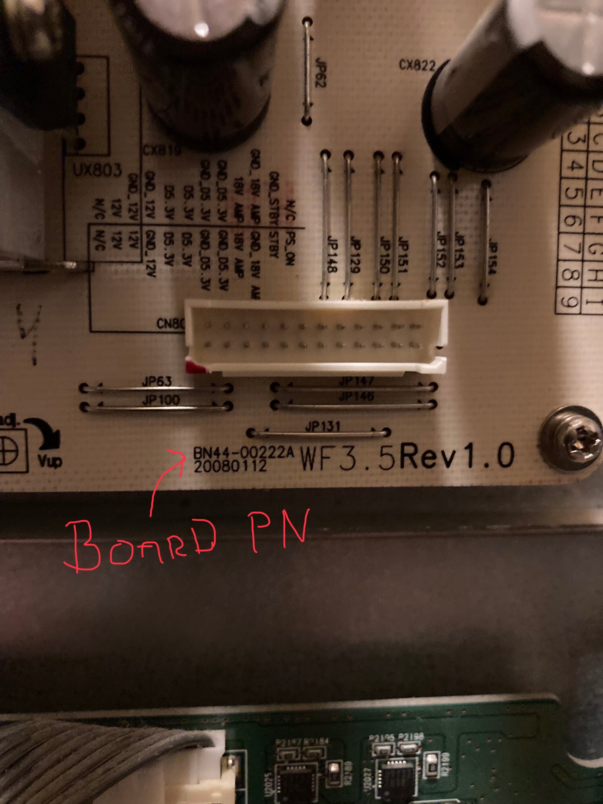

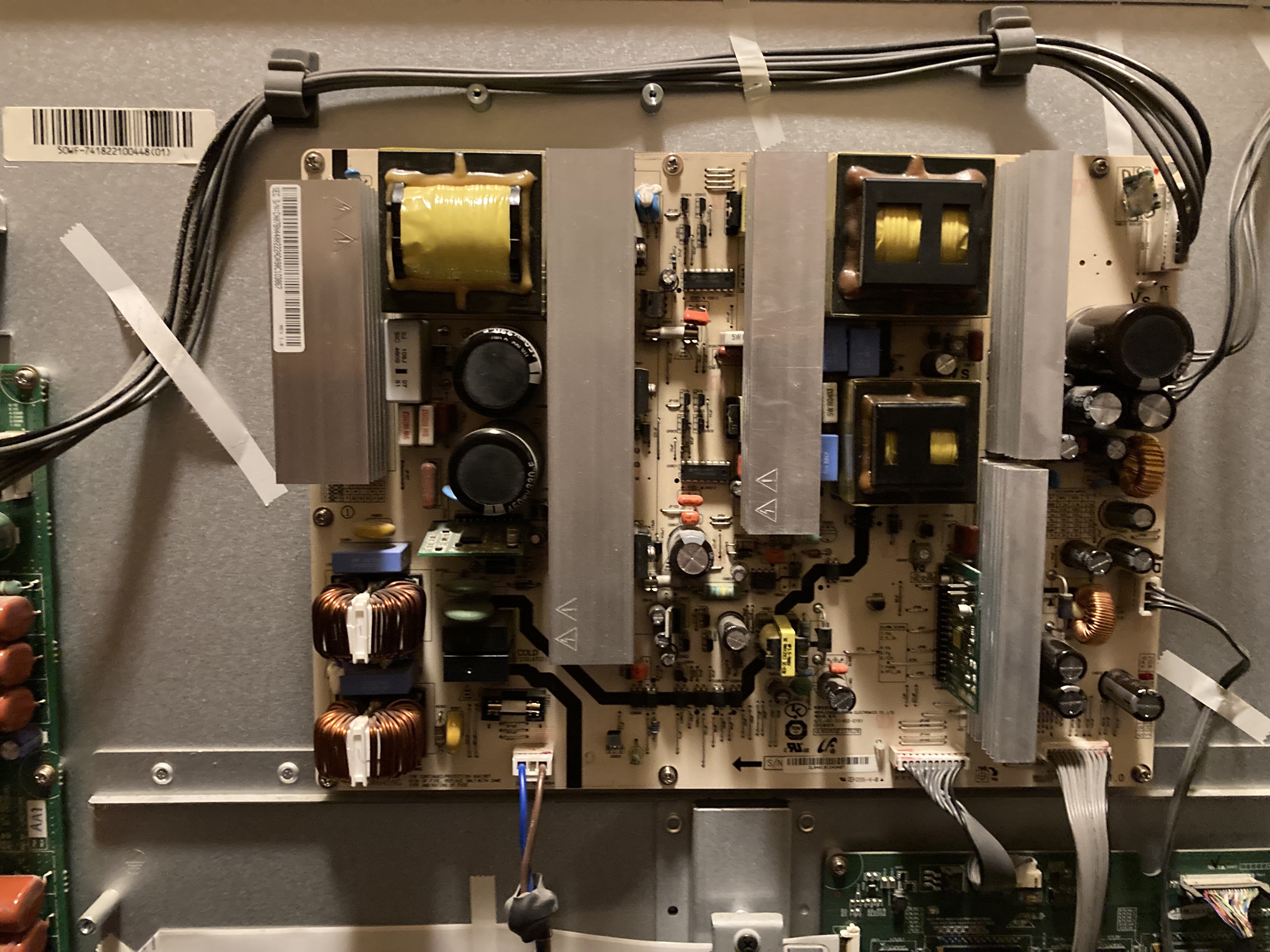

    I have a vintage 2008 Samsung 50” Plasma TV, Model code PN50A550S1FXZA with a power supply part number BN44-00222A. I repaired the power supply board several years ago finding a couple of cold solder joints on the back side of the board and it's worked great up until now. Recently a fried sound occurred with the smell of burnt electronics and the TV shut down. Trying to turn it back on yielded the typical relay clicking with no TV boot up. Upon investigation, removing feeds to the other boards within the TV it was found that disconnecting the logic board from the power supply allowed the TV to begin boot up. A visual inspection of the power supply board found two bulging capacitors CX834 and CX835, both 2200ufd 10v electrolytics. Not having a schematic of the board I had hopes that this was the issue and replaced them. Turning the TV back on it began boot up however another fried sound and burnt electronics oder occurred and the TV went back into relay clicking mode. This time I see nothing obvious visually but using my nose, it smells like the burnt area appears to be near the two transformers located to the right center of the board.
    I was wondering if anyone has any experience with this board who can throw out some ideas as to what has failed? Why does removing the logic board connector allow the TV to start boot up? The green LED's on that board do flash initially.

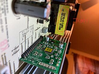

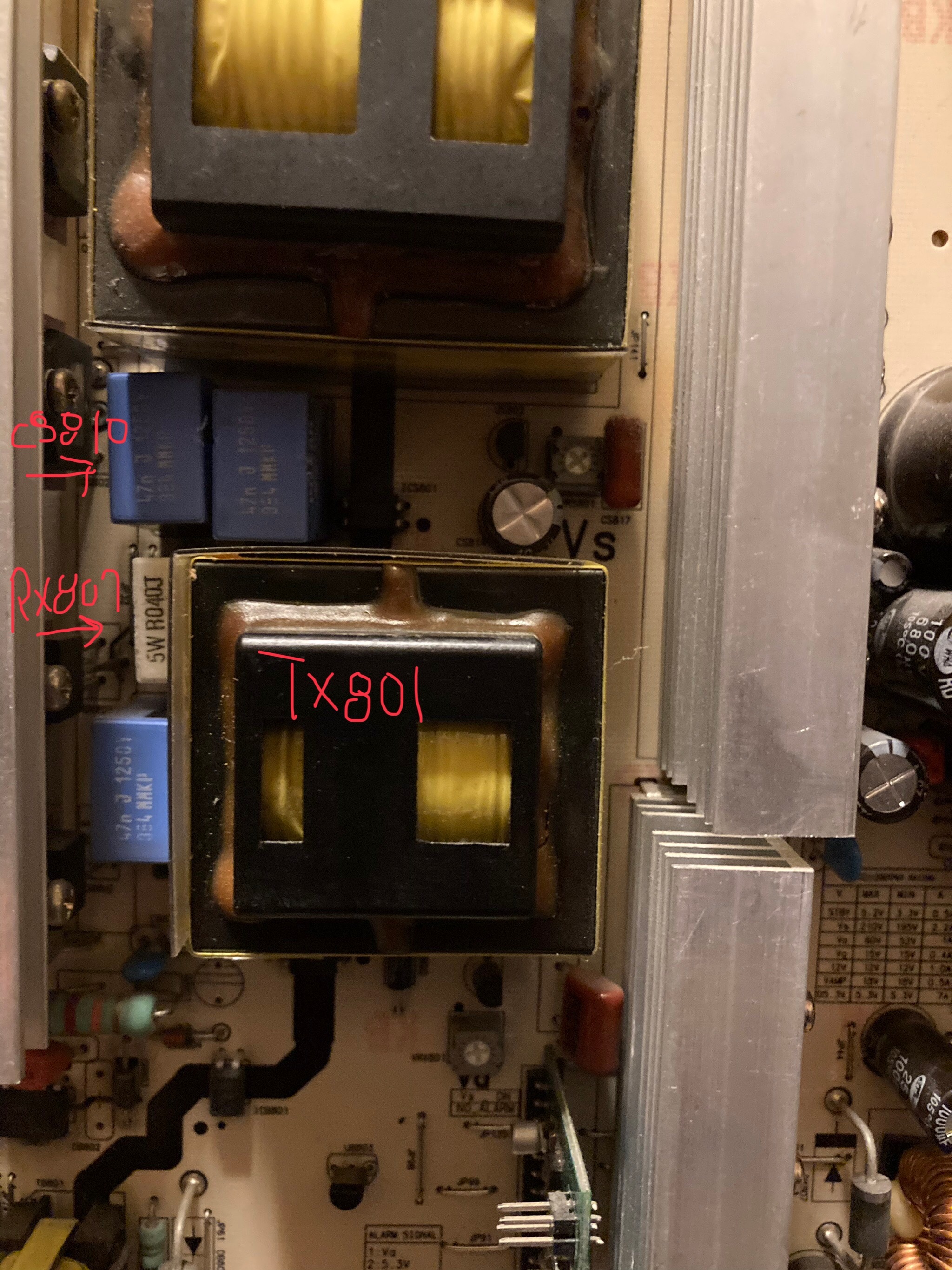

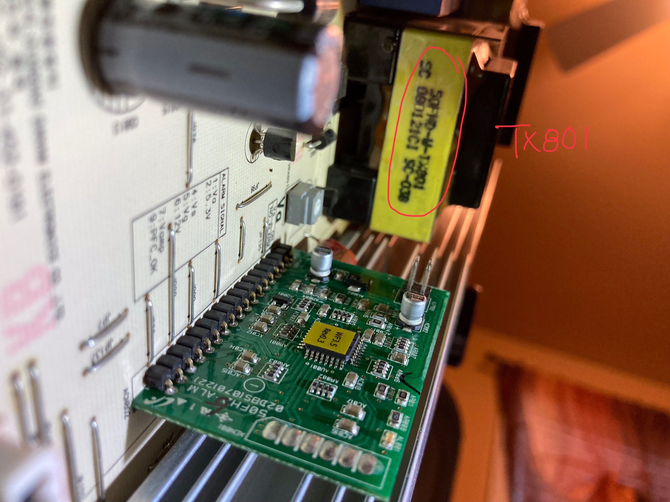

    Wanted to provide an update. Looking closely around transformer TX801, I found some scorch marks near CS810 and RX807. Pulling those components off the board and testing each, both appear to be Ok. RX807 is a 40 miliohm current sensing resistor. I did see some melting on the plastic case of CS810 but it measured ok at 47nfds. That area is in very close proximity to one of the primary side terminals of transformer TX801. Measuring across the primary terminals of the transformer it is showing short. I would think there should be some very low resistance there from the transformer windings. TX801 also appear to have a burnt oder. Some I am thinking this is the bad part. Also did some reflow on any questionable soldering on the board, though nothing looked real objectionable.
    I don’t think I could find a replacement transformer as it’s marking look specific to a Samsung proprietary component. Here are the markings:
    50FHD-W-TX801
    SC080121CI SC-03B
    The secondary is a multi-tap output
    Maybe someone has some thoughts on locating one of these transformers.
    Also looking for a complete power supply board to buy but no one seems to have this available anymore, probably due to its age. Also don’t want to spend a lot of money on it as its a 2008 TV.

        photos of power supply board, board part number, transformer markings, location where scorching on board was seen.
