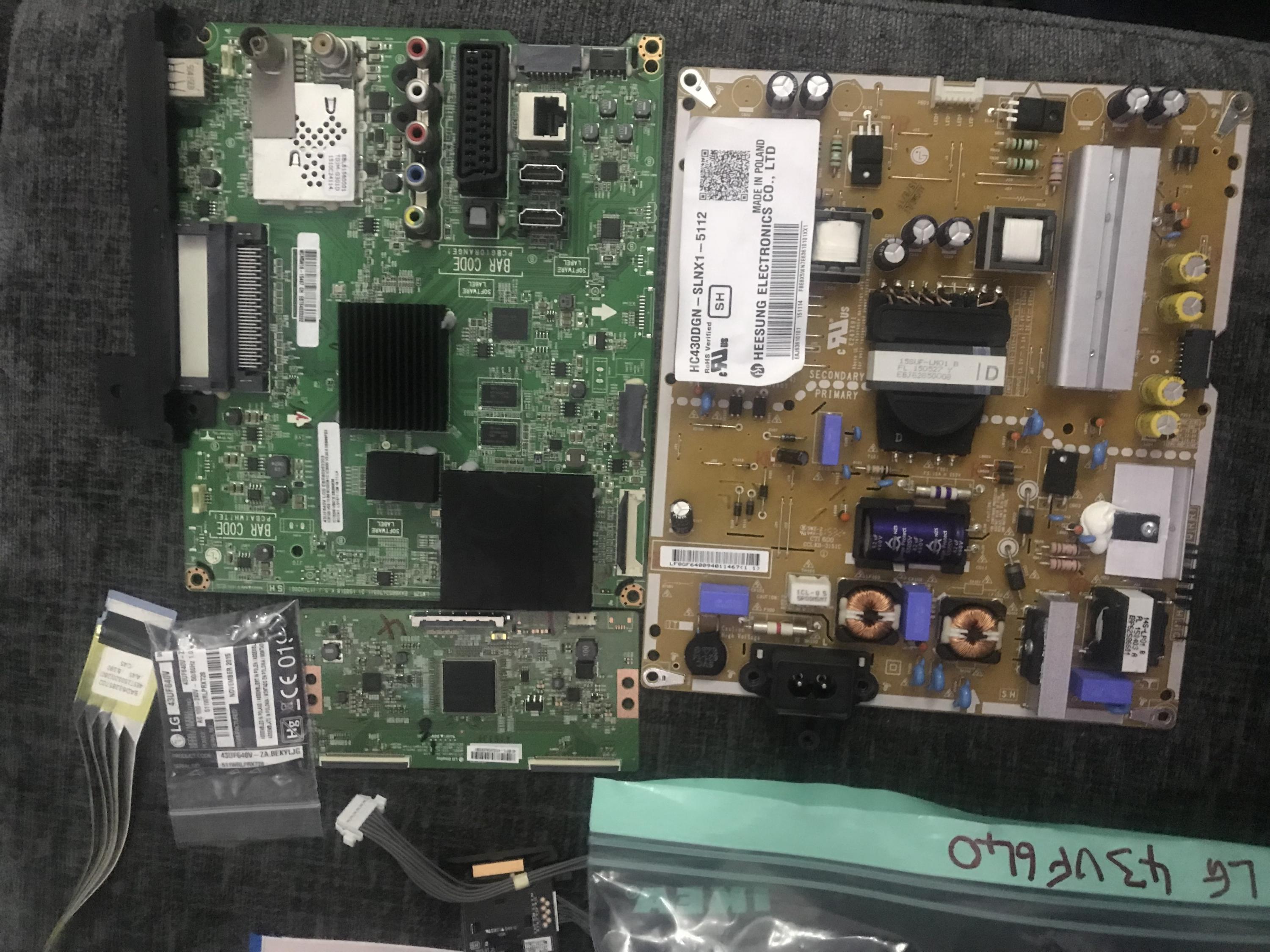

            #105
            Re: LG 43UF640V half picture
            quick update on this tv
            I have got nowhere with this tv, eeprom reset, baking mainboard, tcon change twice.
            however daz2206 is sending me a set of boards for this tv to try
            so will post with result if replacement power, mainboard or tcon sorts the problem
            thanks to darren again for his help on this

                    #109

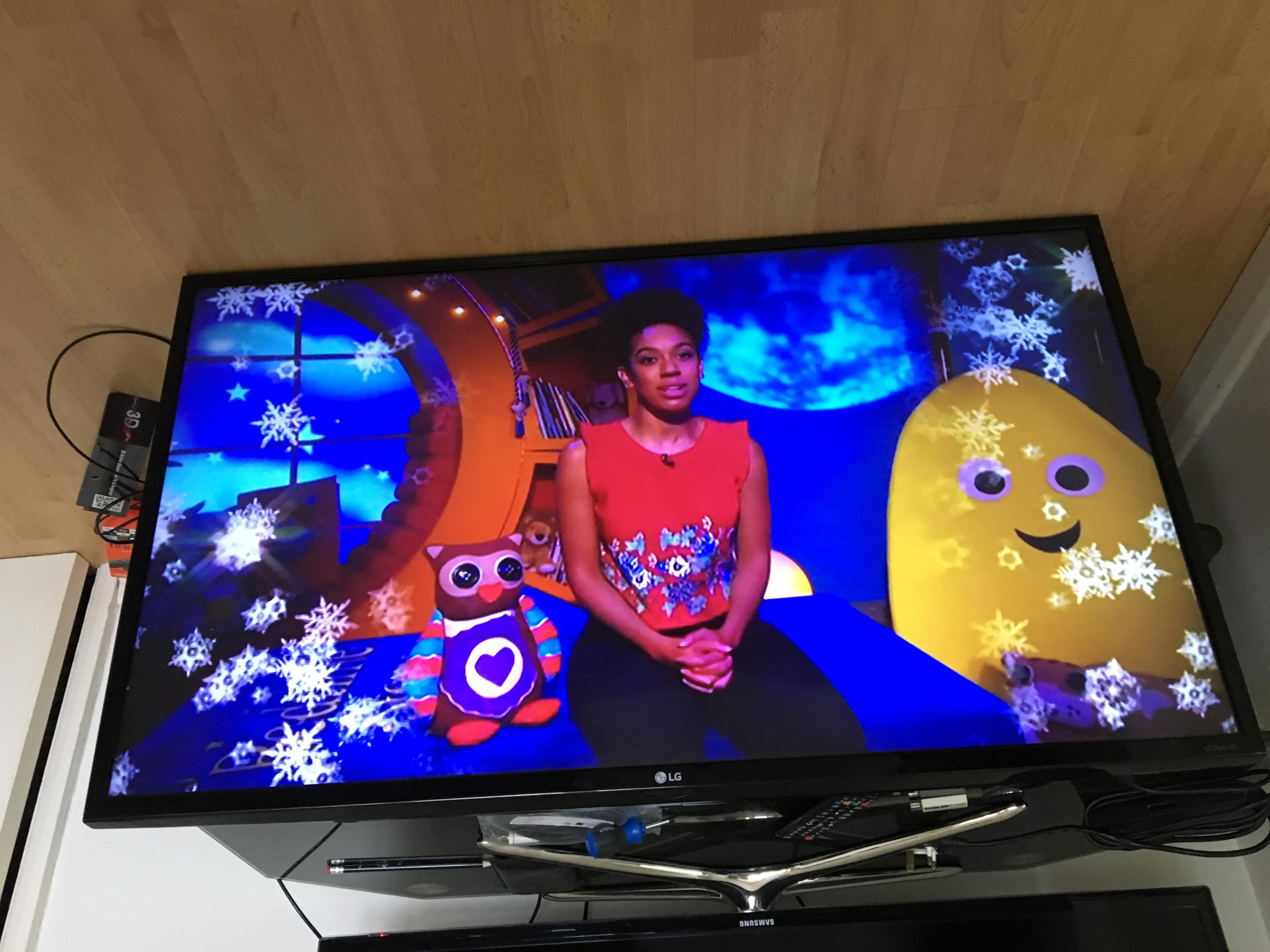

                    tv is working using boards supplied by daz2206, I changed all ie: power, main and tcon so not sure which one yet has fixed it.

                      #110
                      now that is better,
                      advice now please guys do i risk trying my power board and tcon with this mainboard to try and determine which board is at fault

                        #111
                        Glad you fixed the tv it would be nice for future readers too know what board fixed the issue but its your own choice if you risk swapping boards around and possibly causing further issues.
                          #112
                          Half picture unlikely to be caused by a power board fault. So you could probably rule that out.
                          T-con/main is the difficult one. Pretty unlikely for either to damage each other, but small chance.

                            #113
                            Originally posted by london-freddie
                            now that is better,
                            not sure that I would do that just yet. IF I recall, earlier in your thread, you replaced a tcon and "post replacement", the set worked for "5 minutes" and then you were back to "half / half". I assume now that you have checked out the functions in terms of remote and such... inputs, etc. to see that they are working normally.
                            I would think a bit more about what "setup" is what... since some of these didn't work with the other thread. Maybe its more of a "initialization" issue than anything... my first guess is some form of eprom "issue" either reading or otherwise such that the main gets corrupted and can't readily recover.
                            PS... glad you got to a working set.
                            • london-freddie
                              • May 2015
                              • 472
                              #114
                              hi thanks for that guys everything appears to be working fine now on this tv including all remote functions
                              yes when I replaced the tcon I think the second time it did work for a short while then went bad again, so not sure if main had killed the replacement tcon
                              I would love to know which board caused the fault but am reluctant to risk damaging these replacement boards by mix and matching

                                #115
                                My thought is replacing T con is a temporary fix. Main board maybe sending too much voltage or over driving data signals into one side of the T con. So inevitably mainboard root cause. Just a thought.
                                Especially after hitting the main board cause different variations on that side of the screen makes me think a drifting resistor to the T con from the maid board might be in order
                                Glad to see it's working now!
                                • Davi.p
                                  Hobbist Tech
                                  • Sep 2009
                                  • 4459
                                  • Italy - Milan
                                  #116
                                  Tcon input signals are not generated by any other than mainboard, only SDA returns back to mainboard but dont affect image, so to be safe change first tcon...
