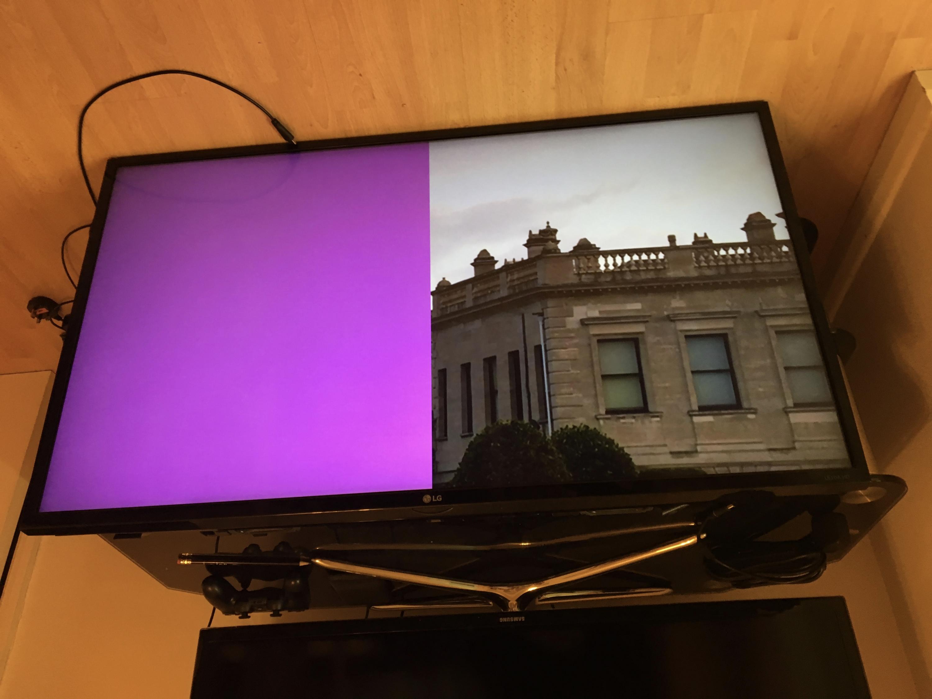

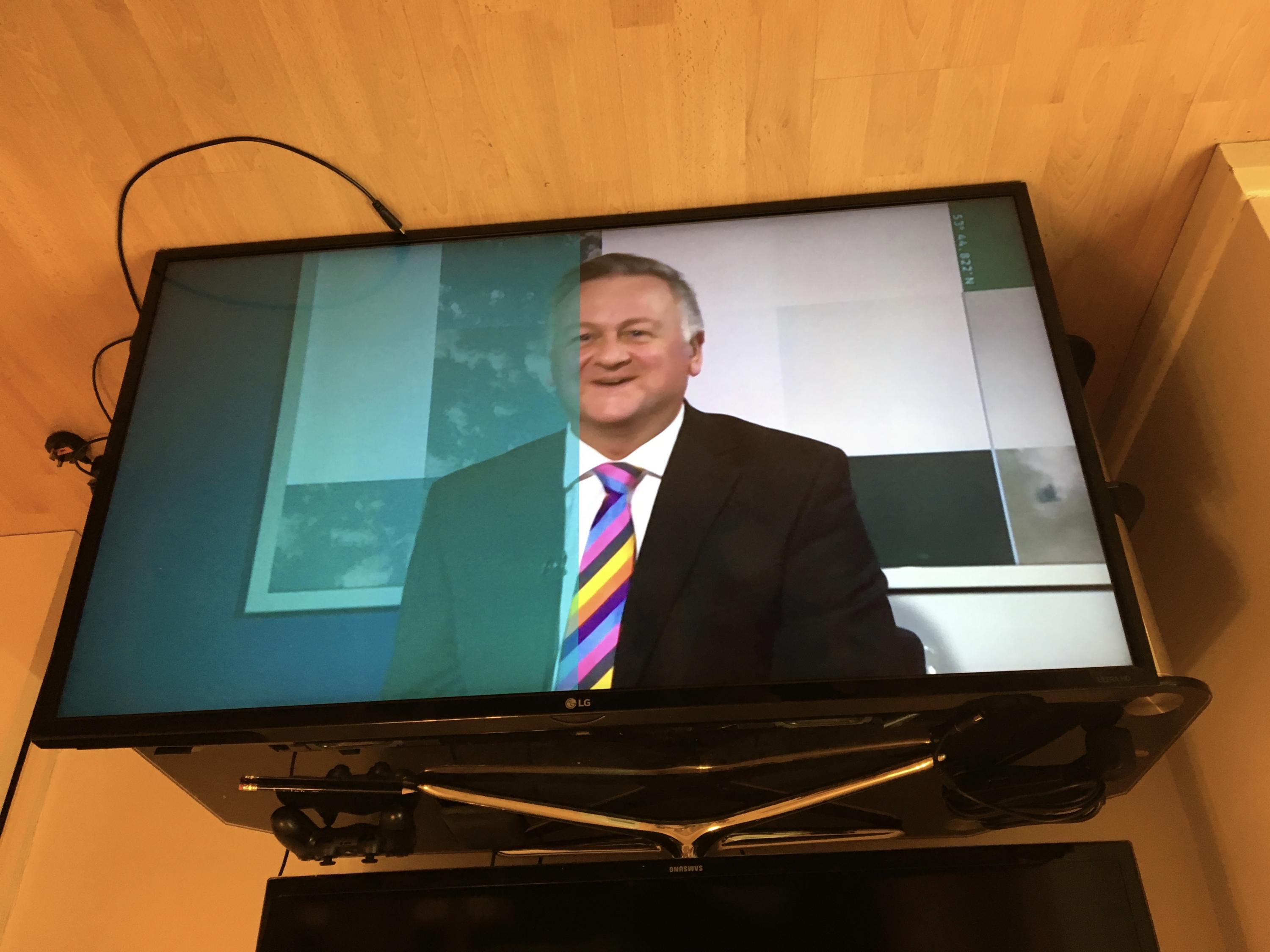

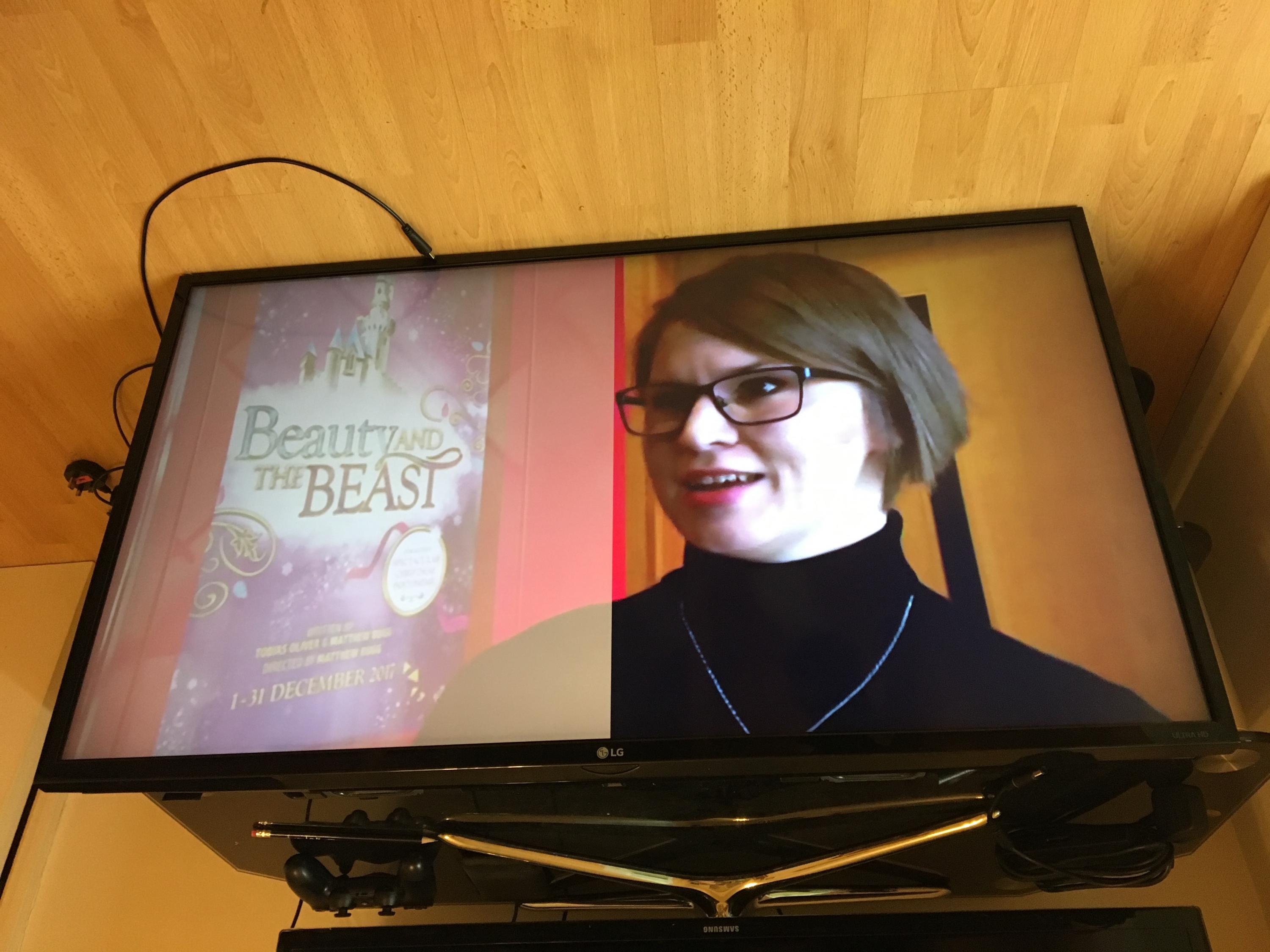

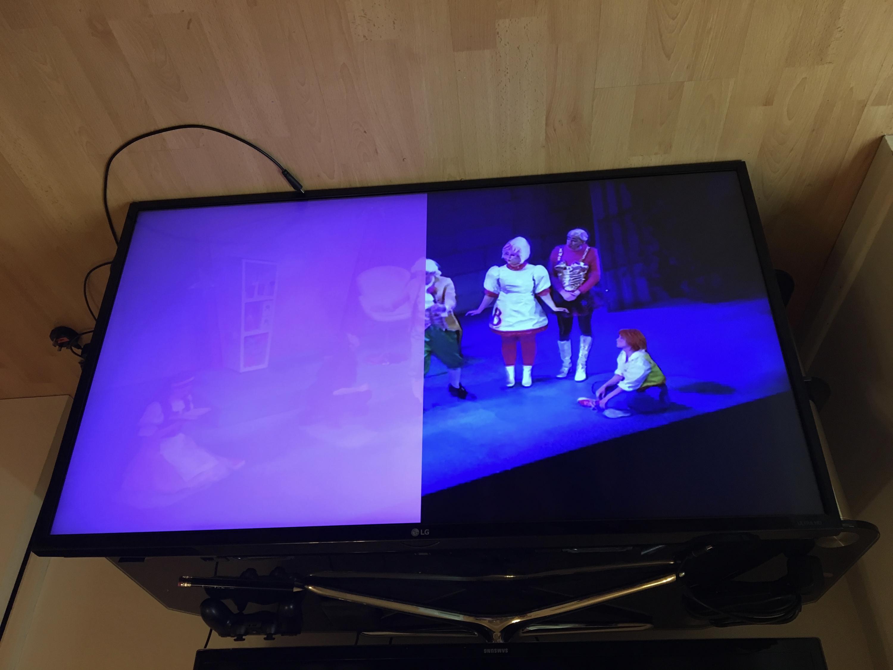

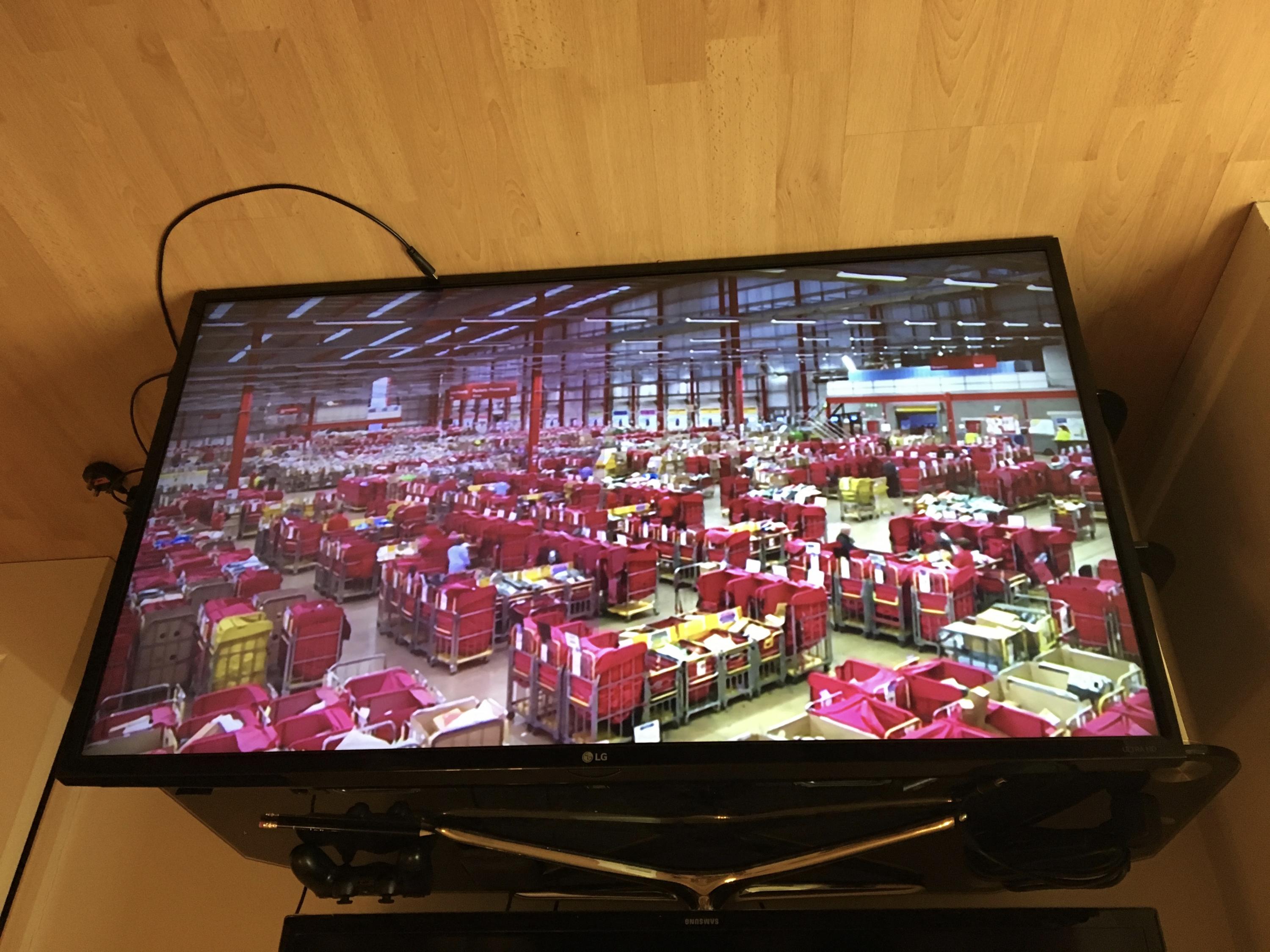

                  • london-freddie
                    • May 2015
                    • 472
                    #49
                    Re: LG 43UF640V half picture
                    just took this pictures over a period of three or four minutes, each one was taken on powering up the tv, switching off and powering up again each time a diffent tint on the bad side of the screen

                          • Davi.p
                            Hobbist Tech
                            • Sep 2009
                            • 4456
                            • Italy - Milan
                            #53
                            The tint evindently depends on the picture content..
