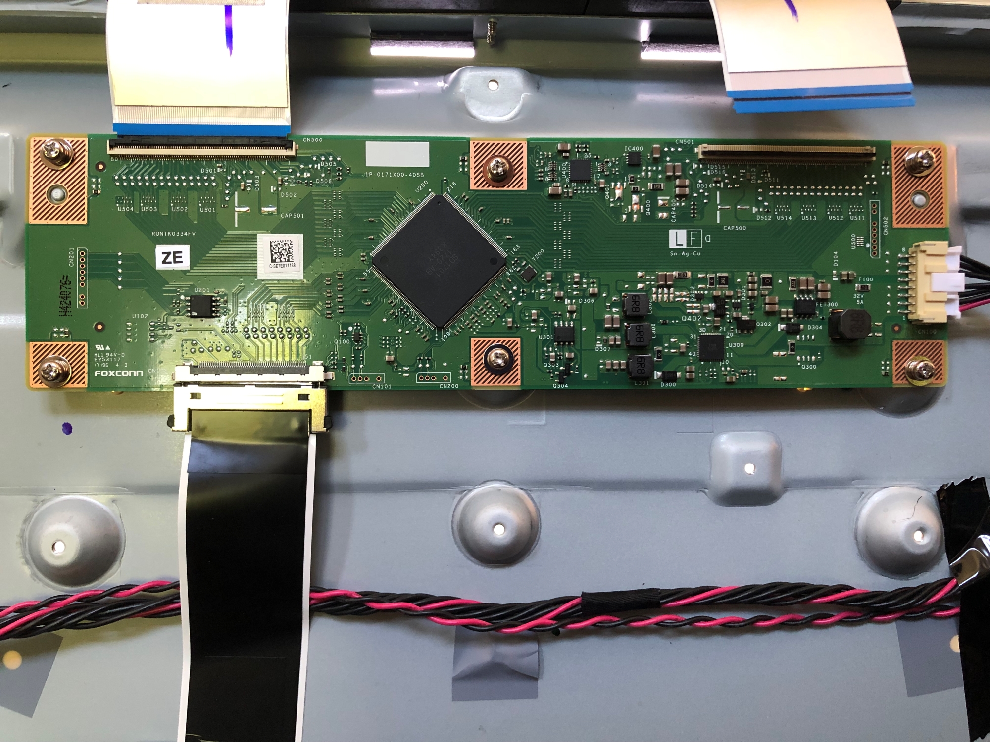

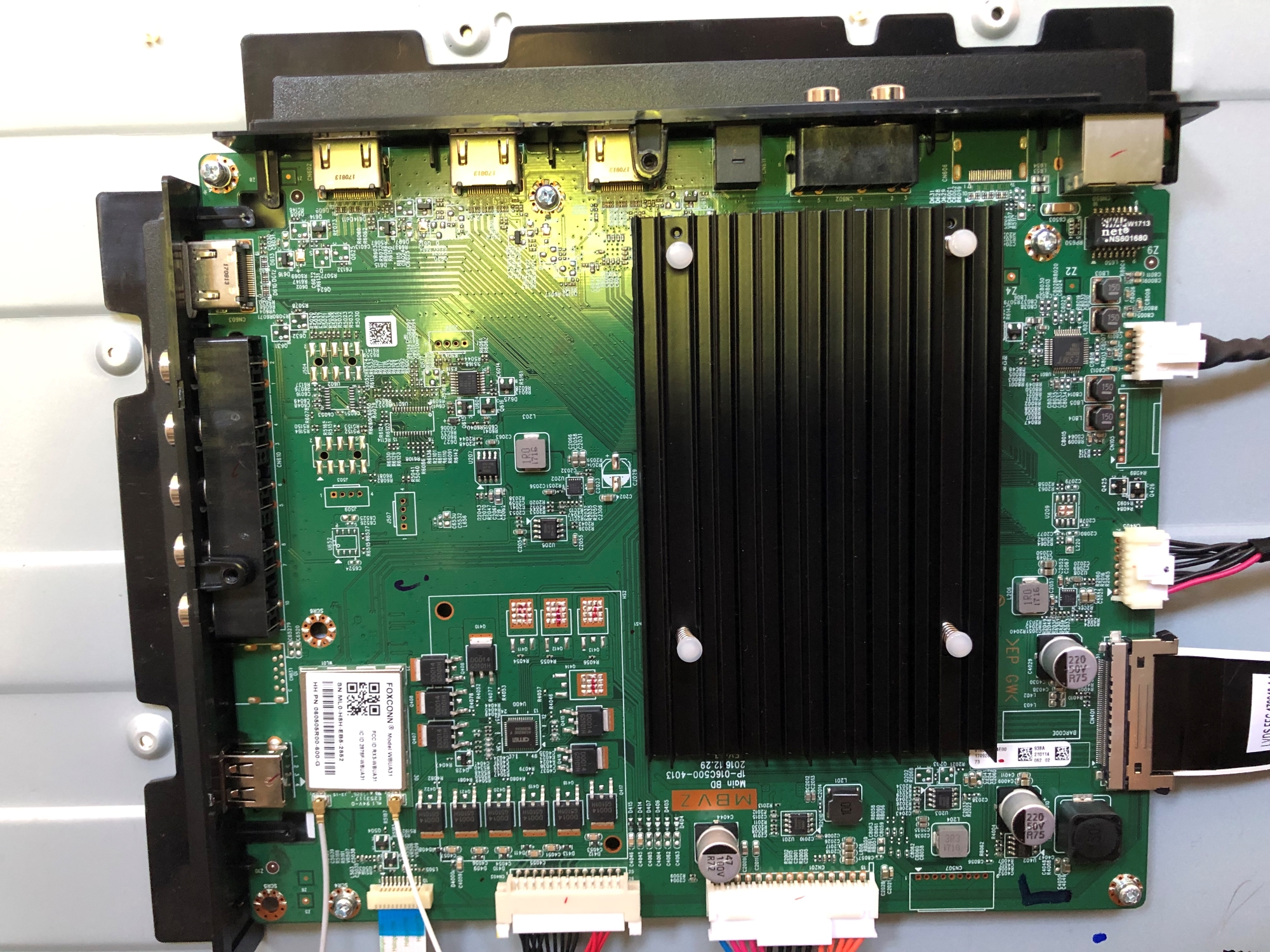

    I have a VIZIO E70-E3.
    Symptoms: Black screen, no picture, but LED backlights are working.

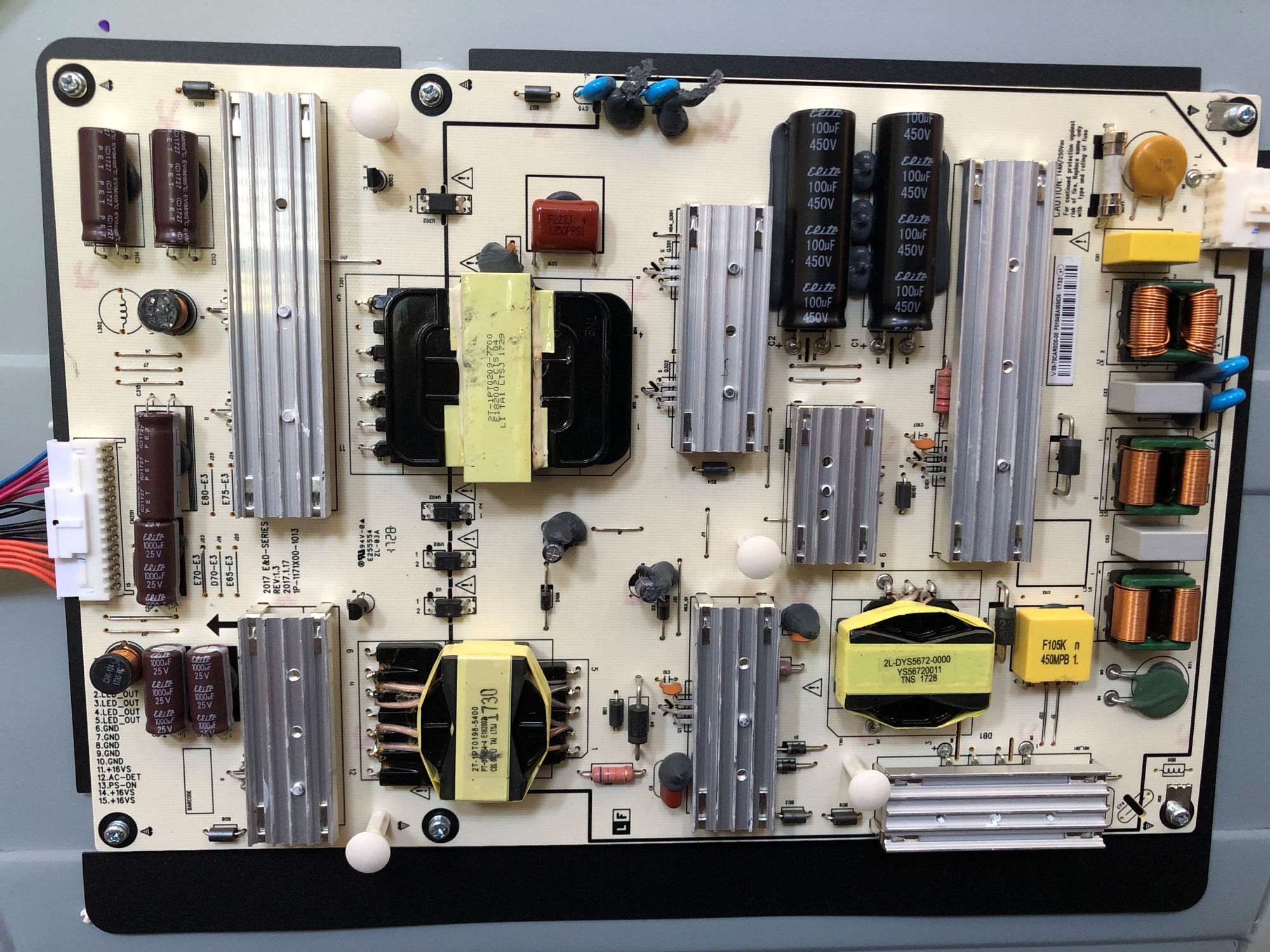

    I probed the power board and voltages are as listed on the board.
    Main board appears fine, too.
    I believe the problem is either a bad T-CON board, or connection to LCD, or bad LCD.

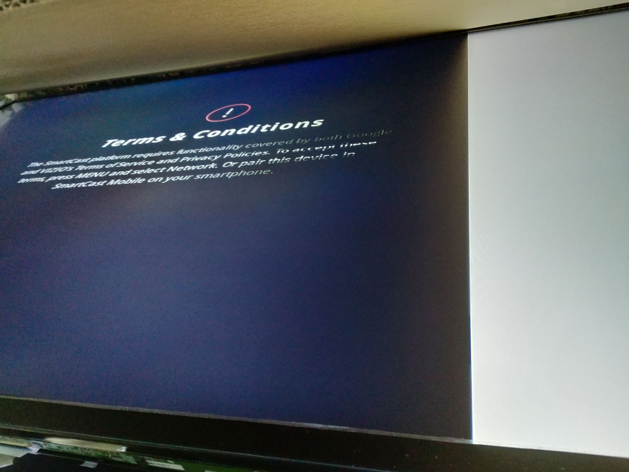

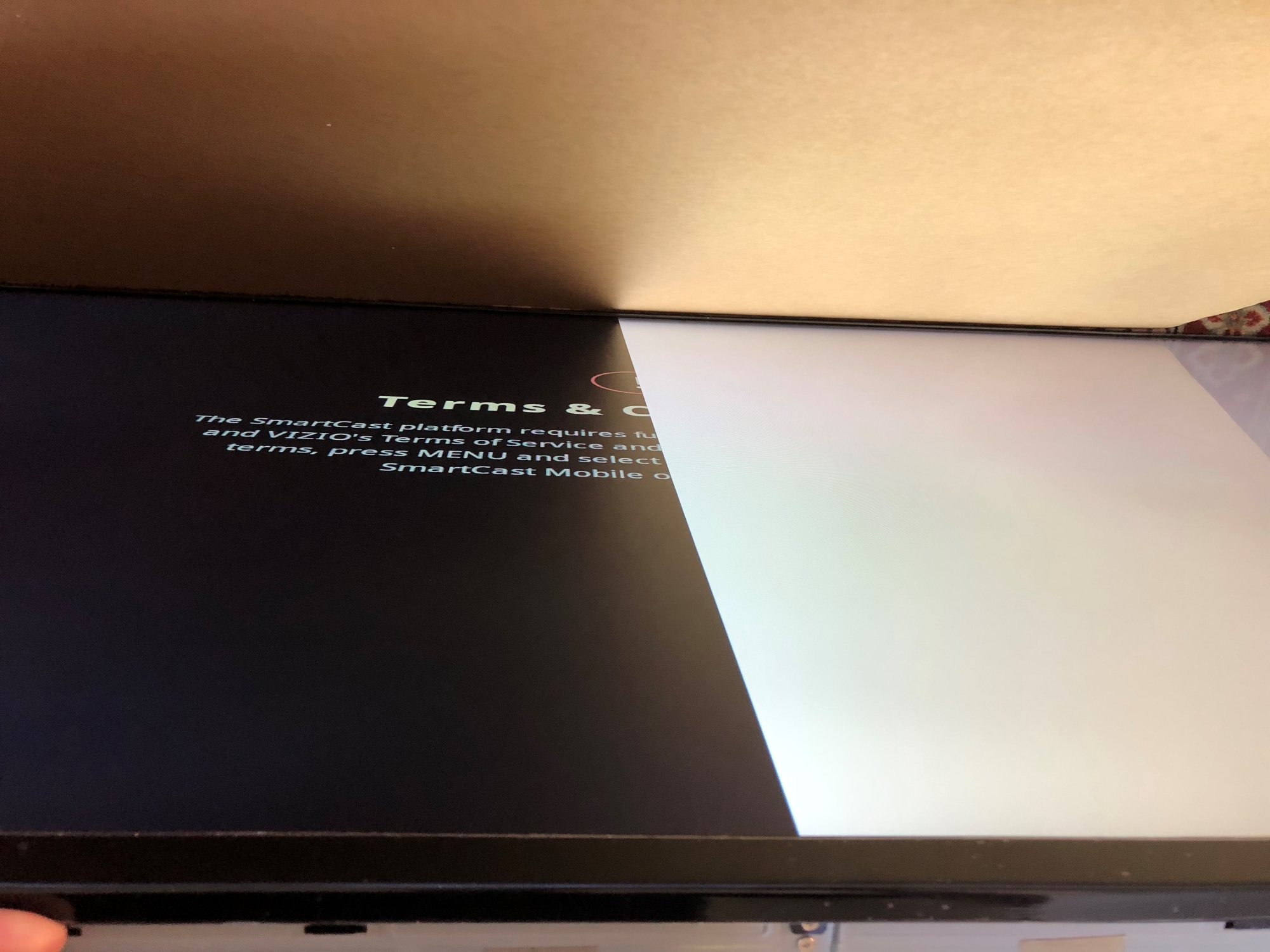

    There are two separate ribbon cables feeding the LCD.
    If both are connected, the screen is black.
    If only the ribbon cable that feeds the right side of the screen (when viewed from the front) is disconnected, the left side of the screen shows picture and the left side shows all white. The reverse is not true, screen stays all black.
    I probed the test points on the TCON board under the ribbon connectors.
    On the TCON board left side (feeding the screen), top row pretty consistently was reading 0.6V and bottom row was reading pretty consistently 1.1V. (I think one or two points, maybe the 4th and 8th read the same as each other)
    When I probed the right side, the top row pretty consistently was reading 100 mV and the bottom row was pretty consistently 1.6V.
    Additionally, the row of 3 caps at the bottom center of the board under D307, read shorted. (They are caps, right? No values printed on them, and the other parts like those didn't read shorted.
    Finally, I already ordered a new TCON board, but same problem of a black screen. I know I read the same shorts, but I don't remember if I got the same readings on the test points under the ribbon cable connectors.
    Therefore, I'm worried the problem is causing TCON board problems, or it is downstream of the TCON on the boards/ribbons feeding into the LCD. I have not fully pulled back the bezel to do any voltmeter probing there yet.
    Ideas?

                          Any thoughts on the different voltages I measured on the test points under the two ribbon connectors?

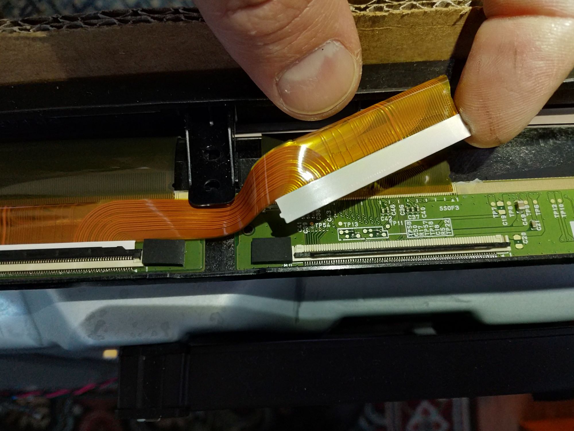

                            I've been trying the taping method and really want getting anywhere.
                            I don't know what pins I should tape, how many at a time, and what side to start from in the ribbon cable.
                            I pulled off the bezel, and noticed the LCD board is split in two. Simply disconnecting one half results in only 1/4 screen white! Getting closer.
                            So then, I applied a small piece of tape on that connector and got almost a full image but with distortion.
                            Question: is it okay to perform the tape on that connector? Or is it preferred to do it only on the tcon board ribbon?
                            • Fly_Among_Stars
                              • Apr 2023
                              • 13
                              Re: VIZIO E70-E3 Half picture with half TCON

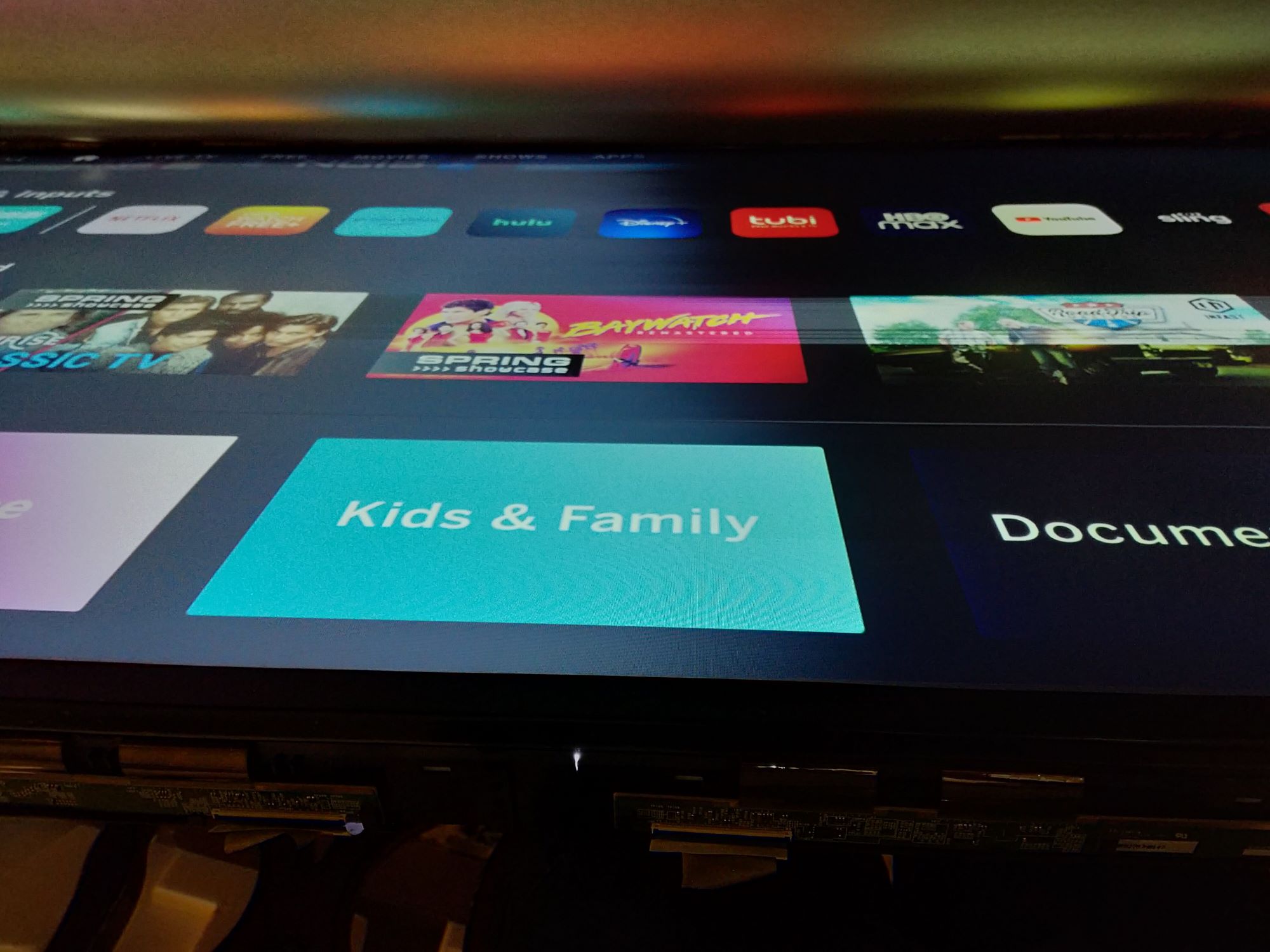

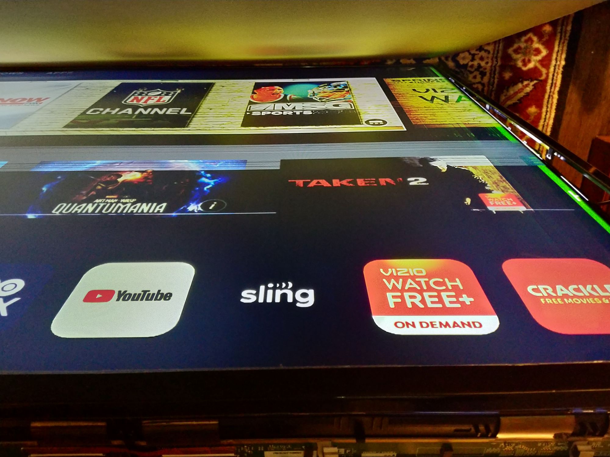

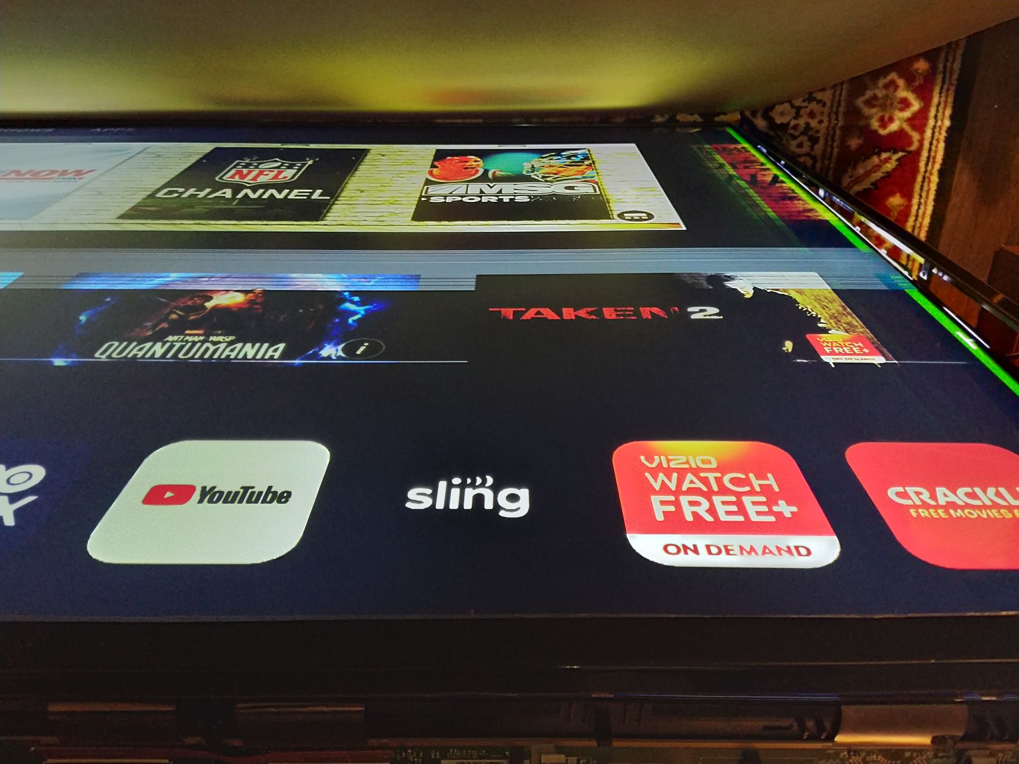

                              Update
                              I found that if I taped pins 9 and 10 on the U-Ribbon I can consistently get a full picture. If either of those pins are not covered, the screen is black.
                              Unfortunately, as can be seen in the images, it wasn't the only problem.
                              I noticed that slight pressure on the right side affected the horizontal lines, so I pulled back the bezel on the TV screen's right side and noticed that those side tabs were smashed in half and that the screen wasn't fully taped down cleanly like it was on the left side.
                              I attempted to unroll the smashed side tab and the horizontal lines went worse.
                              You'll also notice in the images that the screen's left side is significantly more washed out (brighter).
                              And two pictures I attached aren't duplicates, it's to show that top right, as the show ads came up, the top right side would fade back to dark.

                                  you may have LCD glass at the bottom some where broken.. by removing Bezel you can inspect it carefully
