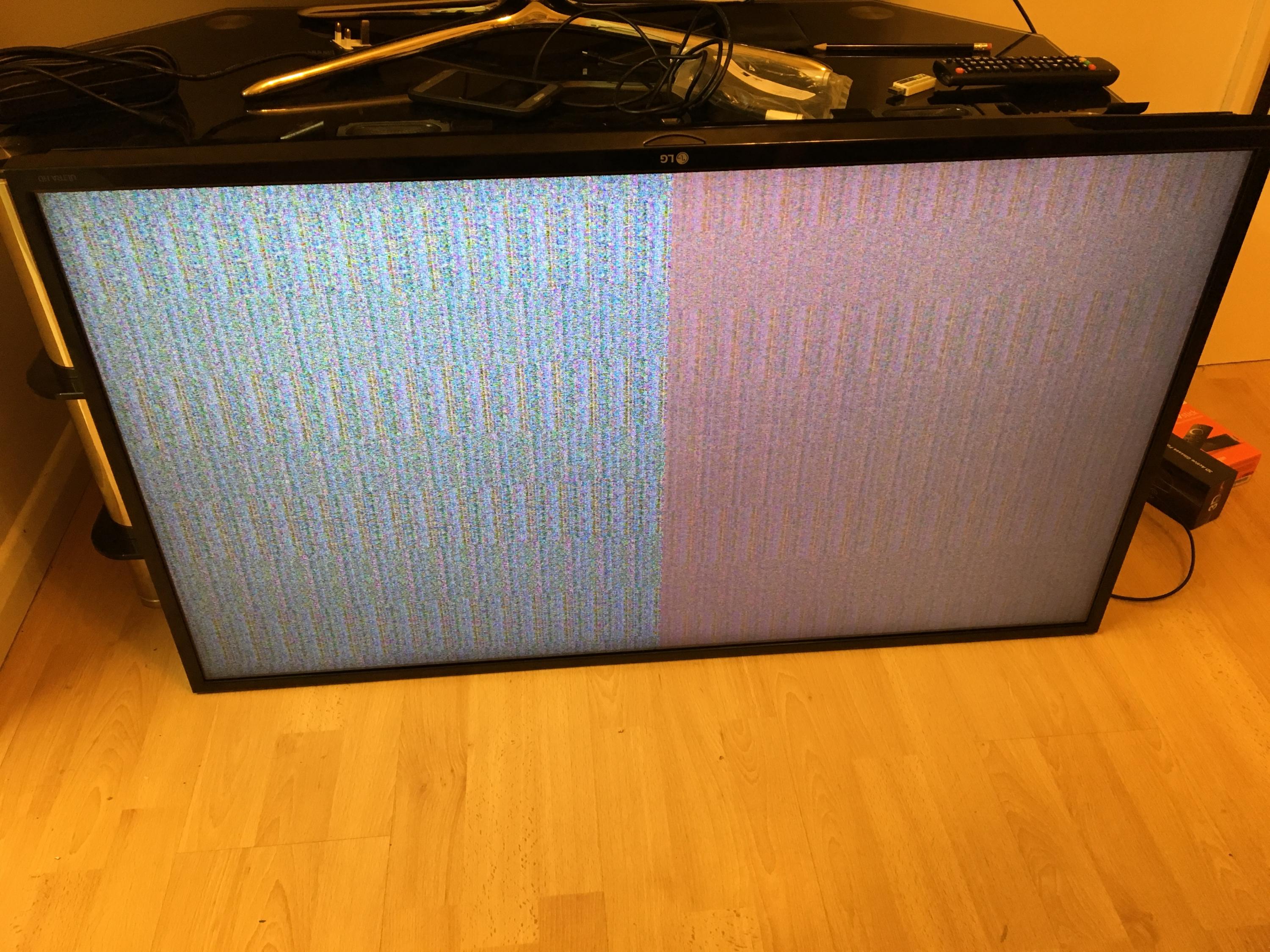

                        #91
                        Re: LG 43UF640V half picture
                        just tried resetting IC101 again pins 5 and 6, now got a screen like this ????
                        • london-freddie
                          • May 2015
                          • 472
                          #92
                          still no remote functions apart from on/off, volume up/down, and channel change, no source or settings

                            #93
                            LG logo at the boot up Is it correct? The audio of channels is present? How do you found the pins 5,6?
                            • london-freddie
                              • May 2015
                              • 472
                              #94
                              never had logo at start up,
                              audio is there
                              pins are numbered
                                    tried eeprom reset again pins 5 and 6, now lost sound and picture, still no remote functions except power on and off
                                    looks like i need a mainboard
