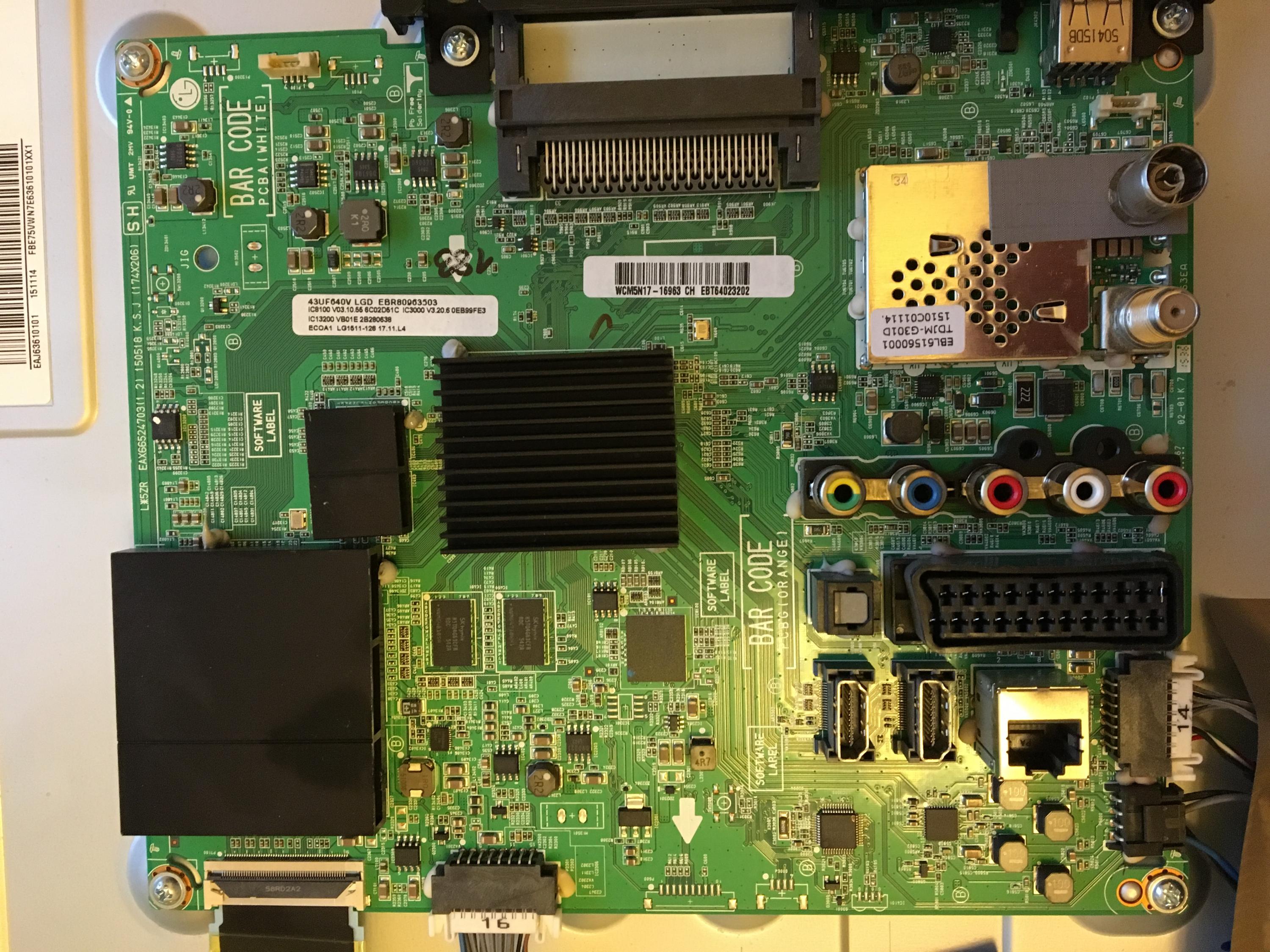

                                  #76
                                  Re: LG 43UF640V half picture
                                  struggling to identify the eeprom chip I will post a mainboard pic asap
                                  • london-freddie
                                    • May 2015
                                    • 472
                                    #77
                                    Mainboard
                                    • diif
                                      • Feb 2014
                                      • 6978
                                      • England
                                      #78
                                      At the top edge, near where the model number is written, has a white dot of paint on usually.
                                      Left hand side in your photo.

                                          #80
                                          ok got the ic with the spot of paint, not checked amy voltages on the power board
