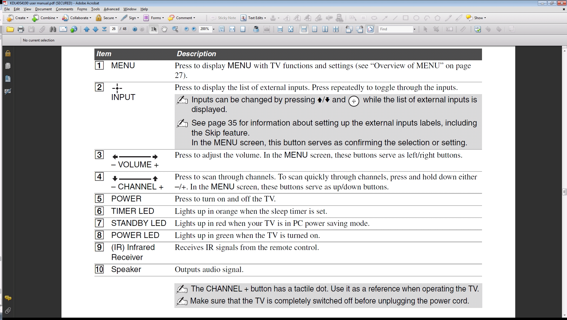

sony KDL-46S4100 proper voltage
    Re: sony KDL-46S4100 proper voltage
    This training manual may help.
      I was thinking there's supposed to be a red standby light on front, when tv is off and plugged in but none of my working tvs have that, it must be normal.
      See page 26 of the user manual.
          yes thats the manual I've been reading, it helps a lot, I think I need a good video tutorial on checking mainboard check points, thanks Budm.
                              quick question, anyone with a proper working sony kdl model, do you have a red standby light, when tv is off and plugged in?, Thanks.

                                  #36
                                  I just checked my Sony Kdl-46S4100, When it is pluged in there are no led's lit. only when the power button is pushed does a green led light up. when turned off the green led turns off.
