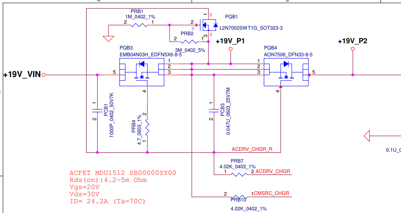

    Hi
    Acer A515-43
    LA-H801P
    Fail: Does not charge battery, has low voltaje on connector.
    Laptop didn't want to turn on, only charge led blinked.
    I found PQB5 (mosfet high battery charger) in short, voltaje in +12.6V_BATT was 19 v ...
    I changed it, changed PQB6 too and now battery charger voltage is 4.4V but battery is 3 cell, 11.25v, then is very low to charging.
    Laptop turns on without battery and works fine, but with battery turns on and turns off inmediately, I suspect battery bad but I don't know why battery charge voltaje is only 4.4v, I readed bq24780 datasheet (similar IC) and I found that:

    1) Check the 2 x DCIN mosfets. Specifically, the 2nd mosfet @ PQB4.
    Remove all power / no battery.
    Meter in resistance mode.
    Check the resistance of PQB4:
    source (1-2-3) & drain (5-6-7-8)
    source (1-2-3) & gate (4)
    gate (4) & drain (5-6-7-8)
    Post each measurement.
    2) What is the voltage of ACDRV when the unit is on ?
    3) REGN voltage ?

      Hi
      PUB1
      REGN pin 24 = 6.07v
      ACDRV pin 4 = 24.9v
      ACOK pin 5 = 3.3v
      ACDET pin 6 = 2.54v
      source (1-2-3) & drain (5-6-7-8) 40 to 60 M ohms
      source (1-2-3) & gate (4) 20 to 60 M ohms
      gate (4) & drain (5-6-7-8) 40 to 90 M ohms
      I guess PQB4 is working fine, it has 19.2v in PRB3 and it turns on and works fine...
      I suspect from Smbus lines of PUB1 (BQ2478) due charger data configuration is received by these lines, I'm going to replace it.
      Very thanks Mon

        BQ24781 replaced with BQ24780s, now charging battery.
