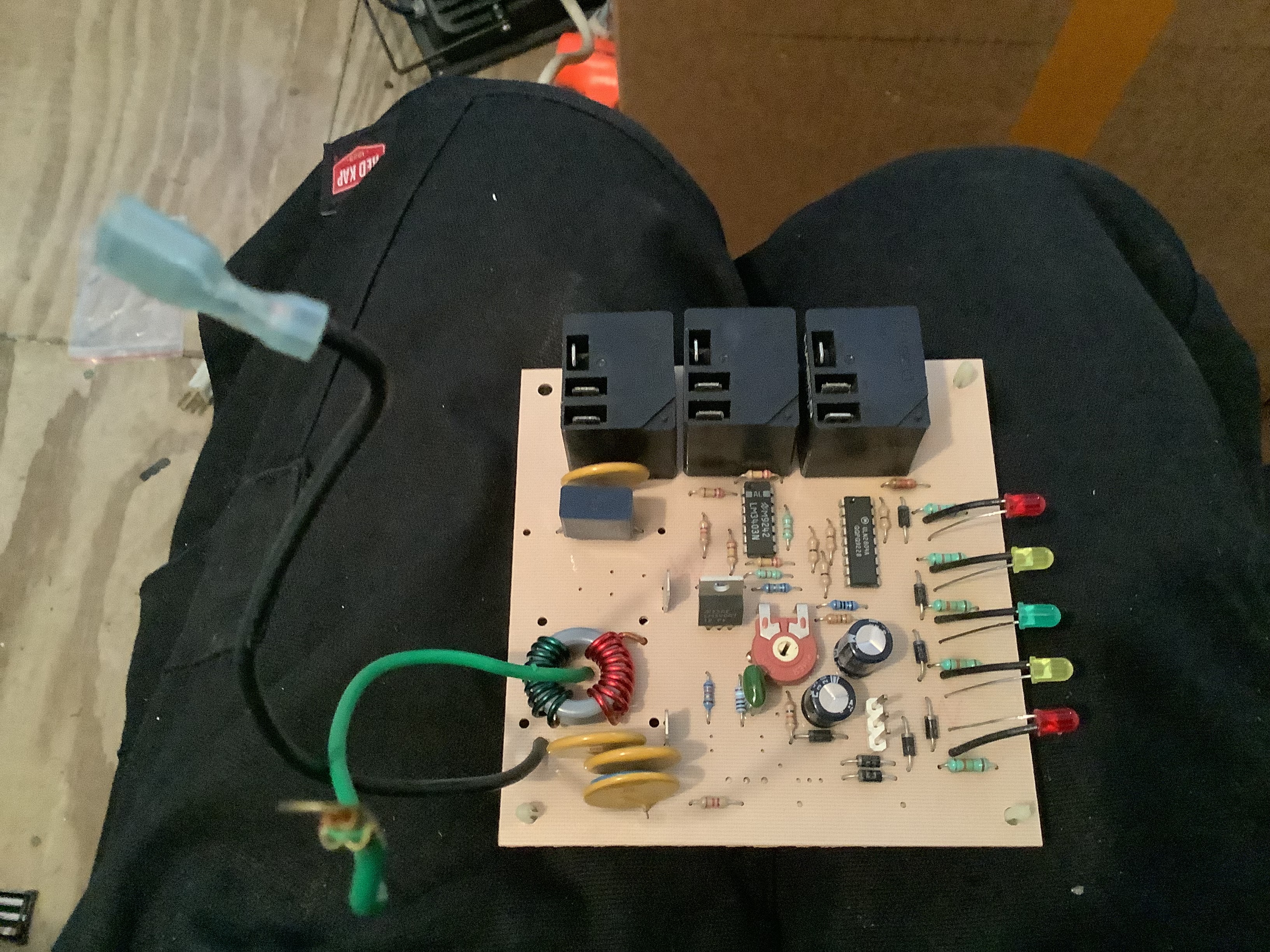

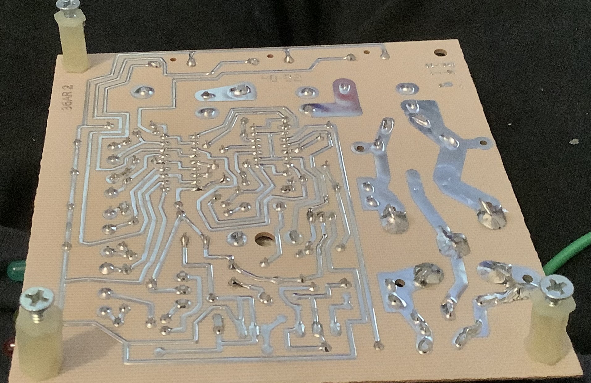

    I found two capacitors on the board and one of the leads on one capacitor had bad soldering joint and the other joint connections not much better and there were several soldering joints that way to much flux around the joint redid several of them
    The capacitors were a non brand that I did not recognize they got replaced and now it does not oscillating between relay but what concerns me a little bit is when the voltage is a little bit low the output voltage is around 130 volts and then drops down to 115 volts this happens around 105 to 108 volts if remember correctly
    Now the eBay seller had in the description that the high voltage light was lighting that was the reason I checked it on my auto transformer and slowly brought up the voltage so I could see what the seller was talking about I did not see the high voltage light coming on until it reached around 130 volts then came on at this voltage but what I did find when checking it was that when the voltage was very low it was not working correctly which I did fix with the two new capacitors and re-soldering some of soldering joints that looked questionable

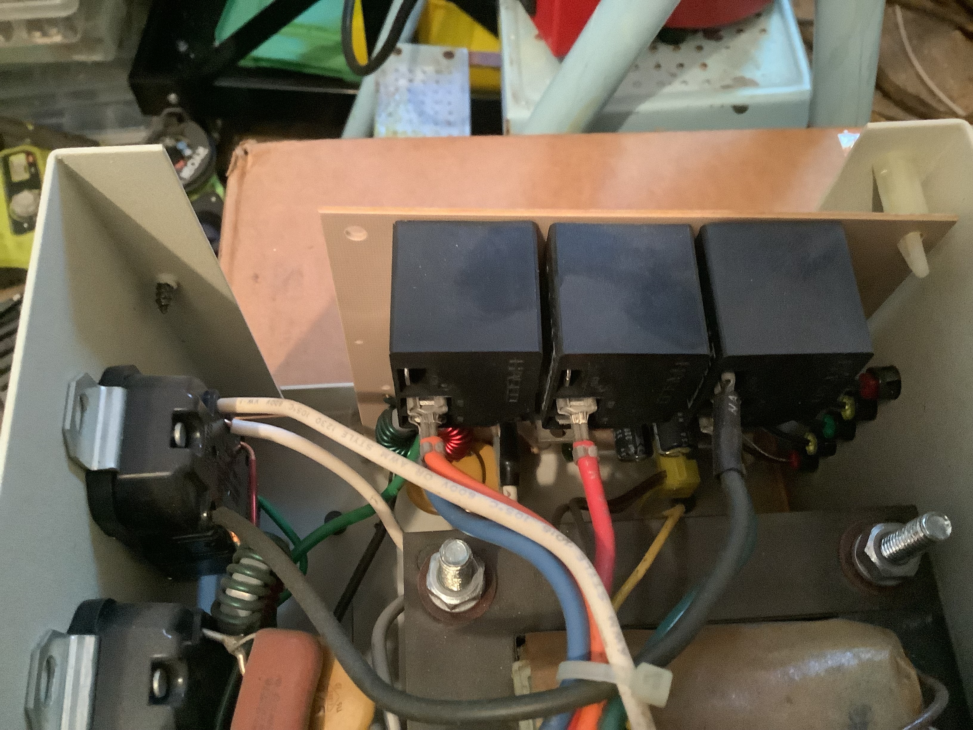

    I will take some pictures if needed but to put this circuit board in is a pain in the neck because the connection wire are heavy gauge wire and they are barely long enough to begin with and a lot of them plug into the three relays
    I have repaired several of the lower wattage versions which are more a pain in the neck to do than this one was

              Here are some pictures of the line conditioner 1800 watt which is very similar to 2400 watt version one
                • Jul 2011
                • 6070
                The 1800 watt line conditioner is powering both battery backups recapped the controller board I also had re-solder the LED lights because the soldering joint pins became some of them were loose

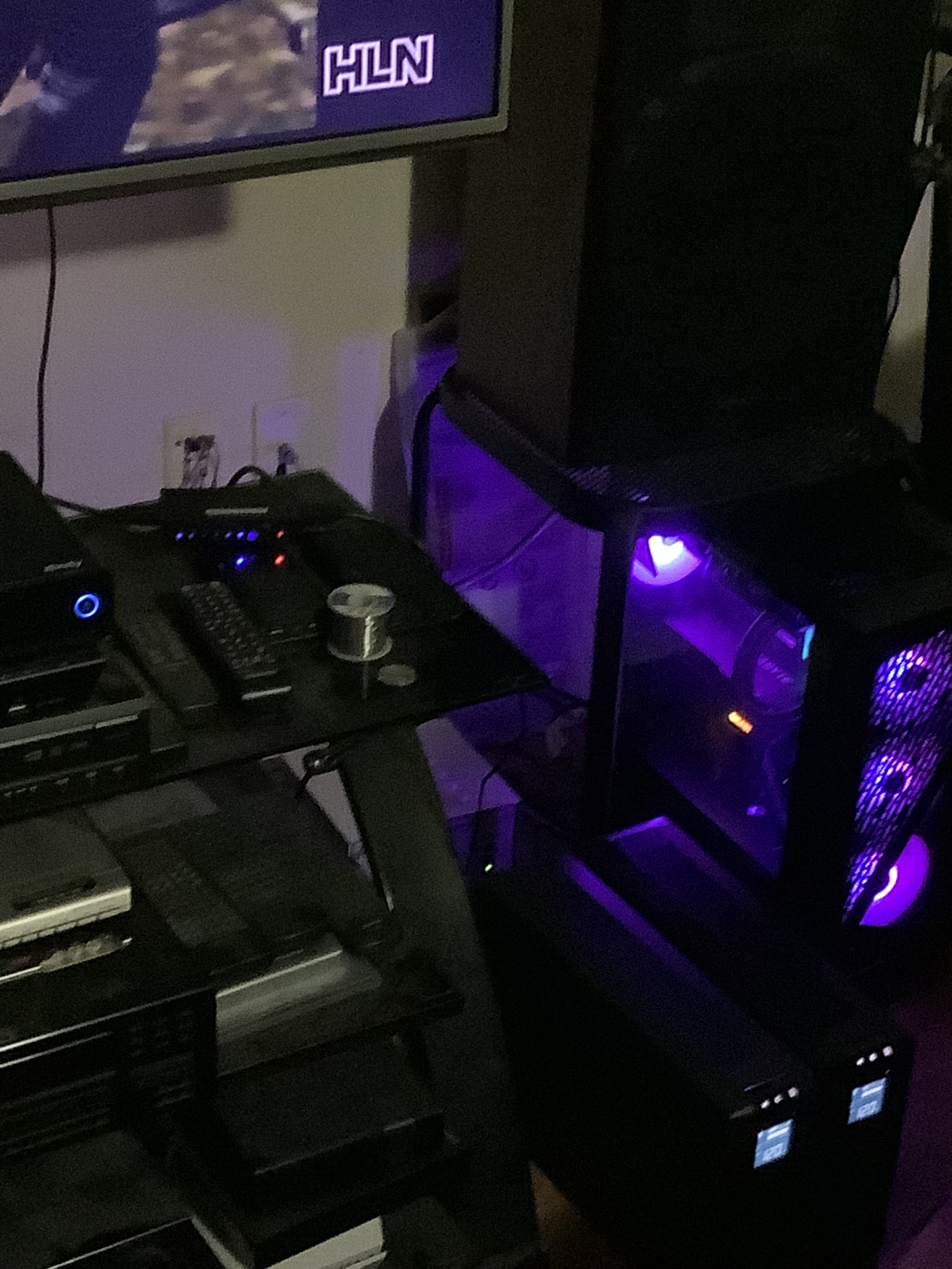

                Well I setup my cable television monitor / computer monitor that I use an HDMI switcher
                The computer and HDMI switcher and monitor on one battery backup and the cable box and clock on a second battery backup which the power supply current gauge shows about the same load on each battery backup
                I originally had the computer in our office but did some remodeling of furniture and I was not really using the computer very much because of where it was that is the reason for getting a higher wattage line conditioner to handle two battery backups and to the current load from being to high on one battery backup and having a very short run and when I had the computer in the office I did not have a line conditioner
                I have had the computer and the cable box and monitor and two battery backups and clock and HDMI switcher on this line conditioner for several hours now and it is room temperature which I am very pleased with it because the other line conditioner had issues one it rather warm and the line fault was on the two different battery backup so I have to open this line conditioner to see if I can figure out what is wrong with it this one was bought a few years ago used it work okay for a couple years with out issues but now it is a different story
