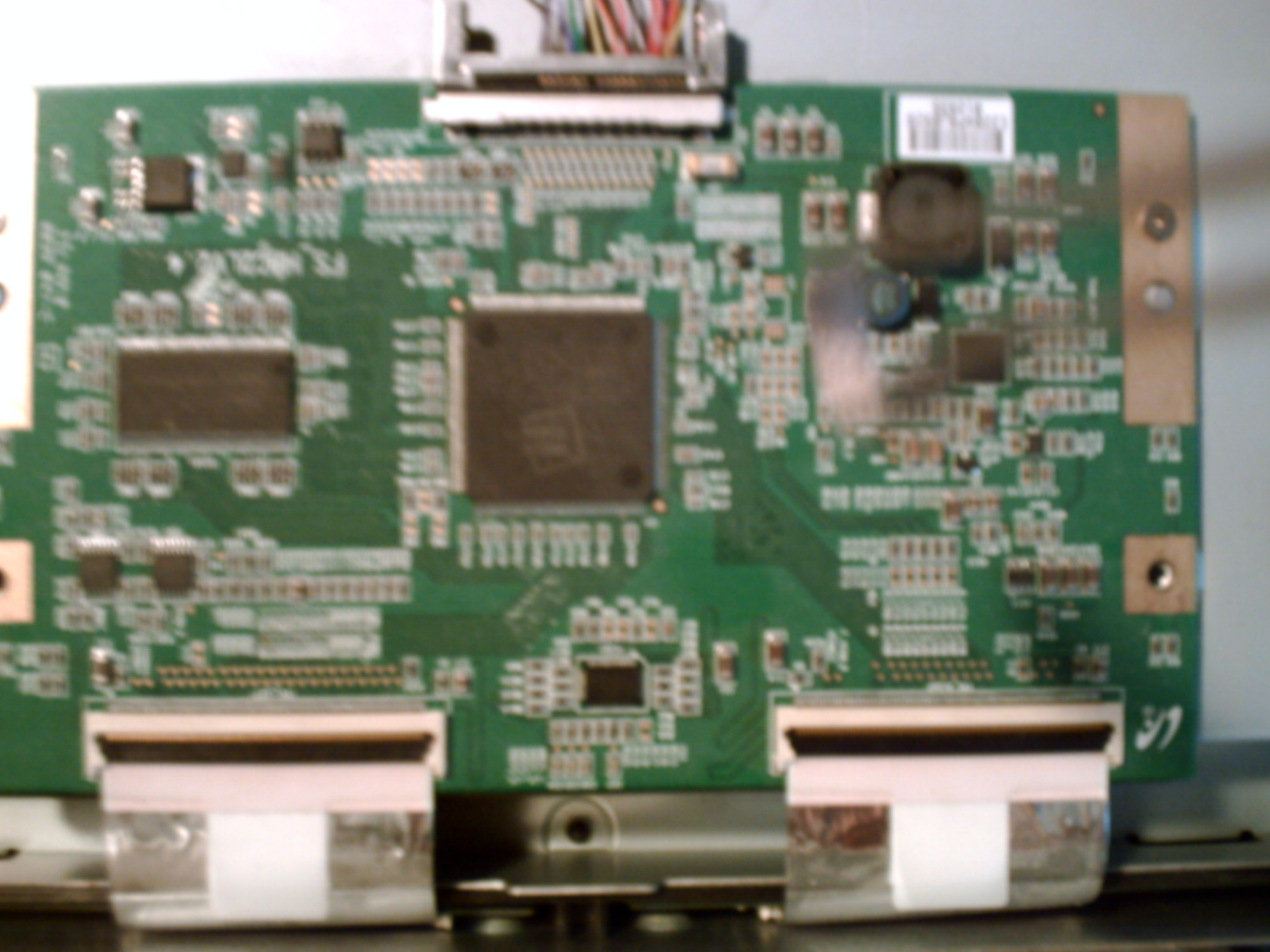

    sony KDL-46S4100 proper voltage
    have a quick voltage question, I'm getting 11.54 coming from the a board goes down to 11.30 volts at the tcon, and still no red standby on front just steady green, no video or audio, black screen, is this proper or do I maybe need a new lvds cable, any ideas, Thanks.

      Re: sony KDL-46S4100 proper voltage
      thinking 11.30 v at the tcon isn't enough to make it display.
        Most T-CON operating Voltage range is +/-10%.

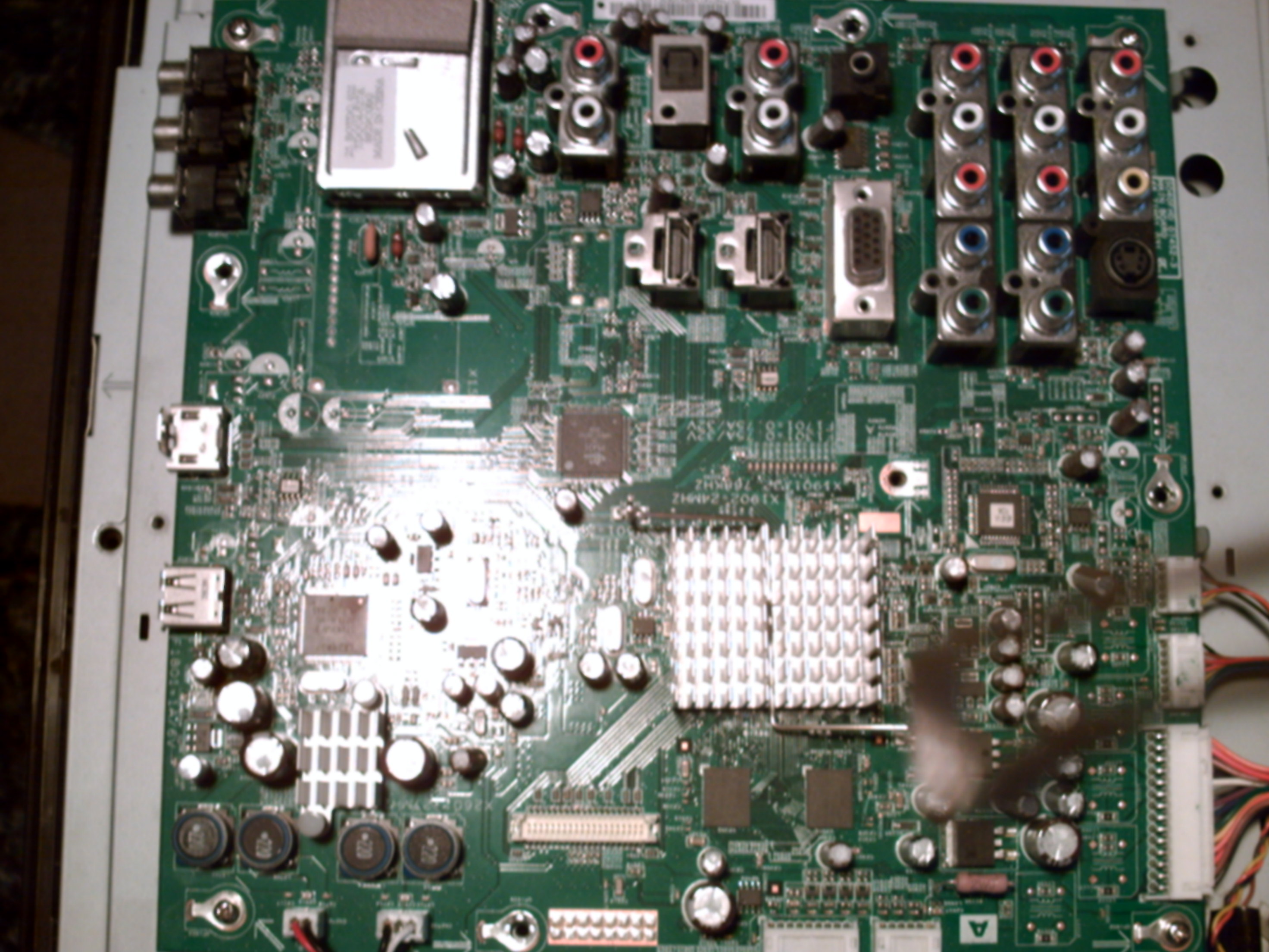

                        got different a board, have strange condition, with lvds cable unplugged from a board side only, get backlights on in about 8 seconds, with lvds unplugged from tcon side only, no backlight at all, any ideas?, THANKS. trying to post pics., having some trouble, will keep trying.

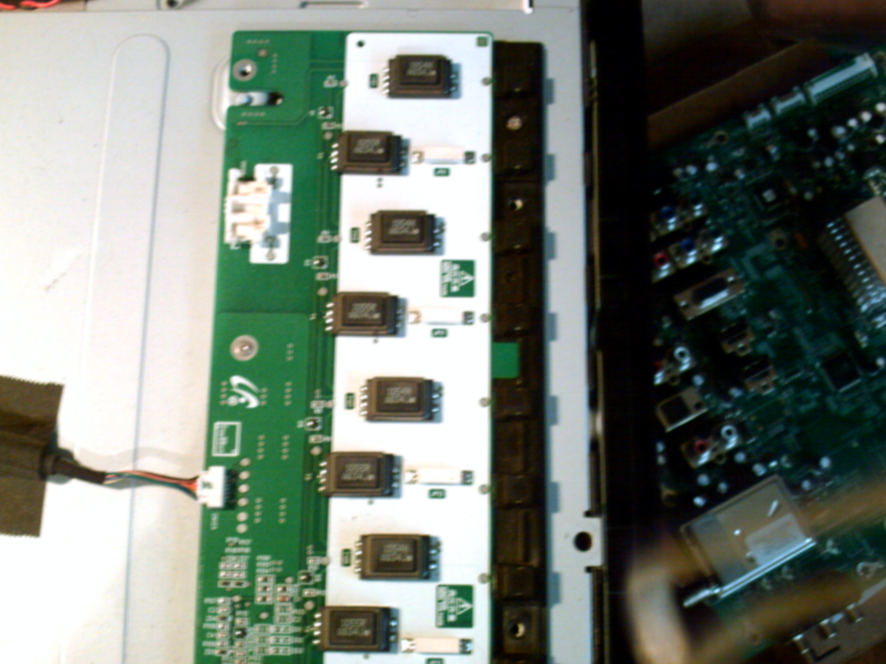

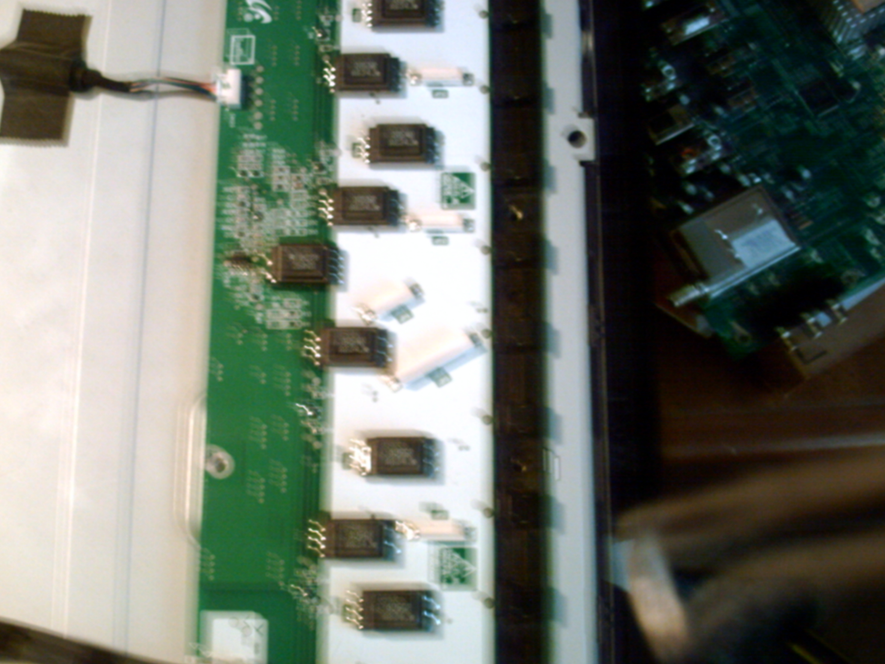

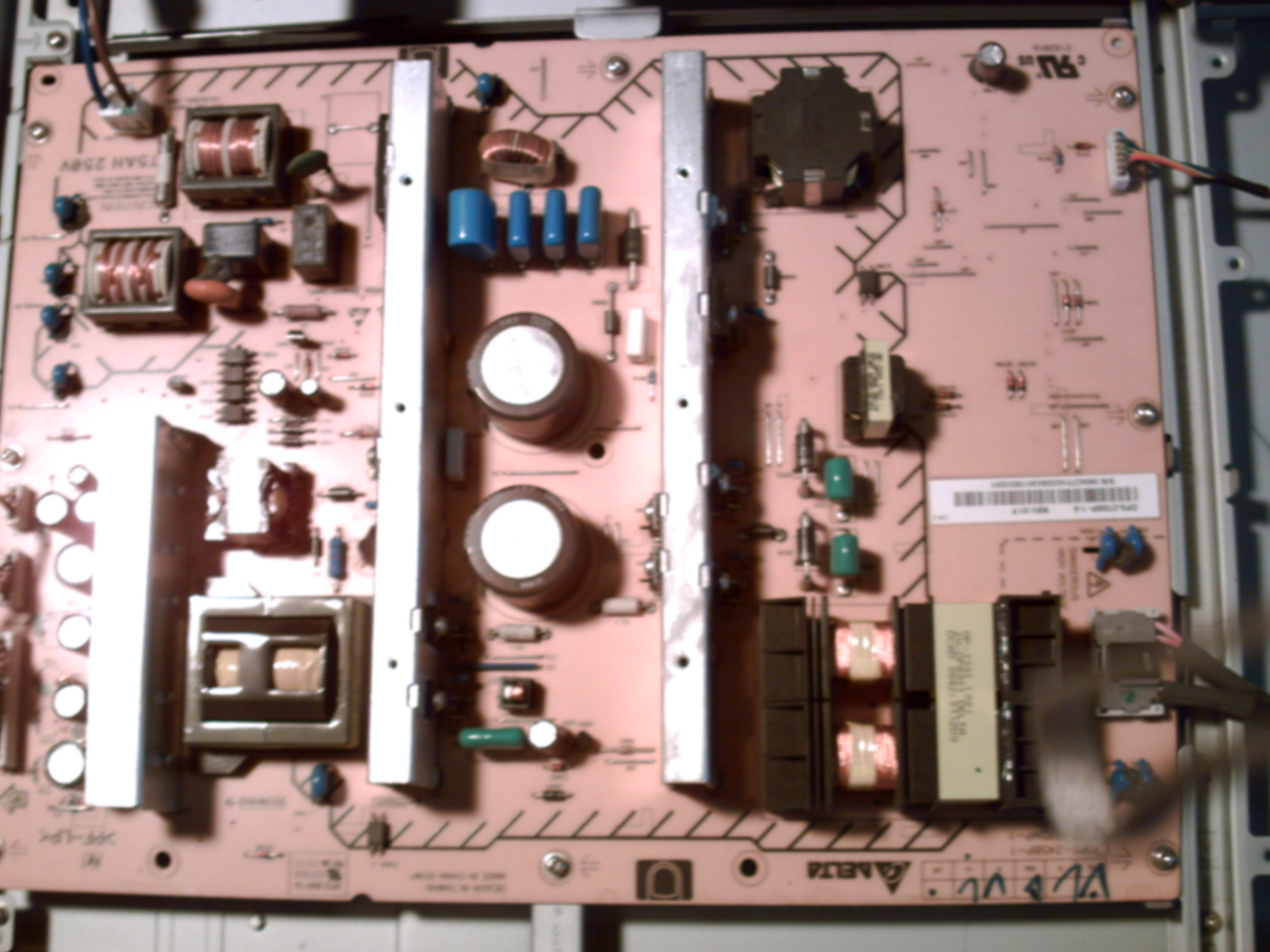

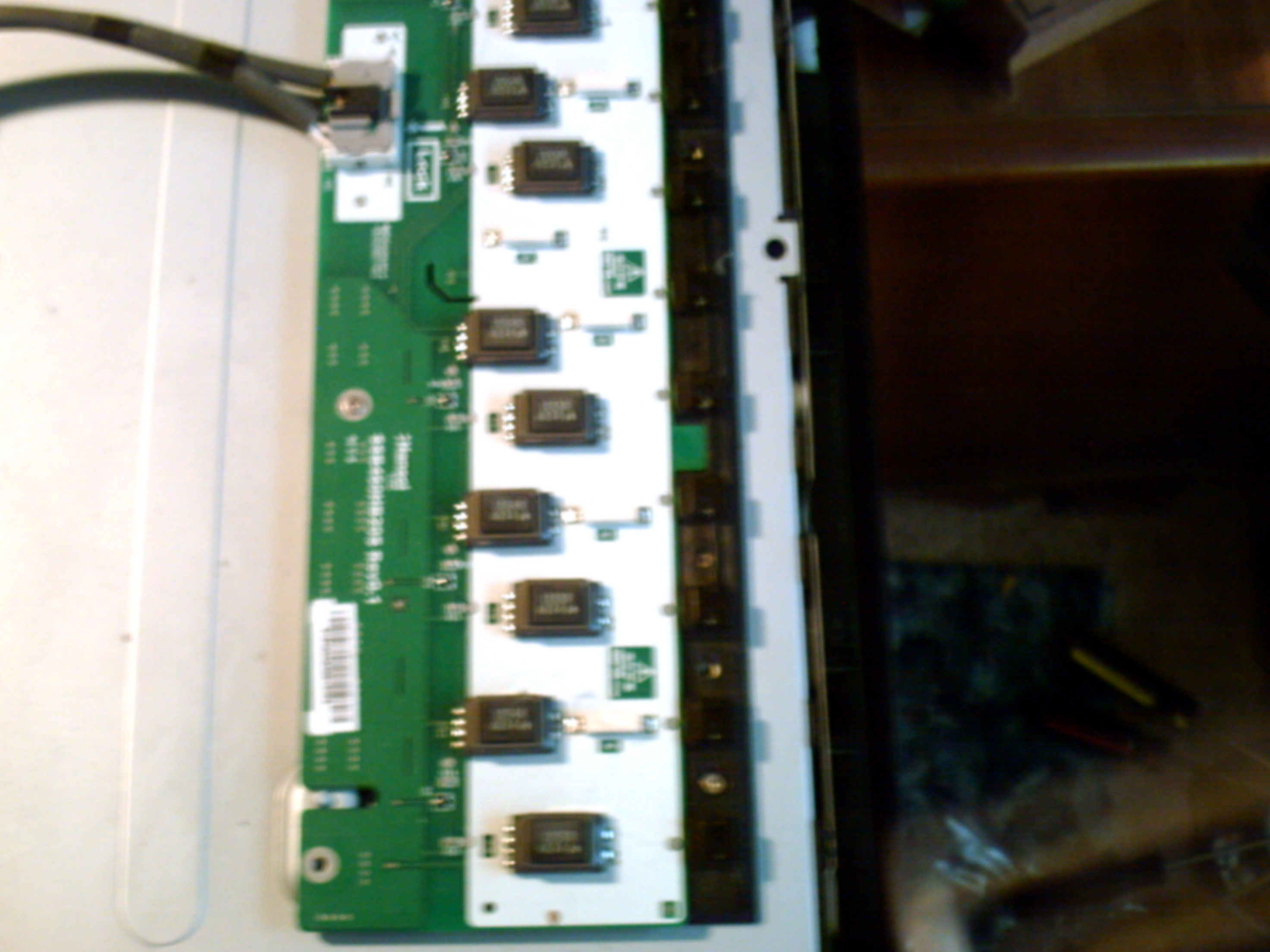

                          some pics.
                          • nomoresonys
                            • Jan 2013
                            • 12206
                            • U.S.
                            some pics.
                            sorry bout the poor pics., best I could get out of this 5mp camera.
                              when unplug bl-on connector from g board, get 2 red blinks on front but I think it's just because it's unplugged, when plugged in the blinks go away and theres no red standby at all.
                                    been reading the manuals, can't figure out why I have no red led standby on front, just steady green, anyone know what to check on g board or elsewhere, when no red standby on front?, getting proper voltages at g board to a board plugs, tried testing cn1 read 000 on 200 and 750 acv, unless I'm testing it wrong.
                                    • nomoresonys
                                      • Jan 2013
                                      • 12206
                                      • U.S.
                                      tested it wrong, there is 122v at cn1.
