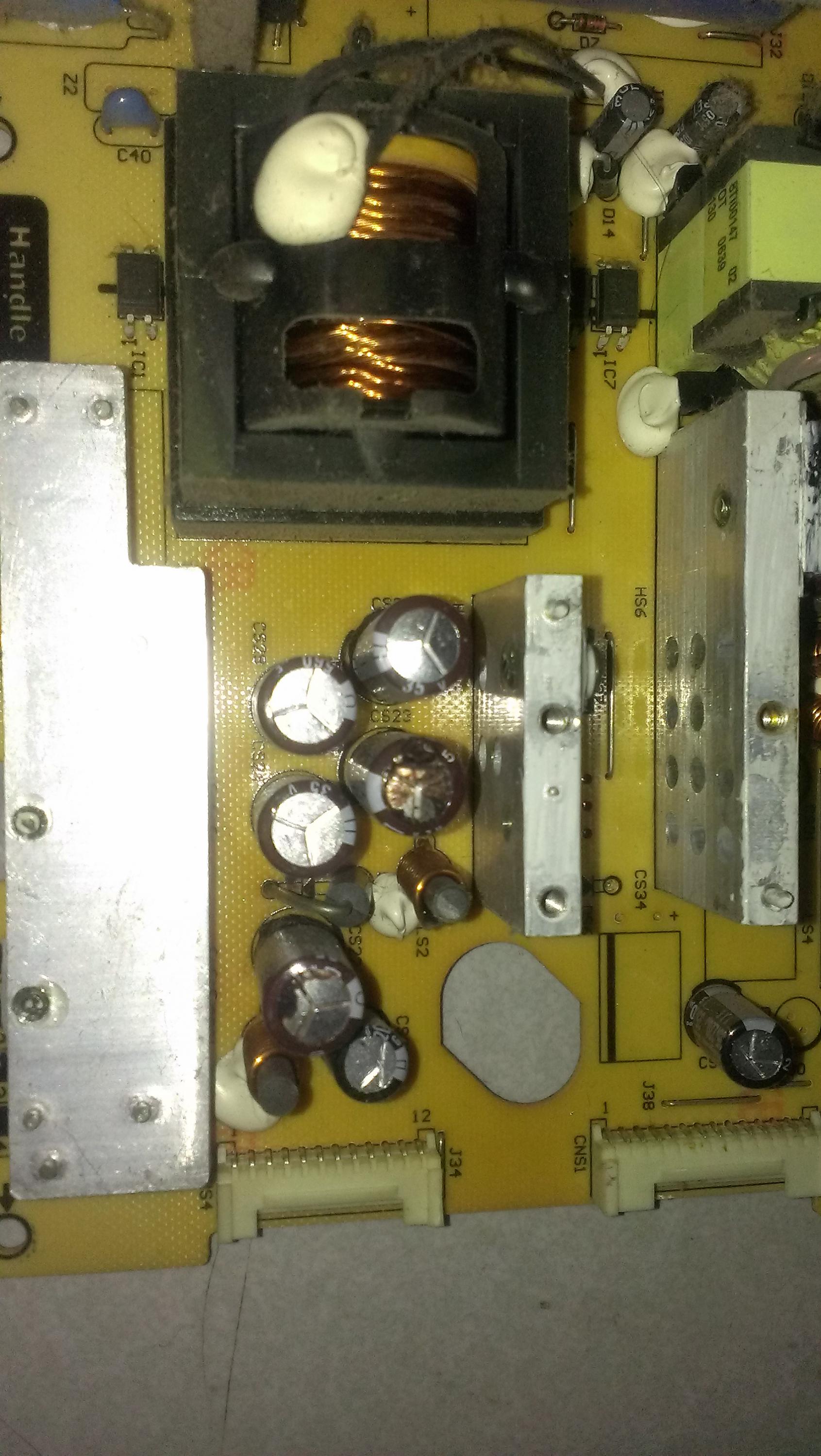

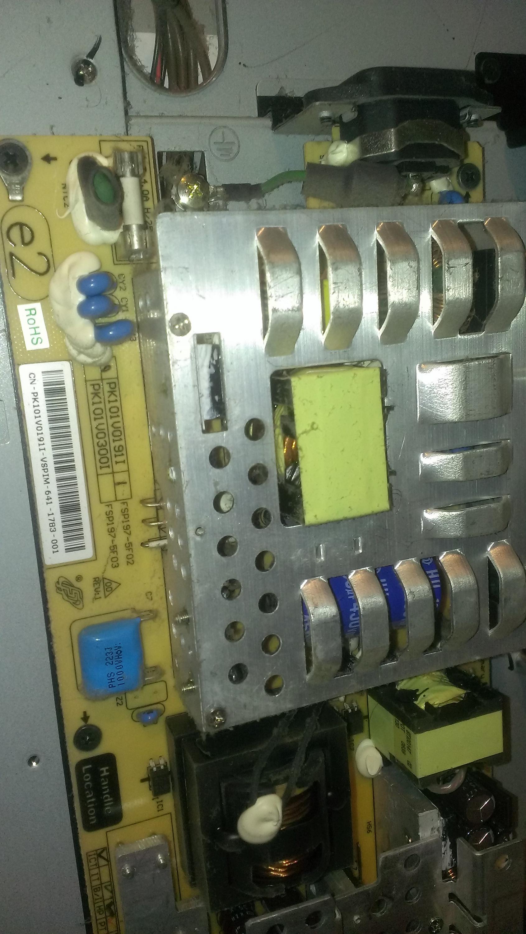

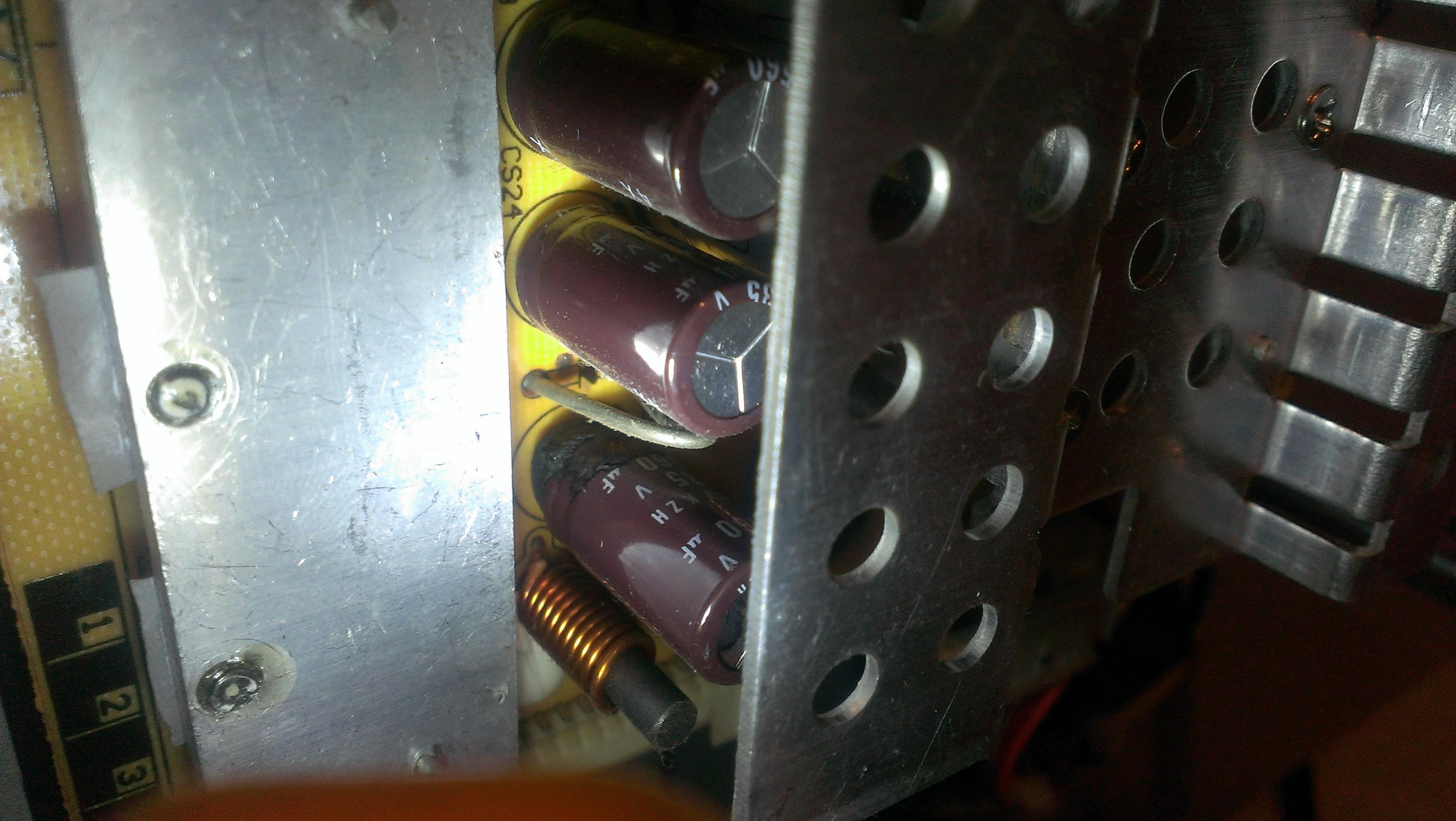

    So today i found tv again that someone thrown out, Was hoping to be lucky that it will work but nope..
    When the power button is pushed the amber light will come on and that's it.
    Its suppose to turn blue when on. And when unplugging it and plugging it back in the amber light will blink 5 times.

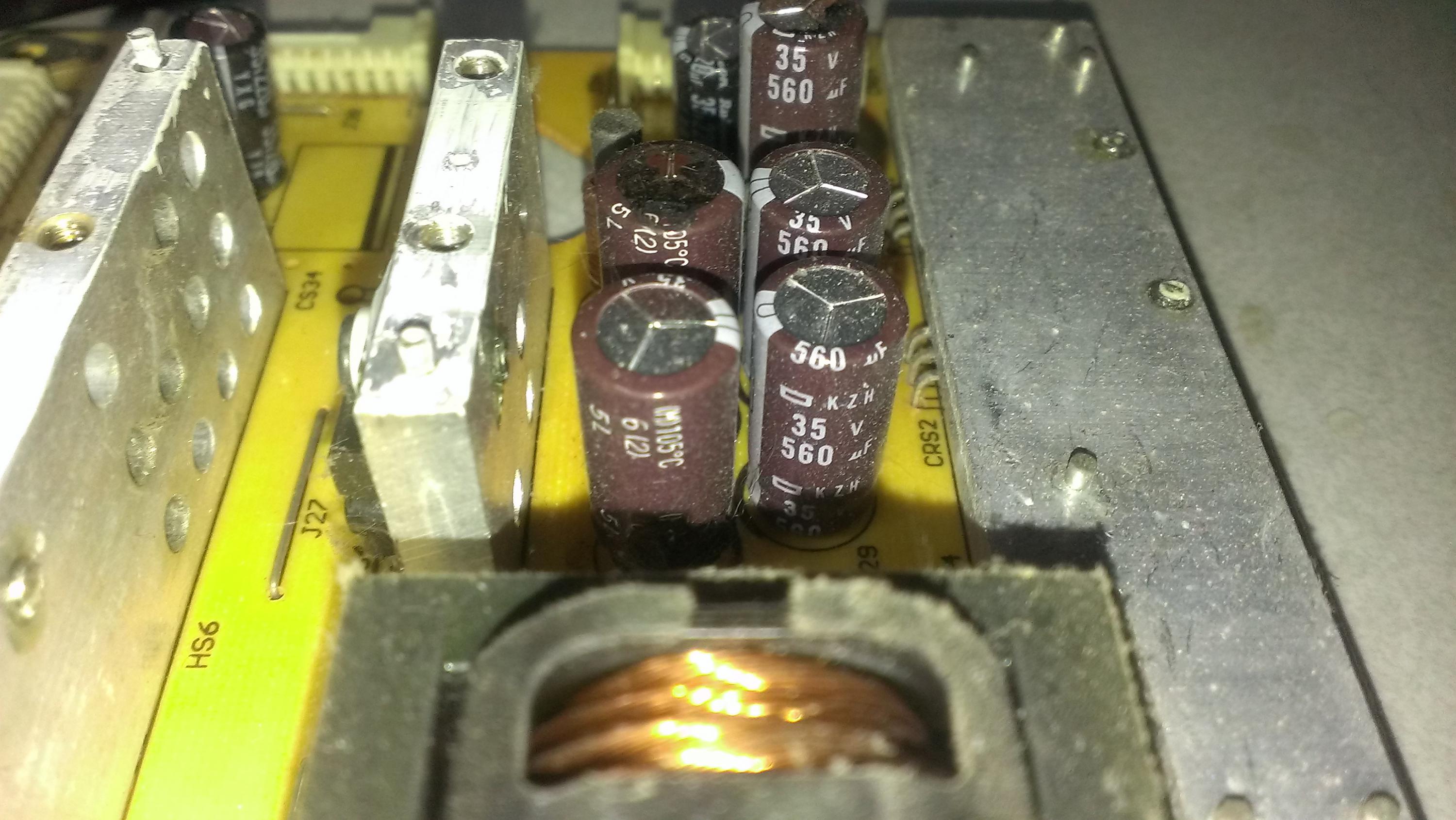

    So i figured i take it apart and see whats up cause i herd power supply's with bad caps are a known issues with lcds.

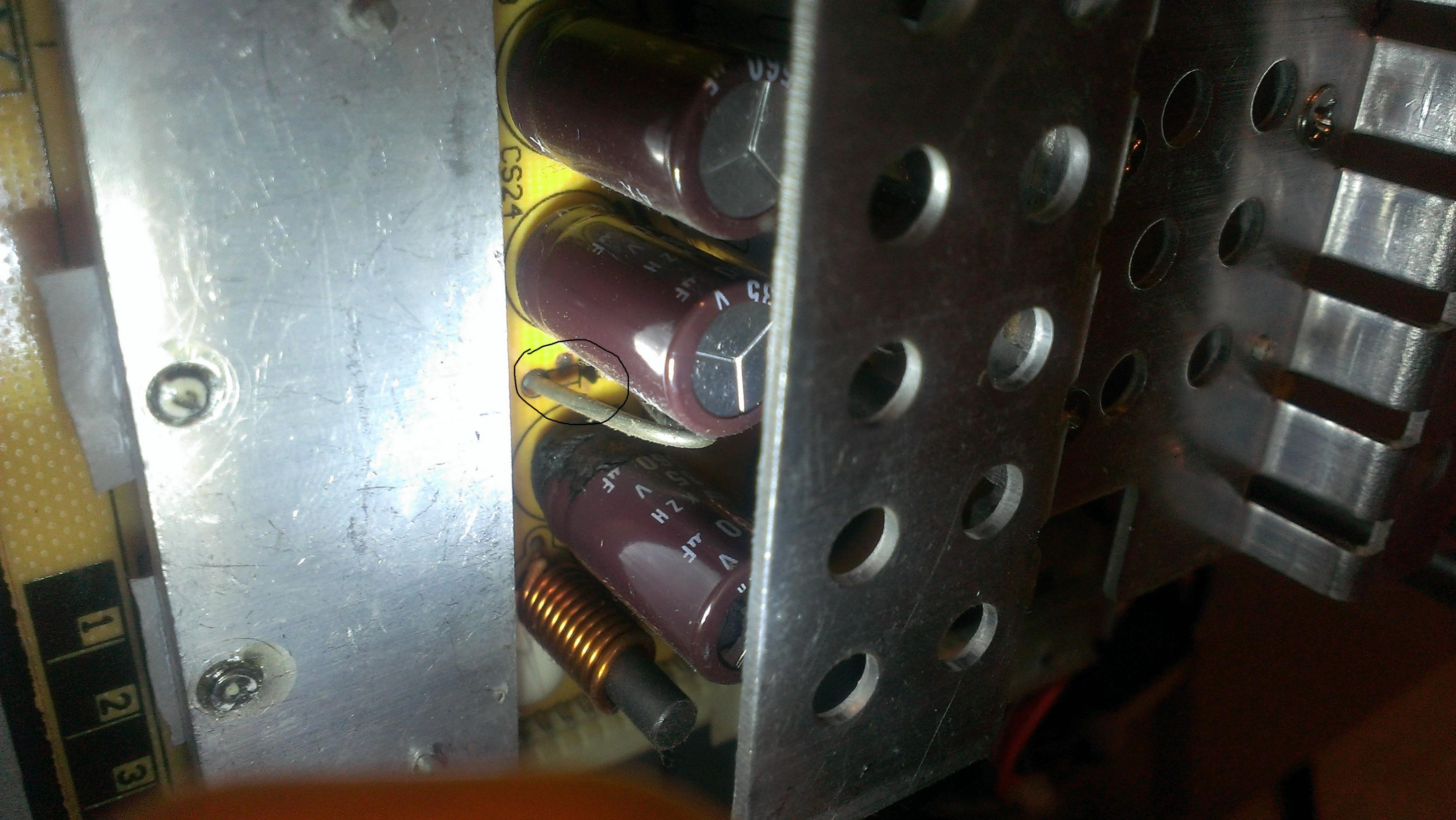

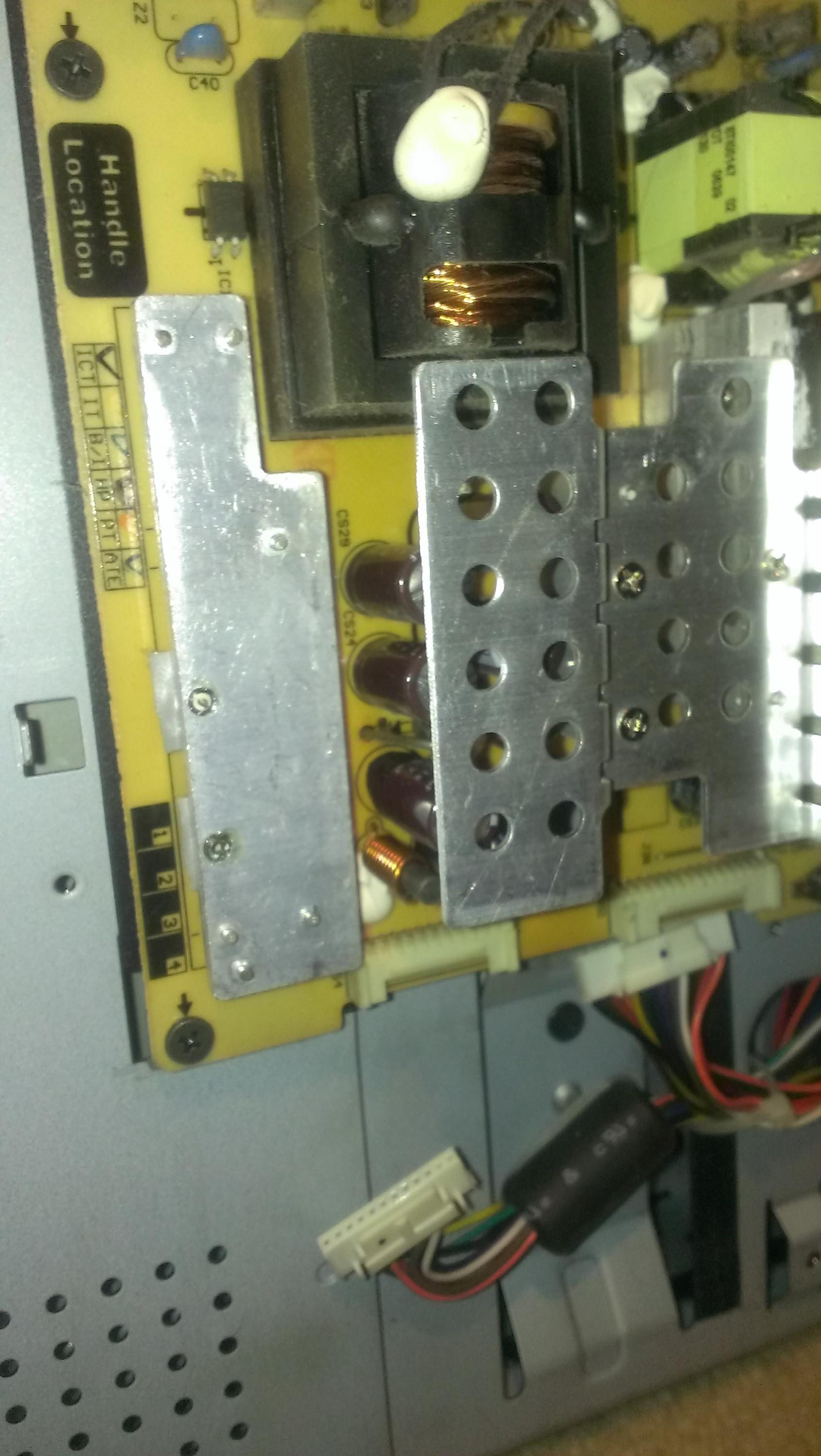

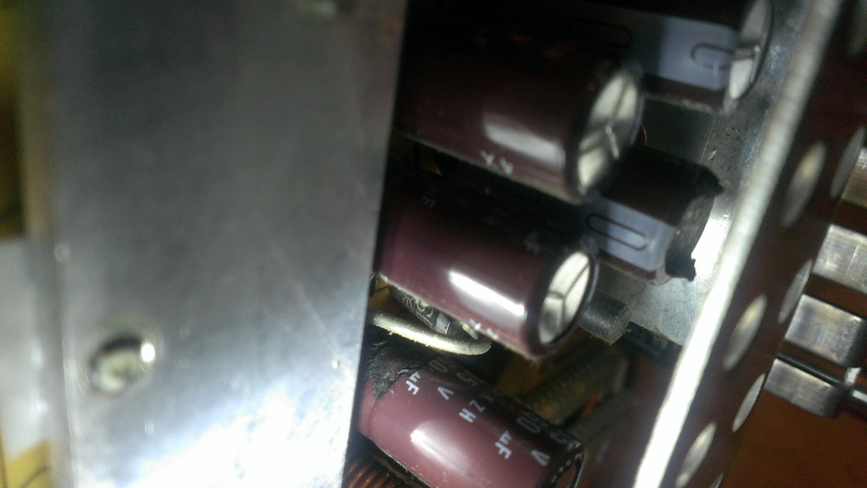

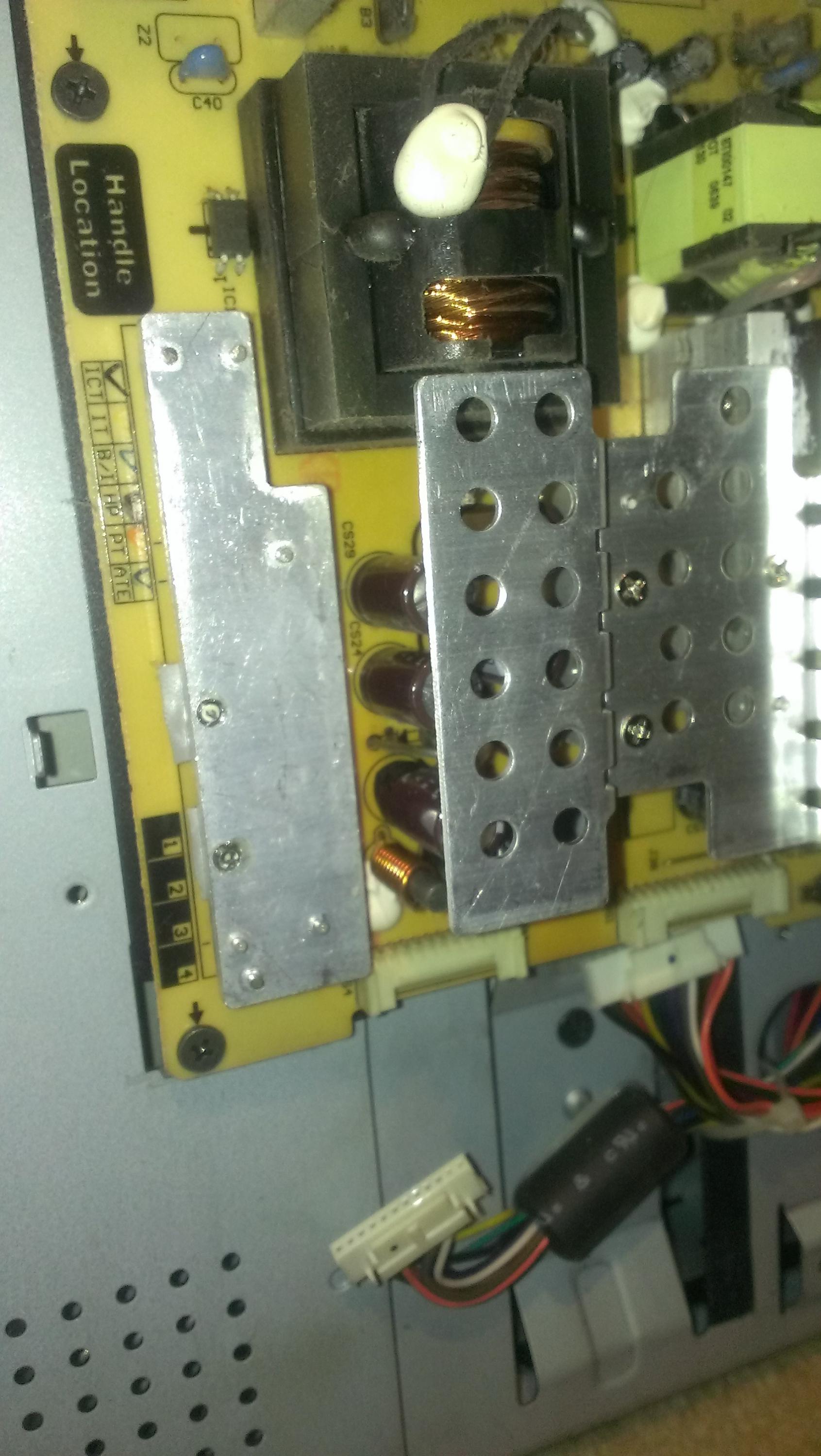

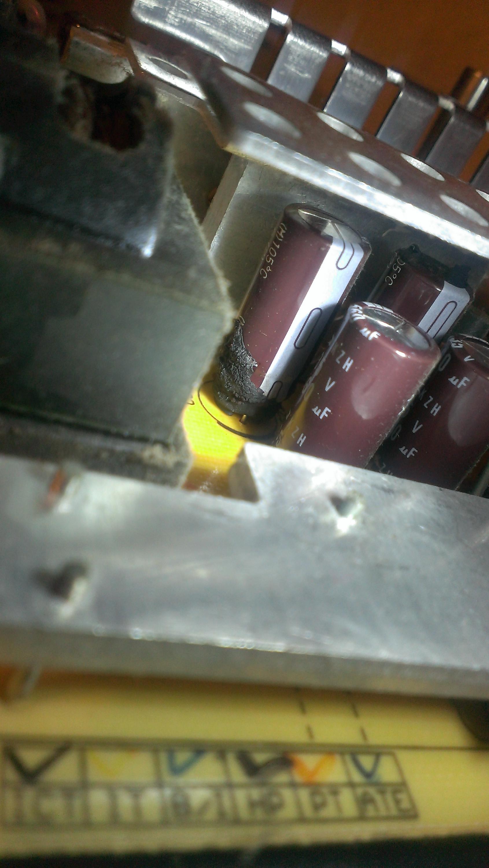

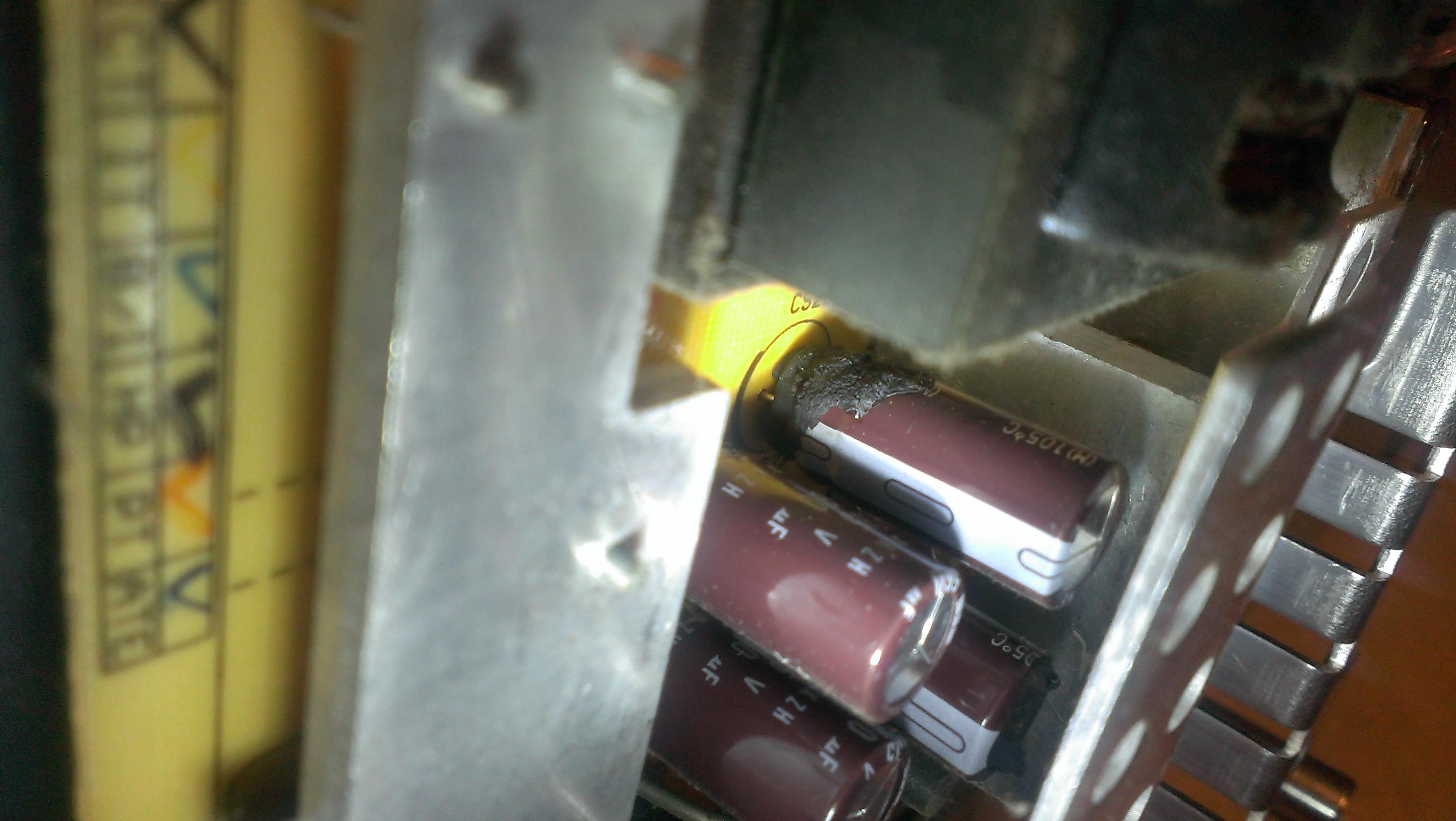

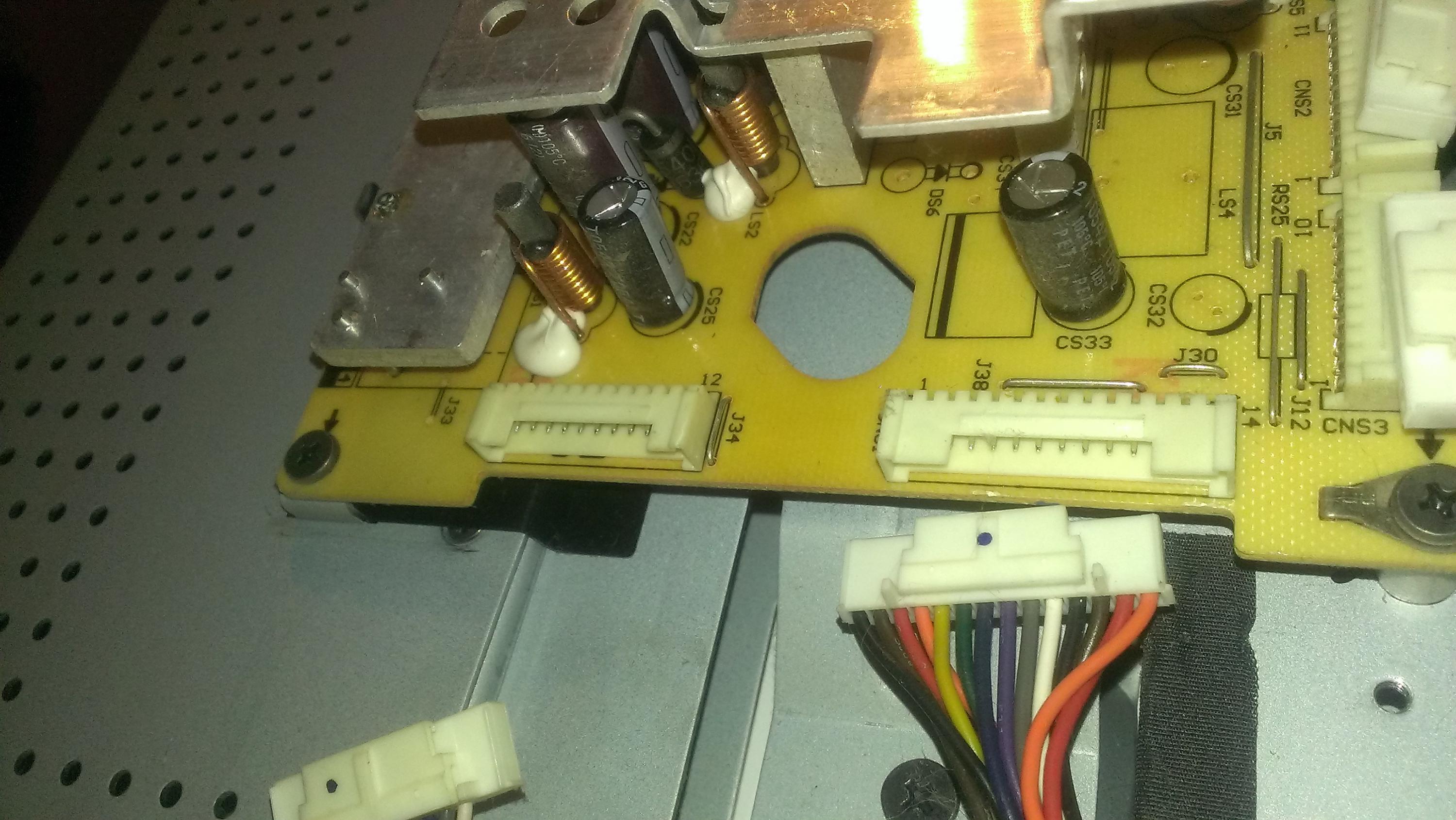

    So after taking the psu heat shield off, There seems to be about 3 burnt caps under the heat sink on the secondary psu side.
    I attached some pics of them.
    Also i got some light on the panel to show after pushing the button a good bit which ony lit for about 2 secs. I also hear a faint clicking on each side of the panel i guess the inverters or the back lit is trying to come on? The power supply also makes a faint noise also.
    So pretty much if i buy a new power supply for this will the tv work? Can the bad caps cause any more damage to the tv?
    Cause i can get a used psu on ebay for about 35$ or a new one for 45$ Which isn't bad at all if i can get this tv working again.
    Or i can try and soder new caps in sense it wont hurt trying anyways. Ony thing im worrying about is getting shocked.

    a used ebay one might not last too long since obviously caps on these aren't so hot
    If you have the ability, I would start by changing the caps on this one since you do have a little power in it so it is not totally cooked.

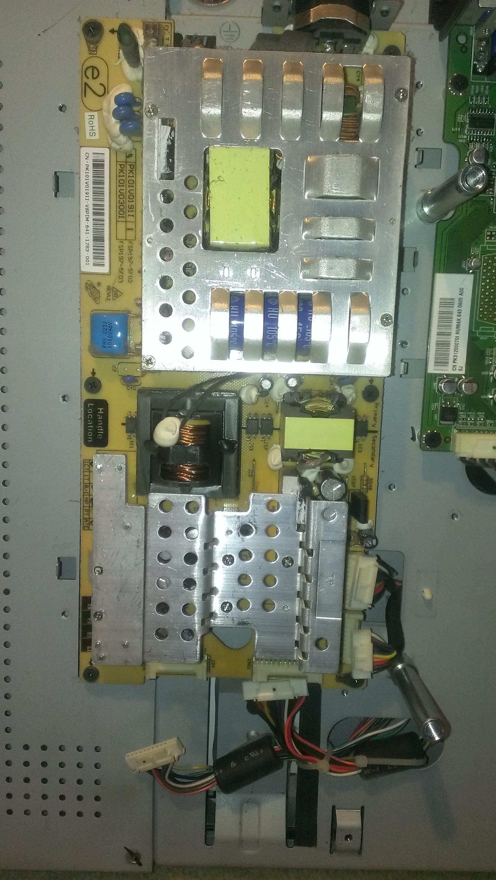

                  Oh and also on one of thoes pics i posted i notice a burnt spot on a metal thing by the caps. Will this be a problem?
                  Heres the pic with a black circle around it.

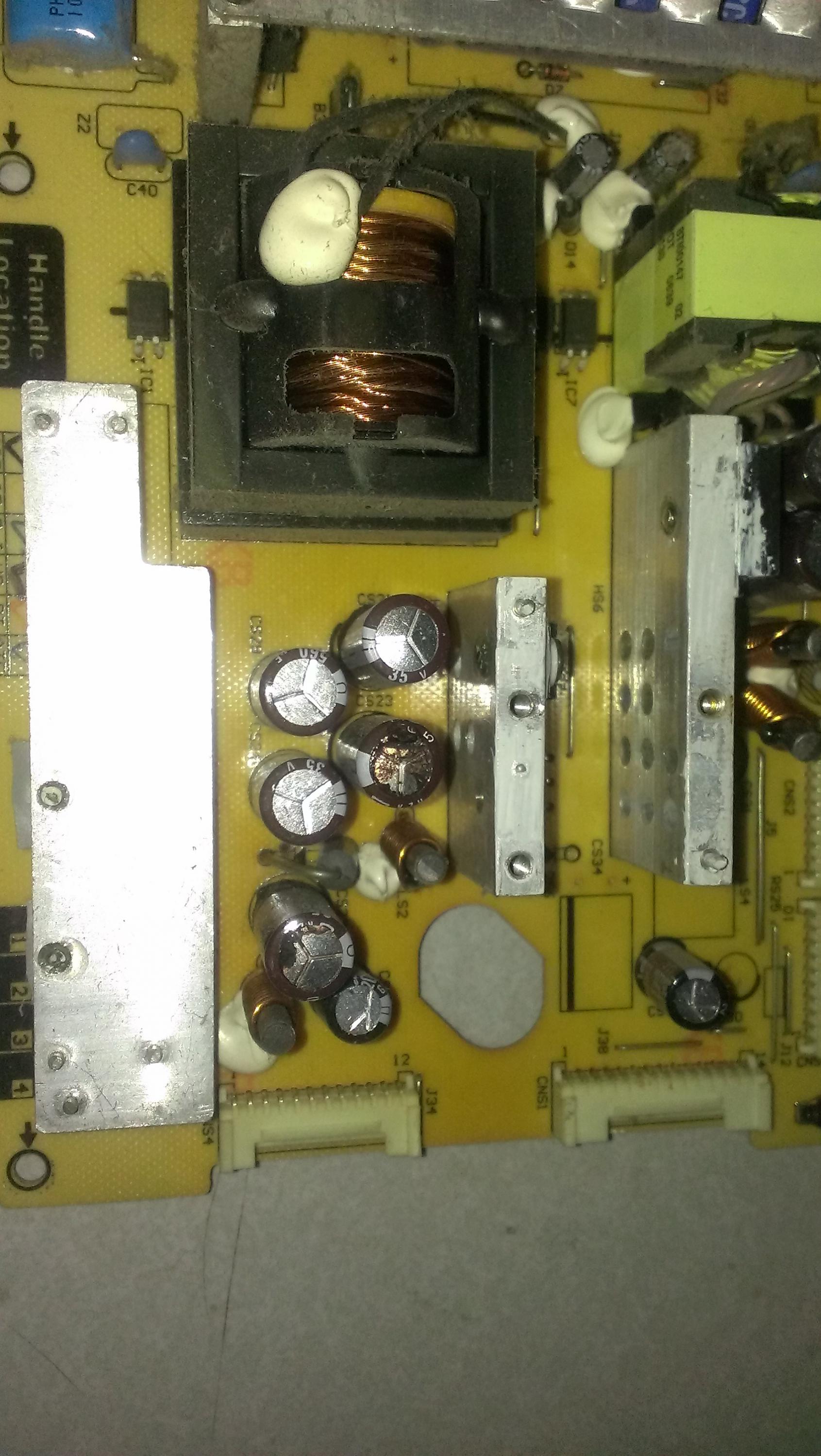

                    look at the underside and everywhere else on the board for more damage. The caps you get as a replacement should have equal or greater voltage/farad values. if the caps are the only obvious damage, id start by replacing them
                      Re: dell w3707c just a amber light on, Burnt caps pics inside!

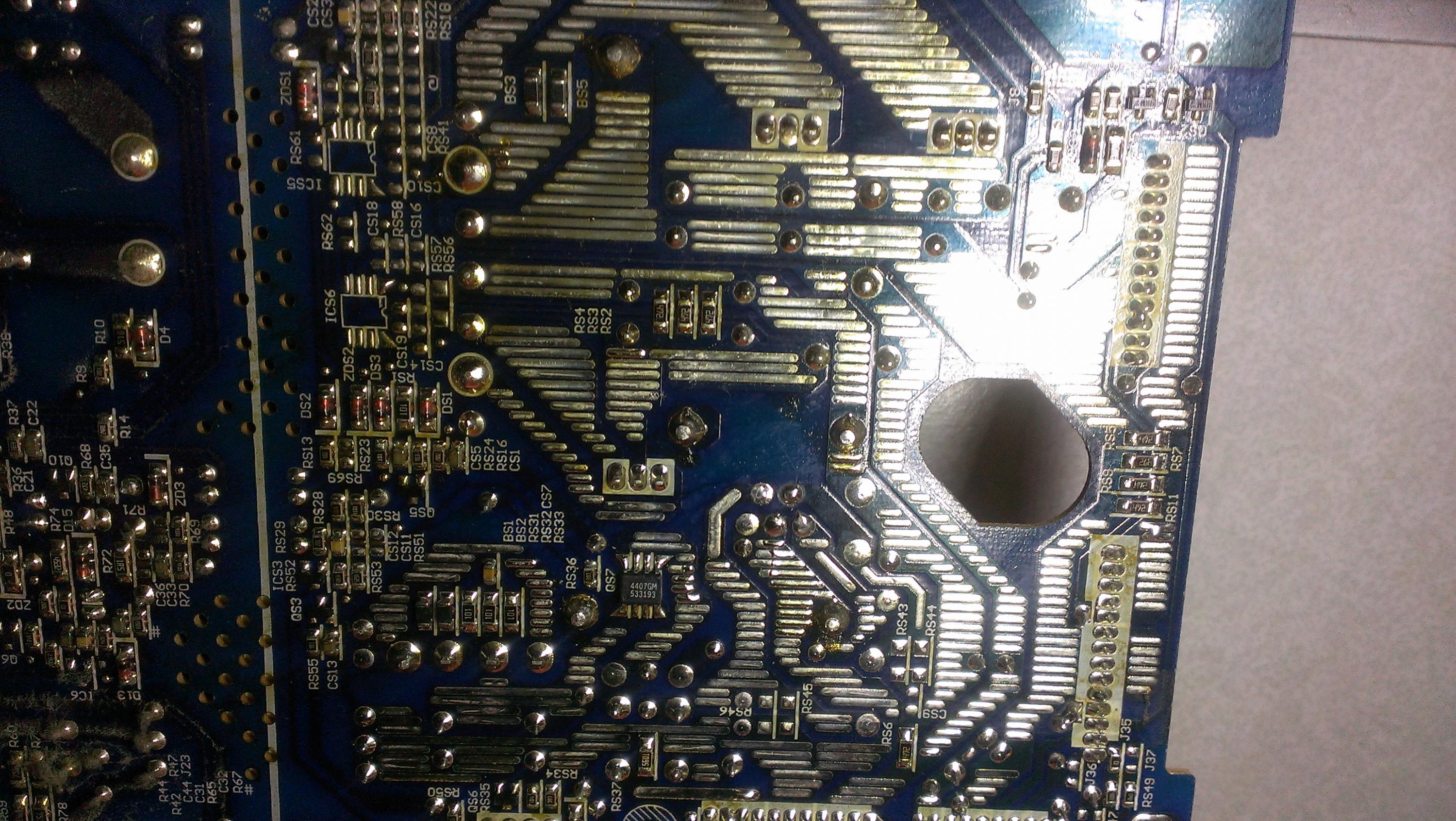

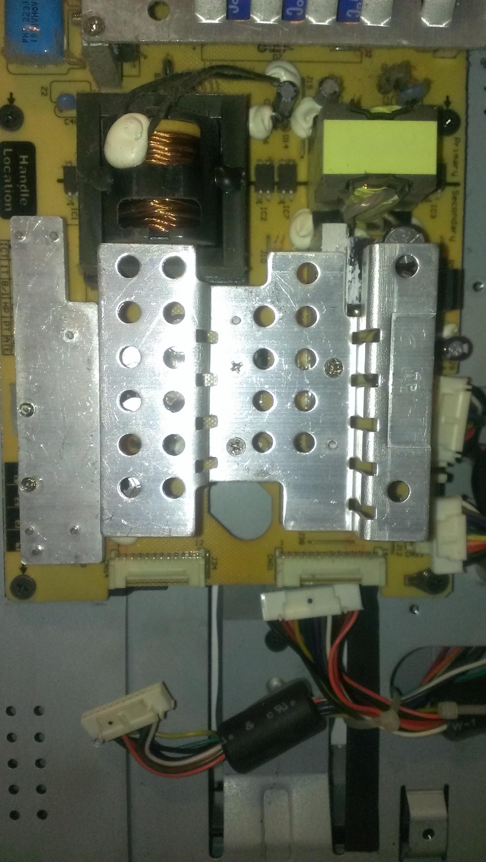

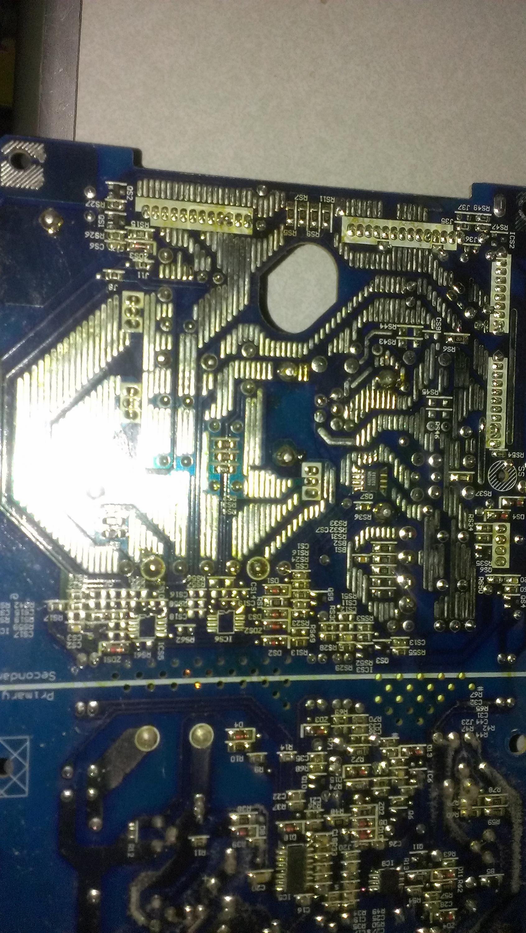

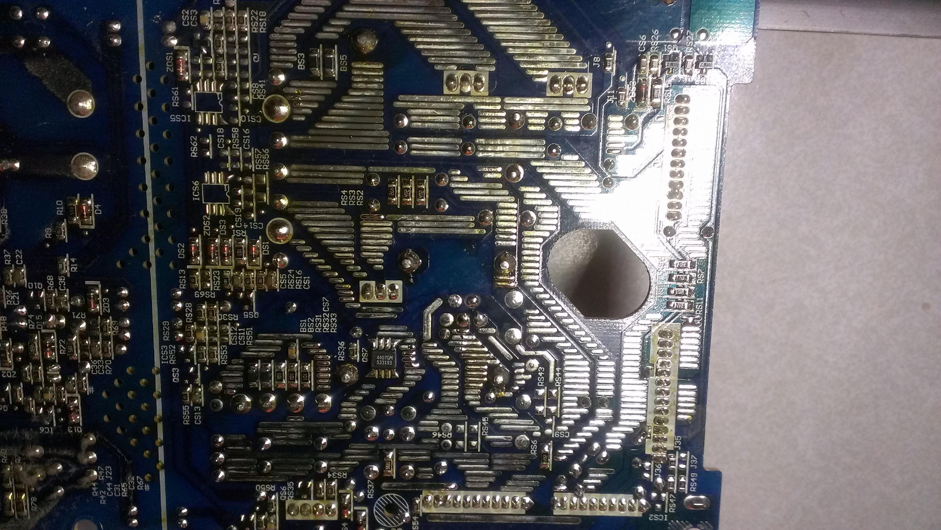

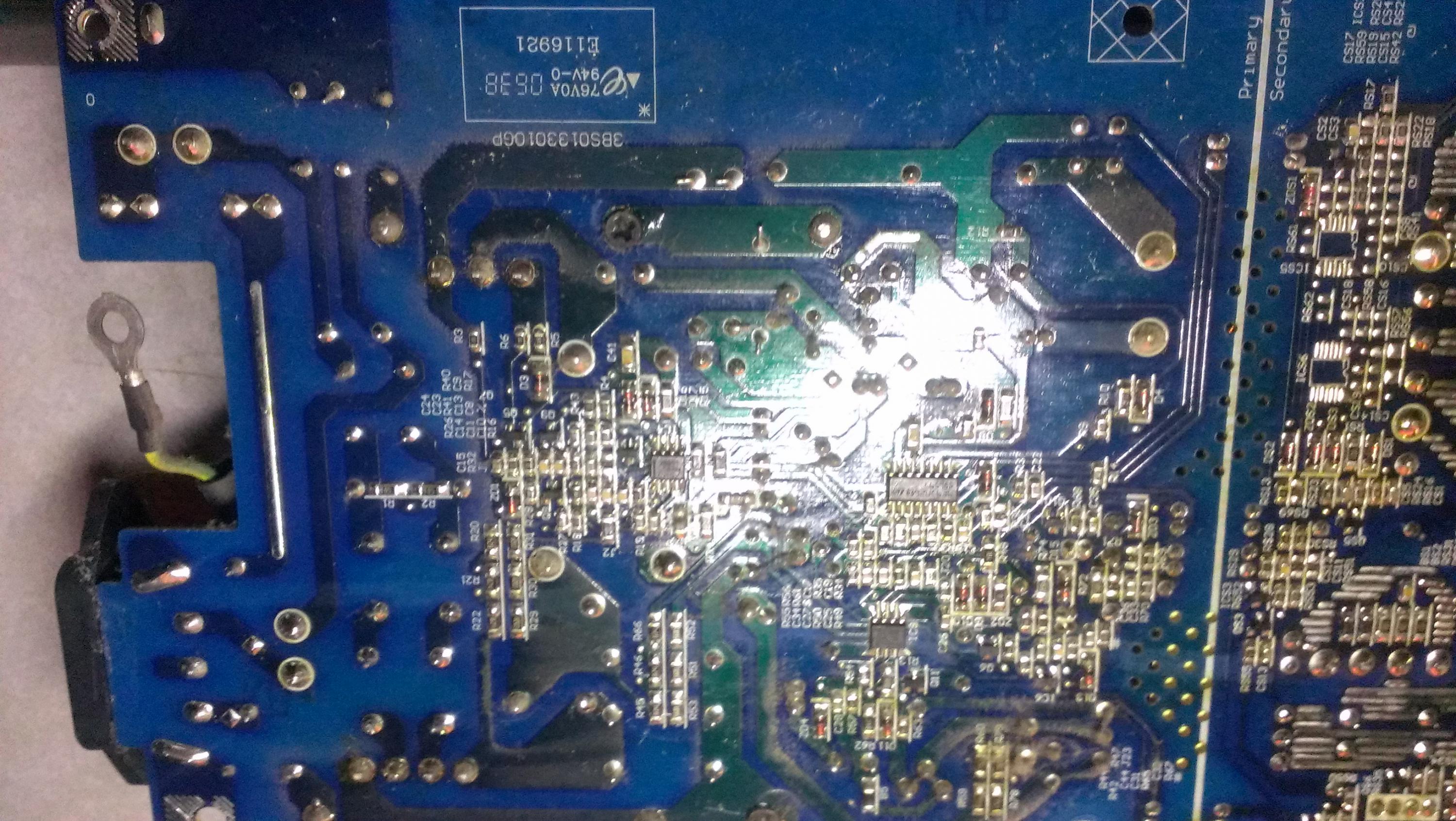

                      It looks like the SMD on the bottom side of the board may have over heat or burnt up, post good clear pictures straight shots of top and bottom side of the board.
                      You need to get low ESR type capacitors, not the general purpose type from RadioShack.

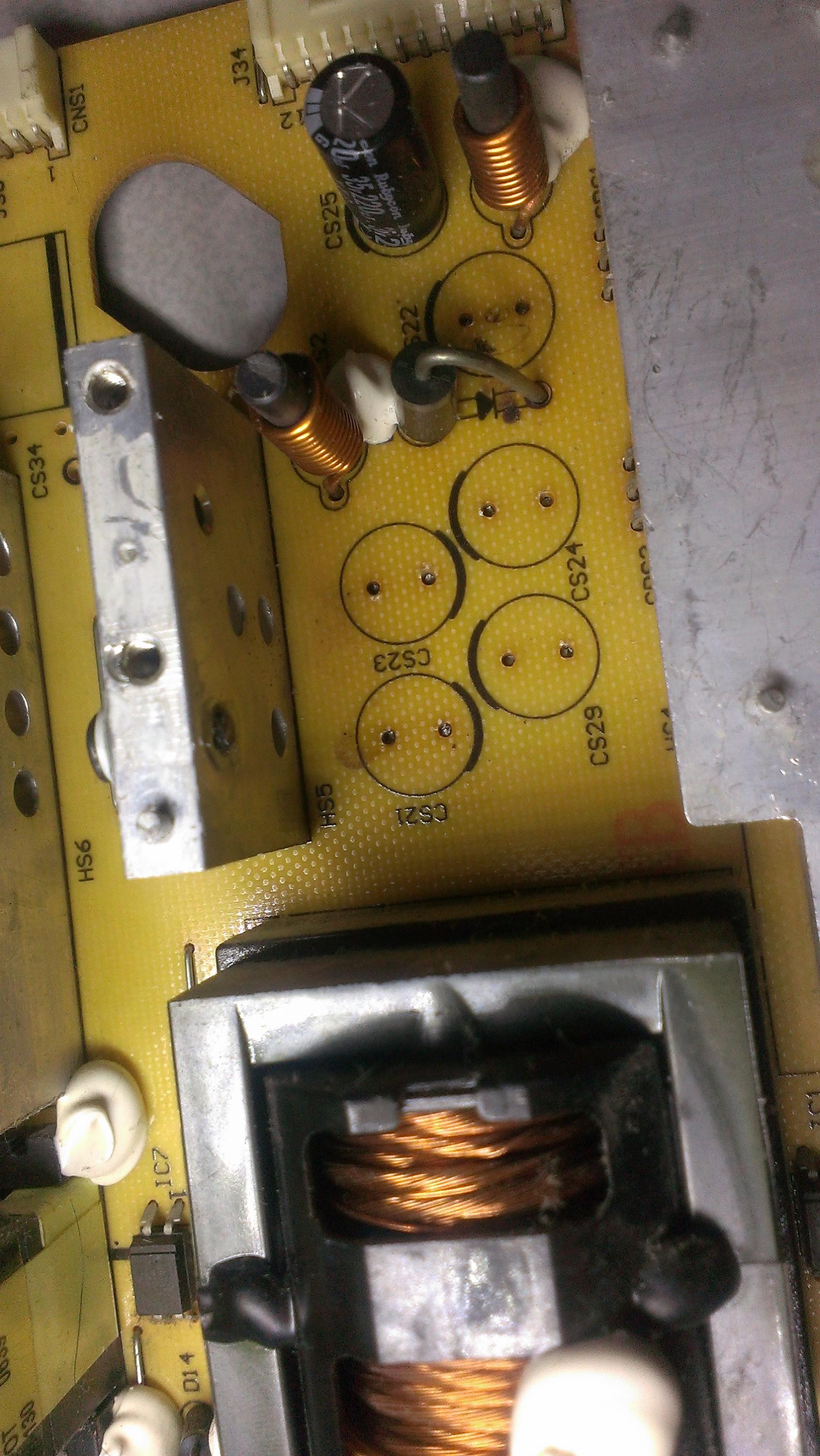

                        Heres more pics of the board. And close up ones. Hopefully they clear enough.
                        So far i really don't see any other damage other than those caps. But i leave it up to the pros to decide

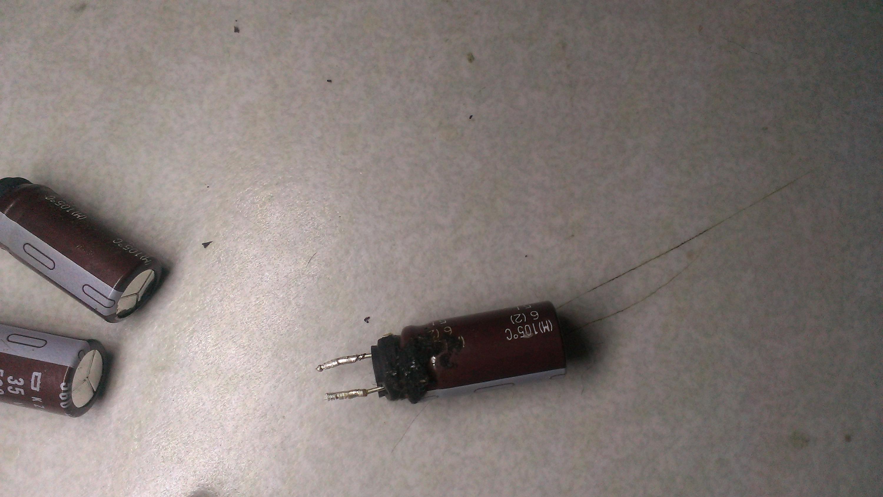

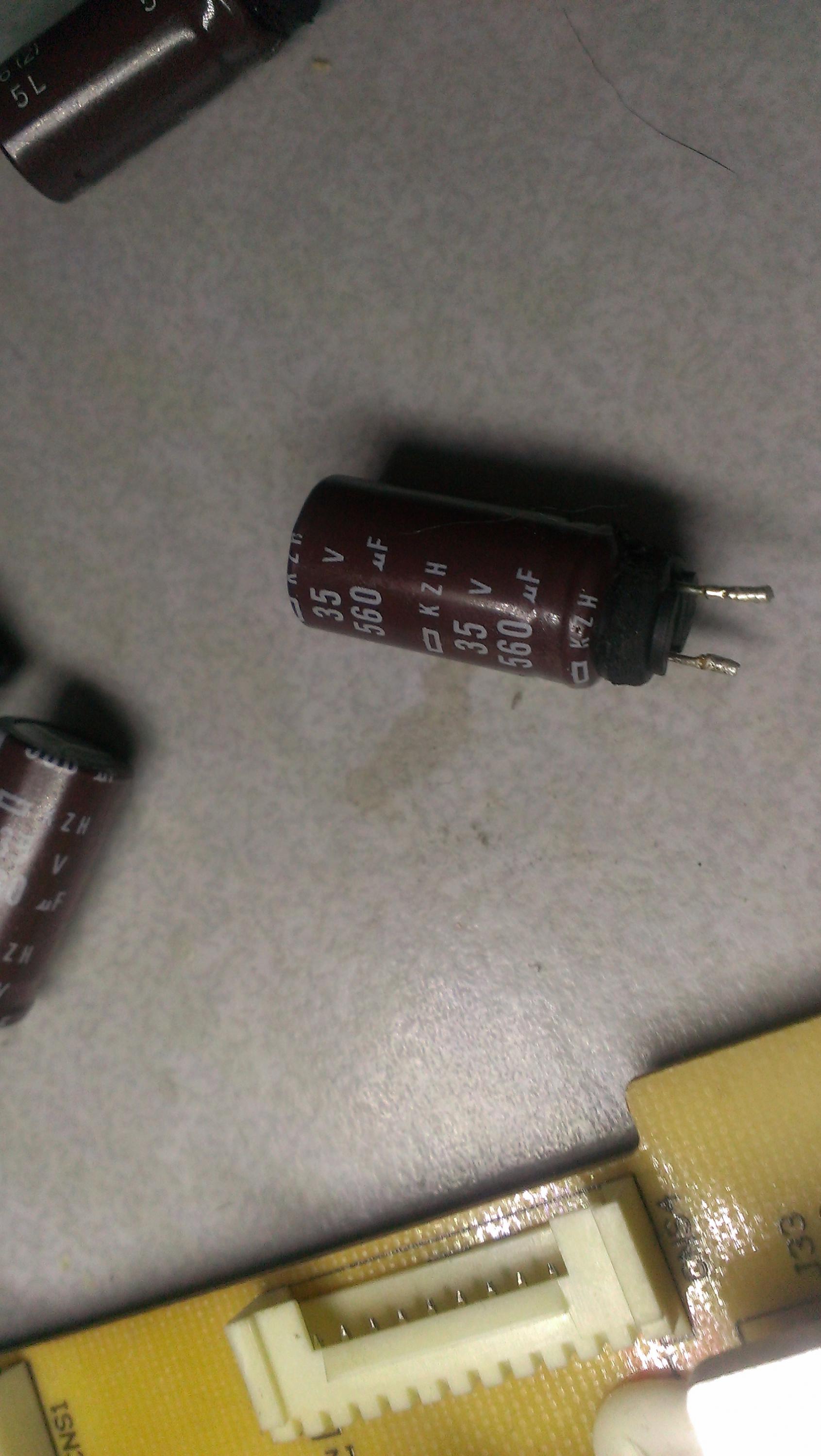

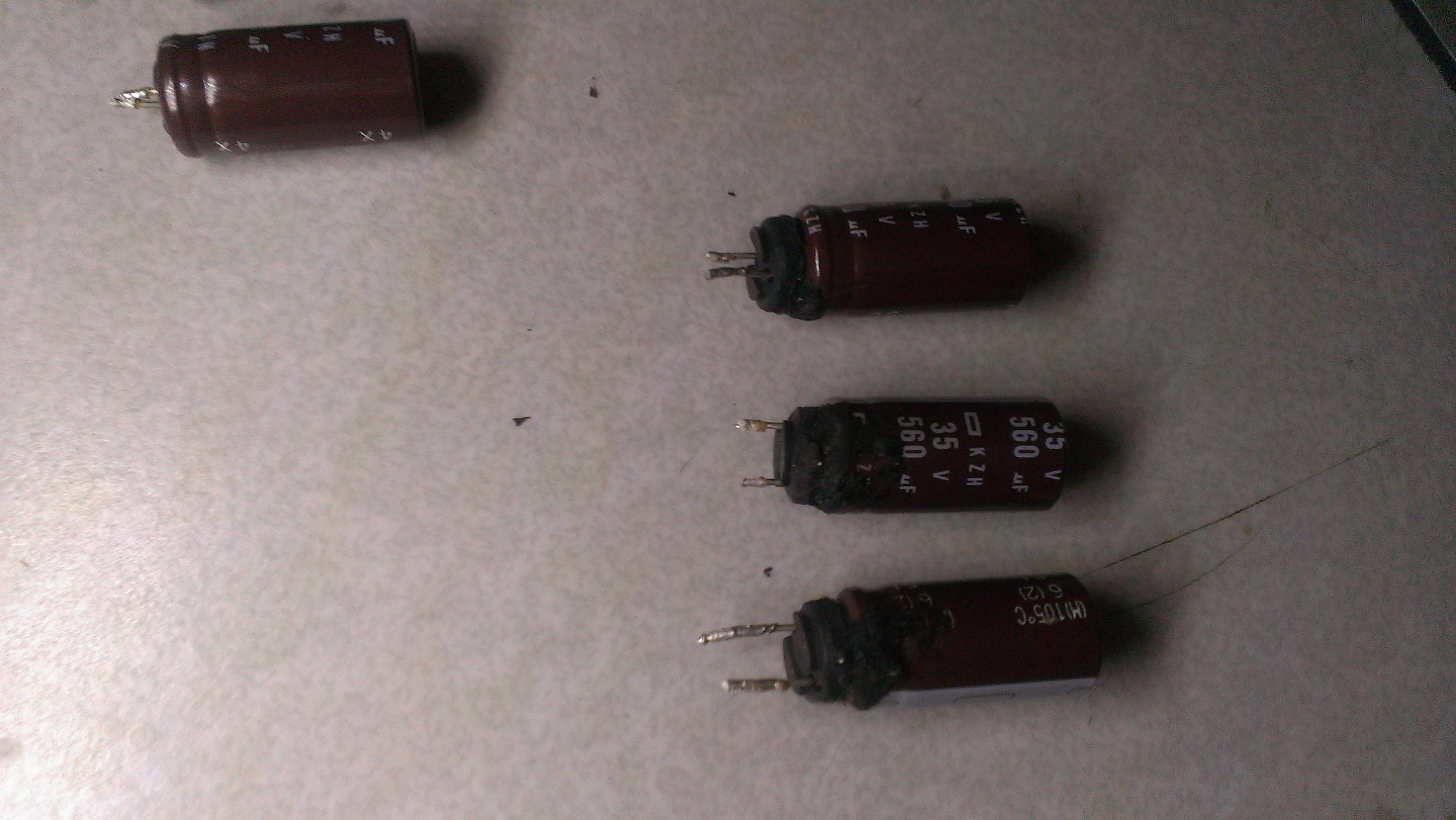

                            what does it say on those caps.
                            it looks like 35v and KZH but i cant see the rest.
                            and how wide & tall are they?

                              Hi
                              You need to post pictures, of the soldered
                              print on the underside of the PSU to get a better
                              idea, if there is a problem with the SMD components
                              on that side.
                              Alan.

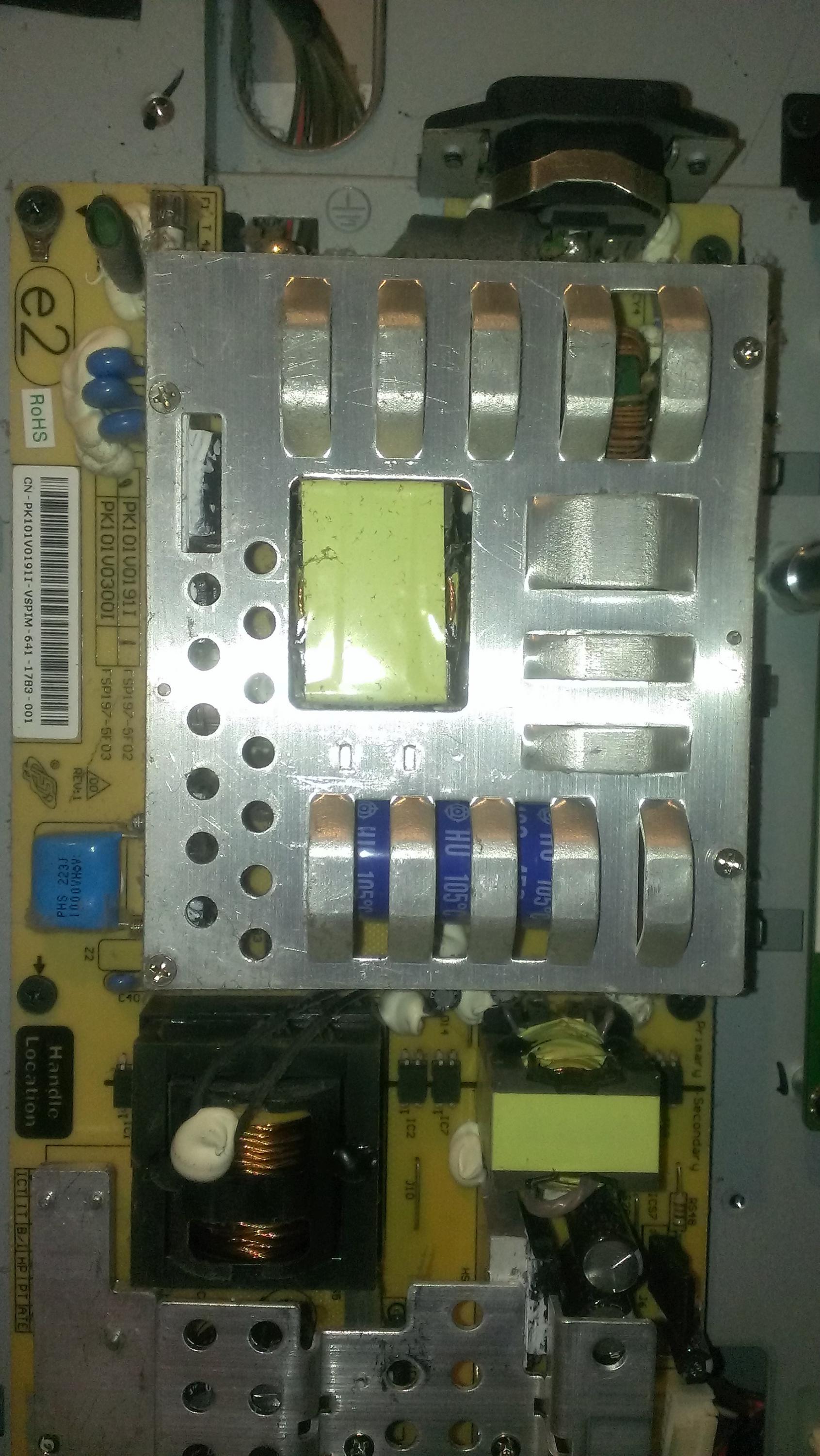

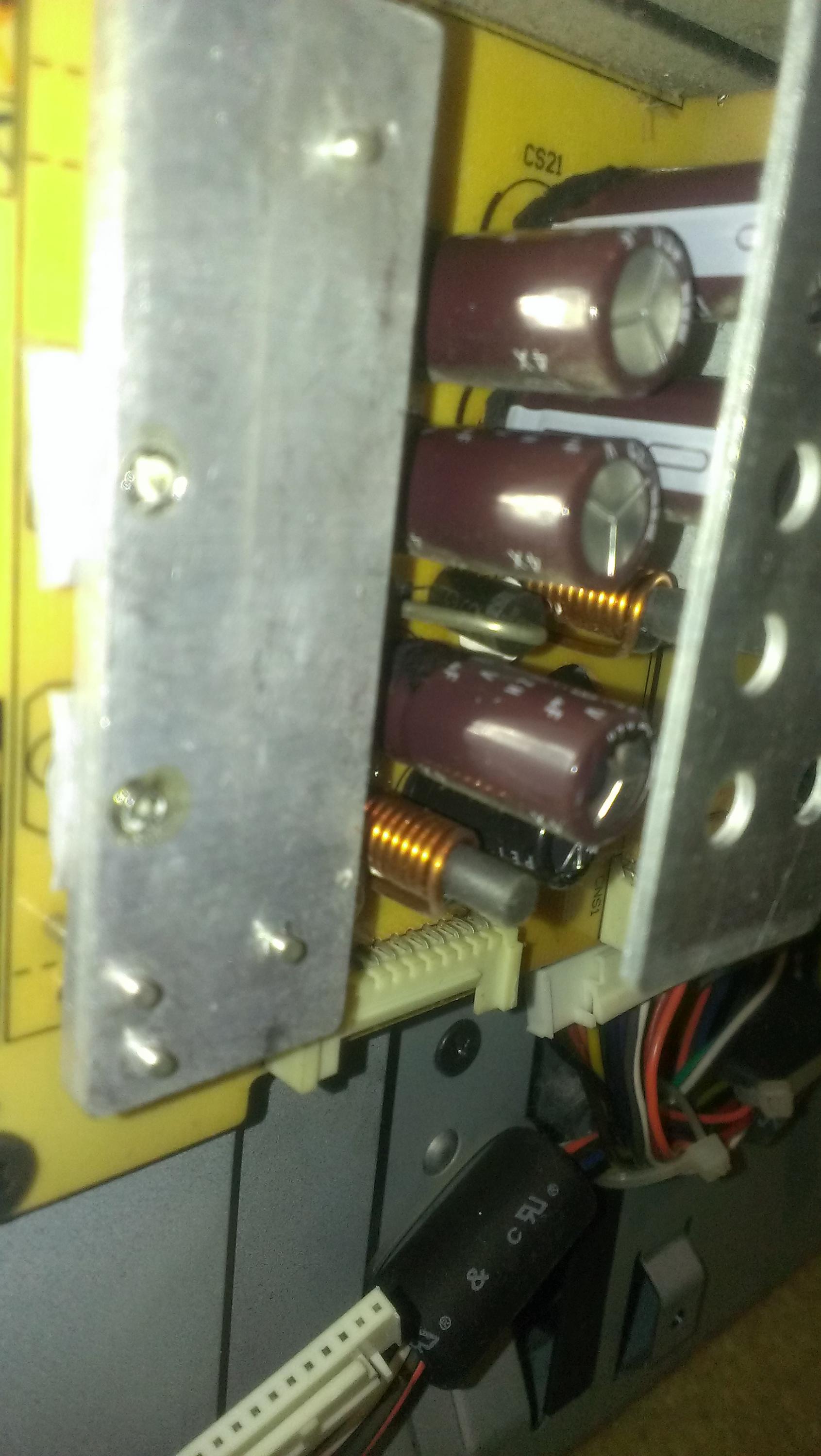

                                Here's better pics, And also took the top metal heat sink shield off the psu and underside.
                                So far by looking at it, It seems like the ony damage i see is the burnt and swollen caps, But really not sure. need the experts for that
                                I figure i try and get this one going sense so far i fixed a hans g 28inch couple days ago by replacing the 2 caps that budm said to replace. Using that same monitor as i type this
                                soldering in caps isn't really as bad as i thought it would be.

                                added 4 more pics i decided to un solder them to get a better look.
                                  So does everything look good other than the burnt caps?
