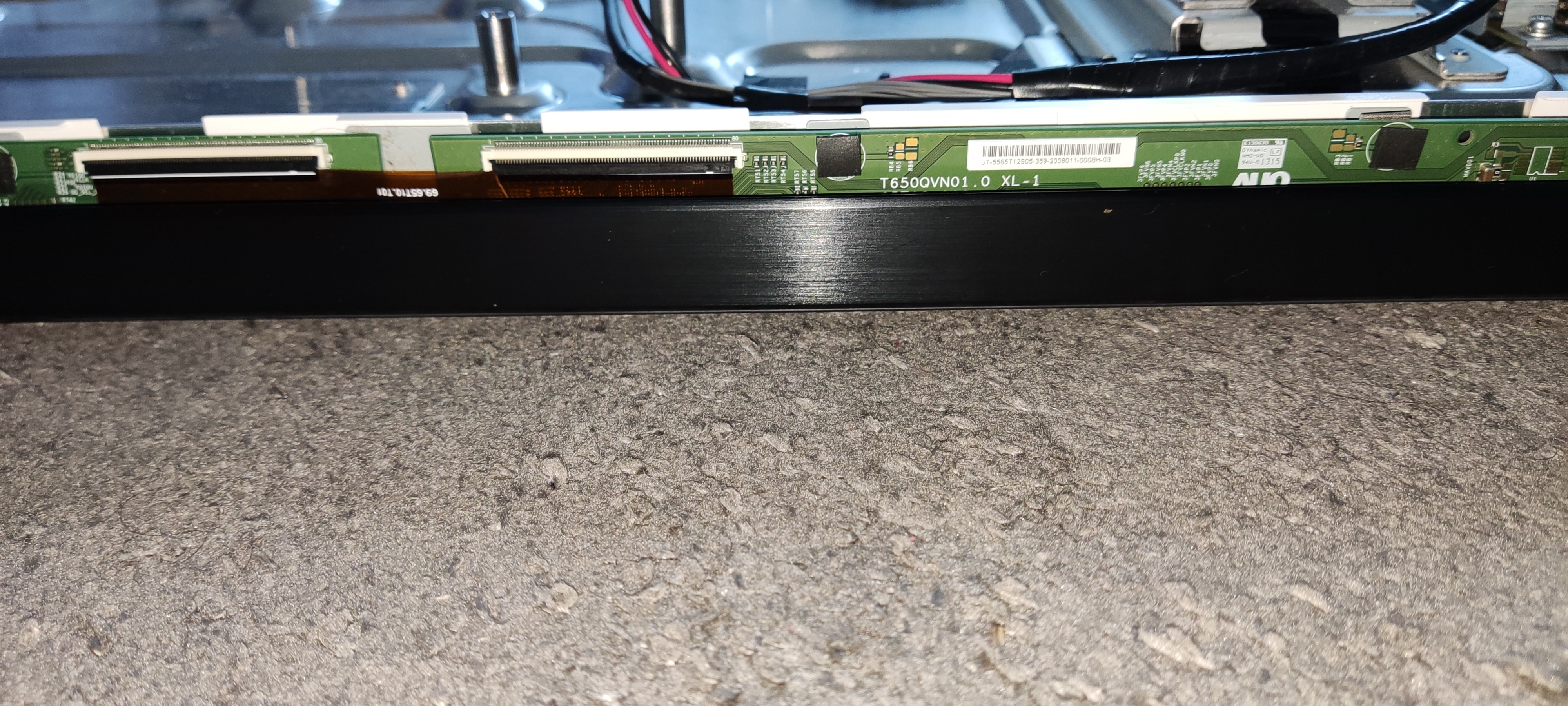

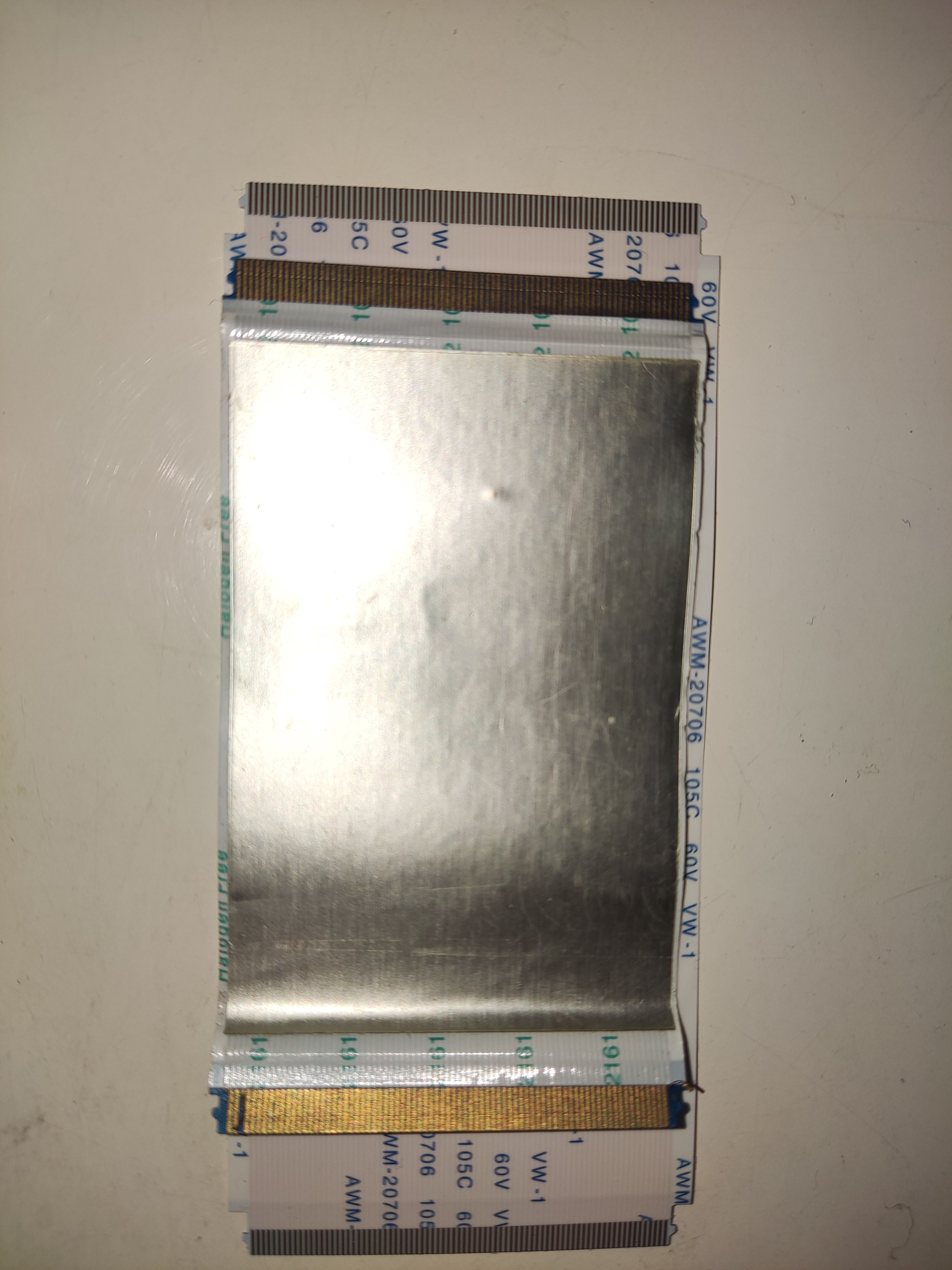

      So I got the cables and the t-con board from China. It came early. I was excited. But somehow nothing changed. What does that mean now?

        #203
        did you compare the pins amount of the new and old ribbon cable ??? and also the the zise of wide???
        if they are fit at that measurements .. try them first with yours original t-con

          #204

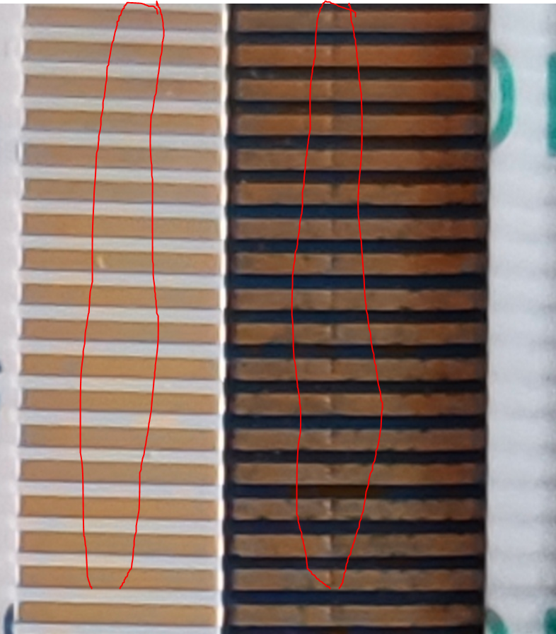

          Diah
          I tried the cables first on my t-con board. Same as with the one from China. BTW: I bought this t-con board: https://de.aliexpress.com/item/1005006203664939.html
          I didn't know but it doesn't look new to be honest...
          And the new cables are a bit wider but the pins are both 80 on each side. I took two pics. Can you have a look?

            #205
            compare them in way both contact pins facing each other..not as you did on the top.. . so we will know

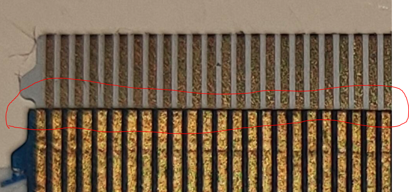

            • lotas
              • Jan 2016
              • 4761
              • Russia

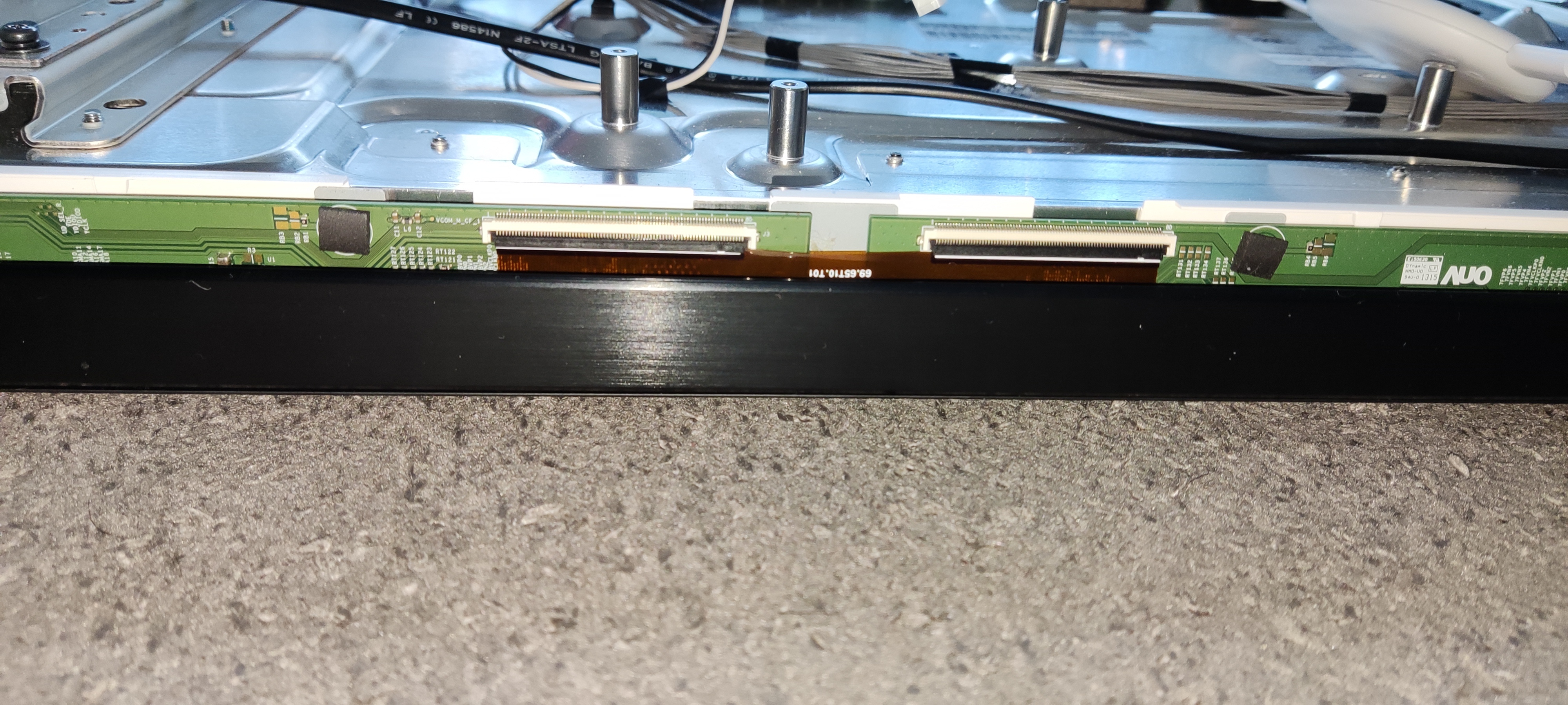

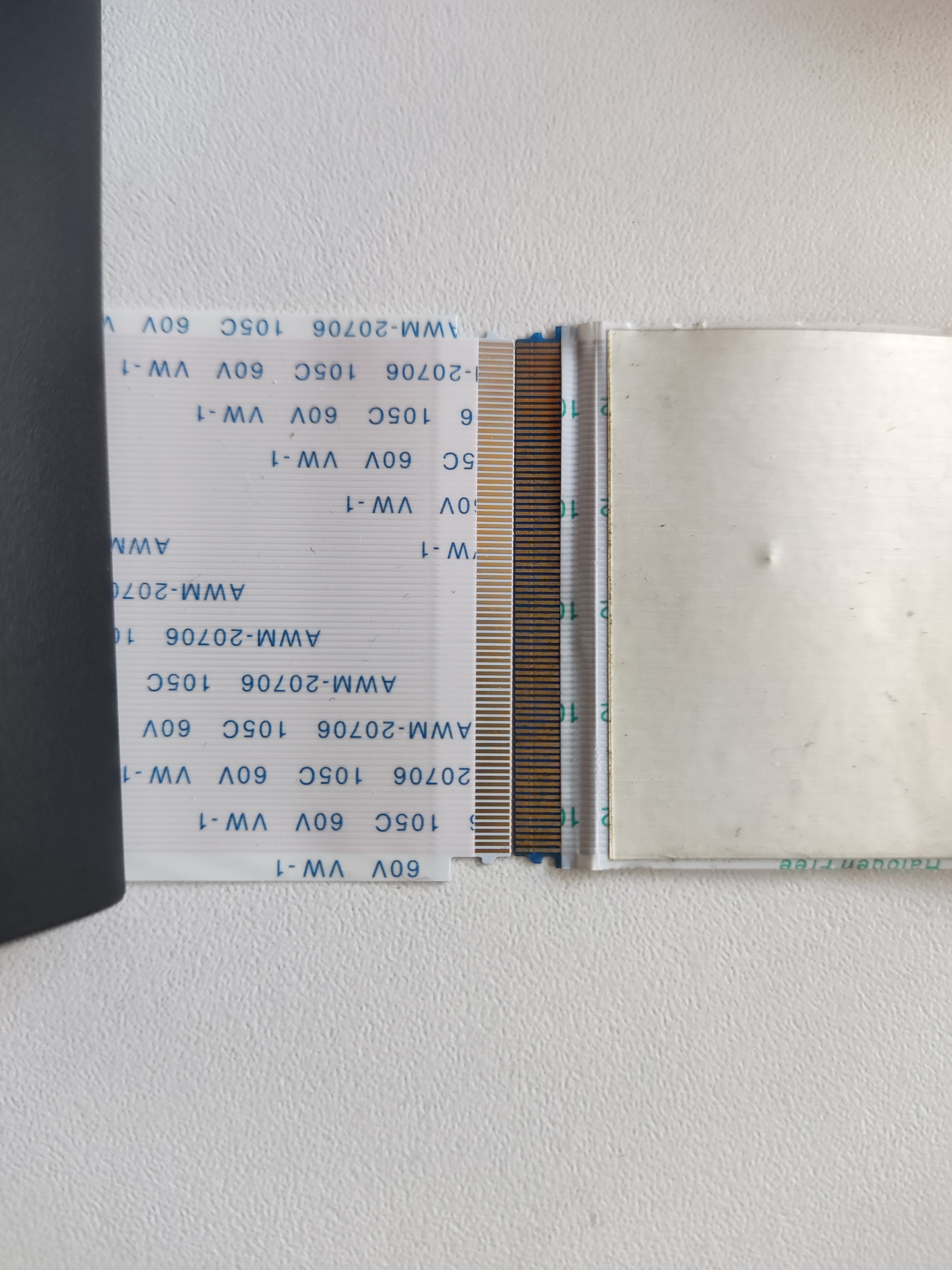

              #206
              Well, from the photo you can see that the step does not coincide with the original, there is a shift...

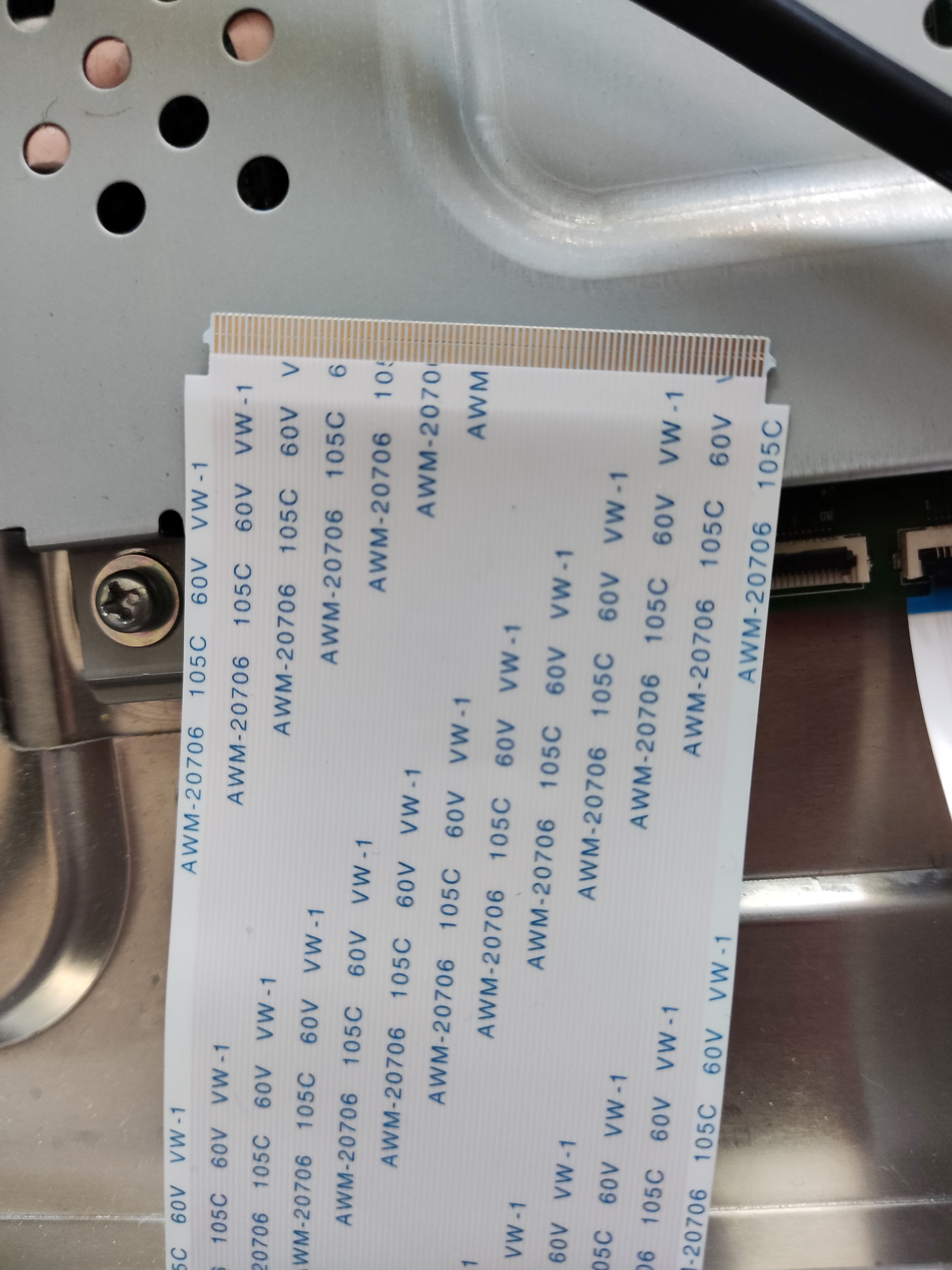

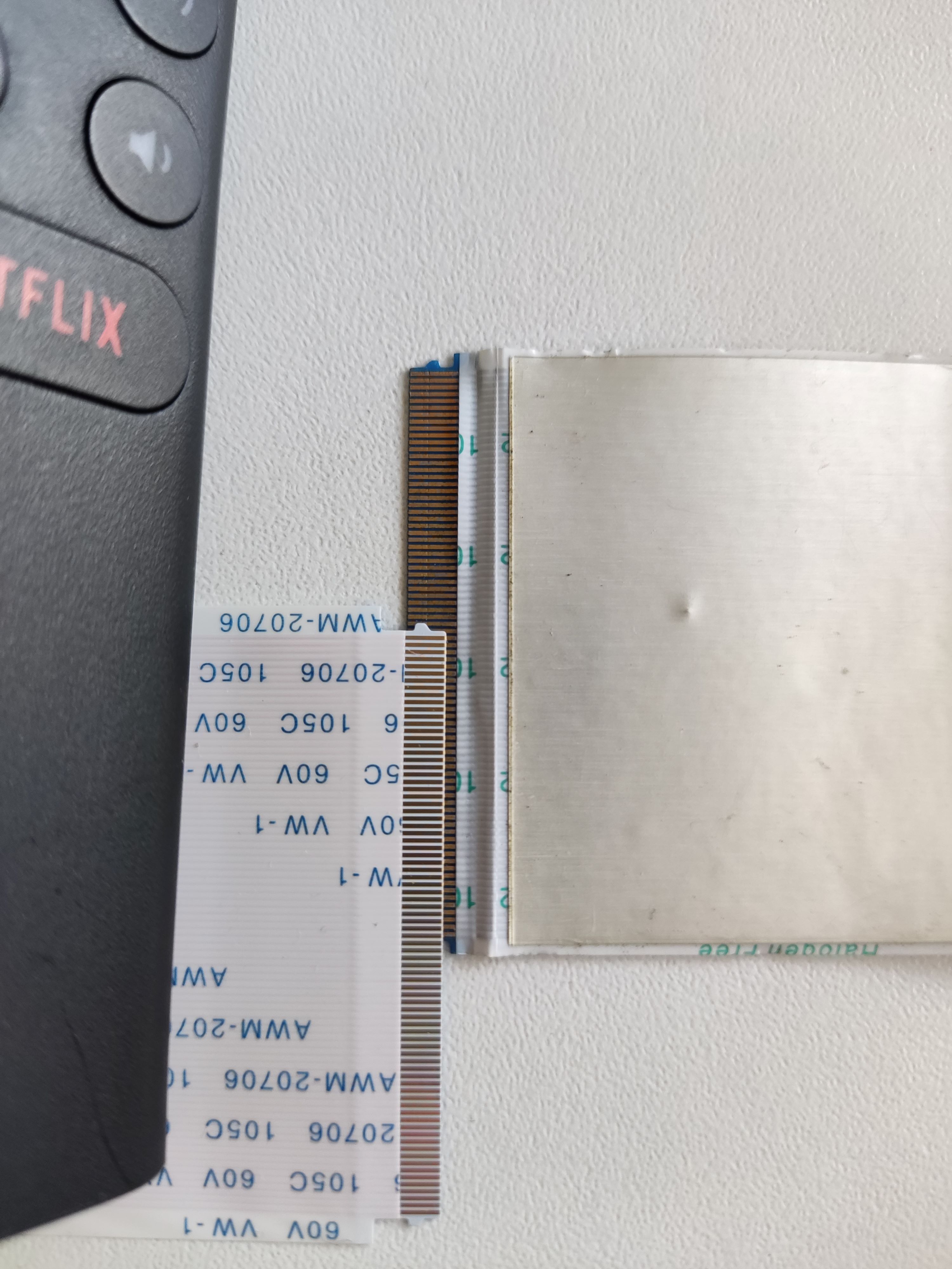

                #207
                Yes, that's what I thought. Then I aligned them as Diah said and it looks close. (Pic1)
                But the length of the pins is definitely different. The originals are longer. (Pic2) Is that a problem?

                  #208
                  The thickness of the contact pad corresponds to the original. There are no traces left from the clamping of the connector, as if there is no contact..

                    #209
                    ah, that's because it was an unused one. I got 10 instead of 4 from China! Here I just de-attached one of the new used one. There you see the marks:

                      #210
                      they pass..
                      hope you didn't remove or play with ribbon white the TV on..
                      let check from the bottom... show the panel puffer boards if there any sign of burn parts or trace

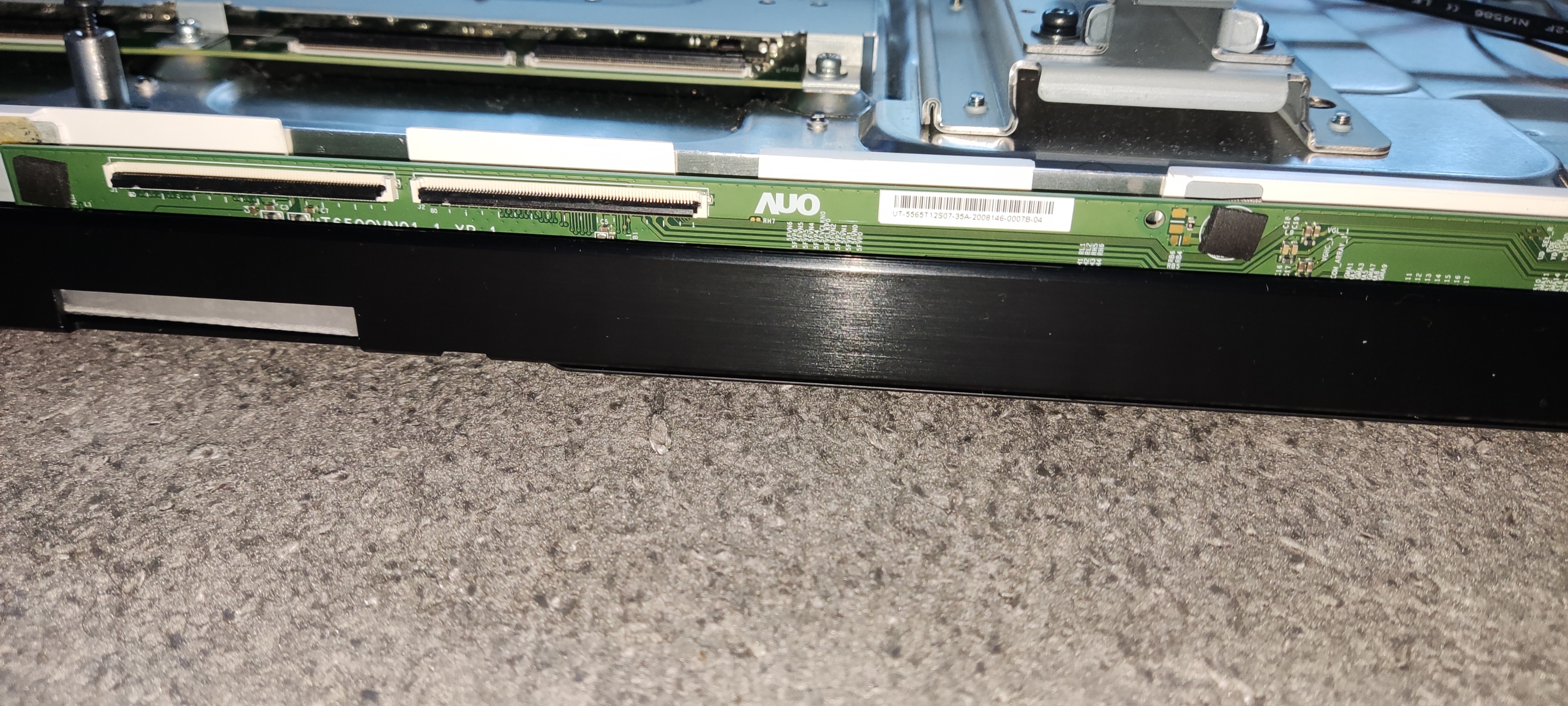

                      • tec3000
                        • Mar 2024
                        • 119

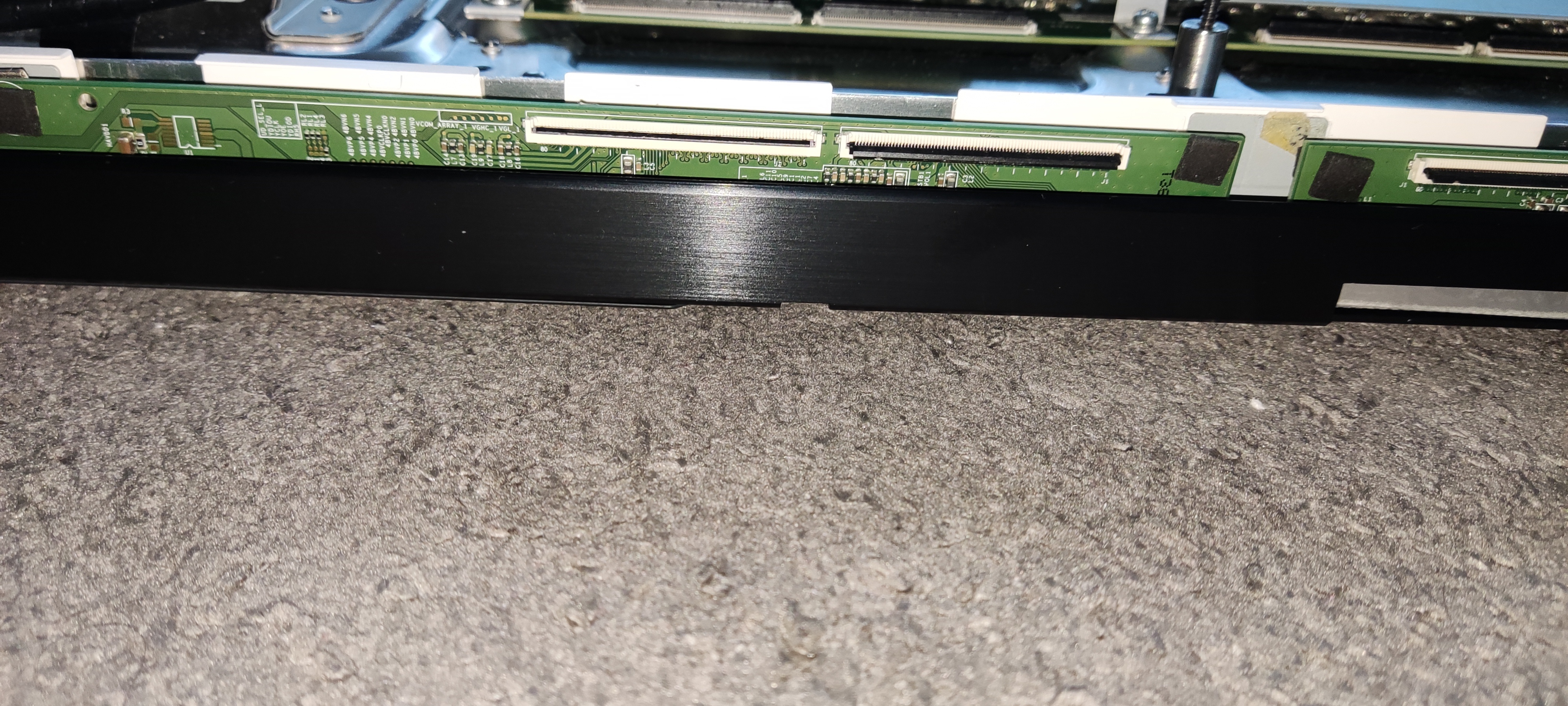

                        • tec3000
                          • Mar 2024
                          • 119

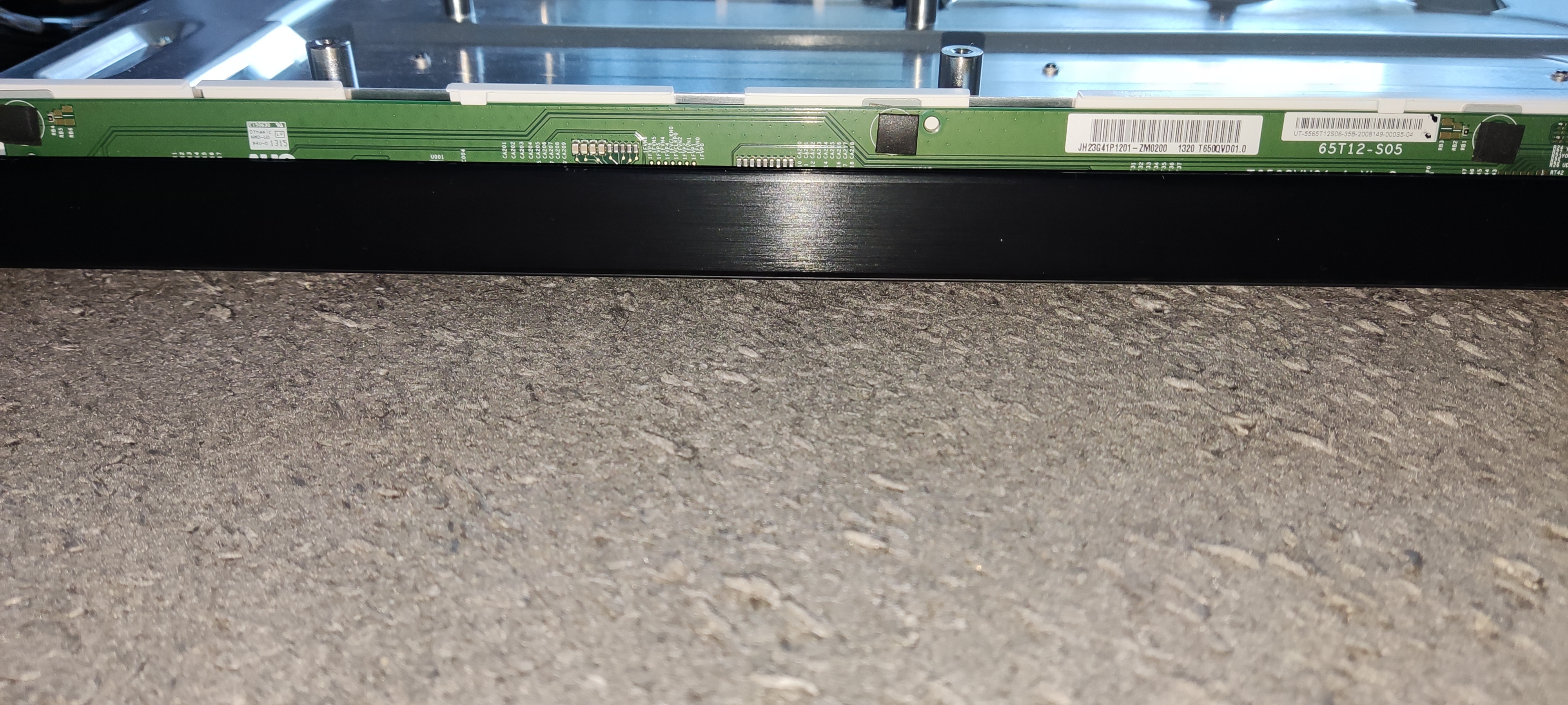

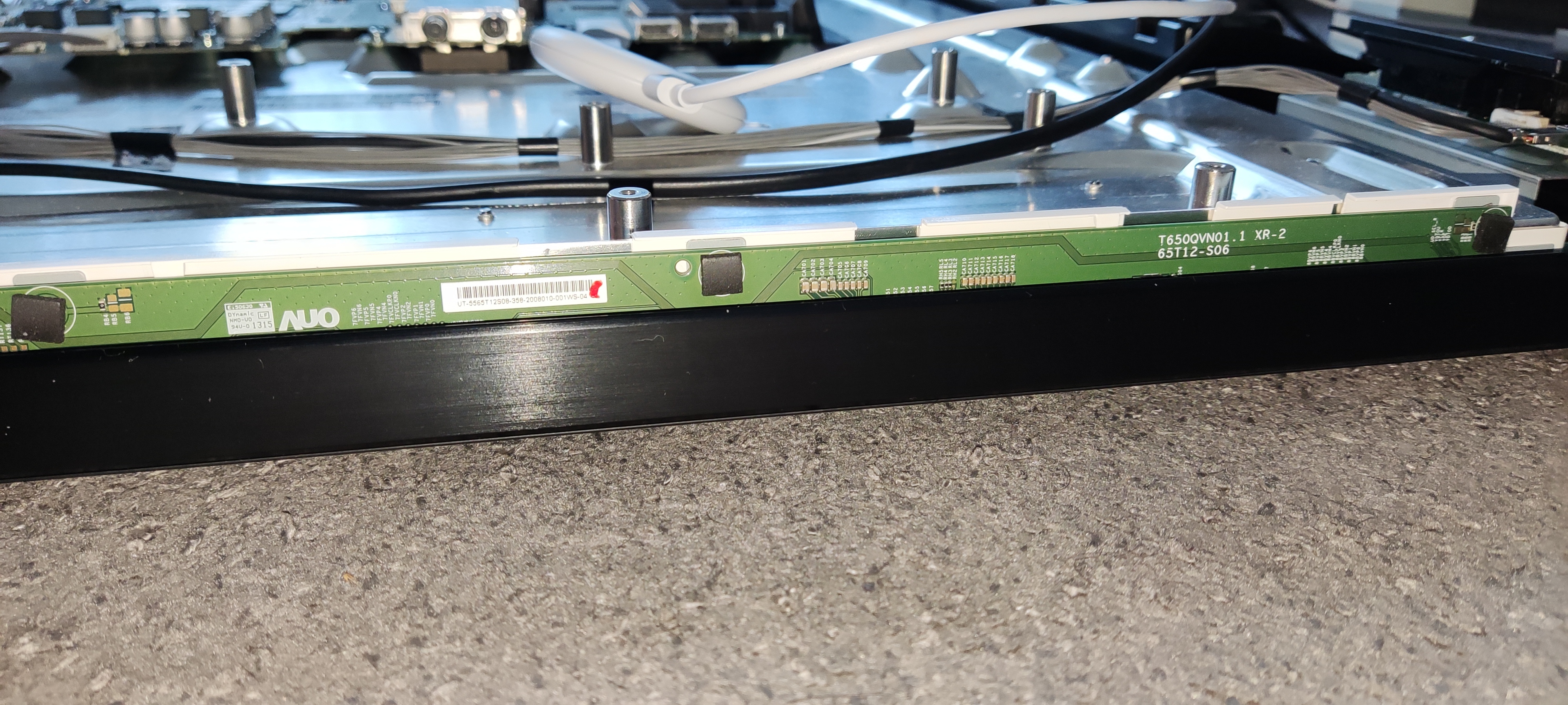

                          #212
                          Originally posted by Diah
                          they pass..
                          and here the pics:

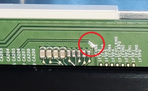

                            #213
                            photo No 2. there are unclear things to me... check them
                            and you have 2 U ribbon cable connect 2 half on one side together... carefully take them out and inspect them

                            • lotas
                              • Jan 2016
                              • 4761
                              • Russia
                              #214
                              This is more likely a reflection from the flash.

                                #215
                                if this the case then this line heated and lost the green color,, and maybe cut off ... i hope so

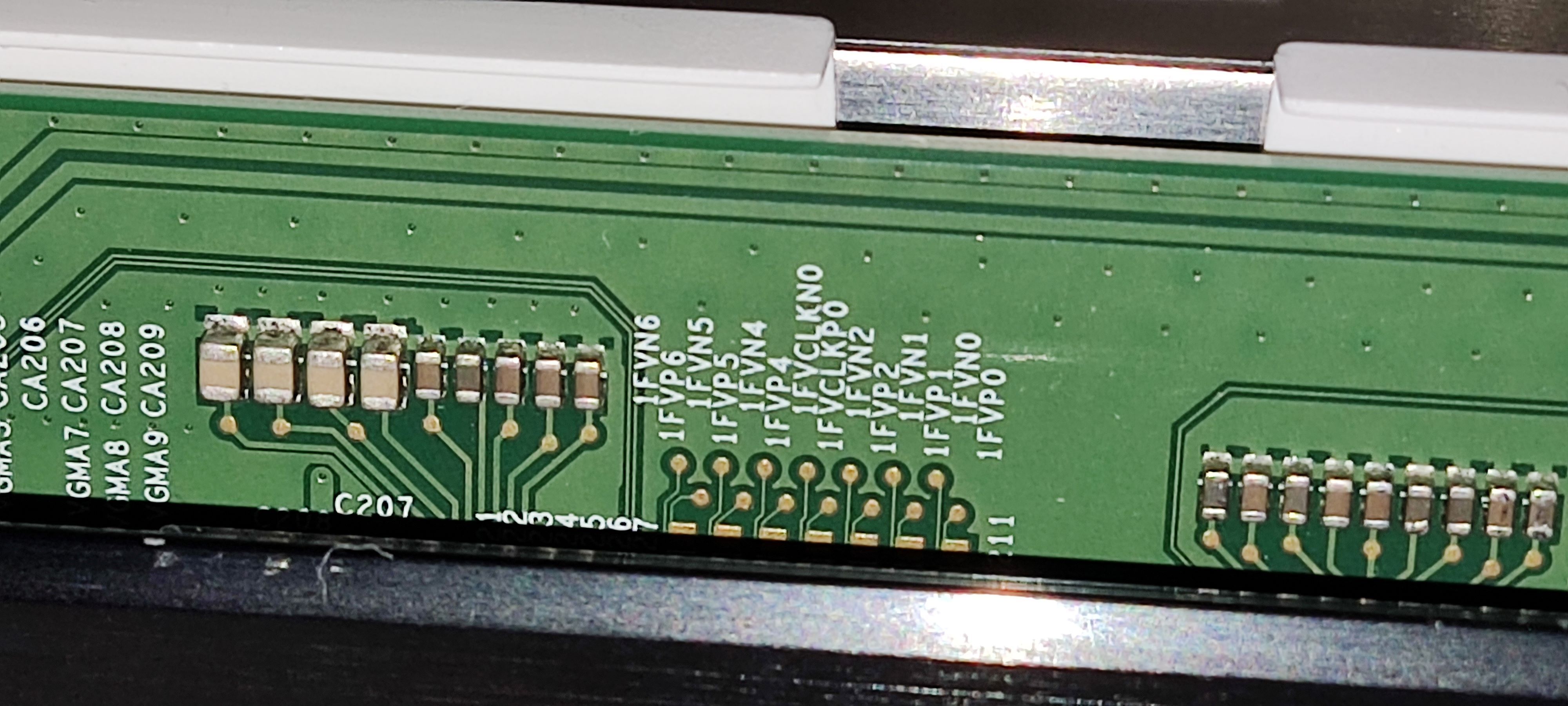

                                • Diah
                                  • Feb 2013
                                  • 6442
                                  #216
                                  there are another way to know why the gamma dead and where the issue.... using the original T-CON and the replacement one we need to do it in points turn on and check the screen
                                  A- with Original T-con in place all 4 ribbon cable connect to panel
                                  1- disconnect only left side U ribbon cable after test if no change put it back
                                  2- disconnect only right side U ribbon cable after test if no change put it back
                                  B. disconnect 2 ribbon from left side after test if no change put it back
                                  C- disconnect 2 ribbon from right side after test if no change put it back
                                  do all points again with replacement T-con

                                    #217
                                    Only 1/2 of the slats are visible here, half is hidden behind the body panel...

                                      #218

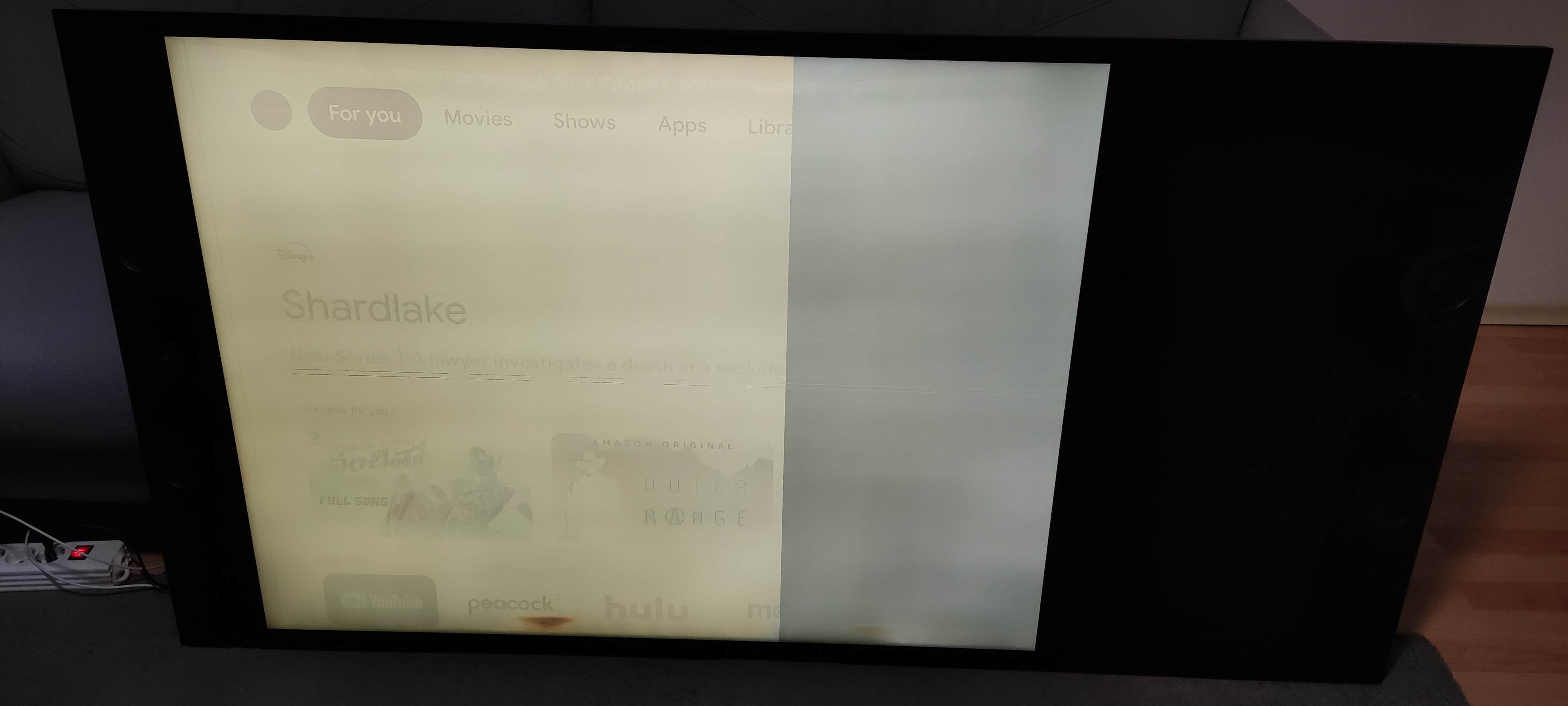

                                      yes indeed...not only this from his last photo it show part of screen are off... like U ribbon... but i think he know now after many fail how to access

                                      • tec3000
                                        • Mar 2024
                                        • 119
                                        #219
                                        Yes, luckily it's just a reflection! I took another pic.
