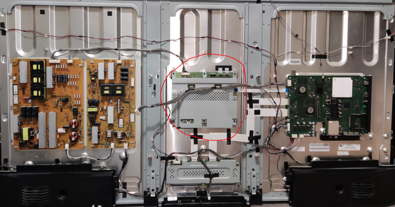

    Here some more pics. (I can upload more pictures if needed.)
    First a close-up of the powerboard:
    And here is the complete back of my tv:

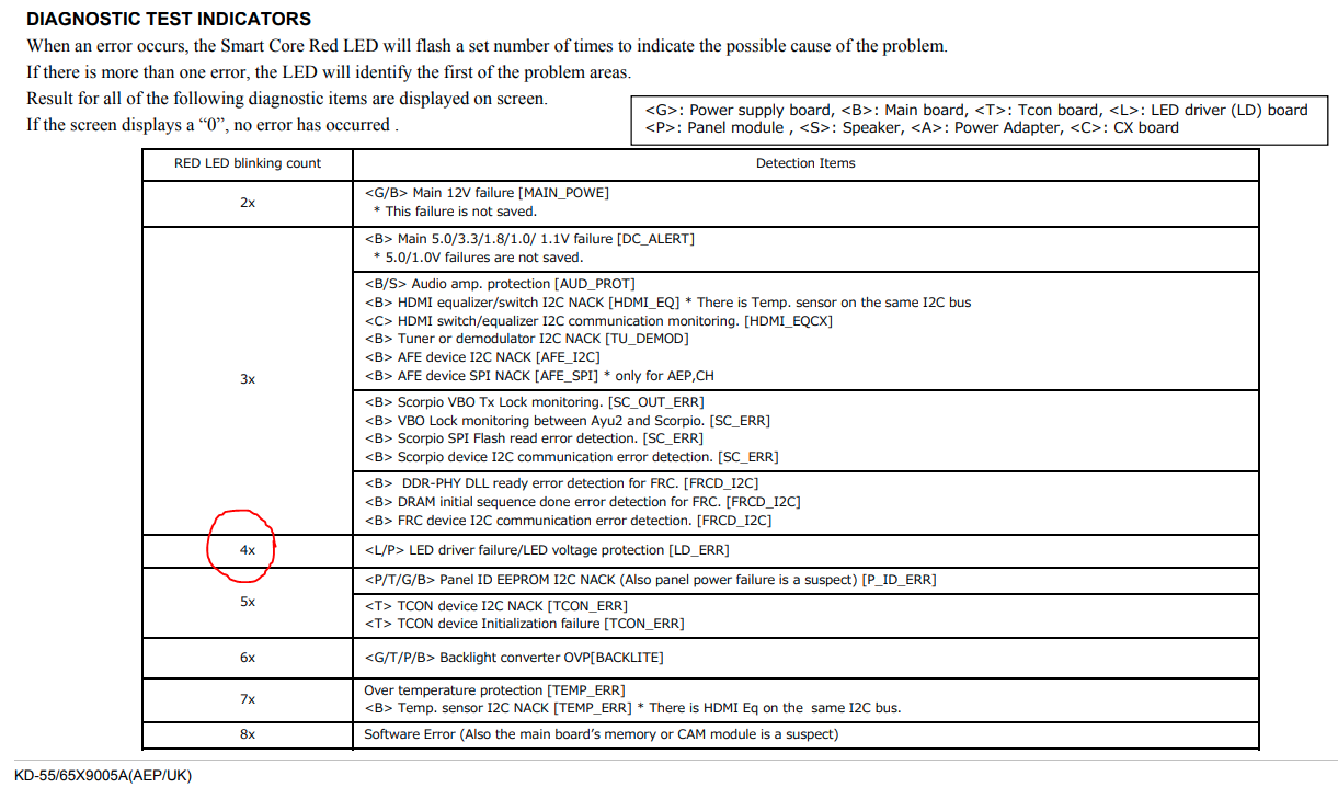

    Code error 4

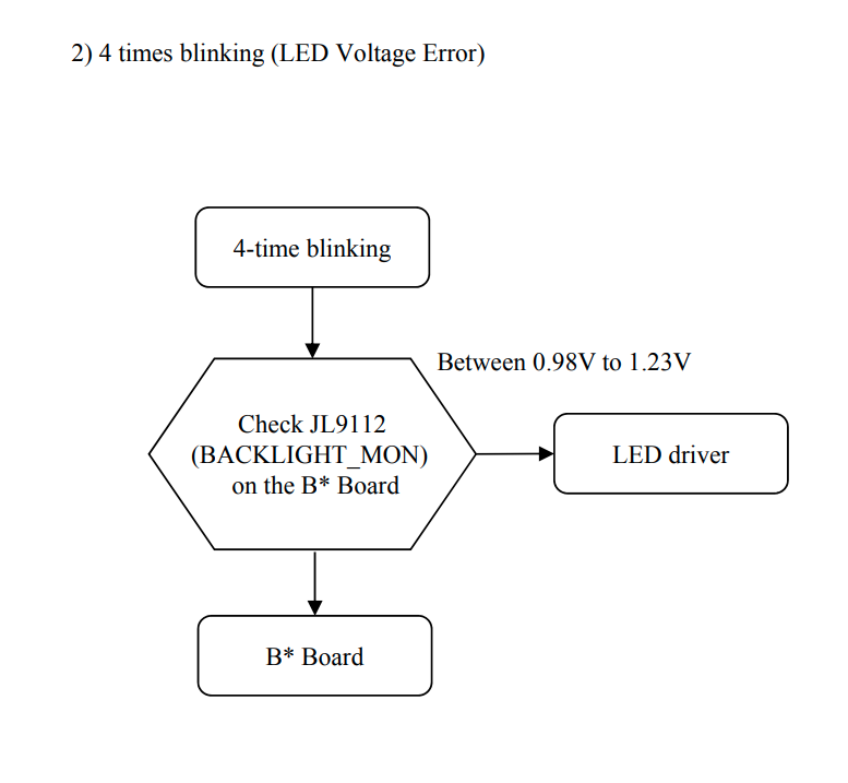

          So you have bad led driver board or panel. It says to check the voltage in the picture of that connection. According to the blink code anyway

                        If you read what he posted, I assume lotas posted the codes for your tv, error codes are different depending on the TV. So what he posted for 4 blinks is not the backlight. It's the led driver board. The code says to check the voltage on the pin indicated. That's your next step. The led driver board doesn't mean backlights are bad.
                        According to the first part of the code. It's your led driver, or your panel is bad.

                          you have clearly LED defect and can be noticed from first picture... all other parts on TV are fine... Sony will never admit or write at Service Manual any issue at LEDs... so the refer to the service manual are useless.
                          yours LED BL Edge one... by pass BL_error.will not work when you have shorted one or more LED ( see the black shadow at the first Picture )
                          if yours plan to use the TV with out replacing LED BL. then at least you need to have access to LED BL edge boards and from there remove the shorted one.or replace one or more.
                          if you want to by pass then the work should be on the LED driver boards... nark first the line which had shorted ( high currents ) pill line.. cut it and add external load ( such Filament Lamp ) to suck all the extra currents which produced because of the shorted LED ). the LED driver boards will no more generated BL_error signal to MB.

                            Ok, I have to ask. I have my meter here. But can't find the board in question. Where is the B board? I couldn't locate JL9112 anywhere.

                                  Man, from yours first photo ( E. Manual ) the screen had black spot shadow on the top... this is remark. one or more LED Units are off.... new driver boards will not help even if you change all boards..
                                  e.manual section at Sony displaying and TV remain ON... just because the SOS ( BL_ERR ) will be ignored from main boards... its same when you call diagnostic service menu.... this facts make you and other thinking LED are fine.. but they are not..
                                  you have 2 flat ribbon cable going under the screen from LED driver boards.... remove the heat sink and post clear photo of it... also try remove one ribbon cable at once and turn on... see if the set remain on... or it will give error immediately.

                                      here the pic. Is that the correct board?

                                        This is T-CON, L.Dr. board. is located here.
