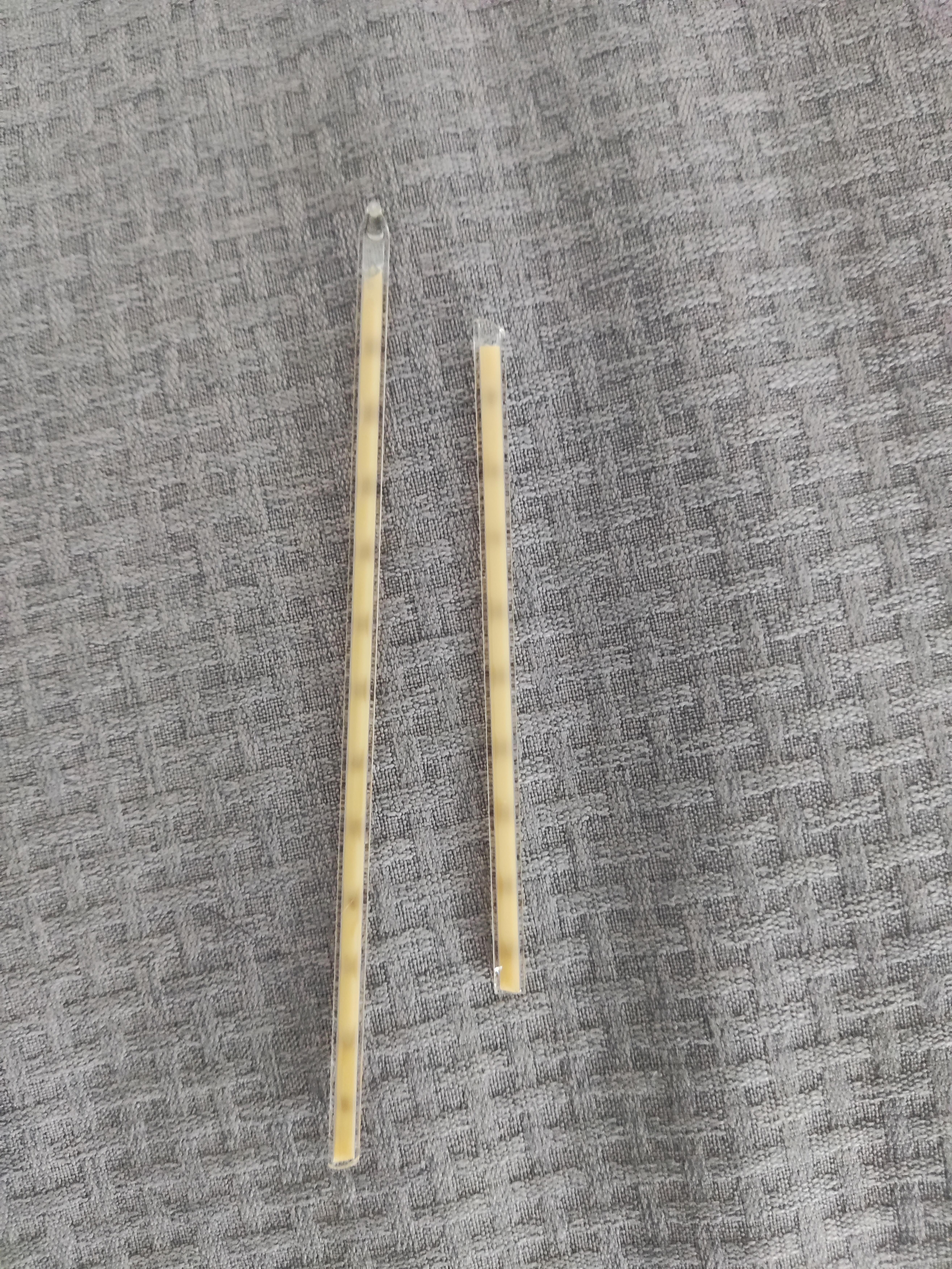

      About the diffuser. Is that the part that broke? I took some pics of it.
      Do you want me to unscrew the bigger plate on the other side?? Maybe you could you mark the area I should photograph?

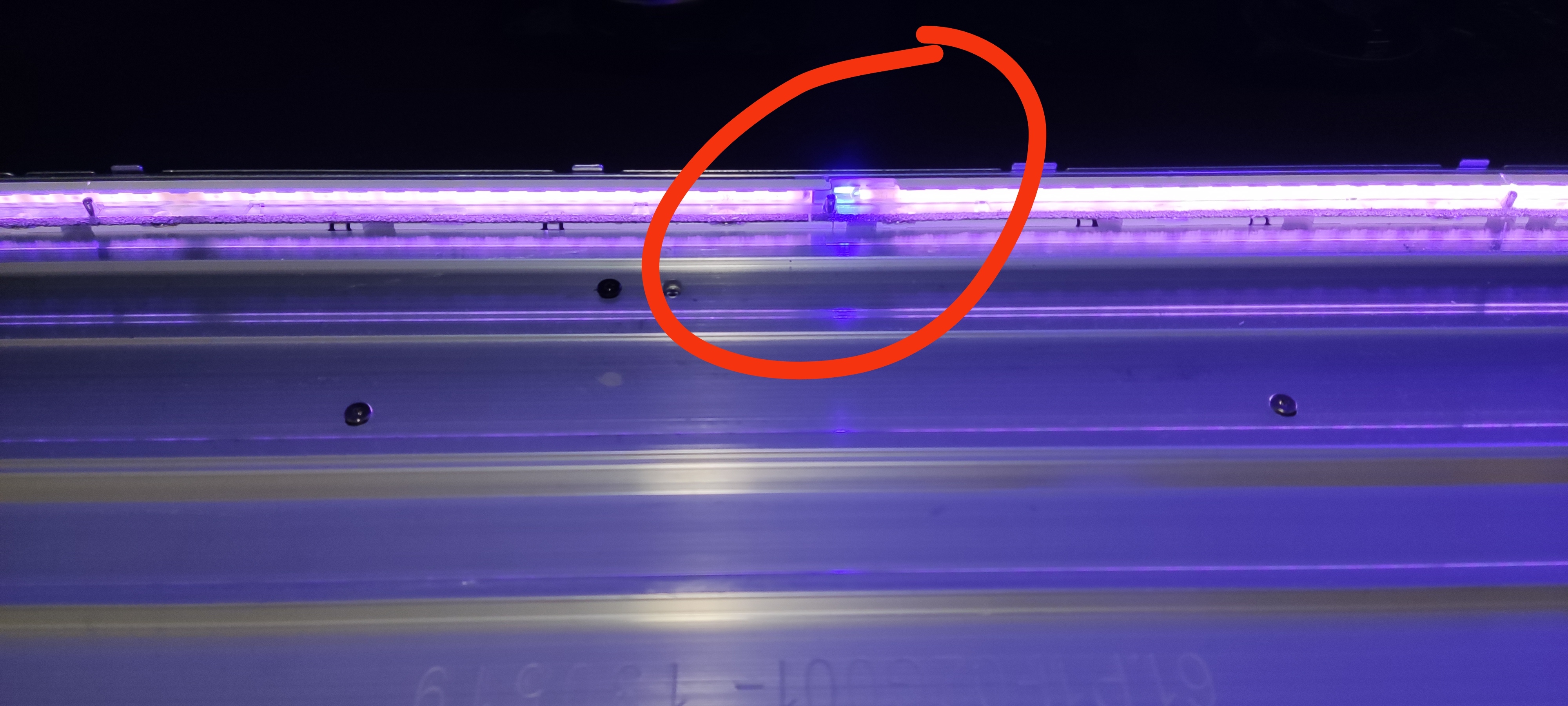

        The broken part is the led strips

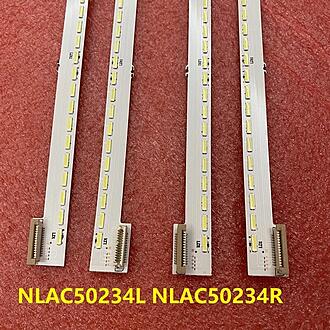

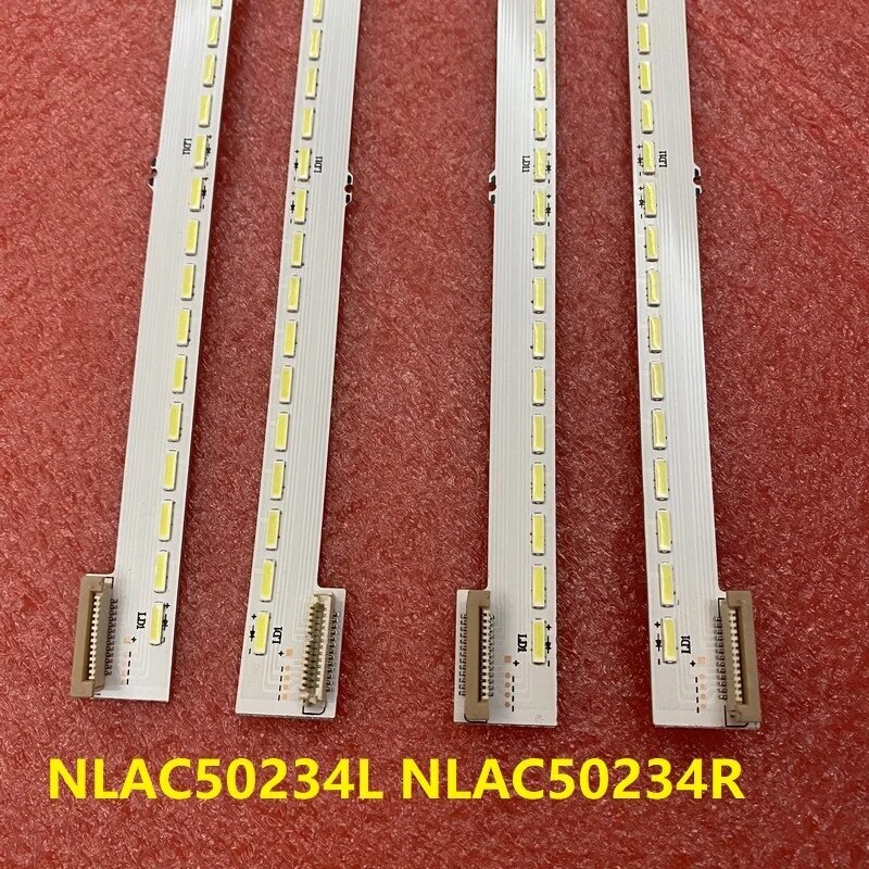

          hi vinceroger69 thank you. What did I order then if that's the strip? https://aliexpress.com/item/1005002859411201.html Click image for larger version
Name:	4pcs-set-LED-Strip-For-TV-XBR-65X900A-XBR-65X850A-KD-65X9005A-KD-65X9000A-KD-65X9000B.jpg_.jpg

            the broken piece are just filter mounted over the strips.... stop doing any things till yours strip arrived

                  I can't. The filter is in the way. I tried to carefully remove it. Result is above. It breaks very easily.

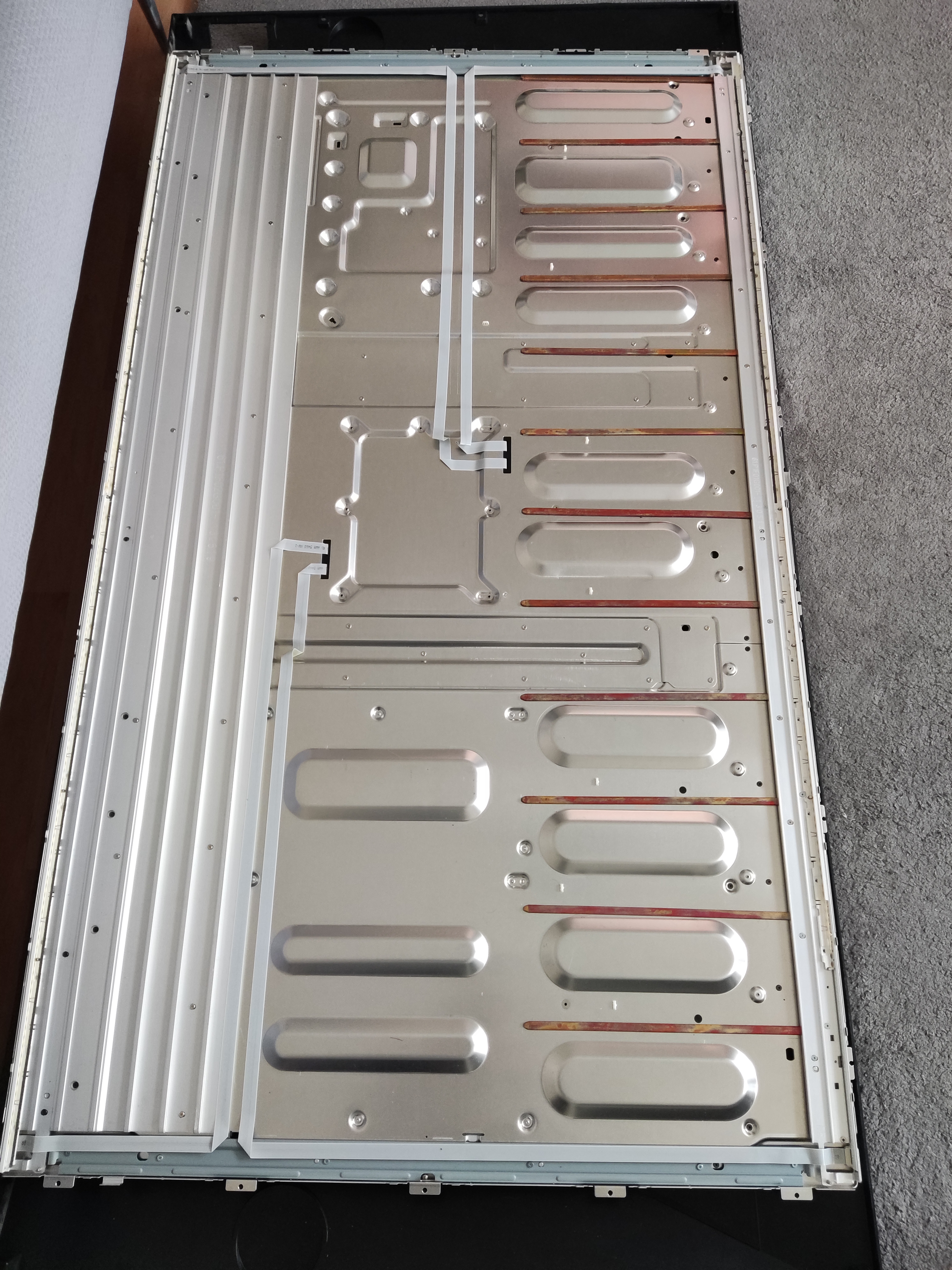

                          1- to remove the strips you need to push the strips at socket forward so the clips which hold it will be in the wide area so you can pull them.... install should be opposite things see the photo
                          2. to avoid the other side filter from any damage.. because it may burned and stitched to LEDs surface... spray the whole with alcohol over night so it will move easy.... the one which break... try start to clean it how much you can

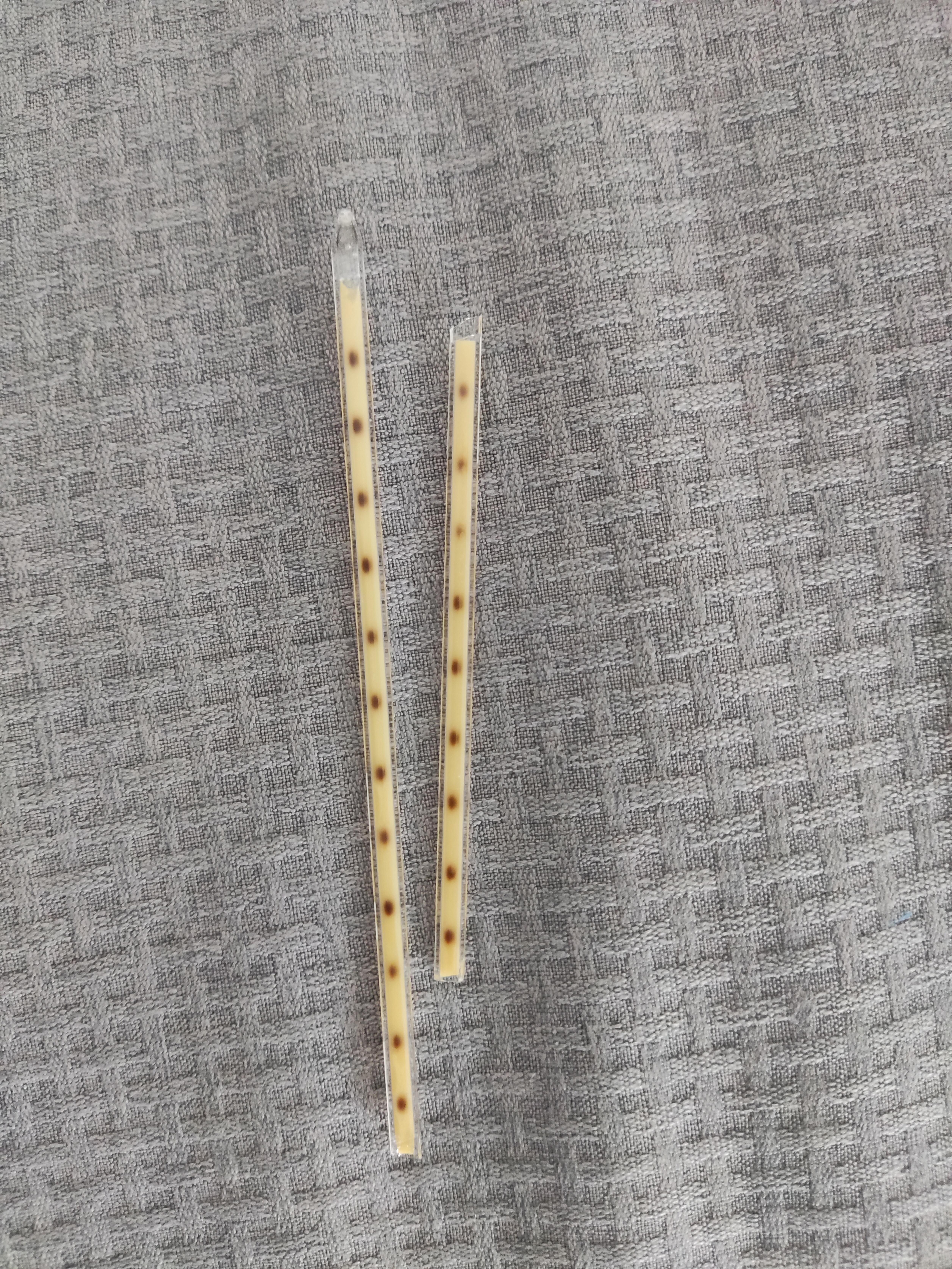

                            about the broken one... you can put them together with ( Sekund Kleber ) or ( UV Kleber )
                            i will recommend UV one as its 100% transparent and you can do it first in room then take it out under sunshine... just be sure it remain straight.

                              Thank you for the detailed description! I have now sprayed some alcohol. Tomorrow I will try to remove the strips.
                              I was also able to remove the other filters now without any problem! Nothing else broke. I was worried about the broken parts, but I will buy a UV-Kleber and put them together.
                              So if I understand you correctly it doesn't need to be 100%. Just have the filters at place. Right?

                                NO. we need to do our best when you bring the broken one together at or nearly to 100% to avoid any light reflection or shadow,, because its located at he light source,
                                so to avoid the filters which mounted over ( under the LCD ) in crease any issue at light reflection.

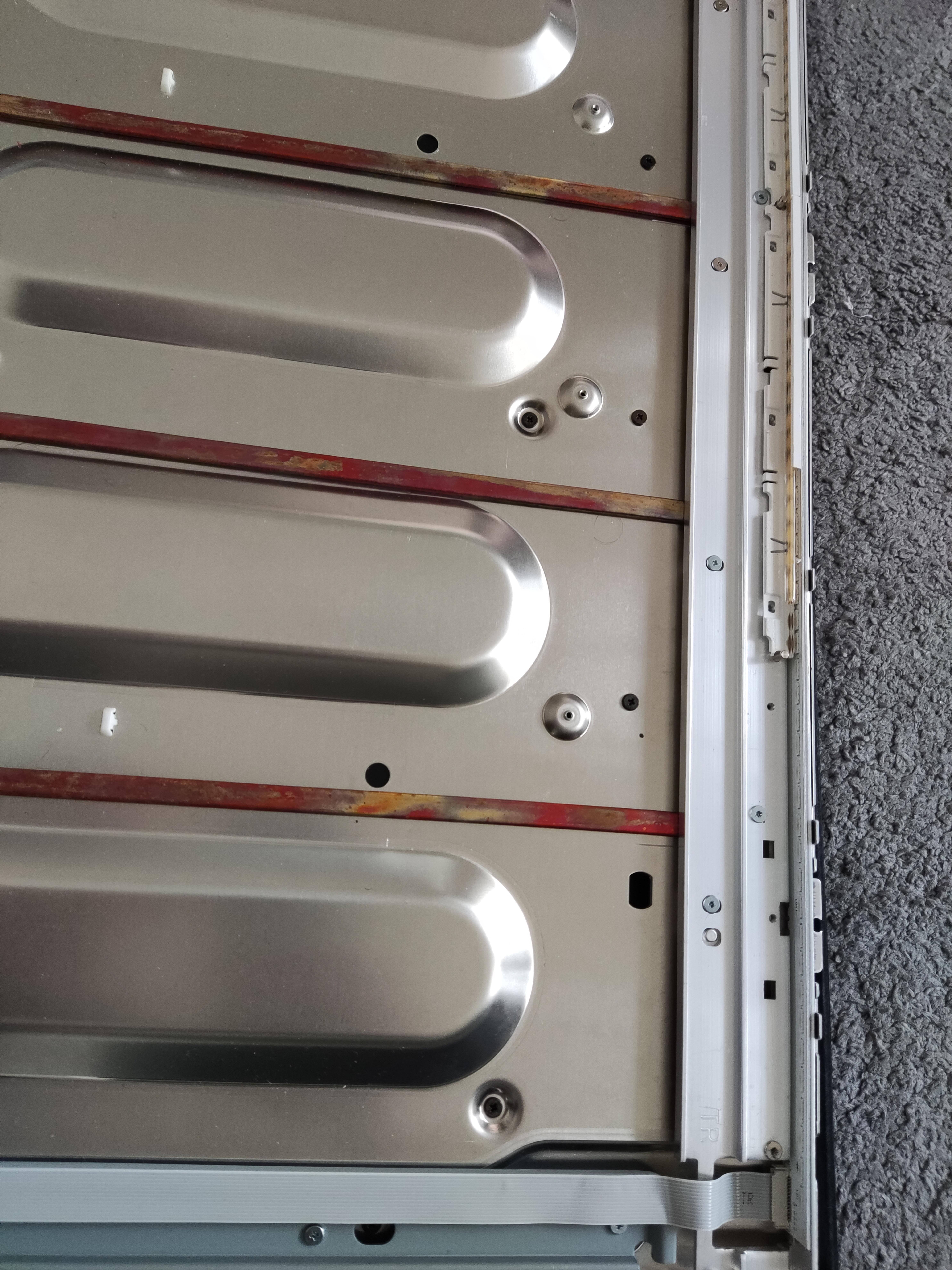

                                  Can you have a look at the pic I uploaded? This is from the other side. I haven't touched that side yet. As you can see there is a gap where the two filters meet and blue light shines though. It was already like that. Is that going to be a problem? It's exactly in the middle of the top of the TV
                                  • Diah
                                    • Feb 2013
                                    • 6460
                                    #157
                                    right now what we did saw..and know ,,
                                    1- the strips LEDs unit went blue color cause of burned the surface of them..( we don't need to explain the chemistry of LED )
                                    2- the first filter also effected with some burn from the LEDs surface. ( this need to try clean them how much u can with out damage the coating )
                                    3- from the photo you upload for LED driver boards there are much brown area happened via heat ( over load ),, until now we cant say this boards got issue or not.... as the reason was the strips
                                    also you are now removing the reason with new strips then you can go back to others points if there are an issue.
                                    so step by step repair called

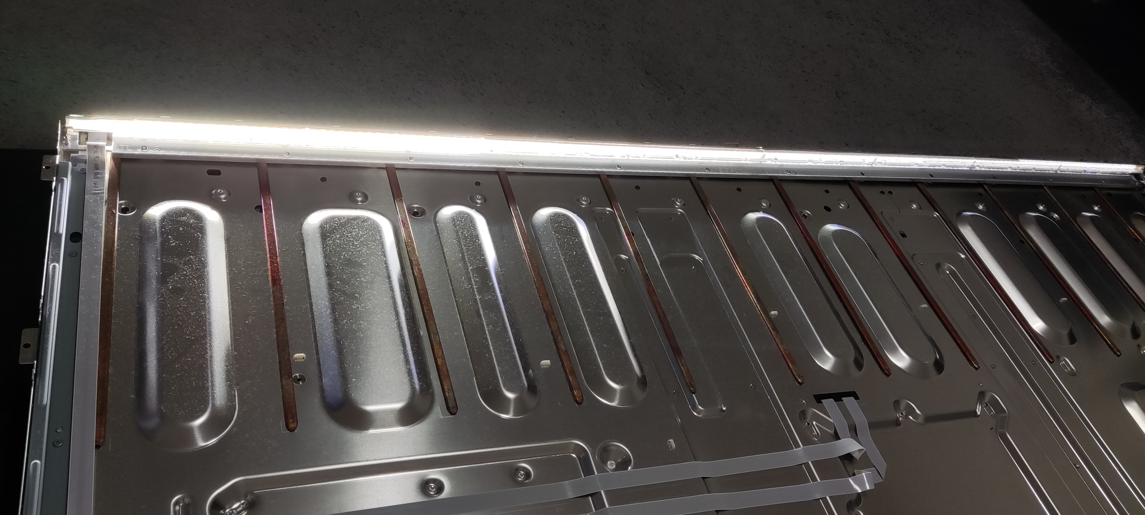

                                        Hi, I finally got the LEDs. I attached them. So far the TV doesn't turn off! (I tested for 15 minutes. Never lasted this long with the old ones)
                                        So far so good BUT:
                                        Please take a look at the new pic. One strip has far more light output than the other 3 strips as you can see from the attached picture. Any ideas why? I wanted to do the reassembly now but not sure....
                                        edit: It's actually not the entire strip. Only the outer half. Towards the edge.
                                        Click image for larger version  Name:	1713775724688.jpg Views:	0 Size:	2.00 MB ID:	3257457
                                        Last edited by tec3000; 04-22-2024, 03:48 AM. Reason: edit: It's actually not the entire strip. Only the outer half. Towards the edge.

                                          dont bother of more light or less... you don't have the screen in place and no signal the dimming process will be different.., put every things bask as it should.
