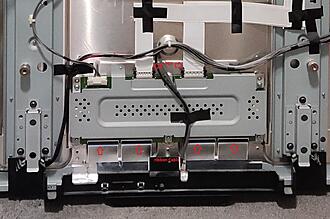

                  Click image for larger version  Name:	1708473458948.jpg Views:	44 Size:	632.3 KB ID:	3241473
                  • Diah
                    • Feb 2013
                    • 6355
                    #69
                    LVDS need to clean them from the main boards side.

                      #70
                      Diah
                      alright, thank you for marking the CORRECT cables. [Super, ich hab also die ganze Zeit die falschen Kabel rausgezogen. Ich nehm's mit Humor....]
                      About the ribbon cables. Just to be 100% sure: You want me to take the ribbon cables carefully out one-by-one and turn on the TV and look if it stays on or not, correct?
                      • Diah
                        • Feb 2013
                        • 6355
                        #71
                        LVDS clean them from MB side to get rids out the disruption in picture you have right now.
                        remove all 4 ribbon together to check the LED BL turn on and remain on so when you attempt to repair LED, at time the screen out from set..let you always can check and see that all yours LED BL lit on with out screen,i
                        who knows could be the turn off issue fixed too by cleaning the LVDS

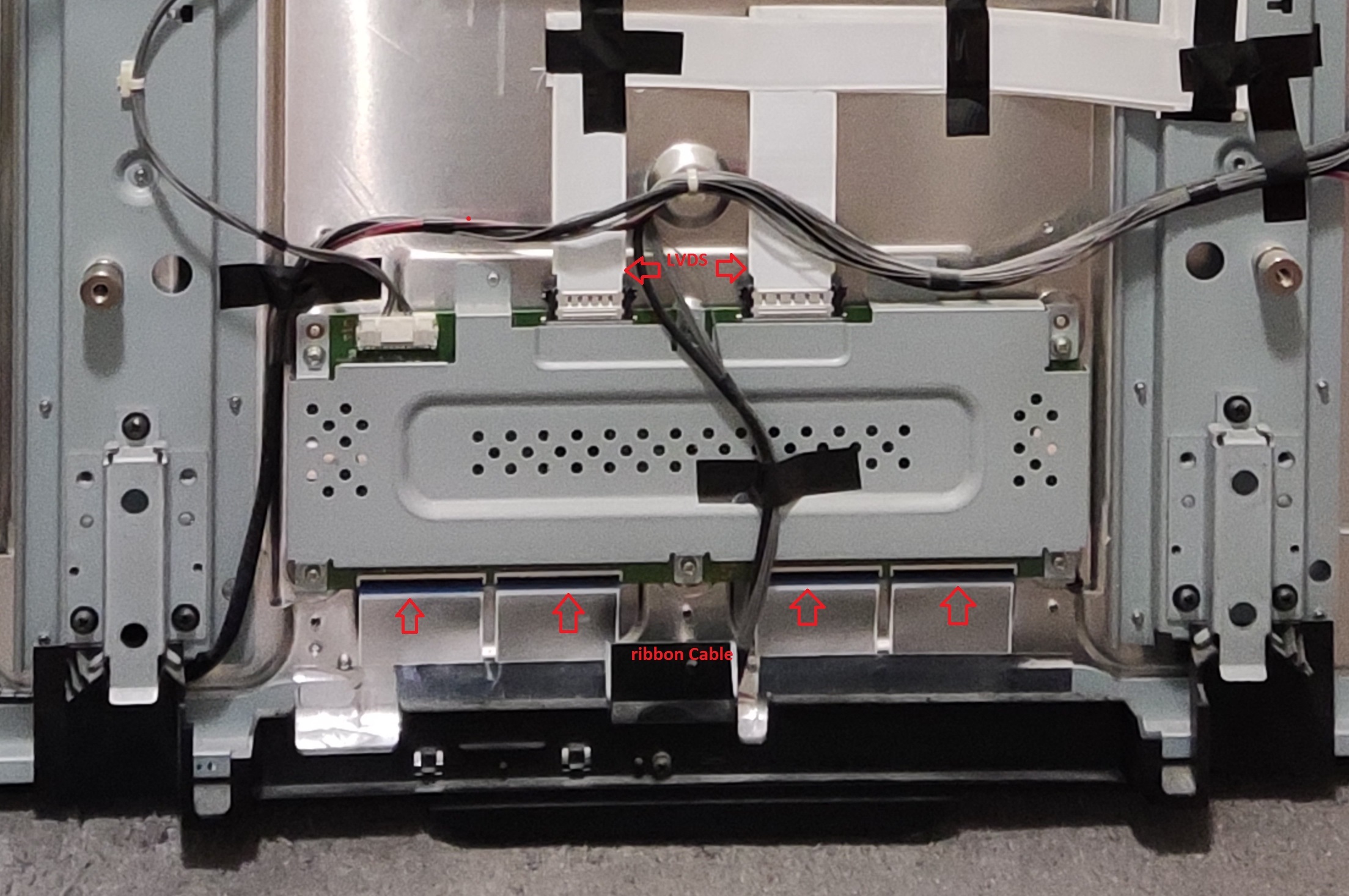

                            #73
                            so I took out one of the LVDS on the mainboard end, had a look and just plugged it back in and first pic happened. Then I played with the cable and plugged it back in and i-Manual is almost as good as it has ever been. (pic 2) BUT Diah can you take a look at pic 3 and 4 and tell me how I should clean it?
                            And in pic 5 you see the ribbon cables. Any hint how to carefully disconnect those cables? I should first peel off the tinfoil right? I really don't wanna mess this up....
                            • Diah
                              • Feb 2013
                              • 6355
                              #74
                              stop to do any more on cables as you have now very clear screen., except the LED defect shadow ... i think now its enough reason to give you encourage to repair LED BL and have full function TV.... good luck.

                                  #76
                                  Thank you, It's been a rollercoaster journey so far, but I'm highly motivated again.
                                  I'll watch some YouTube videos and then get to work. So if I understand you guys correctly I can only order the backlights once I have removed the screen. So right now I can order a couple suction cups.
                                  That's it, right? Or is there anything else?
