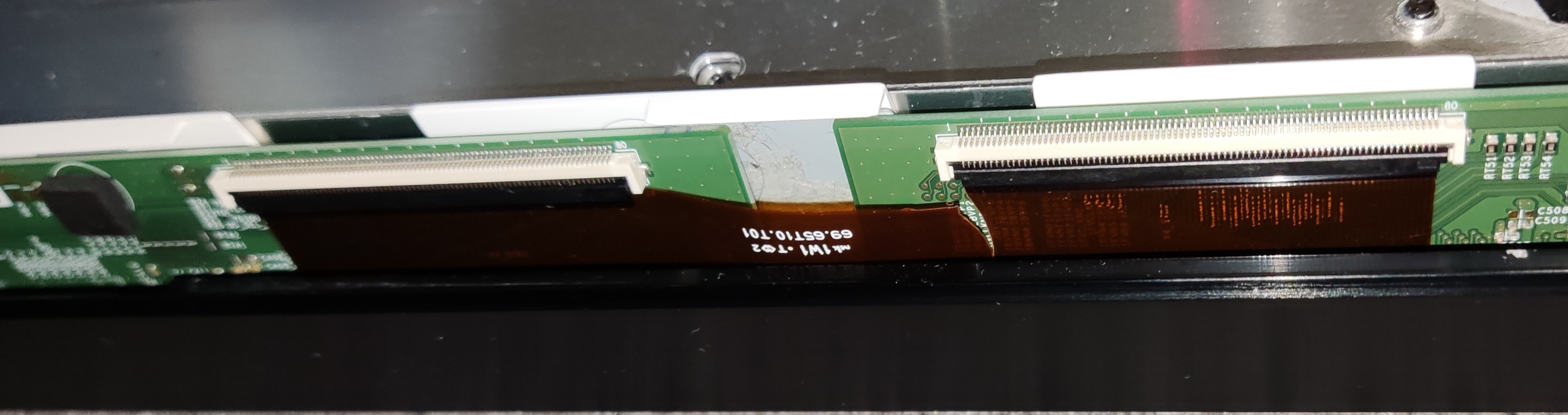

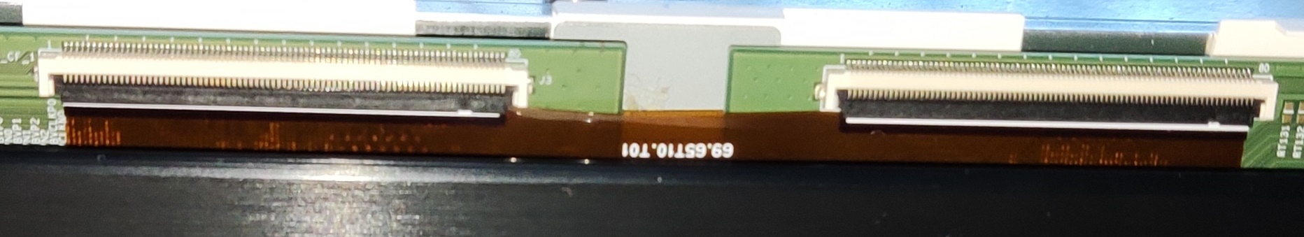

      I was hoping you'd say that! Because I have just discovered something! One of the U ribbon cables is ripped. That's good news right? Likely the cause for my issue??

        #223
        yes it is.... but still could be there another issue,, caused by smell and smoke lol
        • tec3000
          • Mar 2024
          • 119
          #224
          Should I order the U ribbon cable right away or should I go ahead with the testing you described earlier?

              first inspect as mentioned bu lotas.. then need the u ribbon

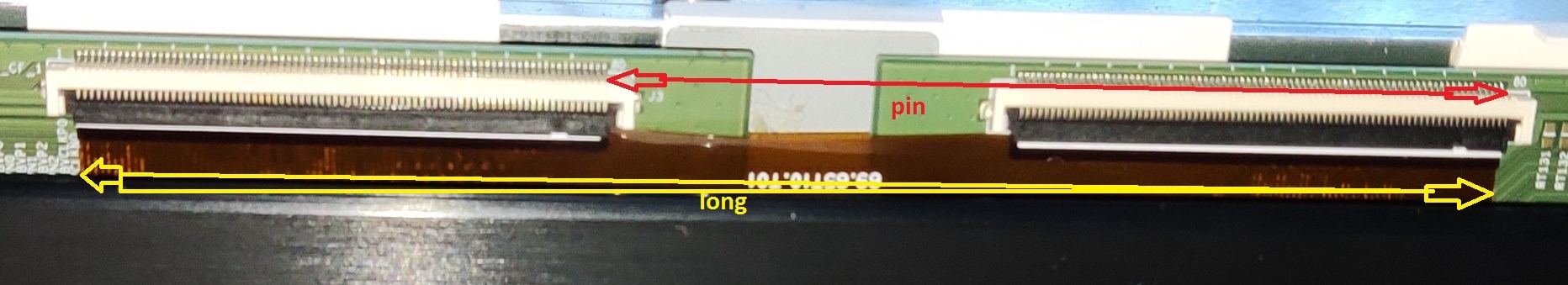

                U ribbon cable should with long and pins amount calculated

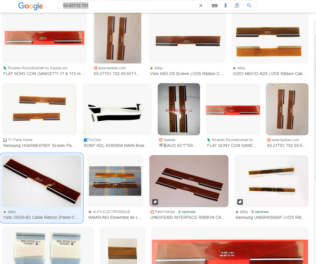

                • lotas
                  • Jan 2016
                  • 4555
                  • Russia
                  #228
                  Why such complexity, we just type the number 69.65T10.T01 into a search engine and see a bunch of offers.
                  • Diah
                    • Feb 2013
                    • 6357
                    #229
                    remove this defect U ribbon.. and put yours original t_CON and the new 4 ribbon in place.... you should have 3/4 screen display clear image

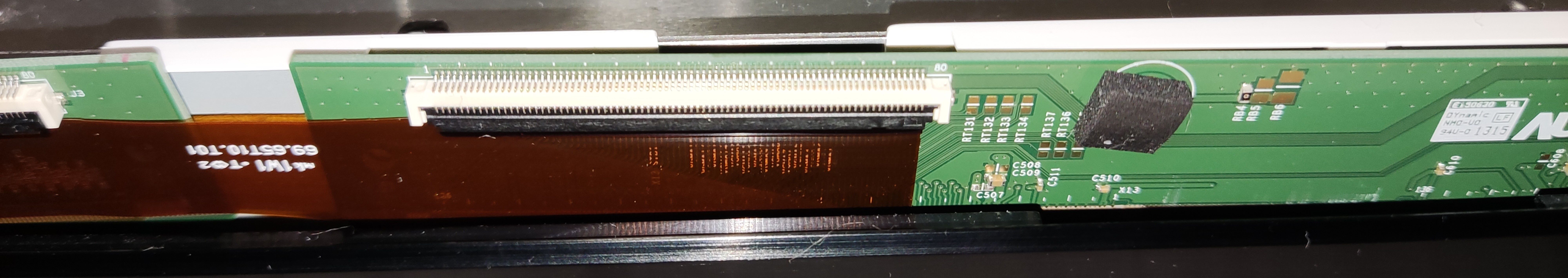

                      #230

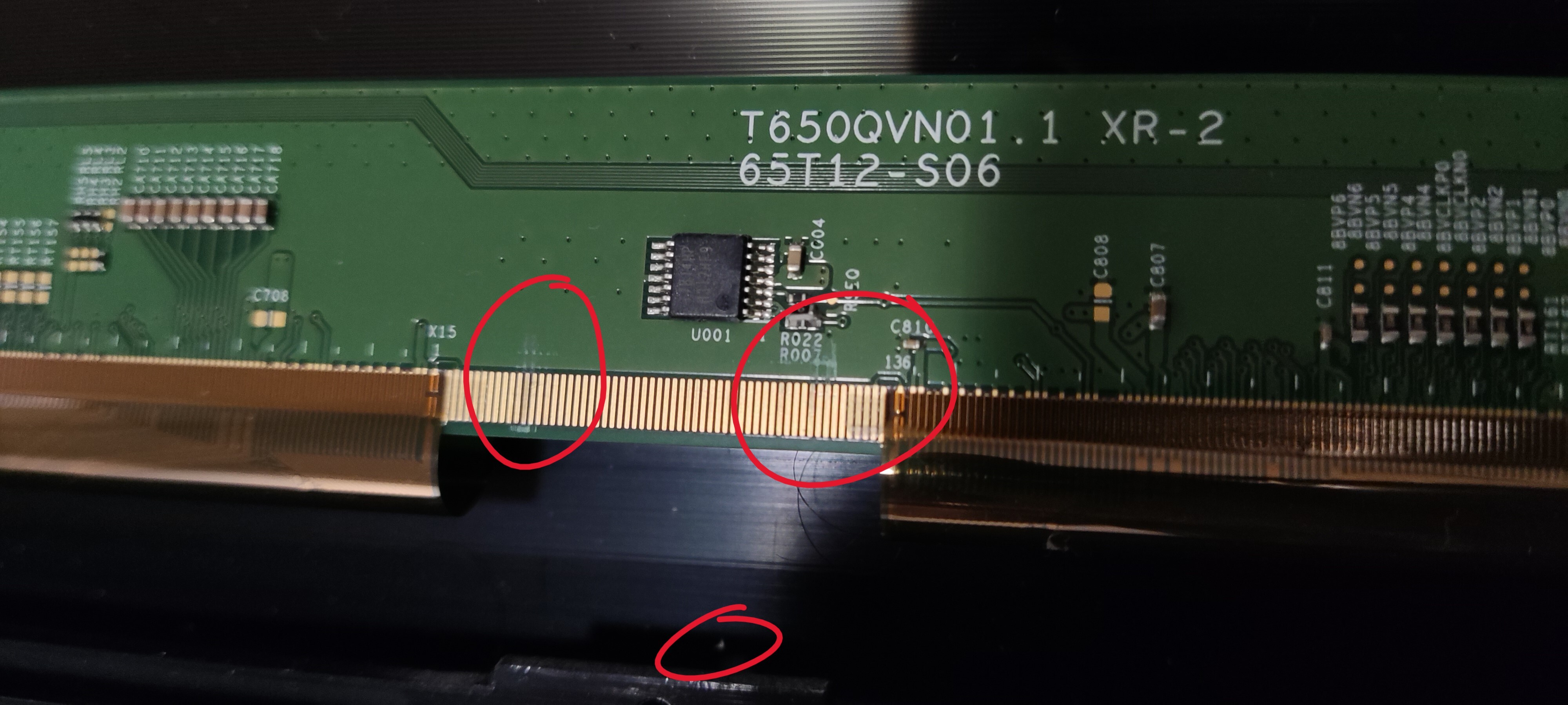

                      Originally posted by lotas
                      + Missing components.
                      Not sure if something is missing? I have the TV in this room and there is also nothing that fell off...
                      I have attached two pics. Please take a look.

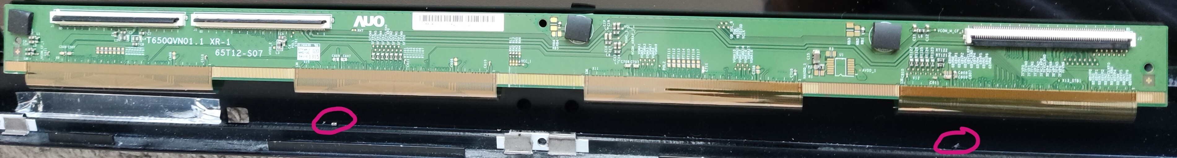

                      • tec3000
                        • Mar 2024
                        • 119
                        #231

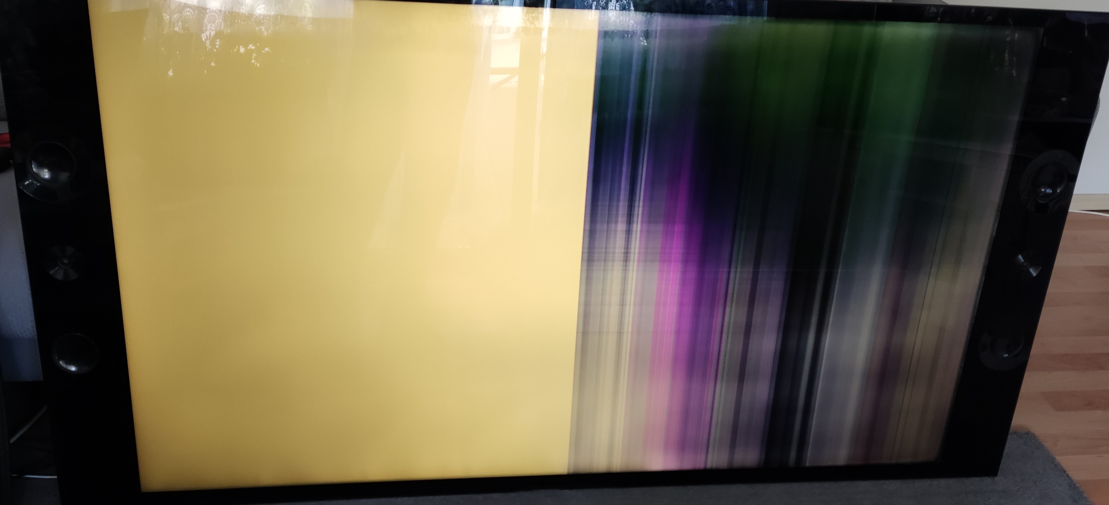

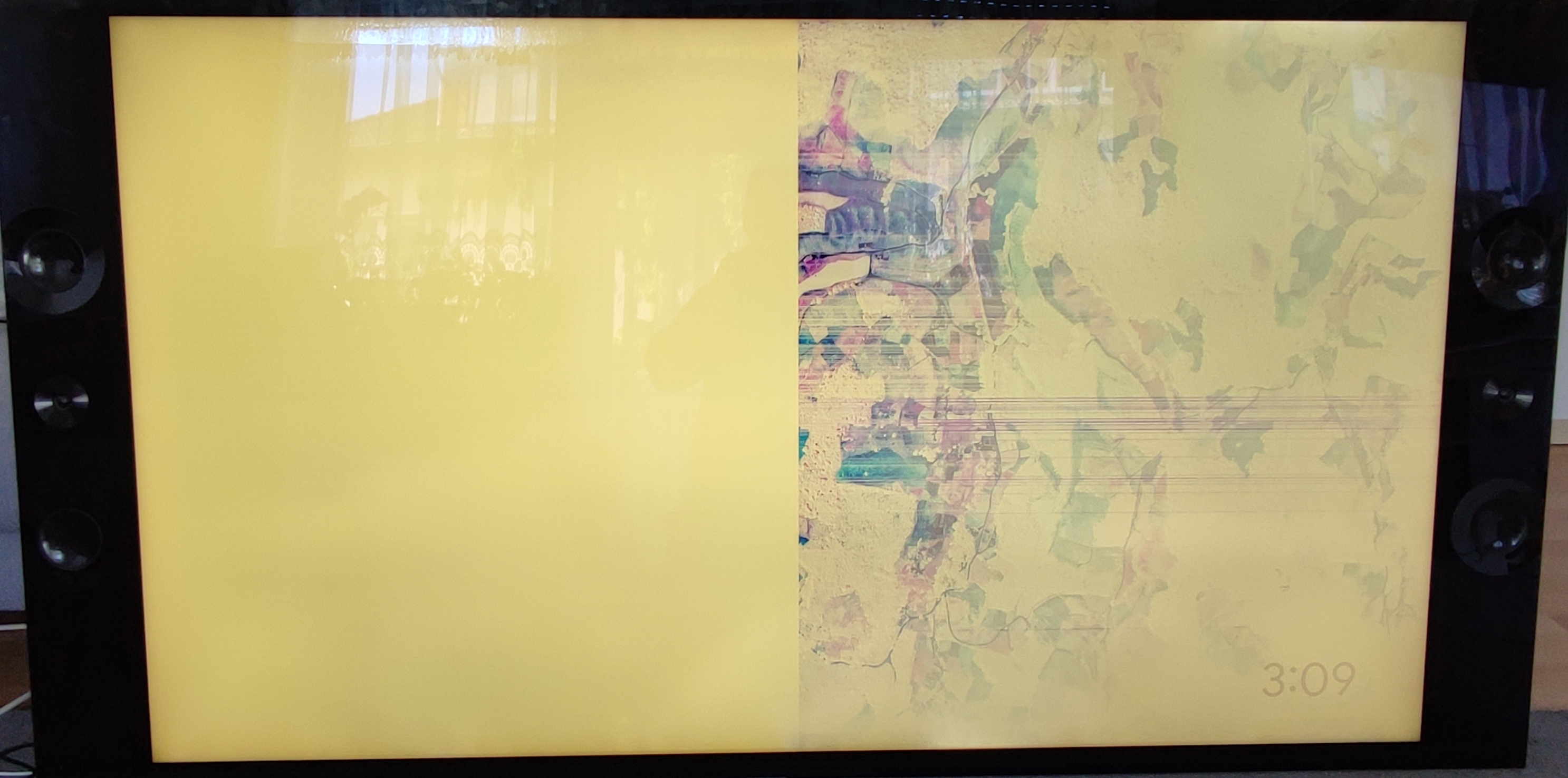

                        I removed the defect one and changed places with the working one. Unfortunately I don't have a clear image.

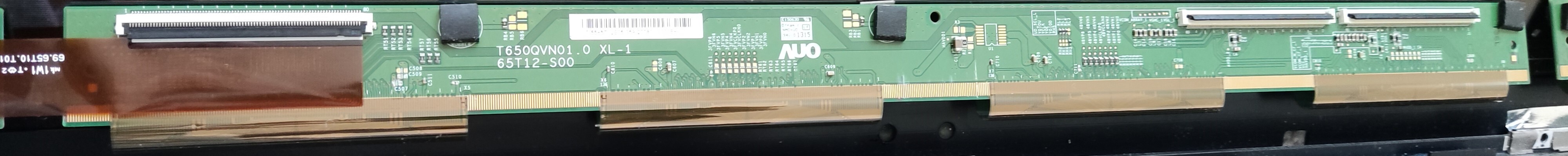

                        With MY t-con board I got only weird lines on the right. (Pic1)
                        With the t-con board from China it looks a tiny bit better Pic2.
                        It's baffling. So it's not just the U ribbon cable unfortunately Maybe it's the LVDS cable?

                          #232
                          Well, isn’t there something you can’t see already? Take a magnifying glass and inspect all the planks for any broken components.
                          • Diah
                            • Feb 2013
                            • 6357
                            #233
                            not good at all.... what you did man...
                            take out the screen.. be careful don't add more damage.. so we will have access to whole panel buffer boards to compare the other side with this damage and to know what kind of Cap installed.. and don't use your original t-con too

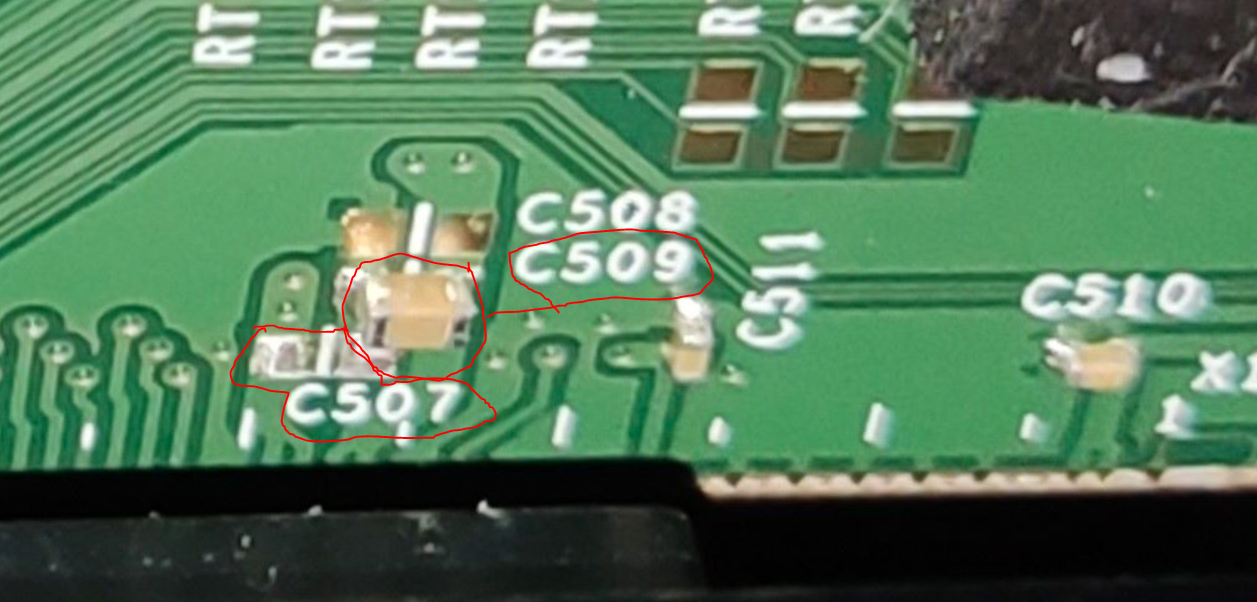

                            • tec3000
                              • Mar 2024
                              • 119
                              #234

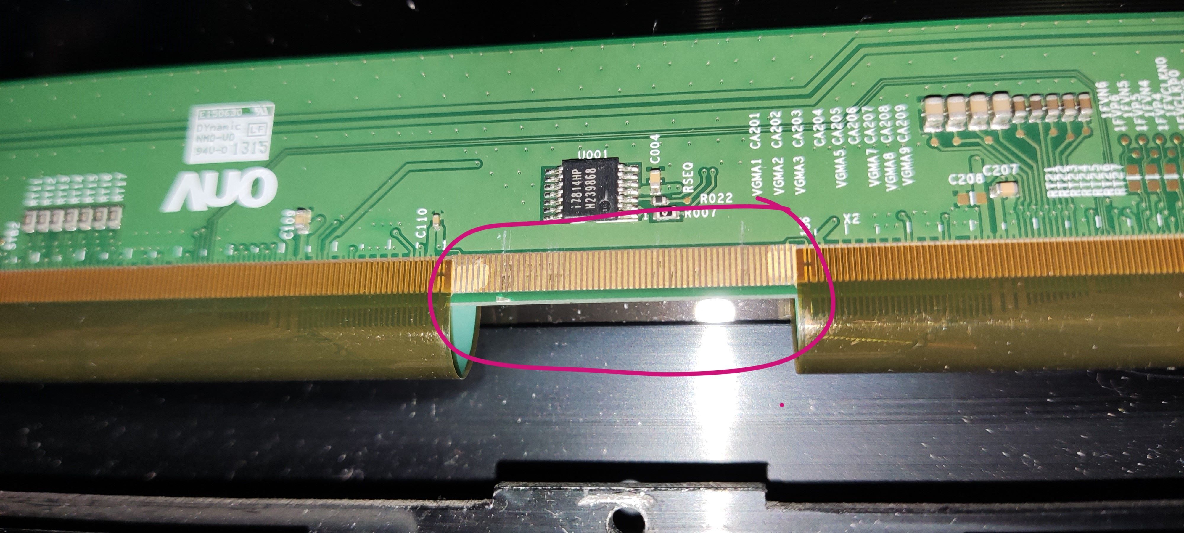

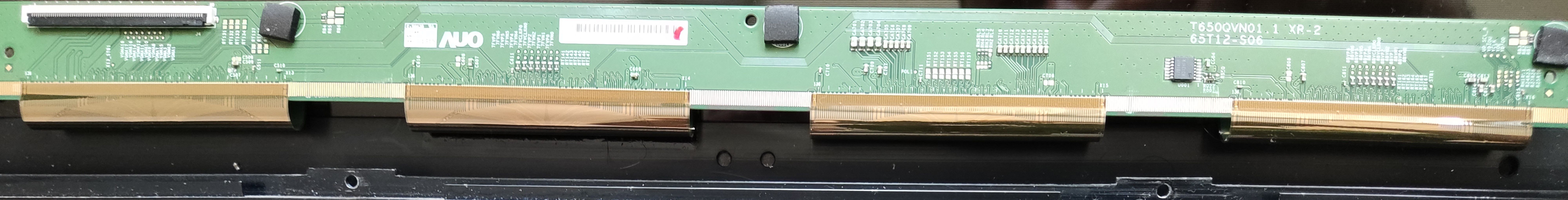

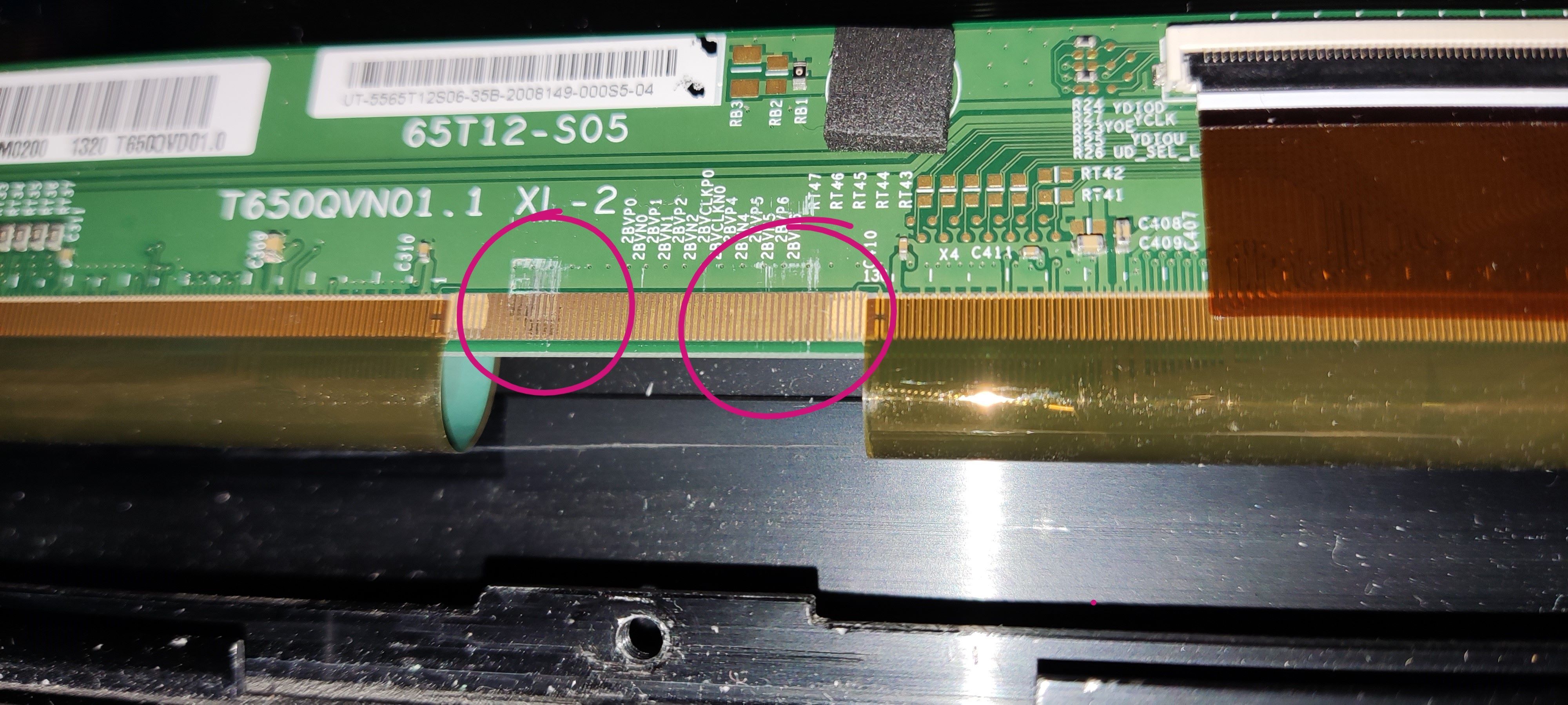

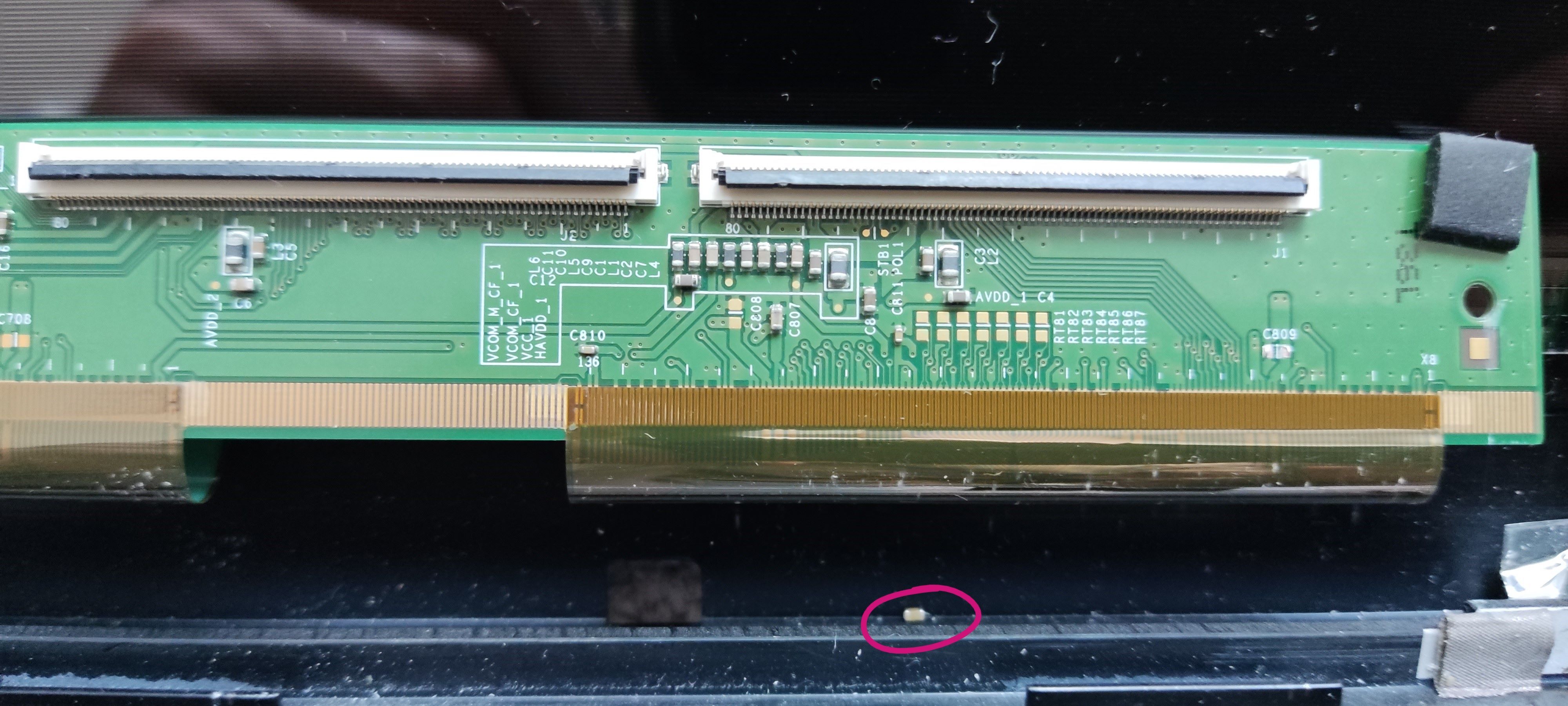

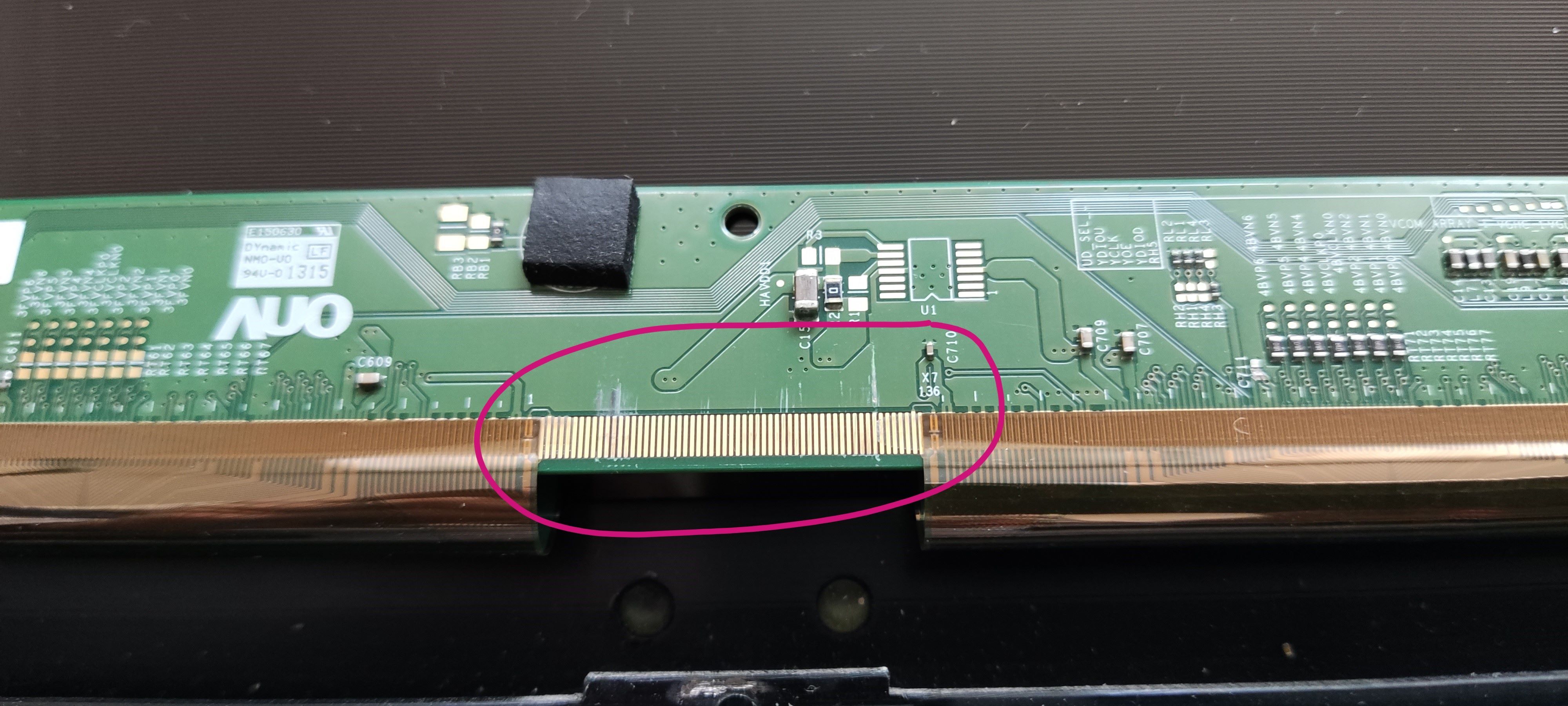

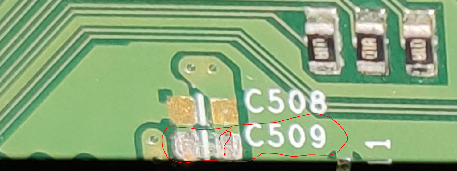

                              Guys, as always you are correct. Pieces fell off. Almost on all of the buffer boards. Not only that... FCK....
                              I am trying to capture it on camera now. It's a challenge but I'm almost done. Pictures will follow shortly.
                              • tec3000
                                • Mar 2024
                                • 119

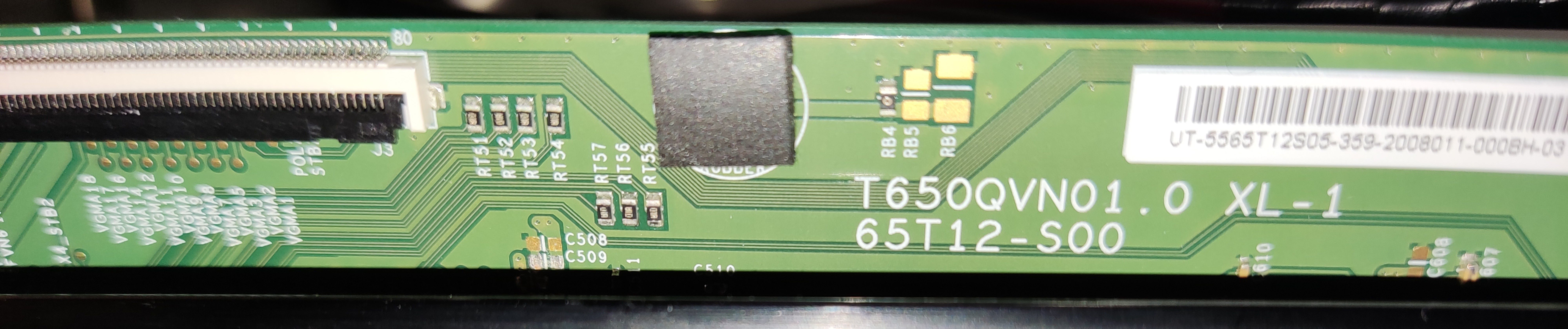

                                #235
                                ok, I will do 4 posts with pics of each board. Worst board is 3. But first here pics of buffer board 1:
                                • tec3000

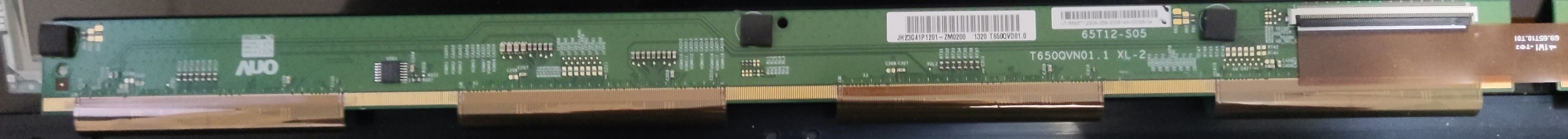

                                  • Mar 2024
                                  • 119

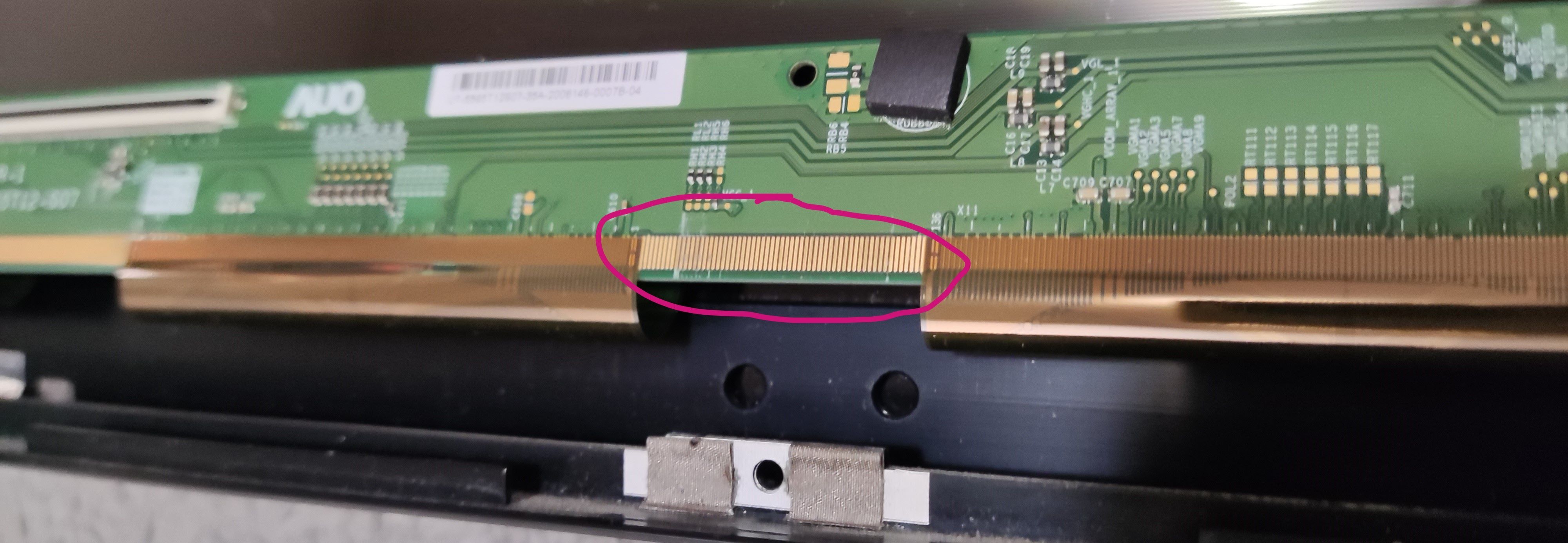

                                  #236
                                  this is board 2:
                                  • Diah
                                    • Feb 2013
                                    • 6357
                                    #237
                                    you are lucky boy you find the missing 2 parts hold them don't lost it but keep them separated as the photos name to know loxation
                                    • tec3000
                                      • Mar 2024
                                      • 119

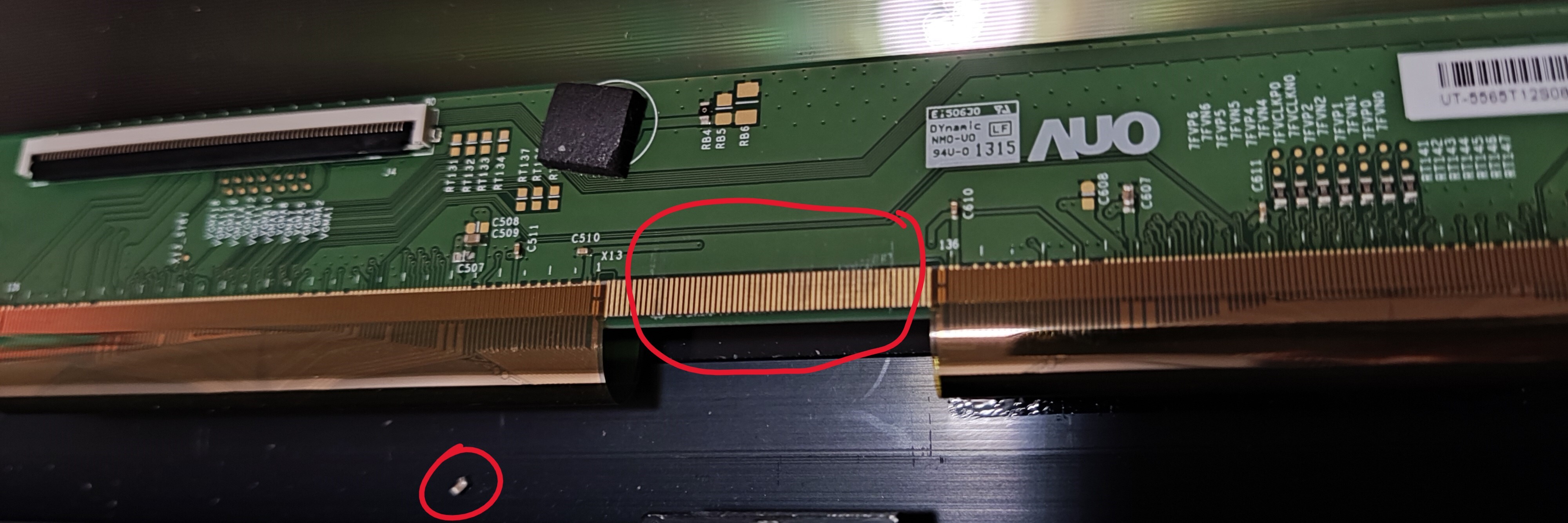

                                      #238
                                      the worst board. Board 3. Look at the vertical white stripes:
                                      • tec3000
                                        • Mar 2024
                                        • 119

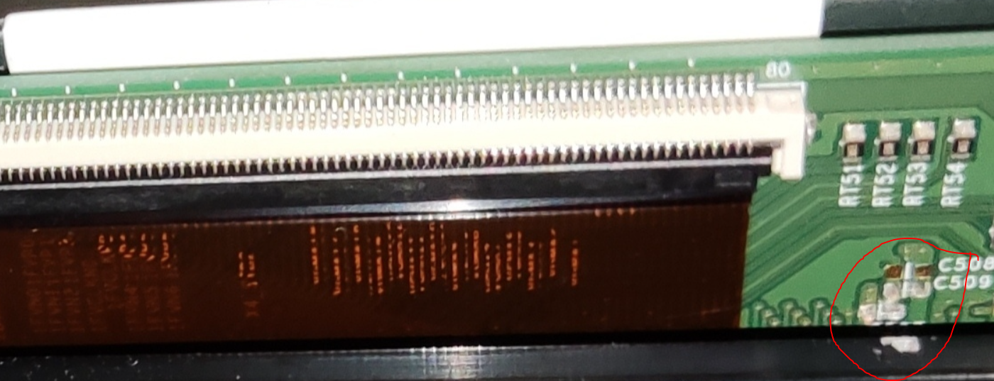

                                        #239
                                        and board 4:
                                        • Diah
                                          • Feb 2013
                                          • 6357
                                          #240
                                          no its not worse,, the empty trace at COF ribbon cable are normal... only the parts you found keep them spectated as photos location to bring them back by soldering
