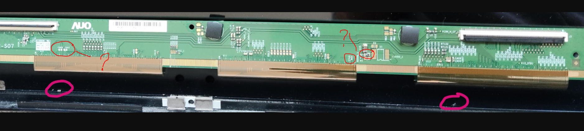

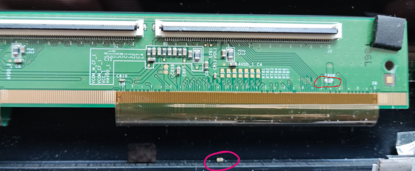

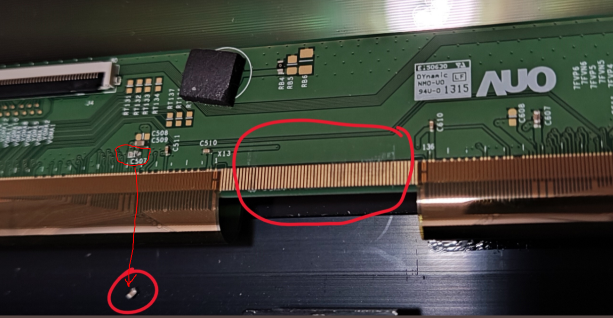

    so now you have 4 parts only fly out
    • tec3000
      • Mar 2024
      • 119
      #242

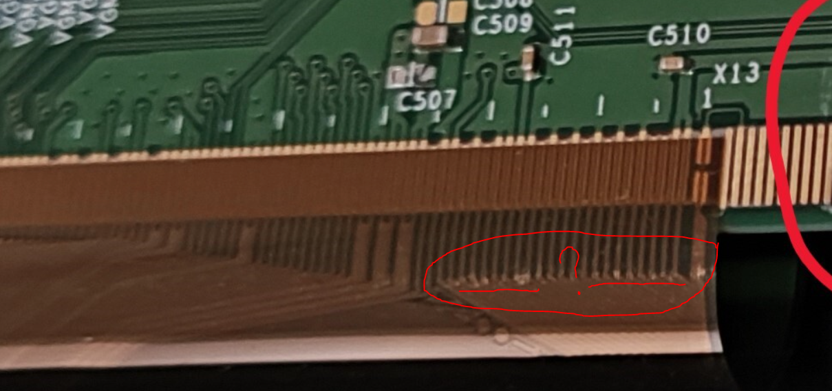

      Originally posted by Diah
      no its not worse,, the empty trace at COF ribbon cable are normal... only the parts you found keep them spectated as photos location to bring them back by soldering
      Thank you Diah. OK I'm relieved. I thought they were traces of burning or something...
      Now, what happens if I solder them and it doesn't solve my problem? I tried to google the buffer boards for my model but can't find anything! And I'm not sure if I really have all lost parts. They are super tiny...
      • tec3000
        • Mar 2024
        • 119
        #243
        maybe more. I will need to inspect further. It's tiny and there is also a lot of dirt inbetween. I can't be sure right now.
        • Diah
          • Feb 2013
          • 6498
          #244
          don't hurry... i think lotas eyes better than my as he discovered... so let wait on lotas advice of the location then you can start soldering them back

              it will be good idea to post photo on each 4 caps you found to see them clearly

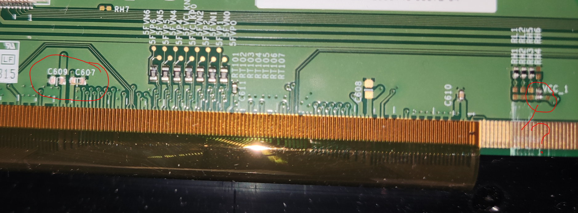

              • lotas
                • Jan 2016
                • 4803
                • Russia
                #247

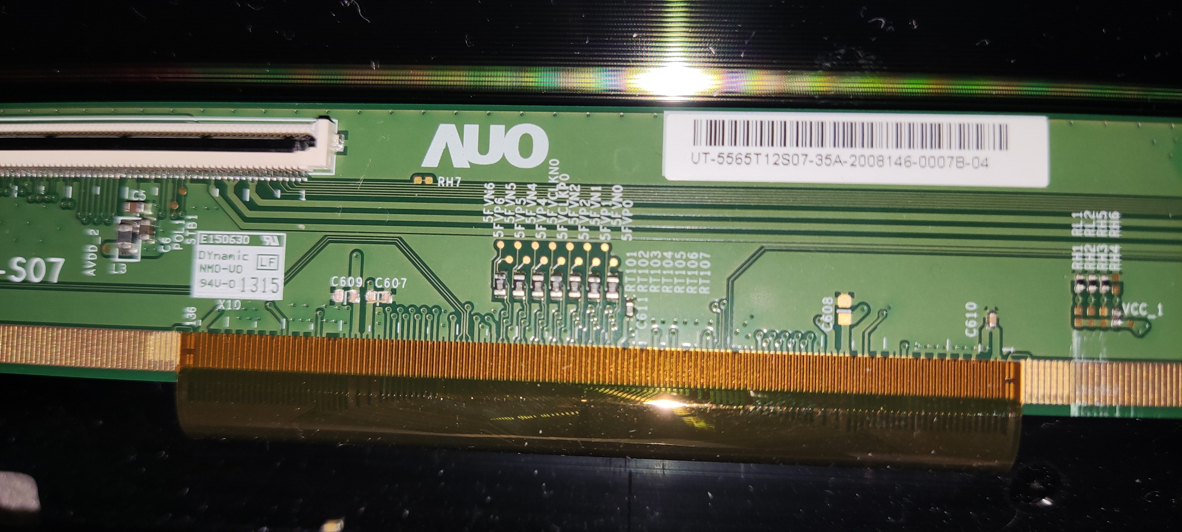

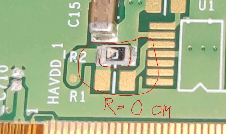

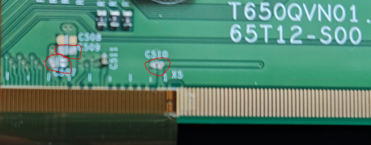

                Everything I saw, the most important thing is not the capacitors, here you need to solder a zero resistor or put a jumper on the chip.
                • lotas
                  • Jan 2016
                  • 4803
                  • Russia
                  #248
                  It's hard to see on this bar...
                  • tec3000
                    • Mar 2024
                    • 119
                    #249
                    Thank you lotas I appreciate you took time to inspect the bars and marked them.
                    So, just to check... You say "solder a zero resistor or put a jumper on the chip". Does that mean I DO NOT need to solder back the parts that fell off?? Instead I have to buy some resistors and solder them on each bar? And you say OR jumper? So is that an option I have? I have zero experience with these things...
                    I retook pics of the second board. I can also retake better pics of the other board if you like.

                      #250

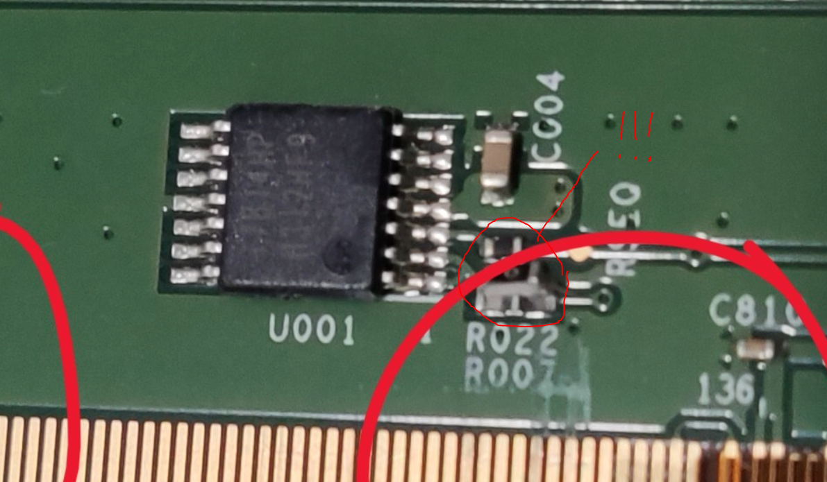

                      you mean R007.. i don't think its in use,.... OP you need to shoot very clear photo on the area close to the IC

                              #254
                              R007 is torn off and hanging on one side, if it is alive (has a short circuit), then just solder it on both sides.
                              • lotas
                                • Jan 2016
                                • 4803
                                • Russia
                                #255
                                Check R2, it should also show a short circuit (0 Ohm).
                                • lotas
                                  • Jan 2016
                                  • 4803
                                  • Russia
                                  #256
                                  And then check RH4, it’s hard to see.

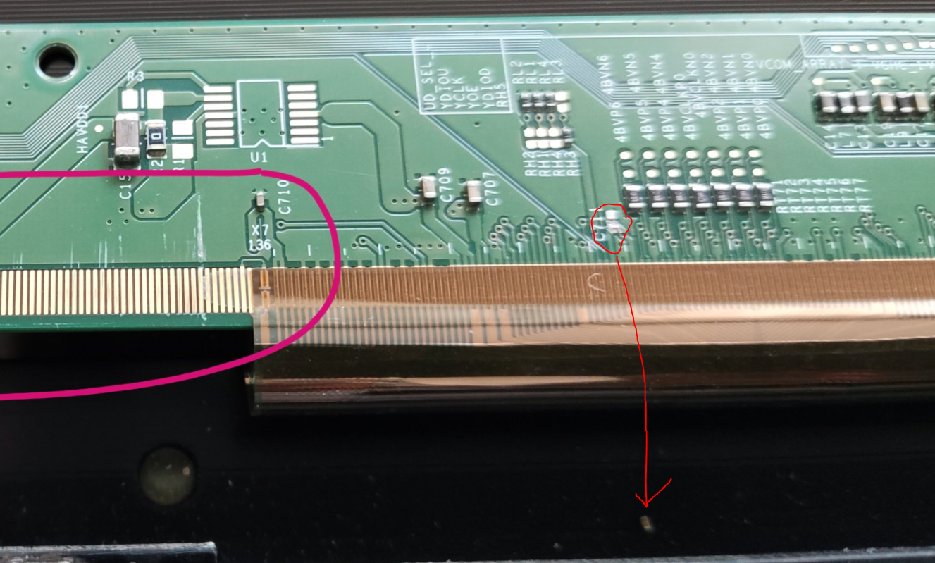

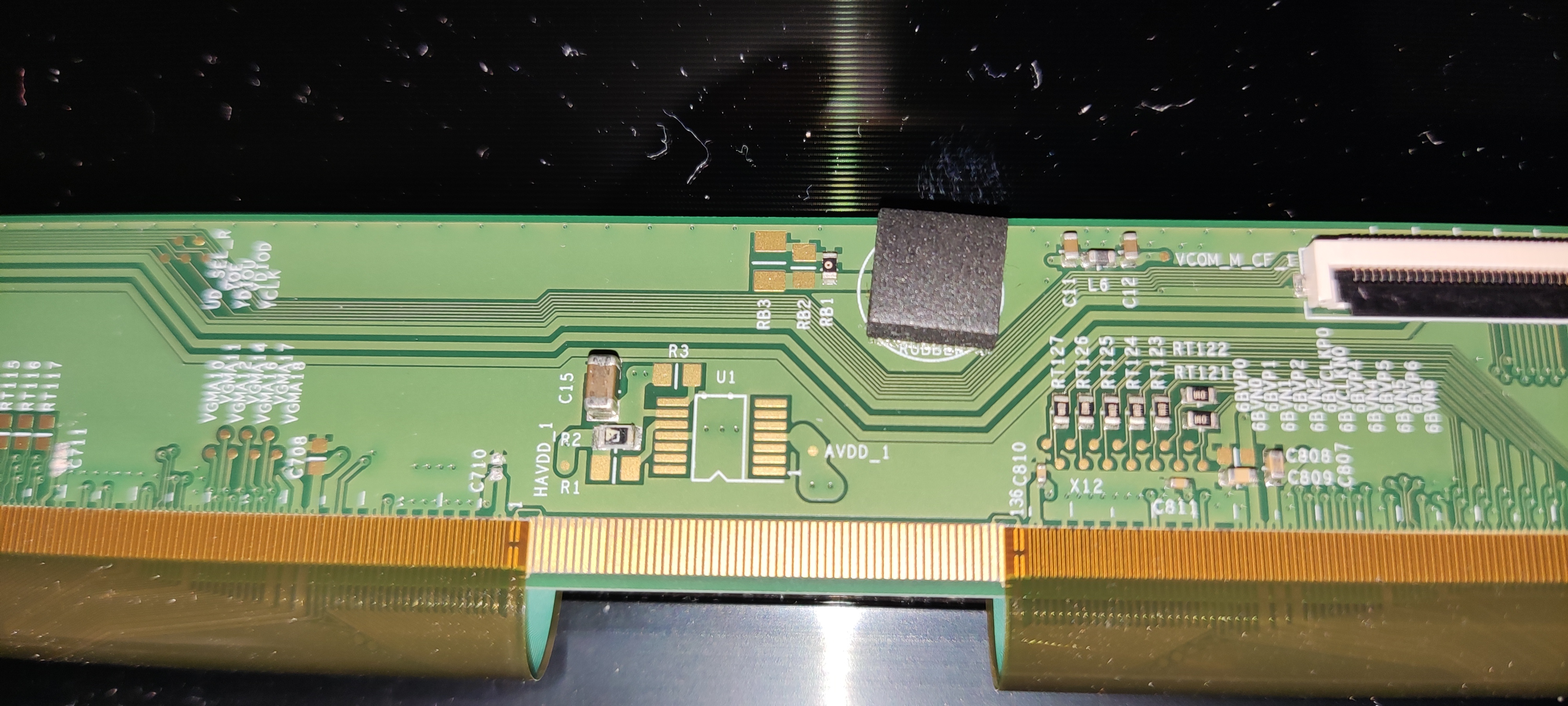

                                    #257
                                    yours photo , here could be parts falling down too
                                    • tec3000
                                      • Mar 2024
                                      • 119
                                      #258
                                      Ah! I forgot to tell you about it. I was able to identify the mysterious "L" on the left bottom of the TV. Luckily I didn't even have to disassemble anything. One problem less!

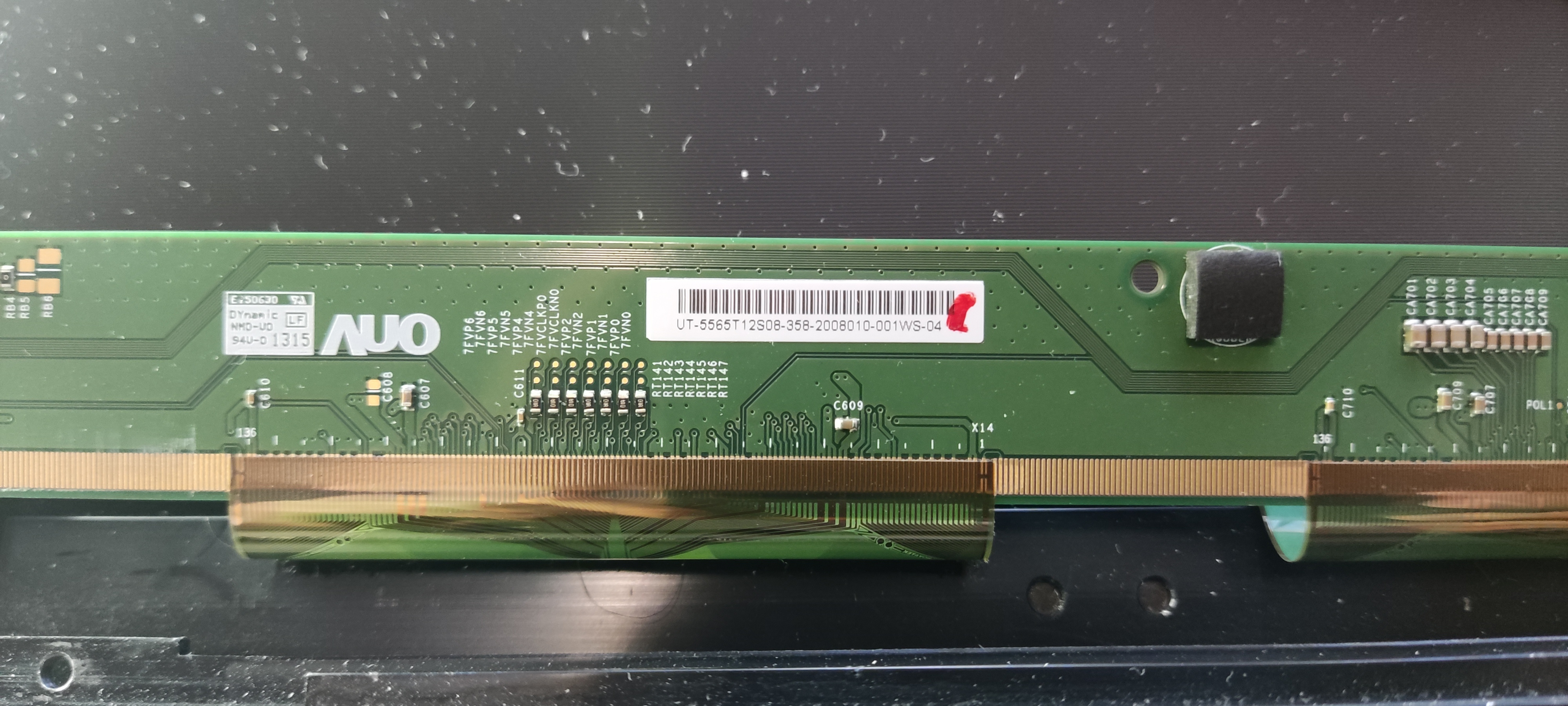

                                      • tec3000
                                        • Mar 2024
                                        • 119

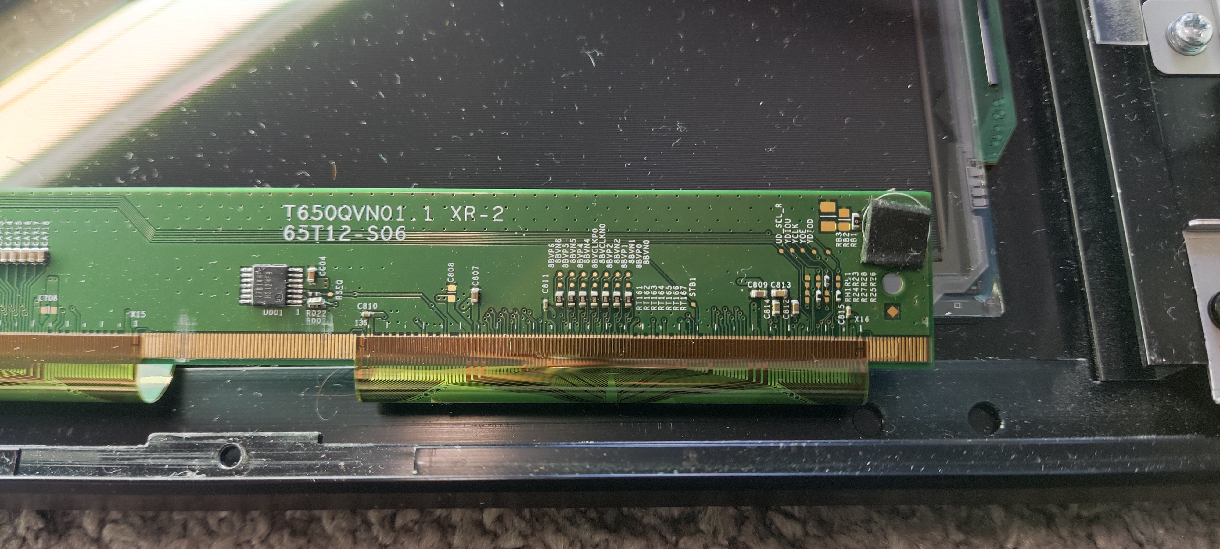

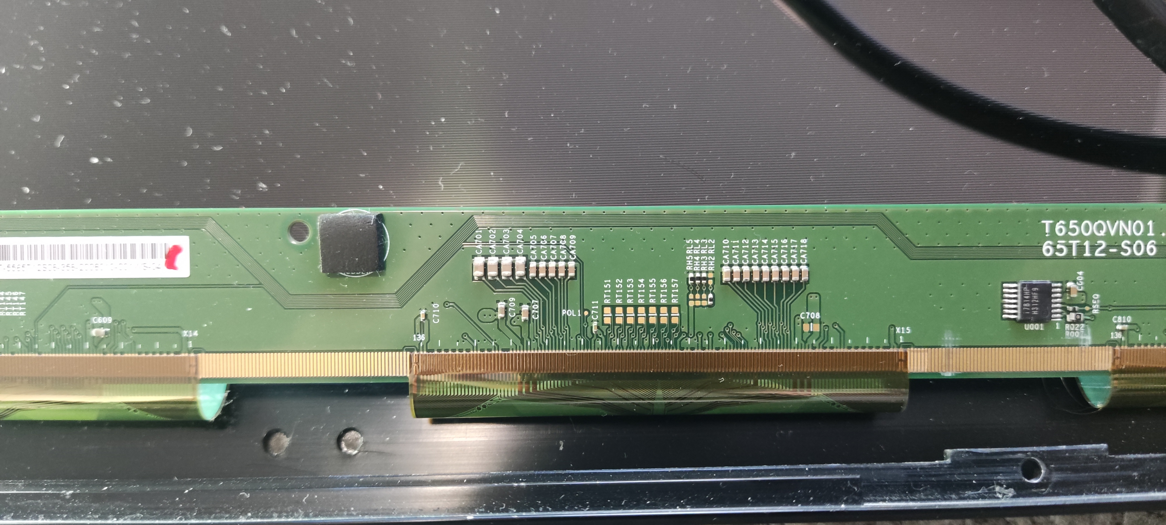

                                        #259
                                        don't use the mobile camera in flash light mode... just use external light like ( torch ) on the area
                                        I have retaken the pictures. I will upload them now.
                                        • tec3000
                                          • Mar 2024
                                          • 119
                                          #260
                                          this is board 1:
