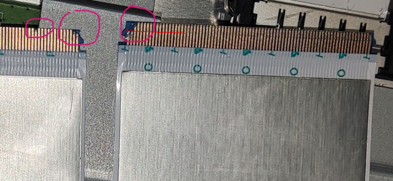

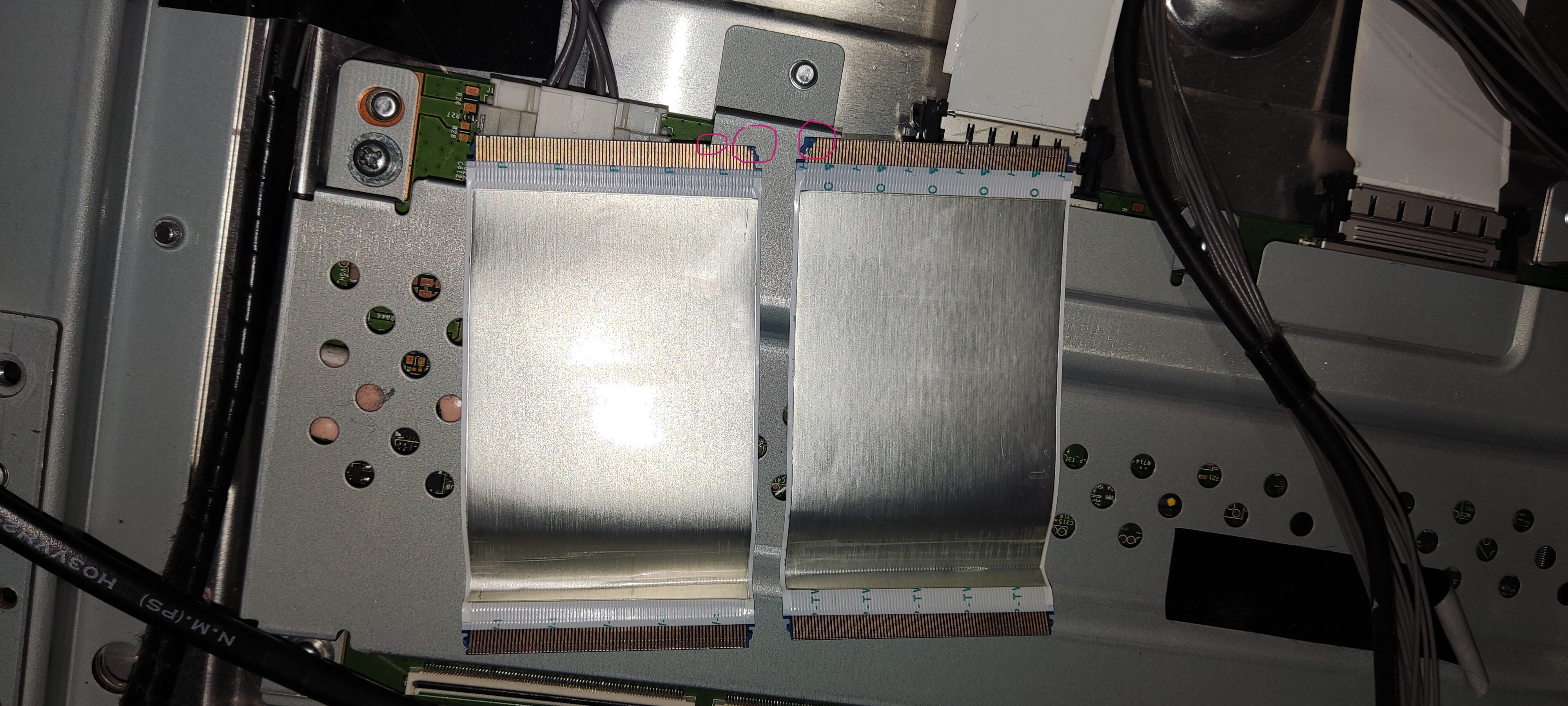

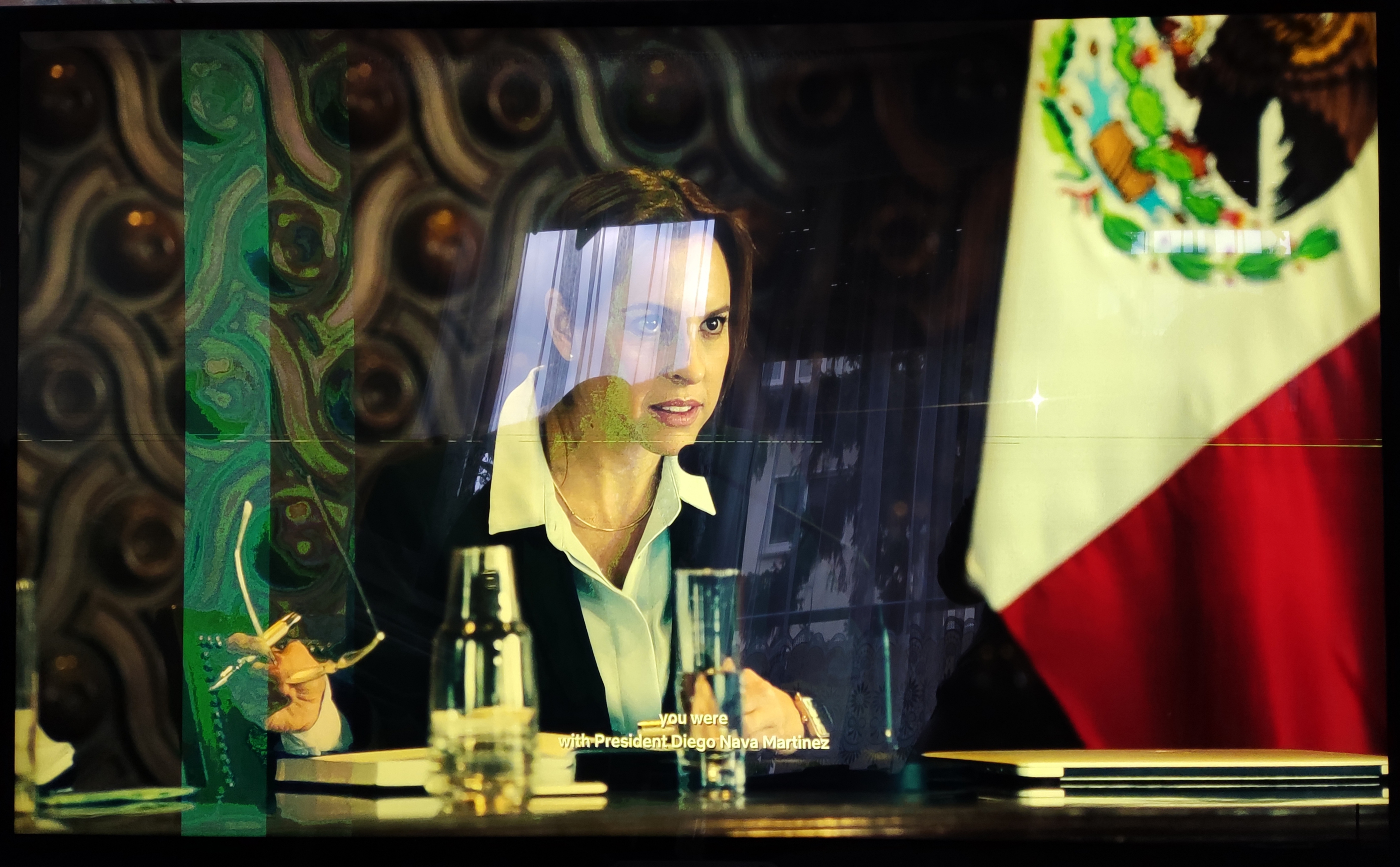

                    Ok, I was able to put everything back together. TV doesn't shut off anymore! And I was surprised to see that light output was even. It wasn't blown out on one corner!
                    But I have new problems....
                    Picture had weird artefacts AND two green thick vertical lines. I was able to get rid of one line when I played around with one LVDS cable. (Pic 1 and Pic 2)
                    So silly me thought it was a good idea to keep the TV on while disconnecting and reconnecting the LVDS cables. I think something must have happened there because since then whatever I do I only get a washed out white image (Pic 3).
                    And in Pic 4 you see the cables. I circled a few spots. Do you think it's just the cables that I need to replace or do I need a new T-Con board? ://
                    I know I somehow messed it up again

                      #170
                      good work for you as it first time to be encourage to take TV in parts and yon have less info on parts..
                      the end result of line or green line now more noticeable to you.... try to clean LVDS and ribbon cables with out damage them..... other wise you can live with it.

                        #171
                        There is no need to clean it, but it needs to be changed, 1.2 pins do not have contact with the connector.

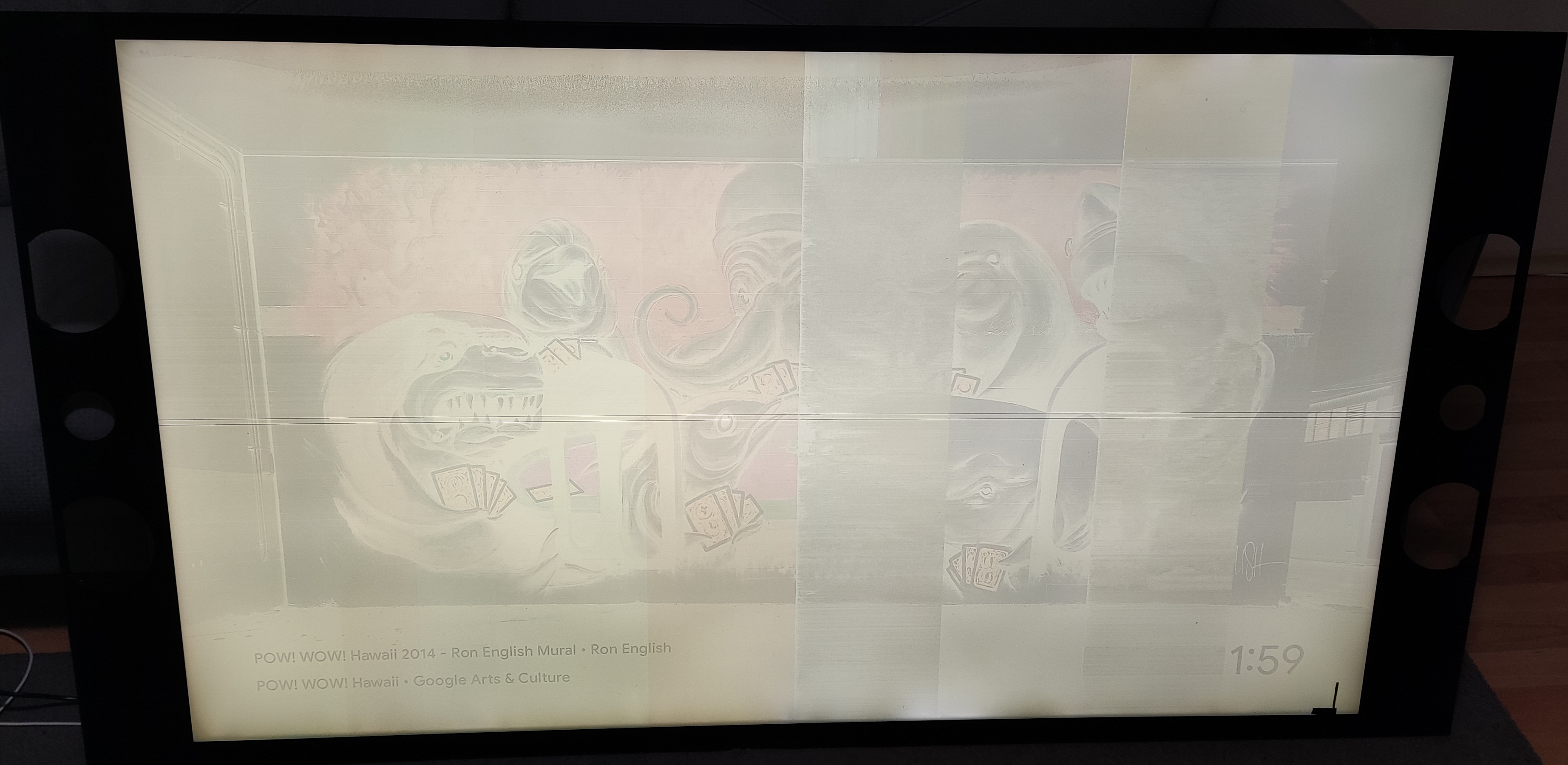

                          #172
                          them are hard to find parts maybe, a restoration could be made, but needs expert hands / tools..
                          this is not a tv for homemade repairs i think, generally i see not a good job (halo areas and etc..)

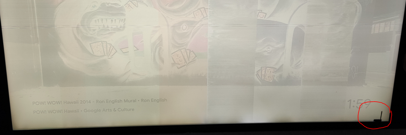

                            #173
                            so this is how my tv now looks

                              #174
                              Click image for larger version  Name:	1713909612508.jpg Views:	0 Size:	1.64 MB ID:	3259172
                              I wrote above that now we need to change the cables, what kind of defect is there on the panel, a crack?

                                #175
                                Yeah, I didn't even mention that yesterday because of the bigger problem. Luckily it's not a crack. I'm not sure what it is. It happened after I put everything back. Something on one of the sheets maybe? Like a piece of tape? I'm not sure. But it's definitely not a crack.
                                About the cables: Can you guys help me find the correct ones? I don't know what to search for. You have some eBay/Amazon link? That would really help. Don't wanna buy something wrong.
                                And it's also possible I need a new t-con board cause it started smelling. I think I did a short circuit, but I'm not sure.
                                Maybe buy new cables first and see how it goes?

                                  #176
                                  First, inspect all four connectors under a magnifying glass to see if there are any traces of conductors left inside them from the cables (they can short-circuit the contacts).
