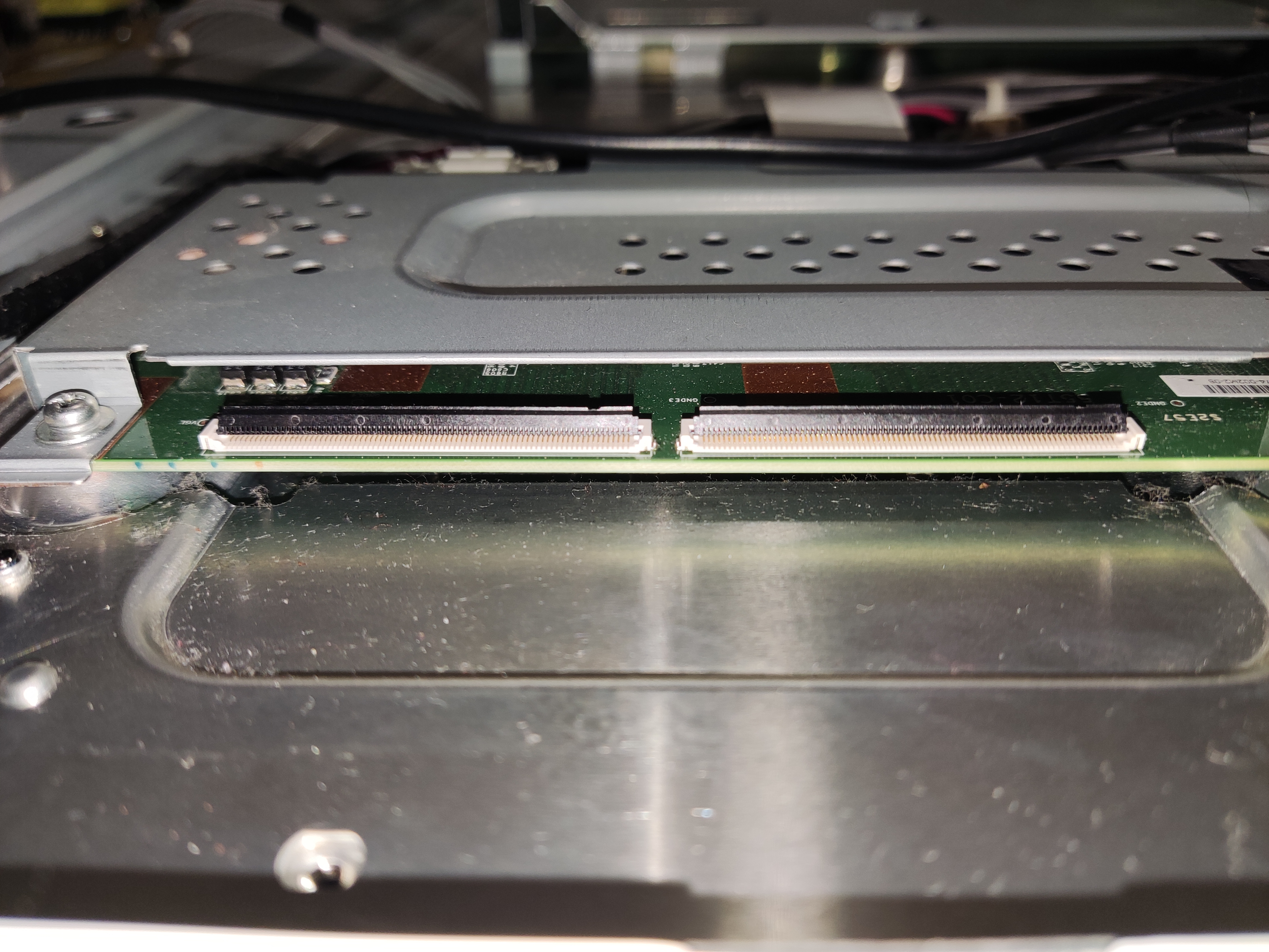

    The t-con is 50 bucks elsewhere. I wanna find those cables first. Does it have to be the exact same ones for my Sony? It's just 4 cables, right?
    • Diah
      • Feb 2013
      • 6544
      #182
      measure them.. long / wide and how many pins,,, any brand same measurements will work

          Ok, in German they are called "Flachbandkabel", right?
          Originally posted by lotas
          Try to bargain with the seller, maybe he will sell you cheaper.
          Thank you. Good idea. No harm in trying. Btw. I just had a closer look to the connectors. Nothing visible. I tried the magnifier but the cam gets even closer.

            You need to inspect all 8 connectors, blow them out, go over them with a soft brush...
              yes T-Con PCB Flachbandkabel
              i asked you to measure one of them,,, i have so many kind.. could be one or 2 passed

                lotas ah ok, I will do that. Disconnect both ends. Hope the problem doesn't lie on the RAM sticks or whatever they are.

                  It's 4.3 cm wide (actually the head is 4 cm) and 7.8 cm long. It got 80 pins on each side. I hope I can find the right ones...
                    change all 4 with 100mm long 80 pin from uncle china
                    from yours photos i think 80P-1 or 80P-3 will be fine but still you need to compare and measure to have the exact wide

                      Diah Thank you very much! Looks great! I will order them. Let's see if that fixes my problem. Otherwise I will have to buy a t-con board too. And maybe veb a LED driver board...
                        t-con it may damaged... by shorting and gamma circuit went defect,,, but this you will know later.... LED driver boards i don't think it need now from photo judgment and the measurement we did early,,, but one critical issue you have 2 horizontal line which it caused by t-con or LVDS... so need to inspect LVDS as you are now expert to know why and how old flat cable easily the contact pins damaged
                            Ok, that's good. Today I will look for the same cables in Germany. If I can't find them here I'll order from China. It just takes ages...
                            Then I'll know if I need a new t-con board.​ Thank you for the continued support!
