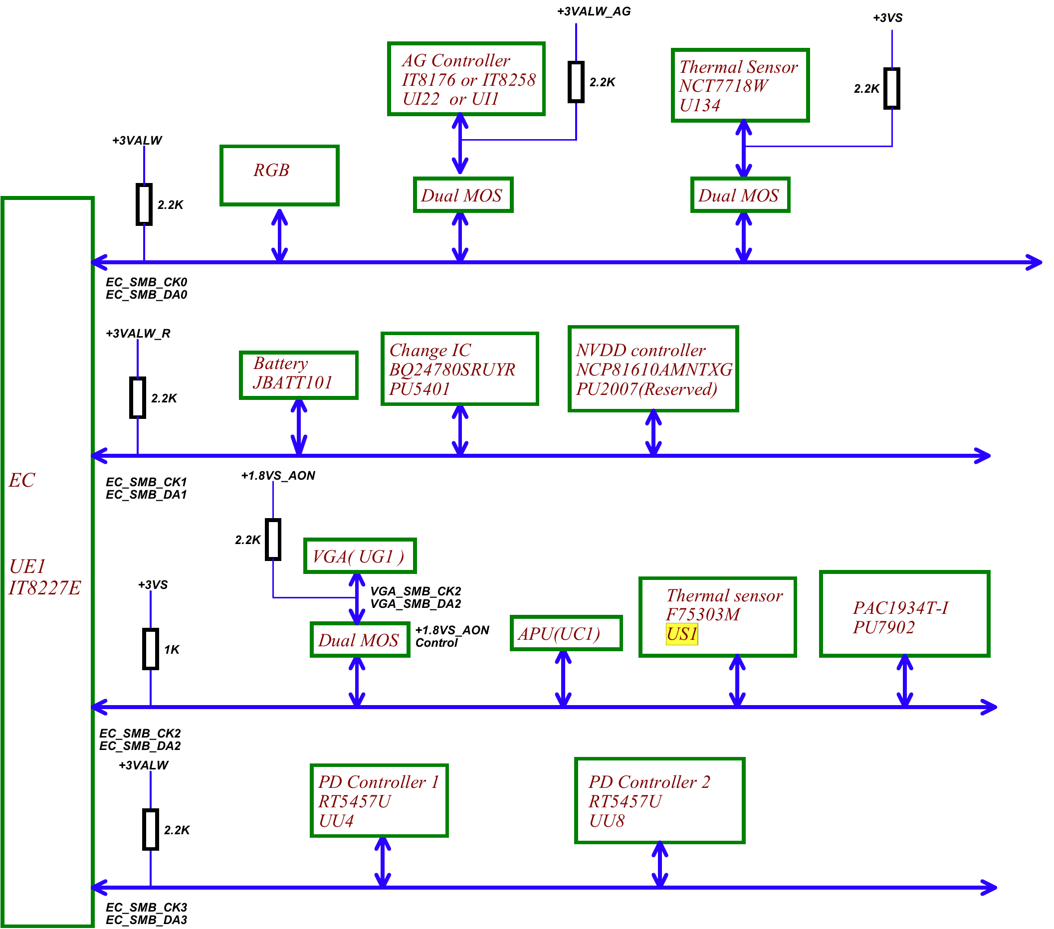

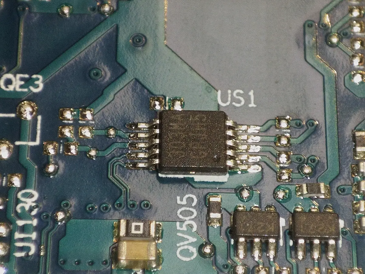

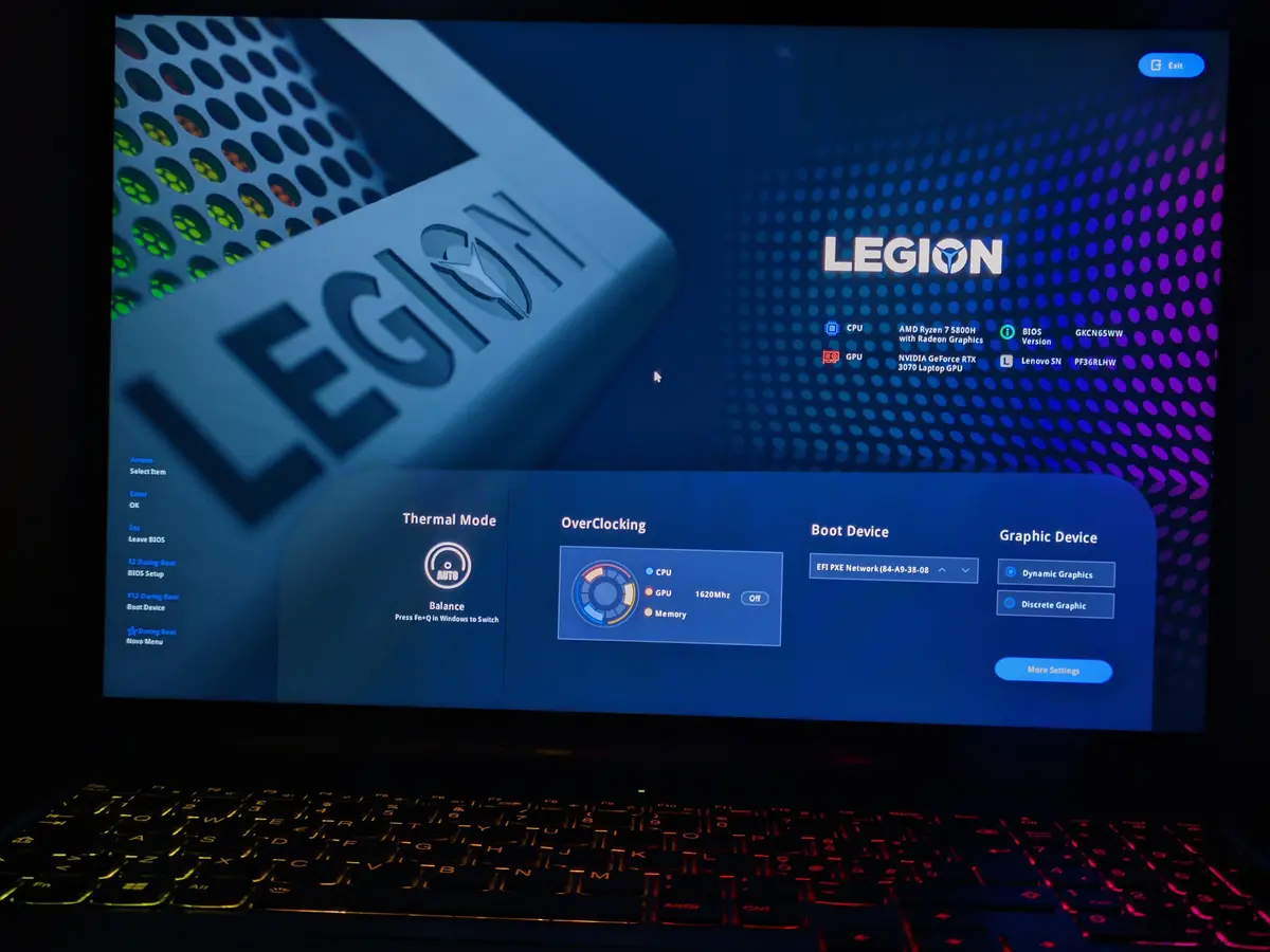

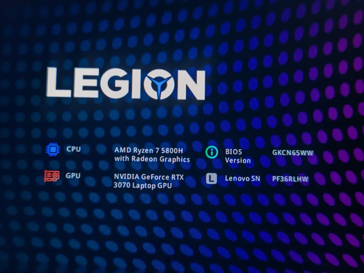

    I have a Lenovo Legion 5 with a Ryzen 7 series CPU and RTX 3070 GPU. My issue is that it turns on and all seems fine except after a few seconds the fans spin up high and the laptop turns off after 34 seconds.
    I can get into bios and can even boot and login to Windows however after 34 seconds no matter if Im at the bios screen or booted into Windows it will just turn off.
    I have managed to run HWmonitor and the temperatures of the CPU and GPU are fine, I can also touch the heatsync which is warm but not hot.
    I have tried a few new bios but exactly the same thing.

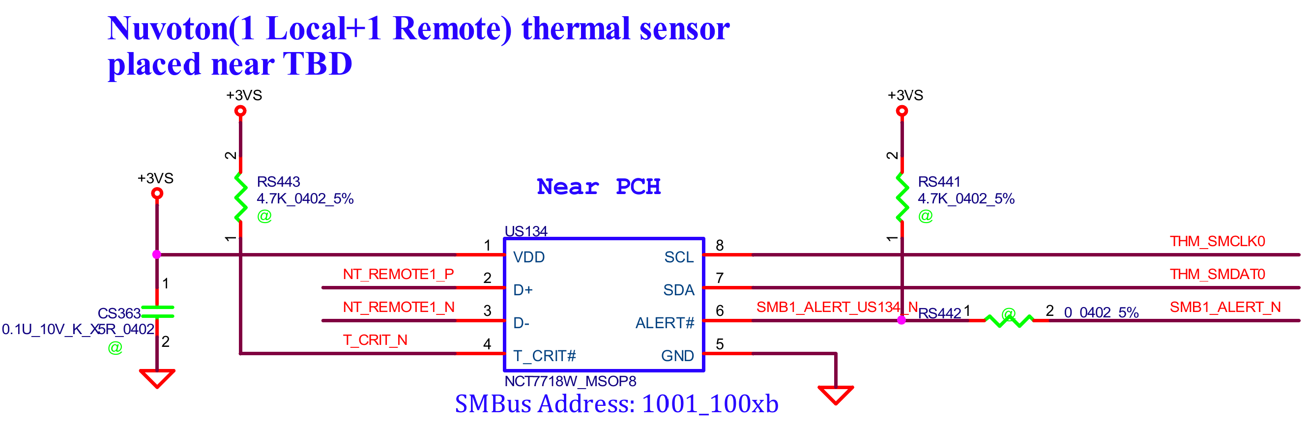

    If I remove US134 which is a thermal sensor then the laptop stays on for 65 seconds before turning off, putting it back it shuts off at 34 seconds again.
    I read on a forum that it maybe the MUX switch which if I disable discrete graphics in the BIOS does not change anything. I could remove the MUX chip but I'm not sure what will happen or what it will prove.
    Any ideas?
    Many thanks

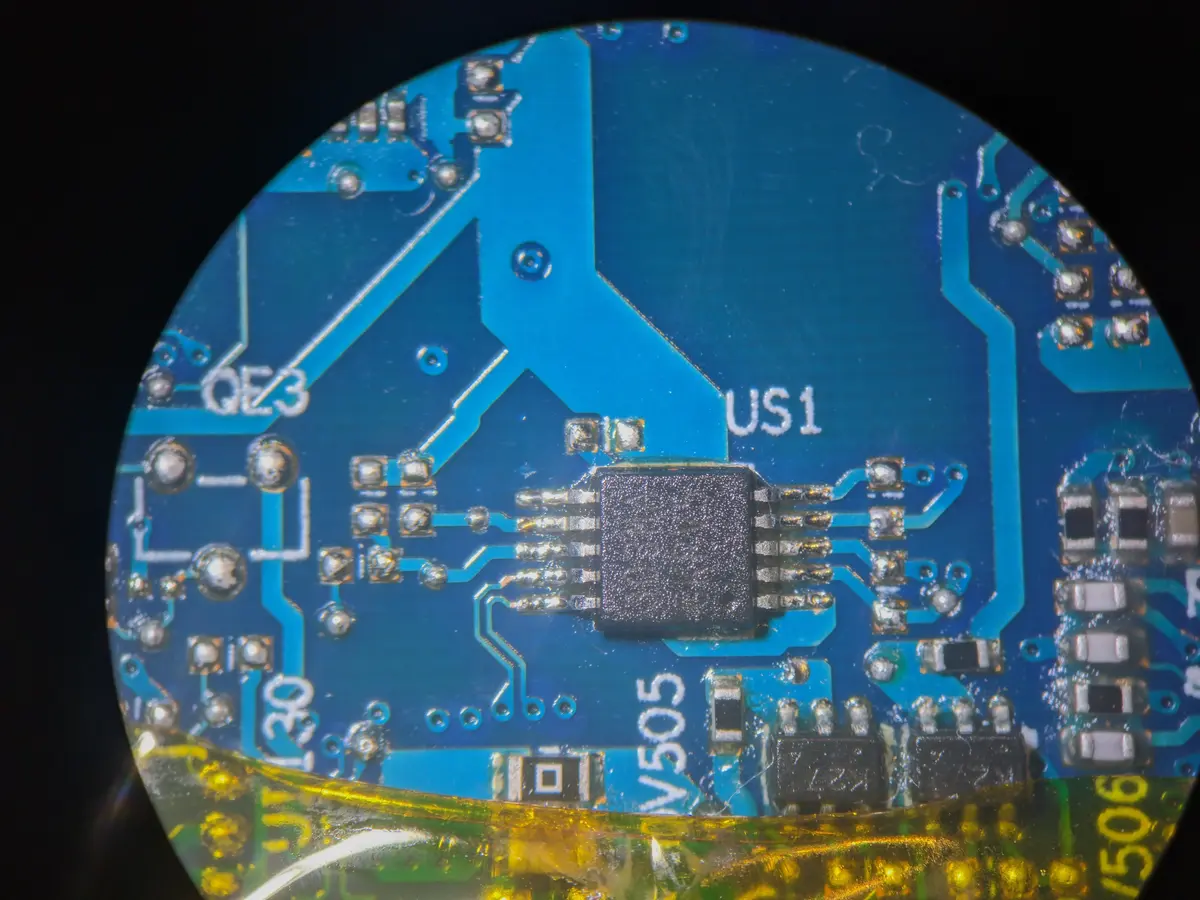

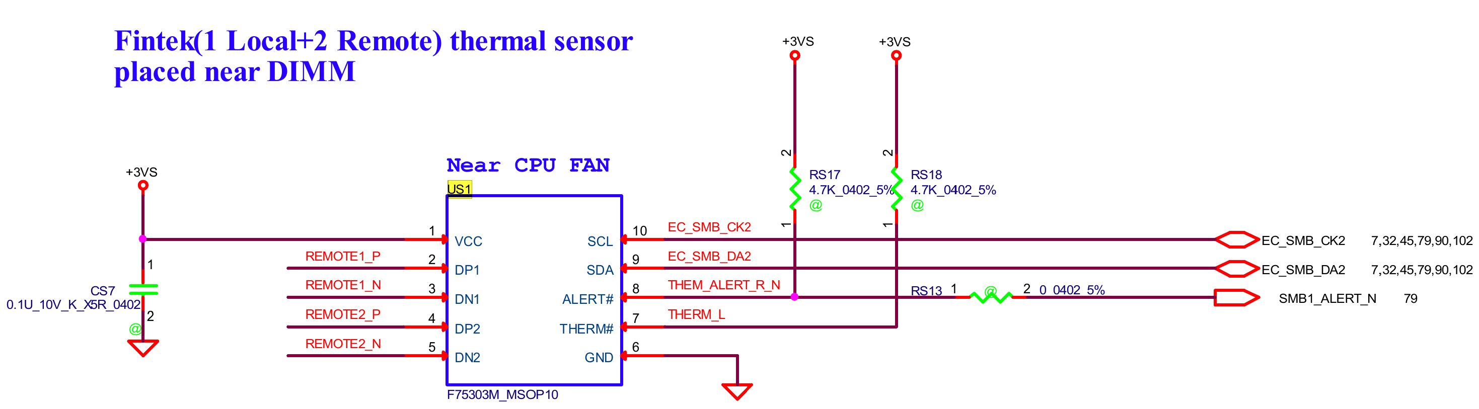

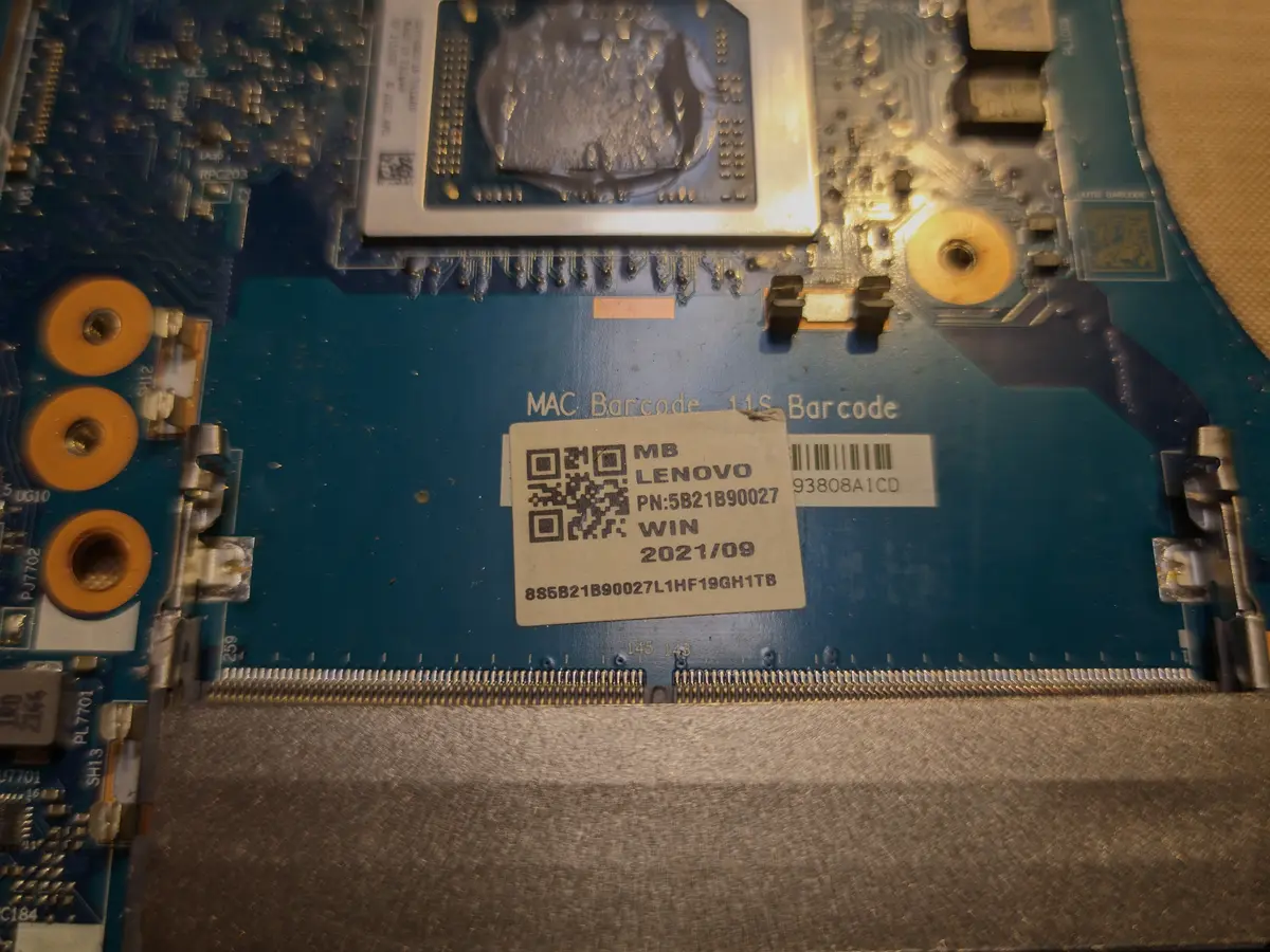

        Hi guys, I finally figured it out. My issue was US1 which is a F75303M. It's a temp sensor chip for the CPU.
        Ordered mine from Aliexpress and fitted. Laptop is perfect now.

            Hi, I removed US1 because it is a sensor IC for the CPU according to the schematics. I noticed upon removal the laptop would stay on for 64 seconds instead of the 34 seconds with it installed. This made me think there was an issue with it therefore replaced it. After replacing it, the laptop worked totally fine. Tested under full load to and the temps got up to 89 degrees at a push.

              The other thermal sensor on the board is U134, I believe this one is for the GPU.

                  My issue was caused by changing the SSD without disconnecting the battery.
                  This caused an issue with US1.
                  The laptop would work fine for 34 seconds before turning off however the fans ran high.
                  To prove, remove US1 and turn the laptop on. Ensure you have the heatsync back in place.
                  Check how long the laptop stays on for, mine was just over 60 seconds. If this is the case, replace US1.

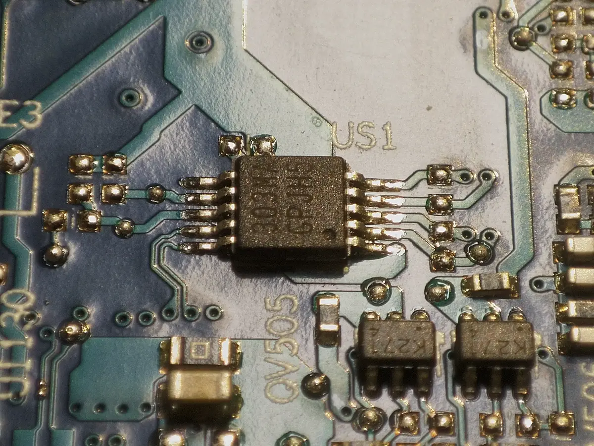

                        I will say though that removing US1 gave me more time, it increased from 34 seconds to about 103 seconds. Just remove US1 and if you get the extra time then replace the IC. They about $8 from Aliexpress.

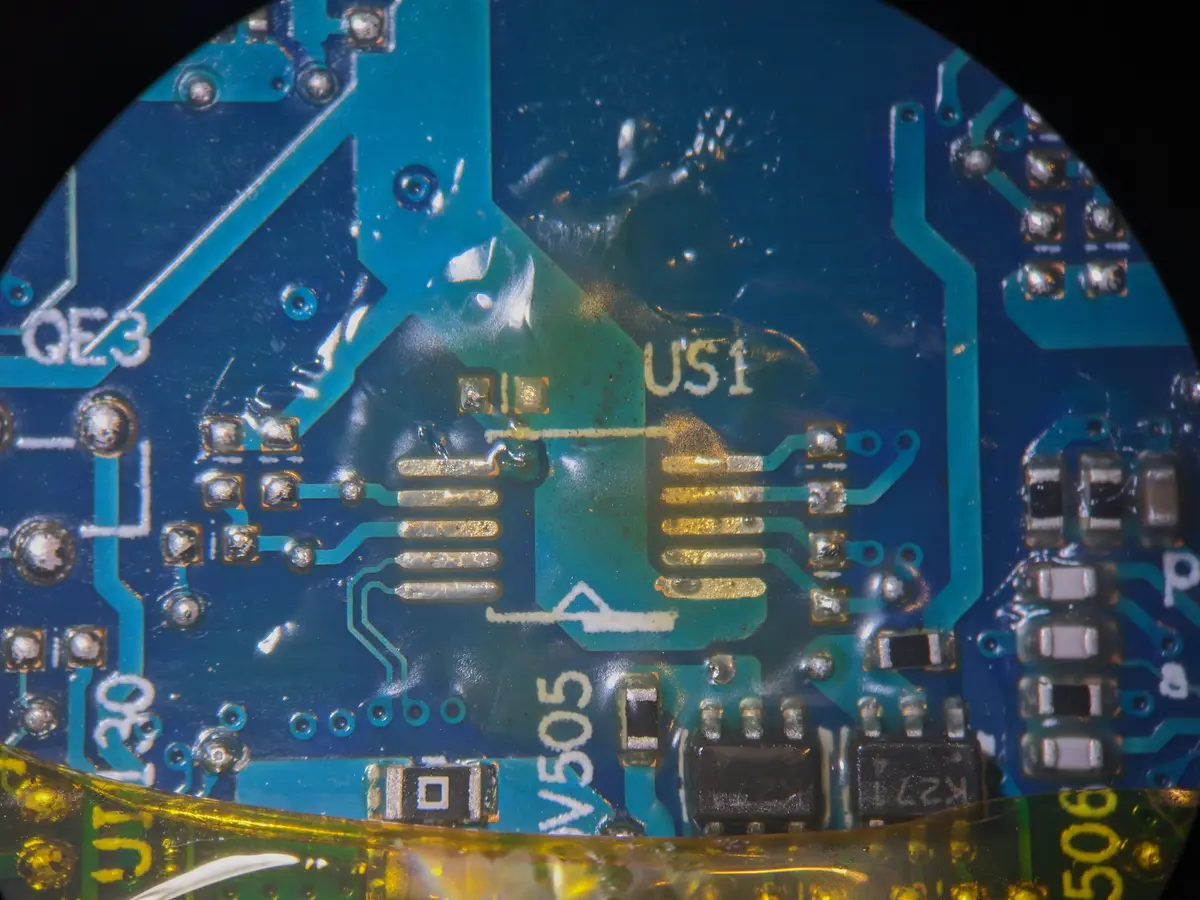

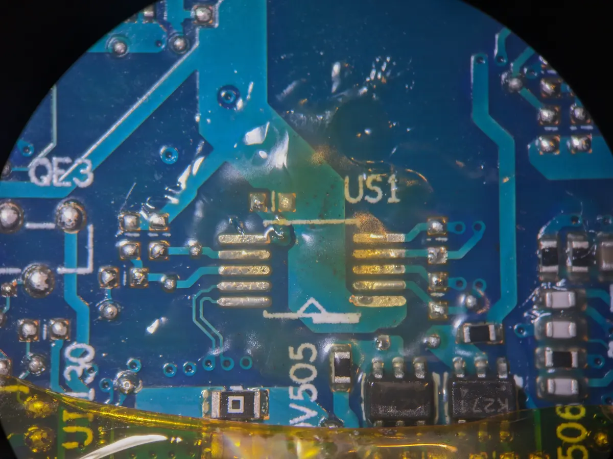

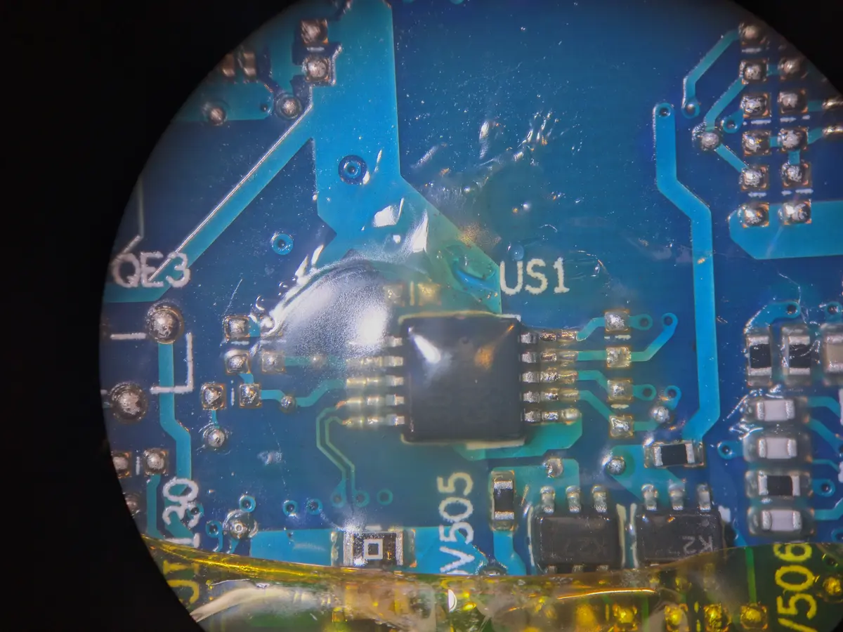

                              twonk9098 The fans don't spin up anymore after removing US1, was that the case for you as well?
                              I can confirm the timing you provided, with and without the IC.​

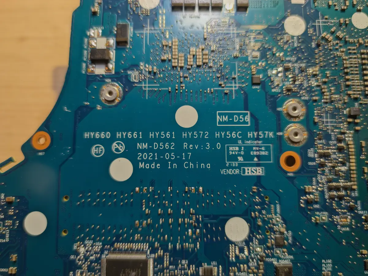

                                I replaced US1 and the issue is fixed, thank you very much!
