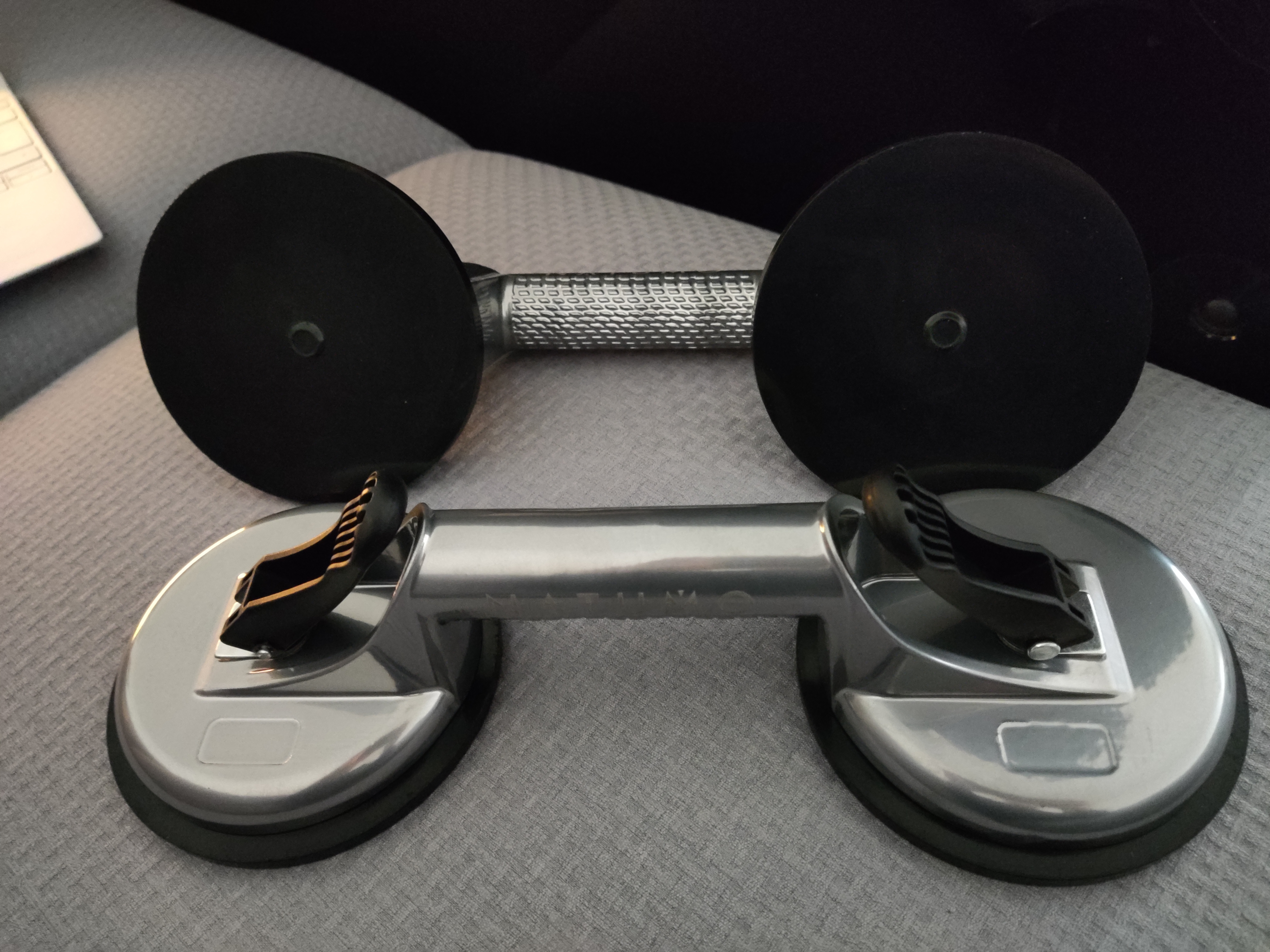

          #84
          slightly of topic but did you see phils video re suction cups we all have too learn but sadly costs us at times https://www.youtube.com/watch?v=2piGTspnCTo
          That's a 28 minute video I ain't watching. What's the point? The suction cups caused those lines? Cause that's never happened to me and I've done well over 100.
          Also if there is only one set of lights for your tv.. then you just order the set for it. If you wait to have screen off then order them, you can't fix other tvs and just waste time. Obviously you aren't fixing more tvs. So you can wait and make sure you don't crack the screen, no one's rushing tou. You have an edgelit tv, do some research. Use shop jimmy.
          https://www.ebay.com/itm/20446775101...mis&media=COPY
          These might be them. Probably are.
          Also when you break down a tv and wait while using suction cups. If you don't put the TV on a hard flat service (I use old TV box) then you can't undo the suction cups. If you undo them on a soft surface the screen will flex and you risk trying to push down the screen to get suction and will crack it because of the flex. So you have to leave the suctions cups attached for a long time while waiting on shipping. And that can take a week or 10 days. And I don't like to leave the suctions attached for that long because we'll, it's creating suction and can mess with the screen.
          So I like to be ready when I take the screen off to be able to put the lights in right away or at least by the next day or so. But maybe I do it more often.

              #86
              Ahh, that's why double suction. One slips off, still got one. Has happened twice on me. I test them all at the store and make sure I get the best ones,they don't all work the same

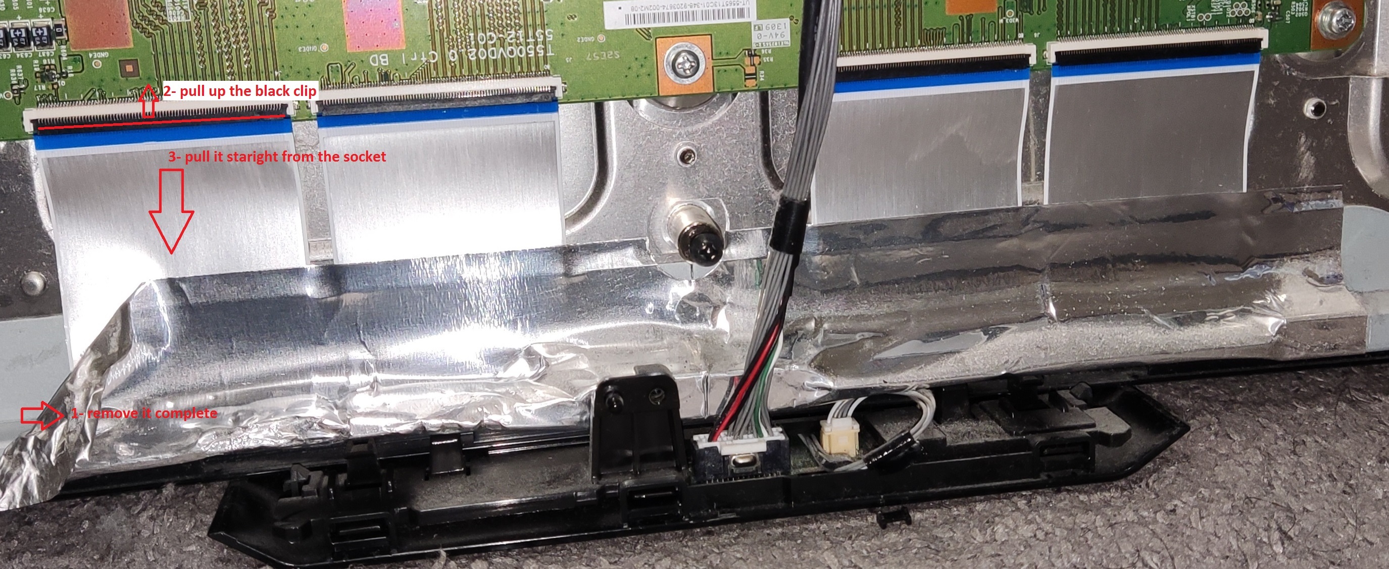

                #87
                Originally posted by tec3000
                so I took out one of the LVDS on the mainboard end, had a look and just plugged it back in and first pic happened. Then I played with the cable and plugged it back in and i-Manual is almost as good as it has ever been. (pic 2) BUT Diah can you take a look at pic 3 and 4 and tell me how I should clean it?
                And in pic 5 you see the ribbon cables. Any hint how to carefully disconnect those cables? I should first peel off the tinfoil right? I really don't wanna mess this up....
                i do wounder our experiences user went to talk on subject and the important things to advice newbie didn't take in place
                so, before any things you do, ,, install back the metal shield & heat sink of LD and T-CON to aoide any spark from yours body to damage them.
                about yours questions,,,
                this how to disconnect the 4 ribbon from panel in points

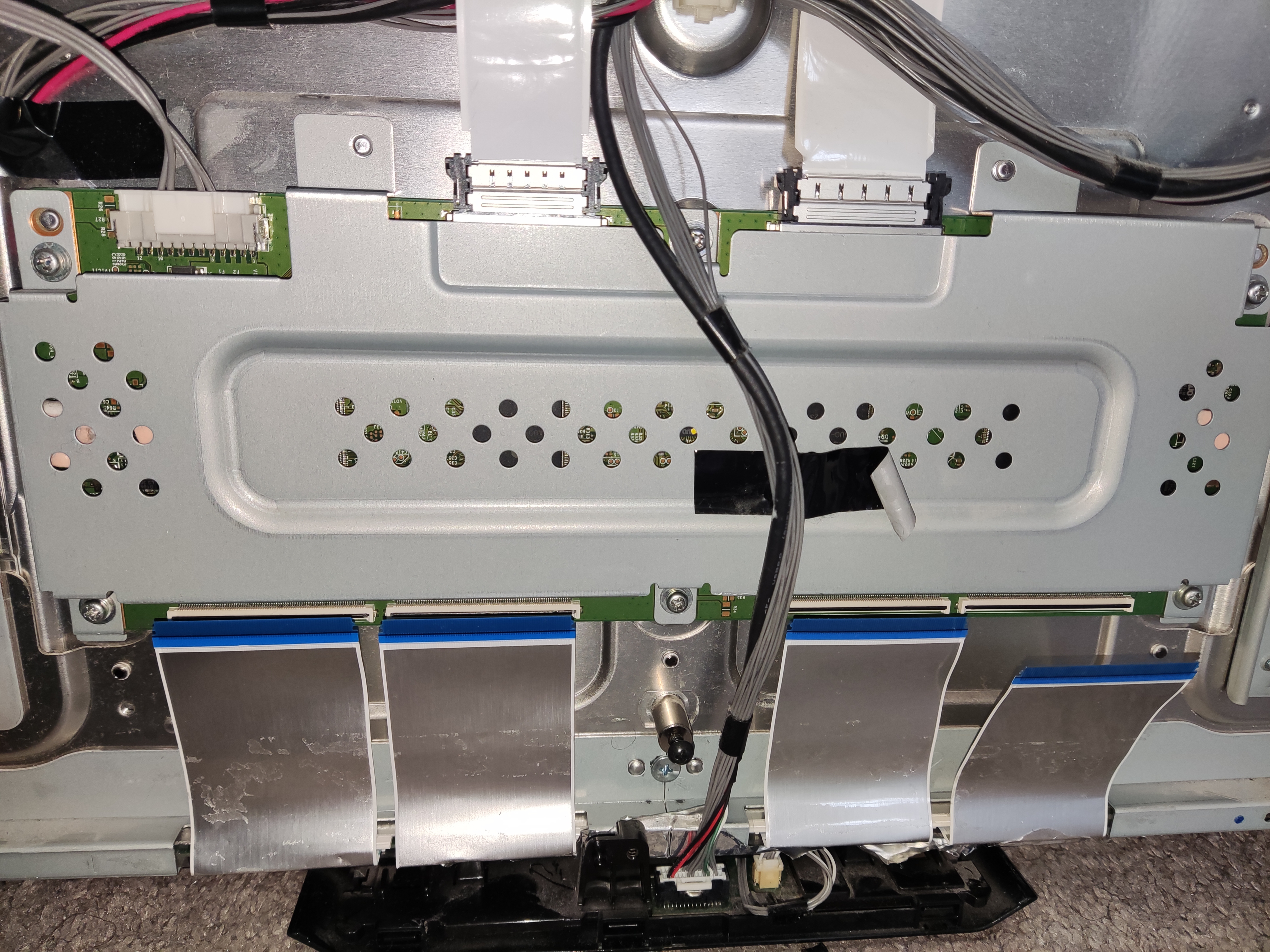

                • tec3000
                  • Mar 2024
                  • 119
                  #88
                  Indeed, thank you!! I wouldn't have put them back on! Now they're back on the TV again.
                  I was able to remove the foil and detach the ribbon cables from the connector. Is this the right end? It's still connected at the bottom of the TV. I have attached a pic how it looks right now.
                  • Diah
                    • Feb 2013
                    • 6445
                    #89
                    its okay... before every things as the TV back on top , remove the speaker and under the speacker there are metal cover the panel buffer boards... you may need also to remove the base of the legs standing too.... after you have access and the buffers boards free from the tV you can start removing the bezel from the front of the screen, , pull out the screen with suck cups... remove sheets and keep them in same order ... that's all,,, putting back will be reward process as you start,
                    • tec3000
                      • Mar 2024
                      • 119
                      #90
                      Great, thank you. BTW: I got the double suction cups today. Now I can try to remove the screen and see what LEDs I need to replace. Wish me luck guys!

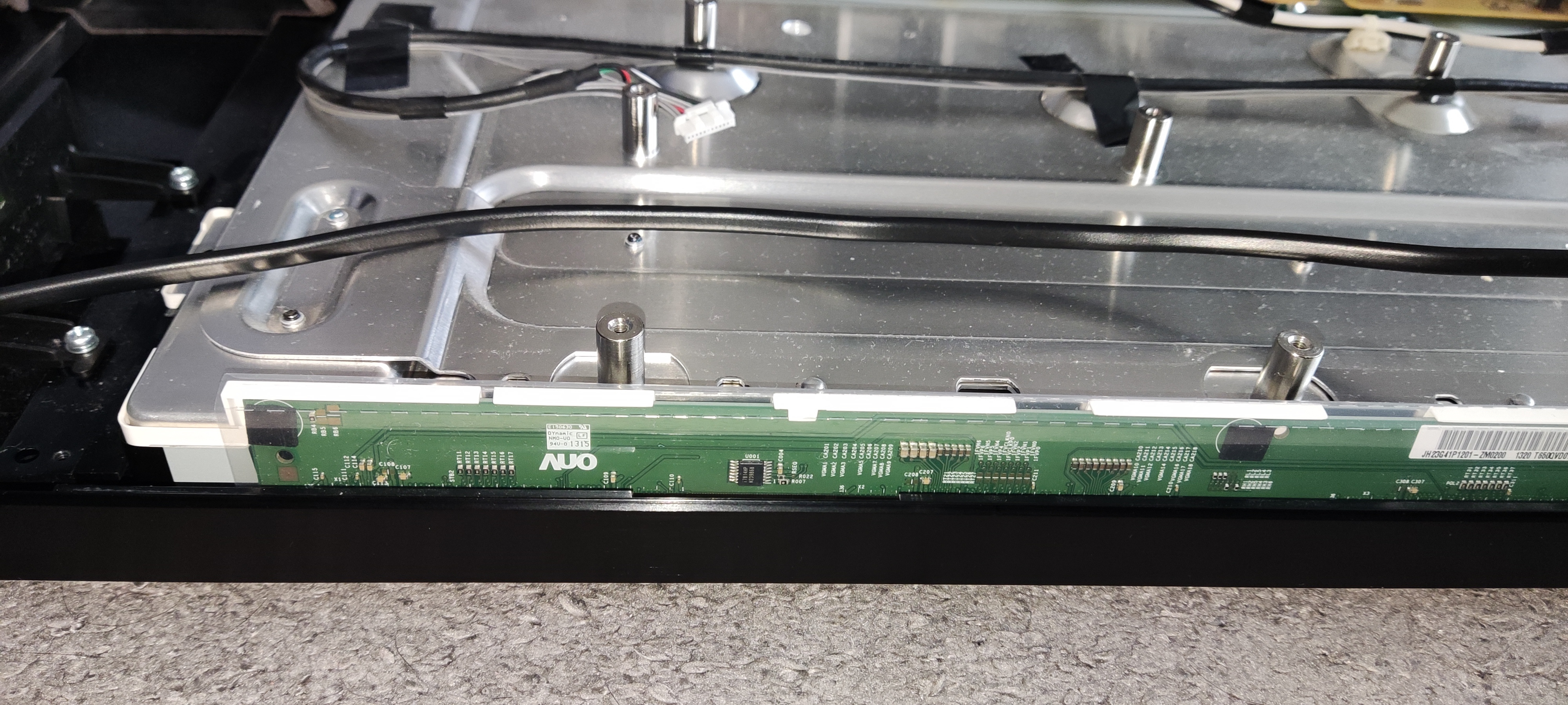

                        • tec3000
                          • Mar 2024
                          • 119
                          #92
                          Yeah, right now I wouldn't know what kind to order and how many.
                          So right now I'm doing the tear down. Not sure how to proceed though. I couldn't find a video with my Sony model. It's from 2013. So it looks distinctively different than newer models.
                          Can you guys take a closer look at the front of my TV? As you can see the speakers are a bit different on this model.
                          And I have trouble removing the bezels. They're not coming off. I also can't find any screws that are holding them. Maybe I don't even need to remove them?
                          Thanks guys!
                          • Davi.p
                            Hobbist Tech
                            • Sep 2009
                            • 4477
                            • Italy - Milan
                            #93
                            can you post the exact tv model? i don't think it's ok what you posted..

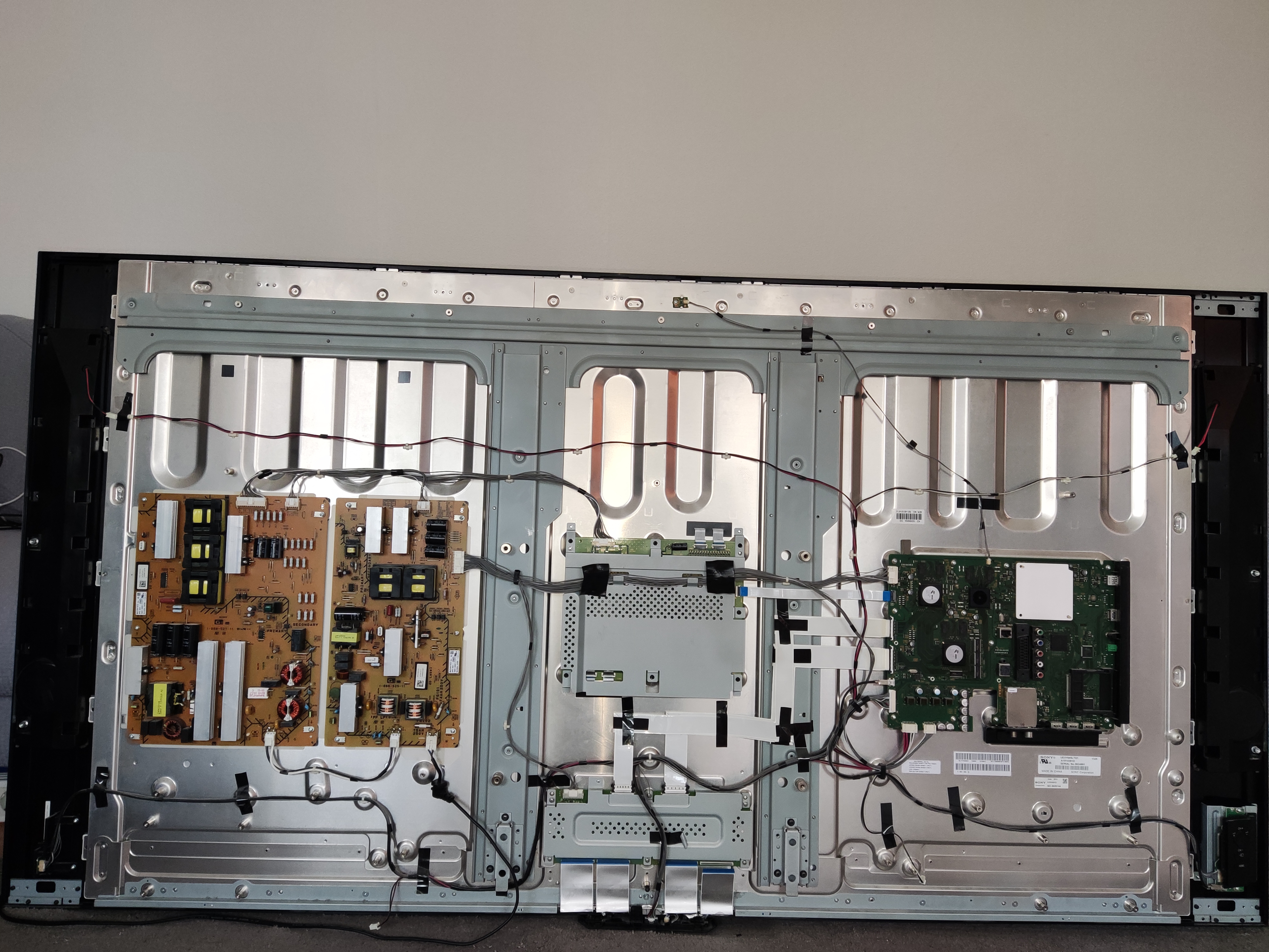

                            • tec3000
                              • Mar 2024
                              • 119
                              #94
                              Model name is: KD-65X9005A
                              • tec3000
                                • Mar 2024
                                • 119
                                #95
                                right now the TV looks like this:

                                  Well for a start mate you need to remove all the boards. So disconnect the plugs and leave the wiring looms in situ. Then things will look a lot clearer. The bezel of the TV will simply unclip from the screen. By design it can’t have any screws in it when you think about it.
                                  • tec3000
                                    • Mar 2024
                                    • 119
                                    #97
                                    TA, appreciated! So mainboard, power supply board, T-Con, etc. ... all out? What is the purpose? Remove the bezel? Or unscrew anything that is holding the screen from the back of the TV?
                                    • Donny2derby
                                      • Apr 2023
                                      • 228
                                      • Uk
                                      #98
                                      Because you’ll want to remove anything that could become damaged when laying the Tv on its back. And you want to be able to see if there’s anything underneath those boards you have to remove or unscrew before you can be sure it’s safe to begin removing the bezel from the screen.
                                      • tec3000
                                        • Mar 2024
                                        • 119
                                        #99
                                        ok, I'll start removing the boards now

                                          #100
                                          E-ehm.. i would not touch the boards... i think them will be useful when you removed the lcd glass to see the leds on, especially if you memorize the imanual key sequence..
                                          i have never seen the imanual screen out, are we sure those shadows in first post image are a defect?
                                          from what i read this is a local dimming set, the tiny power mosfets on the led control bd seems have suffered a bit, some has brown halo some not.. why? each one controls probably a screen sector, one of those could be leaky, i would test them in diode mode in every combination especially G-D , G-S , and compare them, before taking risky action..
