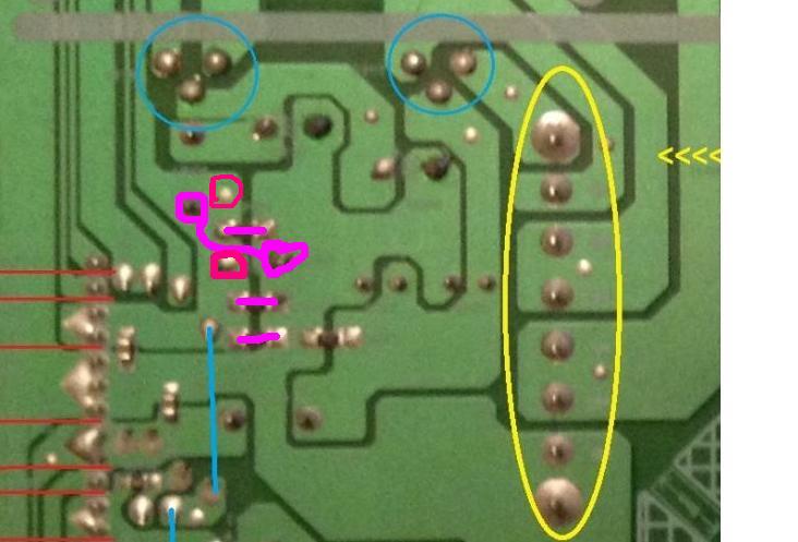

    Originally posted by selldoor View Post
    Hi - what is this- may be just a link or the picture, but it looks a bit odd.
    You have excellent eyes! I suspected this one, too. It looks odd because i lifted two pins for testing. From this view, the top left one and the lower one. Problem still remains....

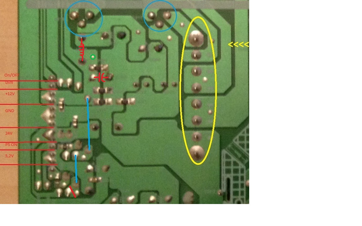

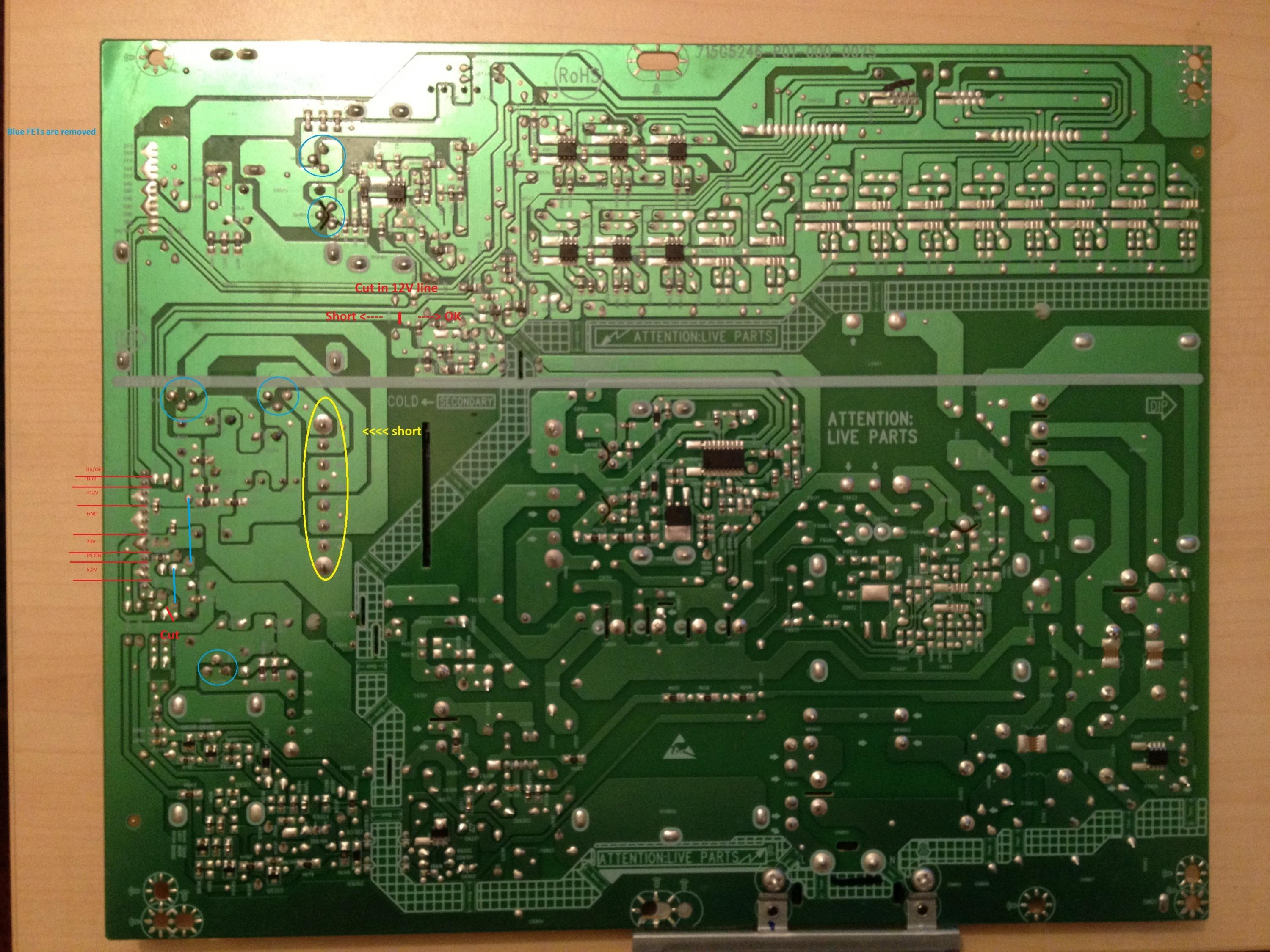

      So, i made a cut in the 12V line. Pls see the picture for details
      Edit: Picture updated with another cut. Blue lines are jumpers on the top. No short below this cut

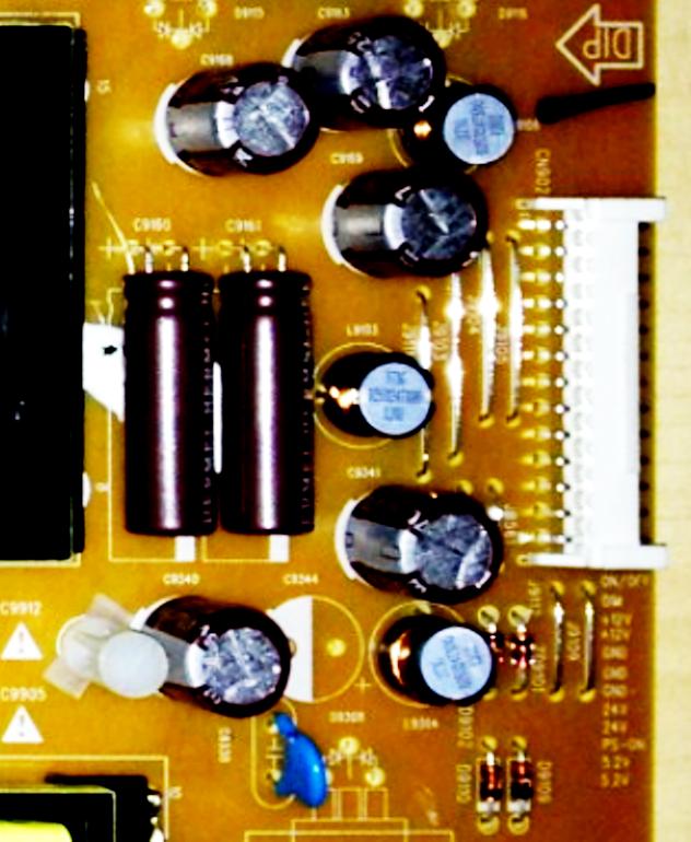

        OK, the other possibility is a failed MLCC (ceramic capacitor.) There is a small brown capacitor across the +12V and GND, right near the connector. Remove this and check if the short persists. It is only for EMI so not crucial for operation. Replacement should be with a 1uF 16V or 25V, 0603 device.

          Well - not a lot to check? Make sure the solder joints are not touching at the connector
          12v and gnd are pretty close. Then chack those little smd components that go from 12vtrace to gnd trace.

              So, let me understand this. DMM in ohms across 12V and GND. Reads dead short?
                Re: Faulty Philips PSU (715g5246-p01-000-002s )
                Reads 0,5kOhms With cuts still open
                  And across the transformer tap it shows a short?
                  I fail to see the problem here -- this is quite normal. A transformer winding is a piece of wire inductively wound around a core. Ideally, it has zero resistance.

                          Can you unsolder the long link - will shorten the problem zone.
                          Did you test the resistors crossing the line? and is there a cap or something
                          pinkish lines - what is the odd cherry coloured joint

                            Can I see the label on the white connector with a bunch Voltage labels next to it, I cannot read them on the picture.
                            I expect the 5V stanby to be working sinc the 12v is switched on by the main board.
                            Philips model number and chassis number? I also see MLCC right across the 12v output close to those two bleeder resistors.
                                The blue one? It´s unsoldered. See post #22
                                They seem to be fine. They would have much more ohms and not shorting out when failing.
                                Pls see the pic for details.....
                                    He means the values shown in the box underneath _ I tried to enlarge and improve but could not
                                    On/Off
                                    DIM
                                    +12v
                                    +12v
                                    Gnd
                                    Gnd
                                    Gnd
                                    24v
                                    24v
                                    PS-on
                                    5.2v
                                    5.2v
                                        So it shows 500 Ohms (0.5K Ohms), that is not dead short, that sounds like the reading of those 3 resistors in parallel with the 12V output. I think we need to get the 5vstby working first.
