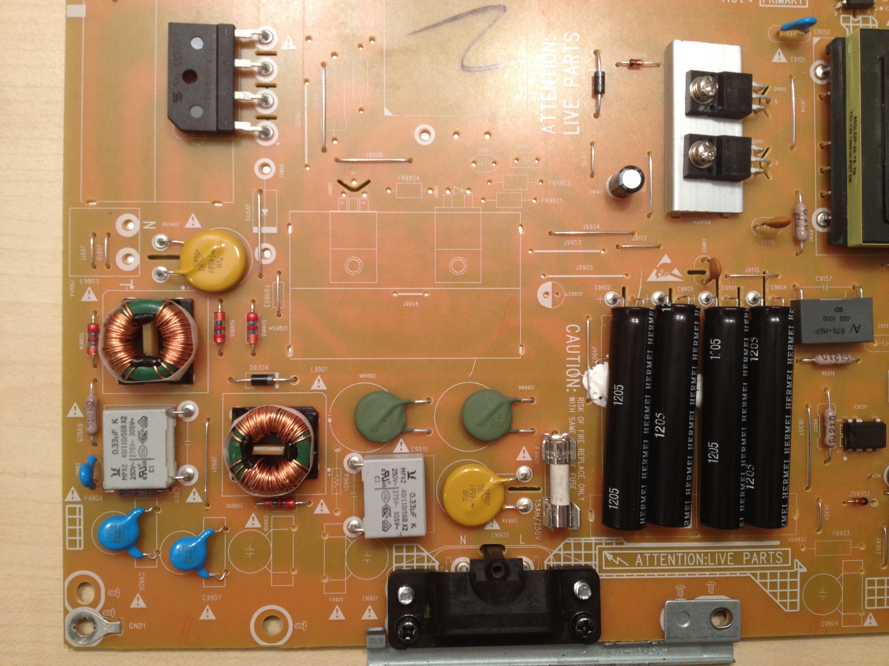

      Re: Faulty Philips PSU (715g5246-p01-000-002s )
      Can I get good focused pictures of these area so I can clearly see the traces and the designators?
      • Mr_K
        • 111

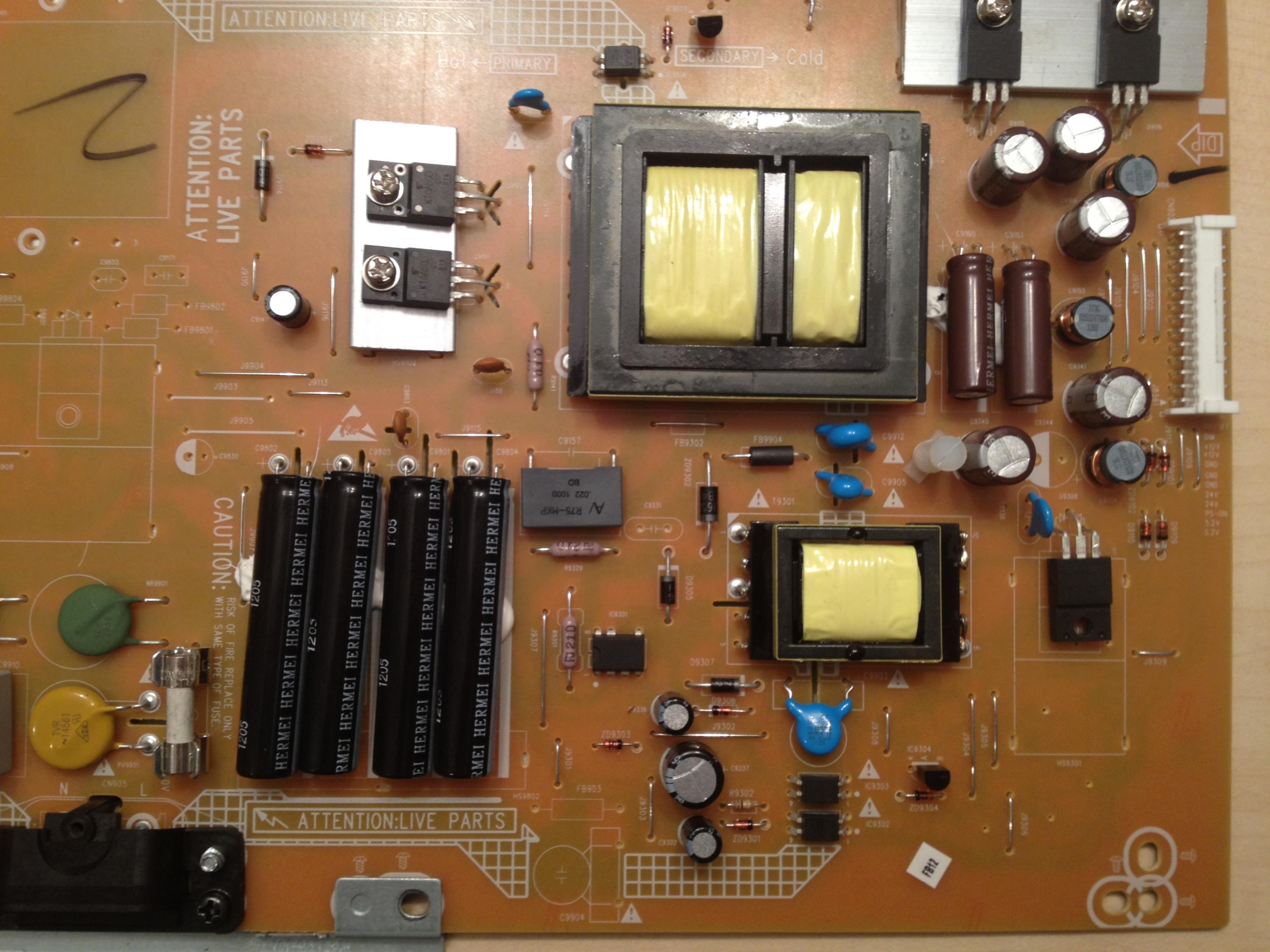

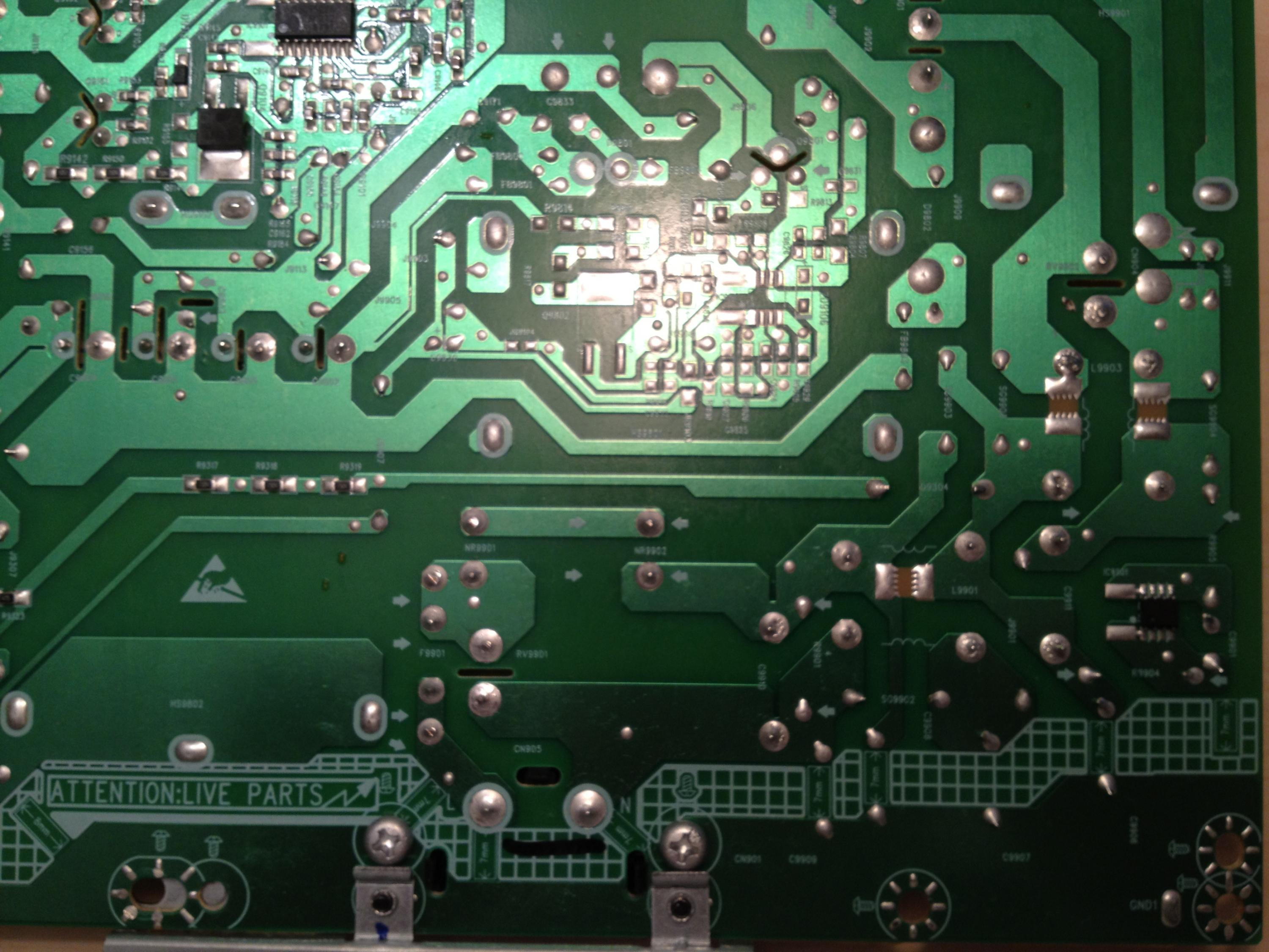

        #43
        Sure, hope these are good enough. If you need anything else, pls let me know.
          #44
          Thanks. Can you get the part number of that 7-pin DIP IC for that standby power supply section? Also pictures of the same section on the top side of the board.

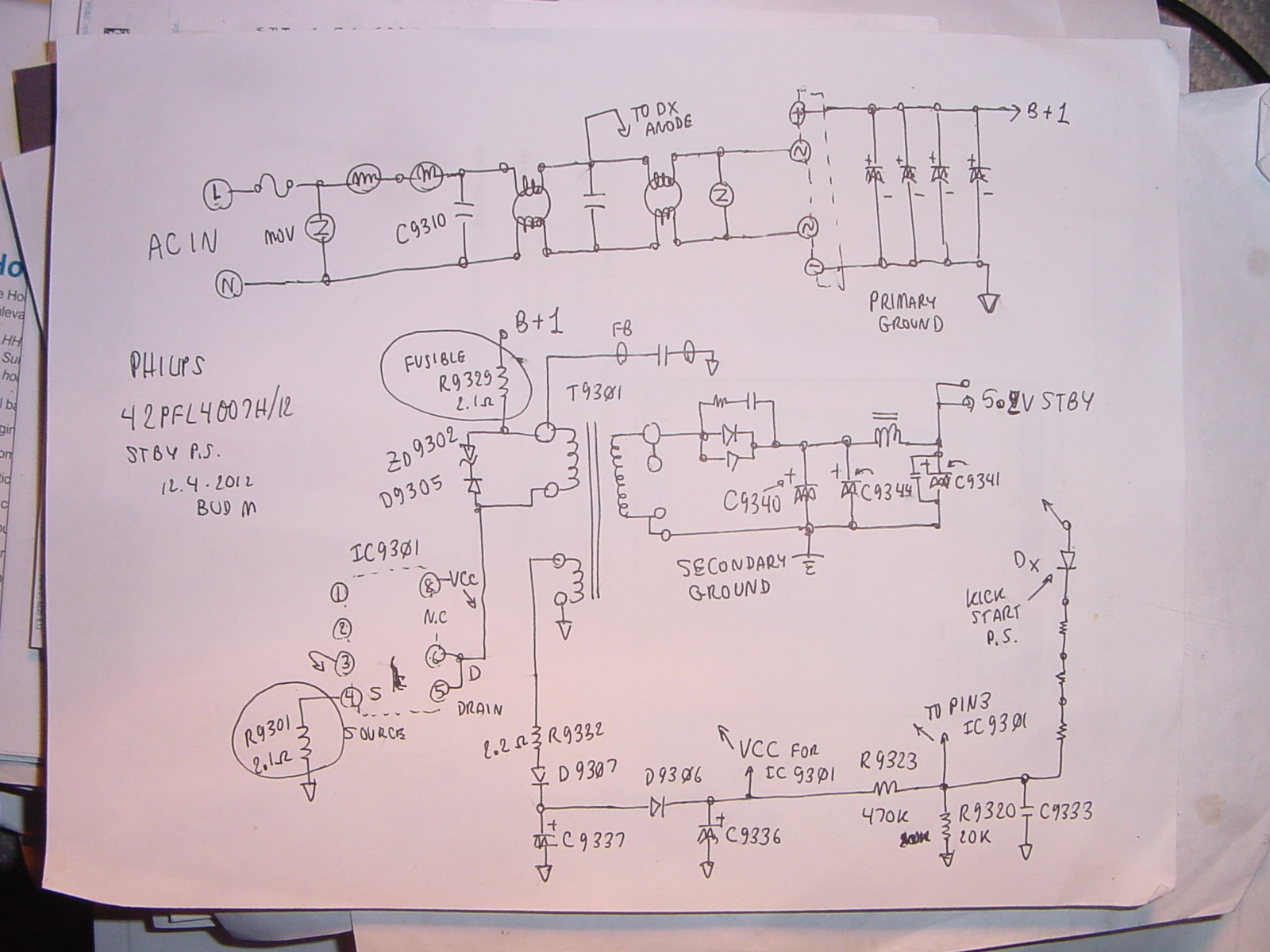

            #45
            OK, this is the best I can do by looking at the pictures.
            Please check and see if you do have B+1 voltage.
            Check the fusible resistors R9329, R9301 (I am not sure the exact values on these two resistors, cannot read the numbers on the body).
            Check ZD9302 for low resistance reading on both direction. I am surprised that the two MOV's did not blow up, or the main fuse.

                #47
                OK, next thing we need is the resistance reading on all 7 pins of that IC and the Primary ground. Since there is not much in that circuits beside the two star up caps (9336, 9337) and the IC. You may want to replace those two caps and the IC if they are cheap.
                I will have to look up the spec of the IC next.
                By the way, now you understand why I always ask for good clear focused pictures.

                    #49
                    OK, here is the spec of the IC.
                    OK, I need to up date the pin out of the IC. I see two dot on the bottom side of the board by each end of the IC pin, so not sure which pin is pin1, now with the spec sheet now I see. I will update the drawing.
                    Please take the reading per spec sheet so I do not get confused, thanks.

                        #51
                        That pin two looks bad, it has resistor R9320 (20K) to ground and MLCC (C9333) in parallel. So it eother has internla short in side the IC or shorted MLCC C9333. Can you lift pin 2 off the board to see the reading on that pad 2 still showing 228 Ohms?
                        • Mr_K
                          • 111
                          #52
                          It has 228KOhms. Missed the point.....
                          The pin reads 12,4MOhms. The pad still reads 228K
                            #53
                            228kohm is bad though, with 20kohm in parallel, MAXIMUM reading is 20kohm.
