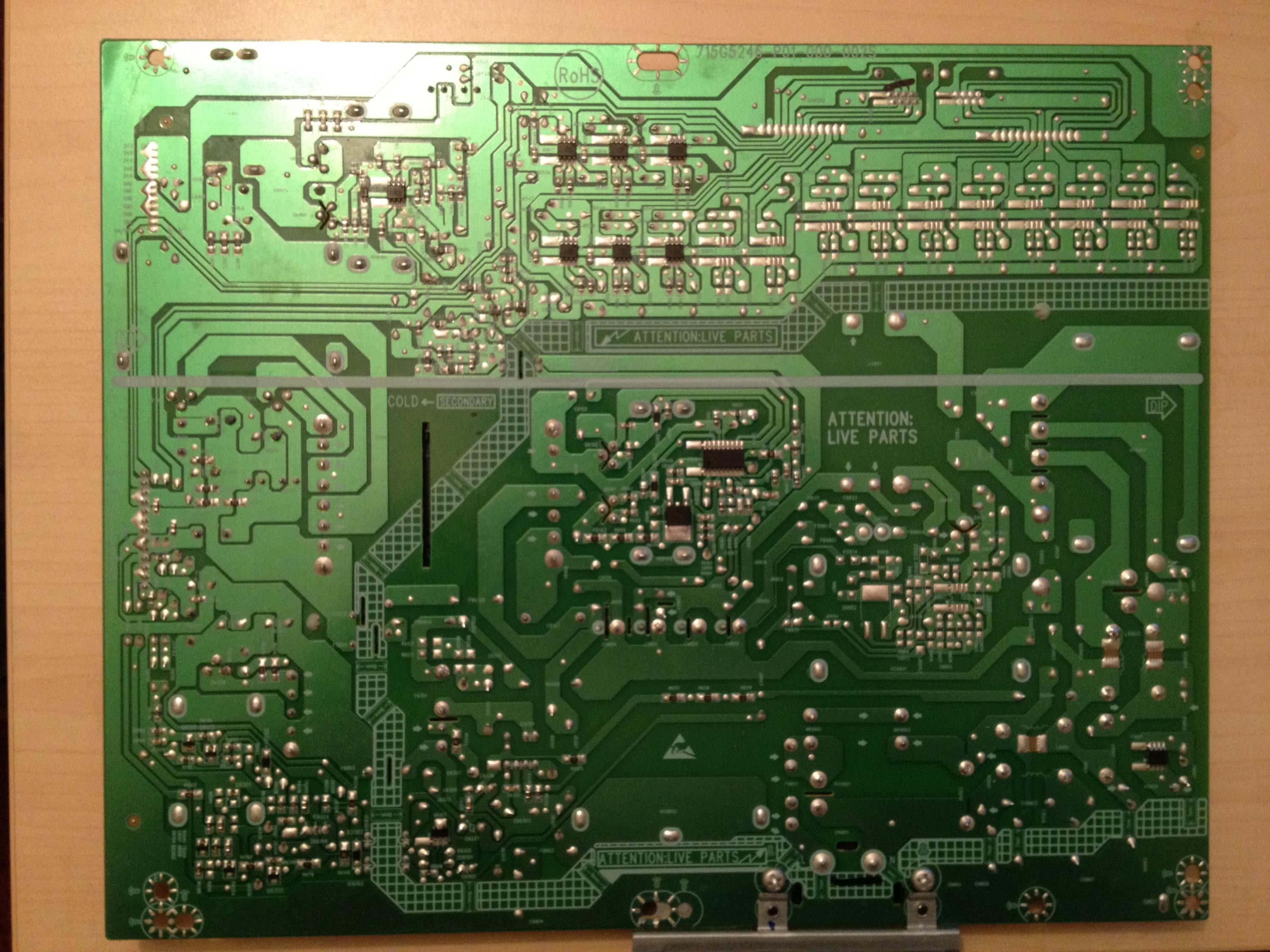

    This PSU was pulled from a faulty 42" Philips LED TV.
    TV was not turning on. I was told that it has been damaged from lightning.
    Here is a Pic of MY PSU:
    For better view pls check out this page
    First of all i´d like to know why there are so many missing components (and heat sinks) on my board, especially on the primary side. The serial numbers match exactly.....
    Don´t mind the 5 missing FETs on the secondary side. I removed them for testing....They are fine.
    Here is what i found so far:
    Primary seems to be ok. On the output, there is no 5v standby voltage. The 12v rail has a short to ground.
    Any help appriciated

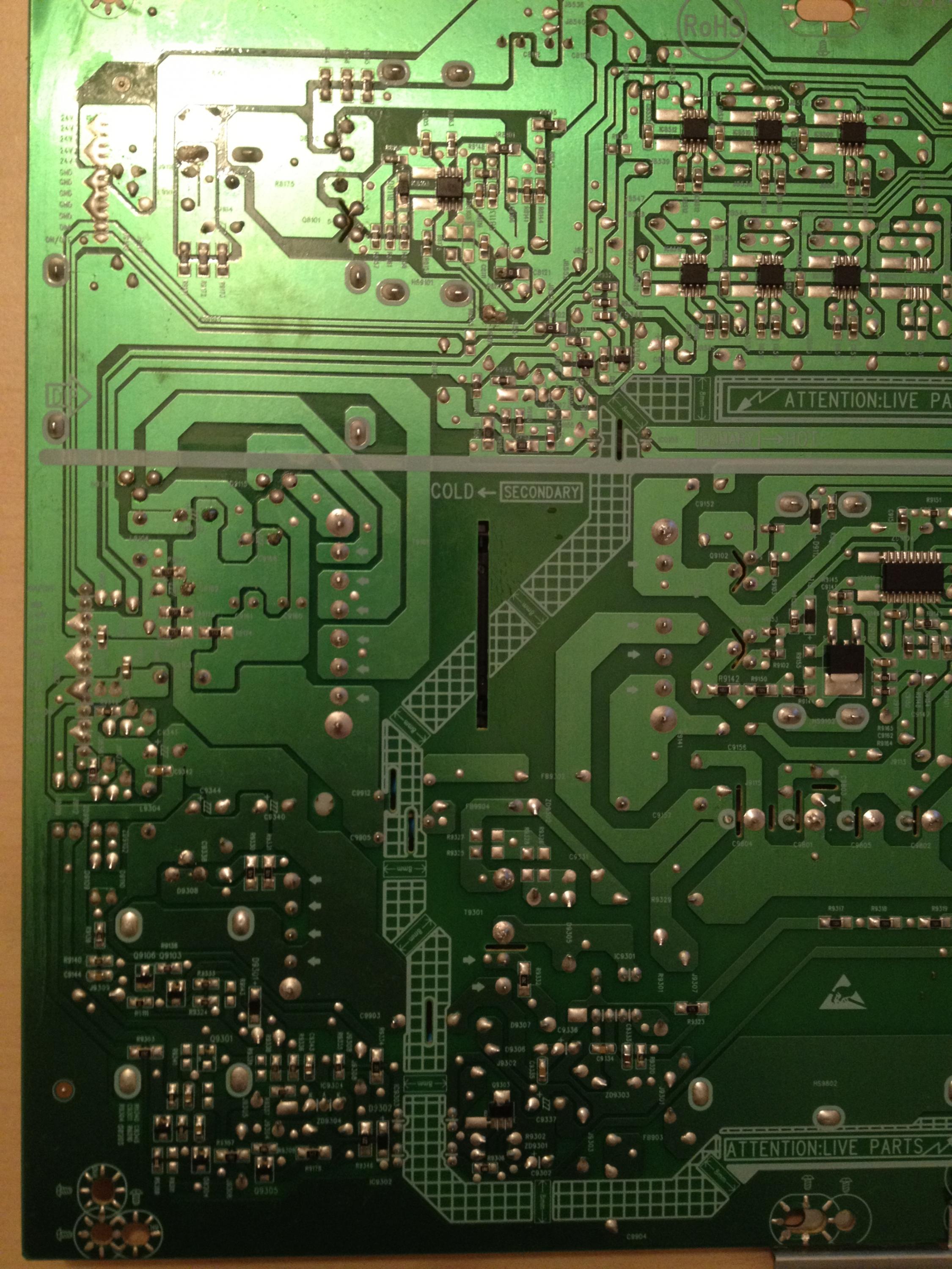

                    Can you supply a picture of the bottom of the board?
                    • Mr_K
                      • 111
                      Re: Faulty Philips PSU (715g5246-p01-000-002s )
                      Here are fresh ones with the best quality i can get:
                      I´ll upload an edited one in a sec....

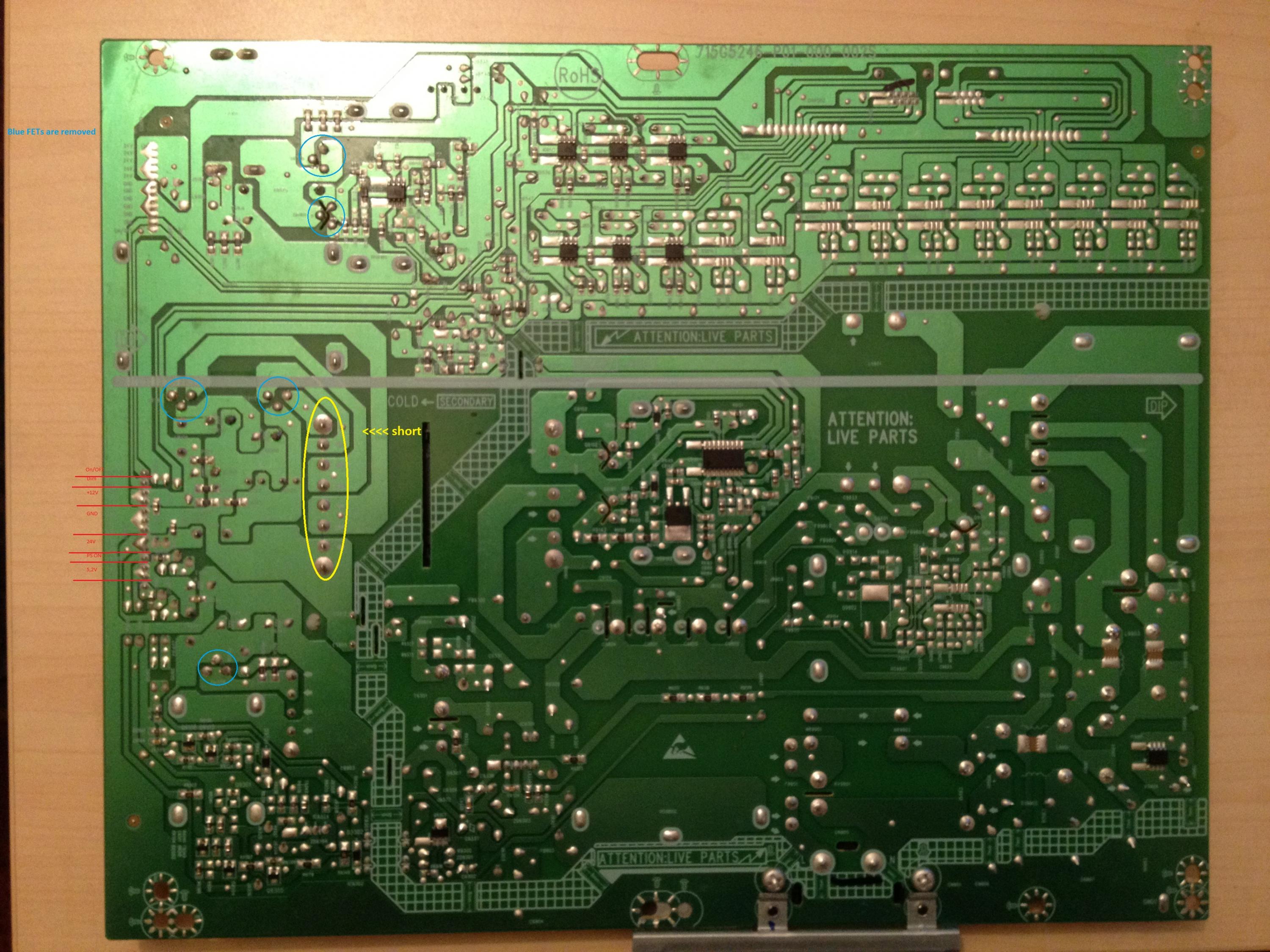

                      I´v added the pinout for the connector. Blue FET´s are removed. Short from 12v to GND
                          Oh, my bad. I didn´t mean they are shorted to each other. They are all shorted to ground. and the 12v output is shorted to ground. So yes, there must be a short beyond the coil.
                            With the diodes remove it's pretty common to real the coils shorted together -- they are tied to a common node, usually ground.

                              Ok, and what about the 12v rail?
                                The 12V might power the LED boost converters at the top of the board. Is there any way to isolate these?

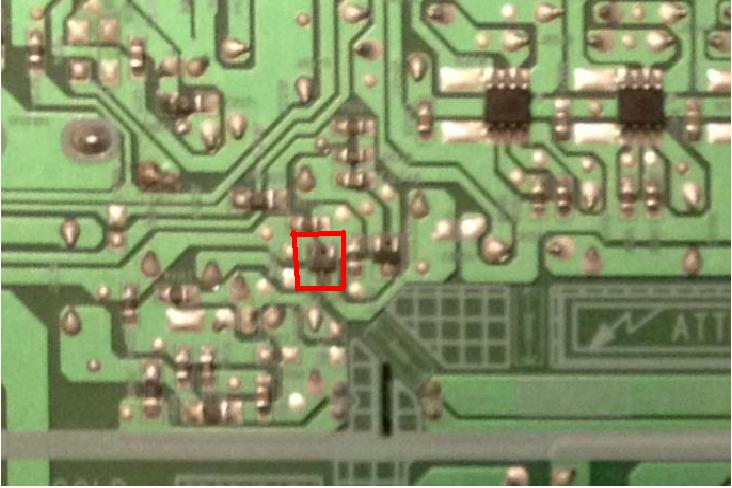

                                        Hi - what is this- may be just a link or the picture, but it looks a bit odd.
