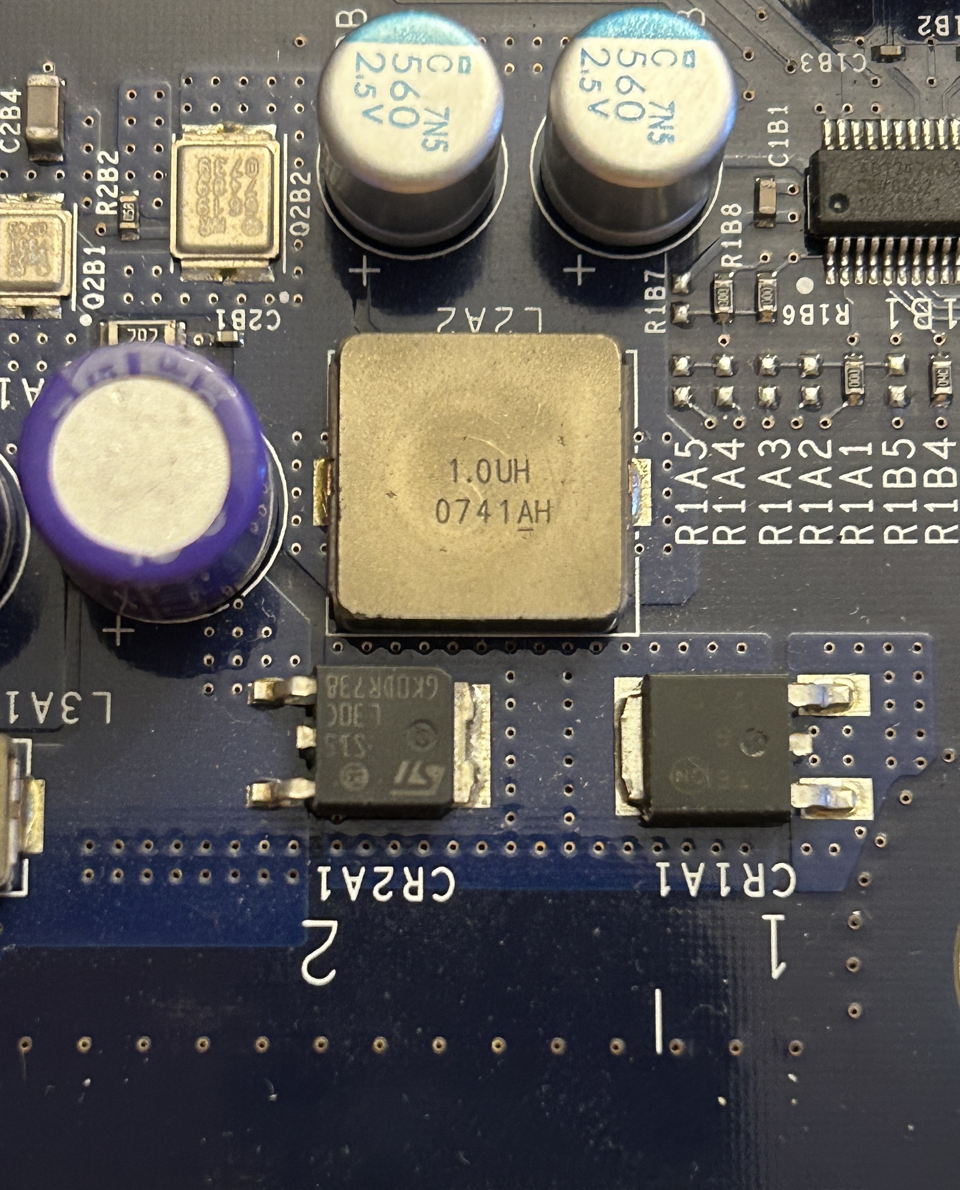

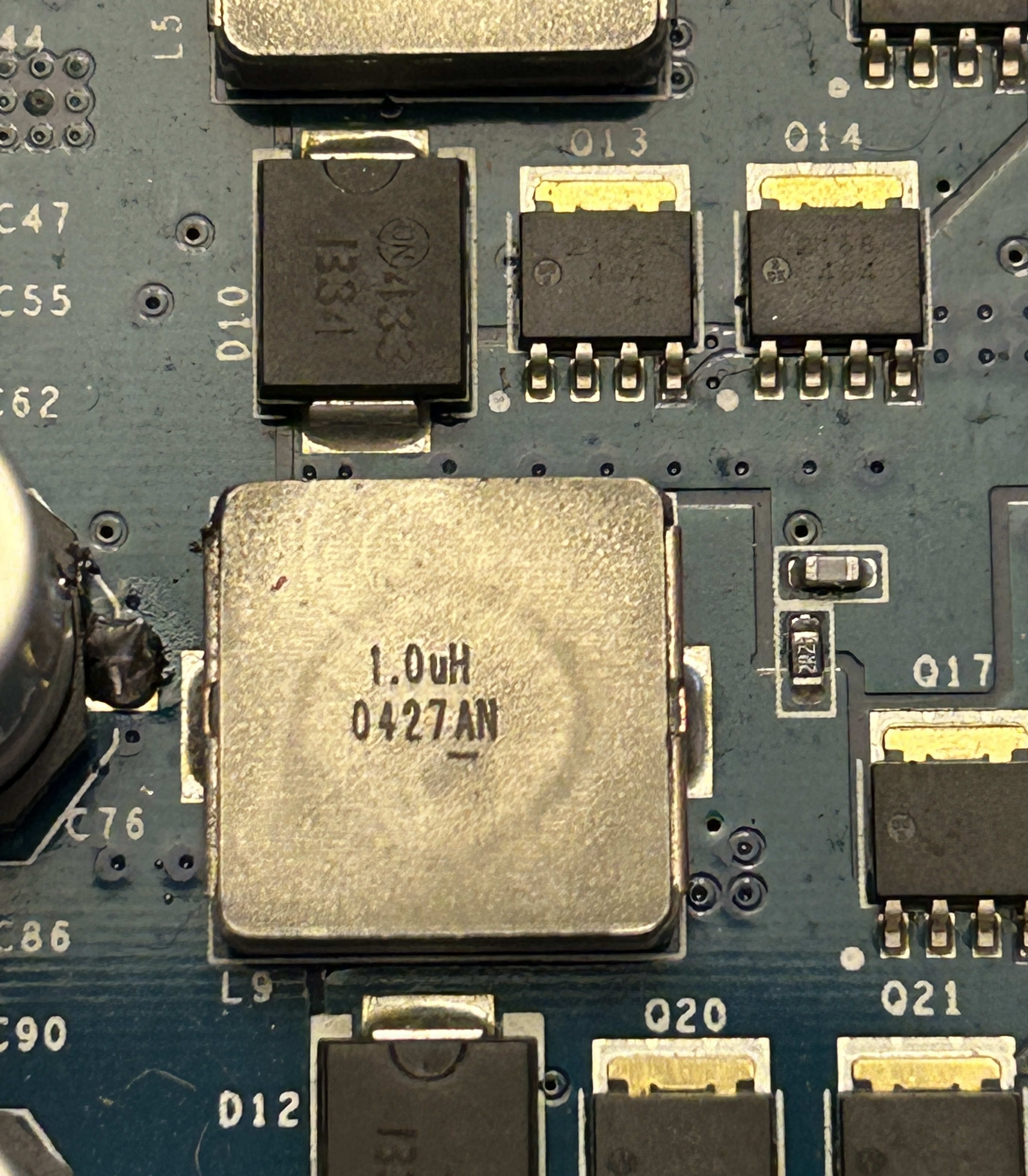

      THANK YOU piernov for the info!! In my search yesterday, I forgot that I had a Mac memory riser board that has an 1.0uH inductor. The one from the riser card (first picture) is 1.0uH 0741 AH, and the original one from the GPU is 1.0uH 0427 AN. It's the same size, except for the lot code being different, so I'm not 100% sure it it'll work, what do you think?
      • piernov
        • Jan 2016
        • 4439
        • France
        This is probably a datecode (41th week of 2007 vs. 27th week of 2004), they look very similar but there is no way to tell if they are 100% identical (a good milliohm meter may tell something about DC resistance but that's it). Could work though. But unfortunate to steal it from one board to fix another.
        • jpreza
          • Mar 2021
          • 8
          Thanks again! I double checked with my multimeter and DC resistance was between 1.5 and 1.8 Ohm for the two inductors. I'm not sure if this is these values are within the range..
          As you mentioned, I have to "borrow" from one board to the other.
          I'll order the missing caps and will report back once I have put the GPU card back together for testing.
          • piernov
            • Jan 2016
            • 4439
            • France
            The DC resistance is in the milliohm range, hence why a specialized milliohm meter is required. A standard multimeter cannot measure with this accuracy.
